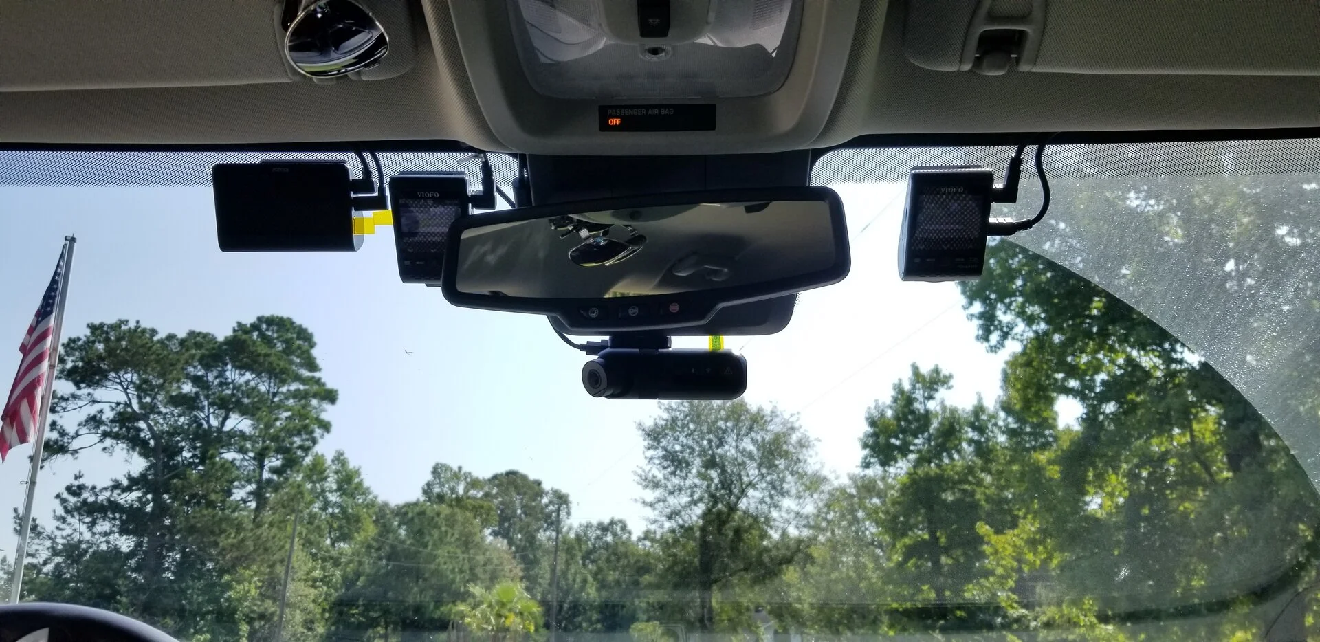

Went out this morning to install the rear cam- 6 hours later I was done :eek: Reworked the sloppy cable runs for all the cams (except passenger side cam which was OK) so it's all hidden and neat and working logically. I ran 2 USB-C power cables, 2 USB Mini cables, and 2 USB Micro cables up front which should hopefully cover future cam testing too ;) I now have one ciggie socket open up front, 2 in the rear, and a USB Micro HWK in place on standby if needed. Had to move the A139 rear cam slightly due to better cable routing and swapped the driver's side cam for a B4K. Also cleaned all the glass. Too tired to configure and test all the cams and changes, will get that and post some vids in the morning :cool:

Installed in my car, the T130 has 'just enough' vertical angle adjustment to aim the front camera at an acceptable angle, with about 50:50 sky:road.
My windscreen is rather shallow at about 23 degrees. I have the camera body rotated all the way round, and the lens is pointed as far down as it will go. I get the same result if I turn the camera upside down, so the range of adjustment is the same both ways.
Some users may have even shallower windscreens, in which case they would benefit from a thin wedge mount rather than a flat mount - perhaps a thin wedge can be included in the box, or as an optional extra @VIOFO-Support ?
