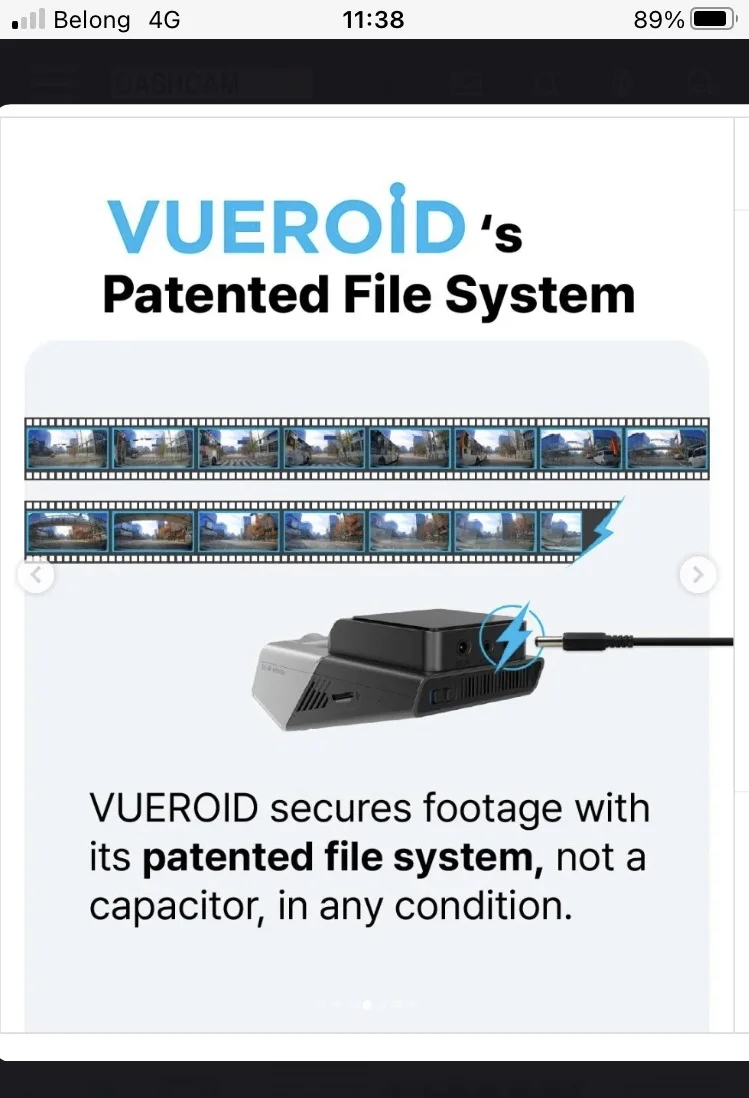

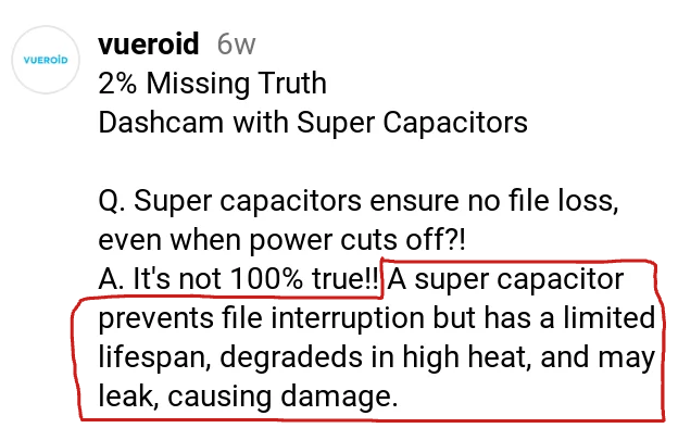

Is that is why the Vueroid S1 is called "Infinite" - it has an unlimited infinite lifespan?
Ask Vueroid, they said it not me. lol
.....Supercapacitor provides power so the camera has a few seconds to properly exit the file being written before shutting down.
Certainly, lithium batteries don't tolerate heat well and end up dying rather quickly, leaving all files being written at shutdown corrupt.
Did @Vueroid invent a new method better than a Supercapacitor? .......I mean @Vueroid stating they have a software solution appears to be VERY counterintuitive. The File is corrupt at shutdown, but the Camera restores the file after it's powered on.
What happens if you're in an accident and NEED THAT FILE immediately and the Camera is renedered disabled? Or, what happens if the Camera stops working? Will any Vueroid model be able to recover the last file?

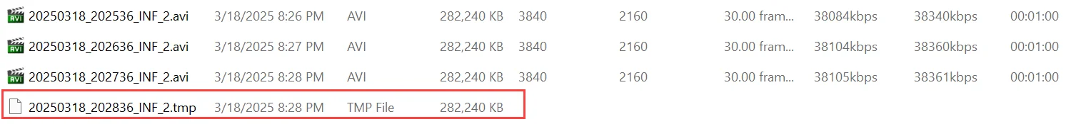

My primary use case for the D21-4K, which has Vueroid's proprietary file system, is to turn off the input 12V power when I return home to shutdown the camera. The reason for that is the manner in which the power button works on D21-4K dash camera. When you long press the D21-4K's power button to turn it off, the "off" state is remembered the next time 12V power is supplied to the D21-4K. When power is restored, you'll see the LEDs flash on and then off almost immediately leaving the D21-4K in the off state until you long press the power button to turn the D21-4K on again. To avoid this remembered power off state, I'm turning off the external 12V power to have the D21-4K shutdown when I park my car at home.
The video file that the D21-4K is writing to when the external power is turned off has a filename extension of ".tmp" [usually ".avi"]. I can successfully copy the ".tmp" file to my computer and rename it to an ".avi" file and the video/audio stored within the file is playable.
The S1 Infinite is believed to be creating MP4 file container type files instead of the AVI file container type files. It will be interesting to see if the file(s) being written to when the external power is removed are playable as well without powering up the dash camera to "repair" them. I don't believe I will need to turn off the external power to the S1 Infinite like I am with the D21-4K, but I'll have to wait to see how it truly works.

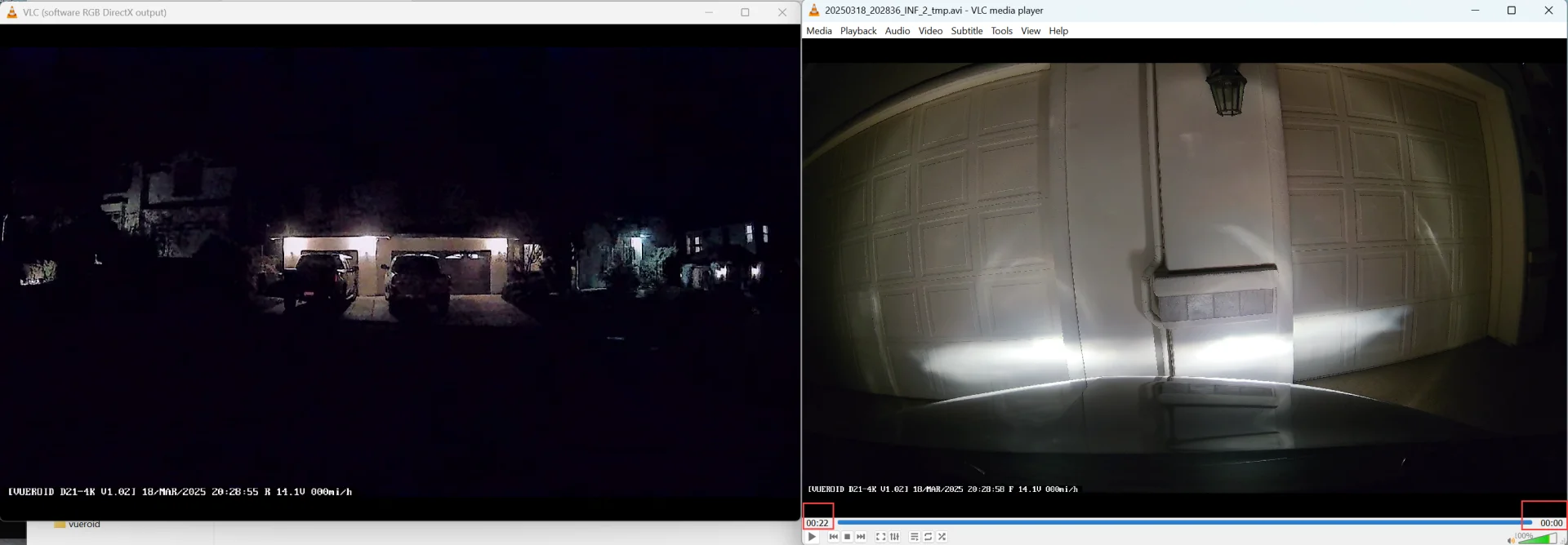

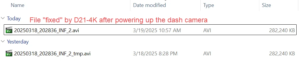

Example from the D21-4K from last night's drive:
The 20250318_202836_INF_2.tmp file is the video file that the D21-4K was writing to at the time I turned off the external power to the D21-4K. I copied that ".tmp" file to my computer and renamed it to an ".avi" file. It played successfully using the VLC player. The renamed ".tmp" file contained 22 seconds of front, rear video / audio content. The VLC video player did not know the full length of the video since that metadata had not been written to the file when the power was turned off, but the video/audio content was there and usable.
You can see the VLC player is showing a length of 00:00 [lower right corner of VLC player] using the "tmp" file version of the video file, but the video/audio was still usable.
This morning, when the D21-4K powered up, it did rework the "tmp" file a bit. It appears to have [re]written the AVI file container type metadata so that video players know it has 22 seconds of content. The length of the media is displayed as "00:22" in the lower right corner of the VLC player window.

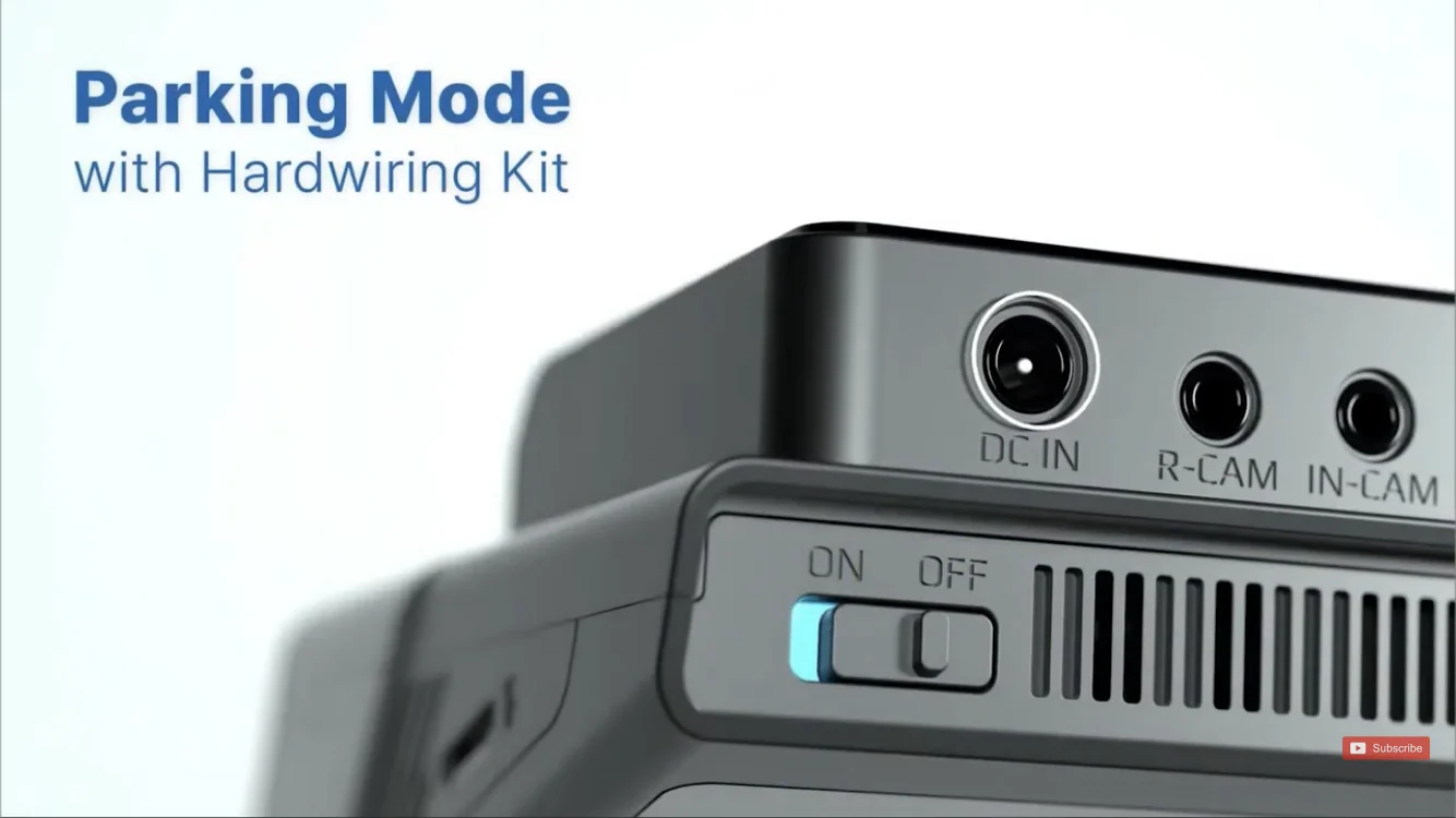

I see they use 12-24V input that would be why no usb power.
I also see they don't mention file type but many recording abilities.
Here s link to @rcg530 ces video.
At the bottom of this post.

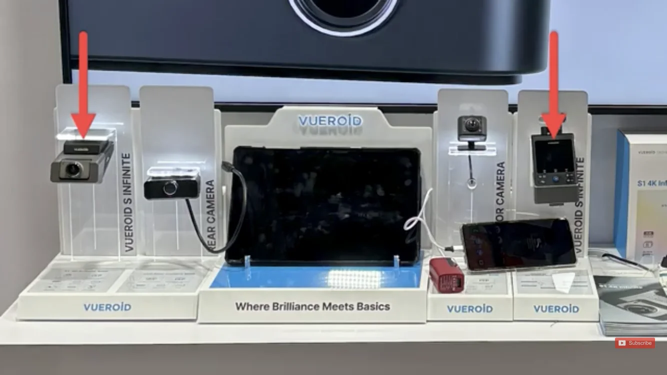

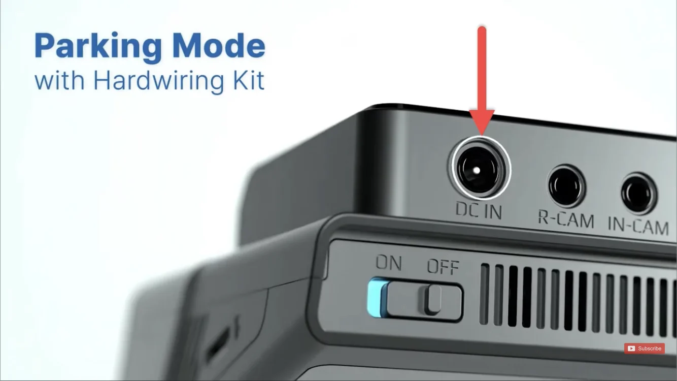

I have taken some screen shots to help clarify my previous posts.
Power plug circular assuming it would use 5Volts
The unit I'm referring to.
Ear plug looking sockets which could mean they are using analog cameras and would like clarification.
patent file system! What is the patent number?
If it is the solution to prevent file corruption for ever I'm all in. It would be nice to know what they have done to back up their claims.
Ok we can do this now with .ts files but they're bigger than what is expected these days.
Credit:rcg530. All image screen shots from his video.
Most of my conclusions based on his early exposure to this equipment. Of course this could change considerably at anytime.

They really like to bang on about super caps and how they "might" fail.
In bad designed products anything could fail but in other products we have tested the super caps seem to be working.
It generally takes a lot to kill a super cap, I mean, it could happen if someone plugged the dash cam into a 48vdc power supply but generally, super caps will last a looooong time. I seem to recall they have a max high temp of around 70c or 80c, which is quite toasty. 🙂 Electrolytic will go much higher, maybe around 130c, blistering hot. As much as I like Vueroid, I think the super cap angle is a bit of marketing to be honest.
