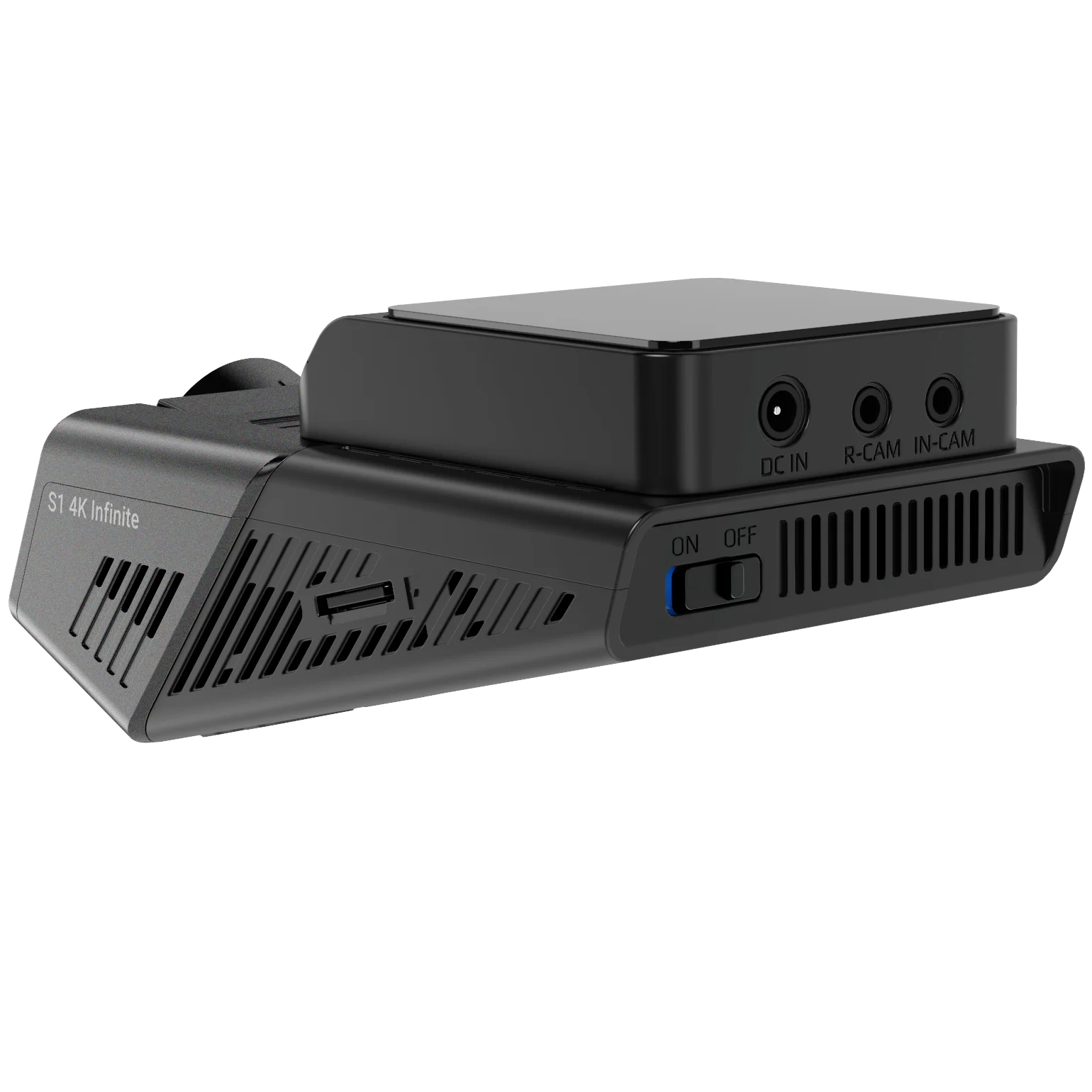

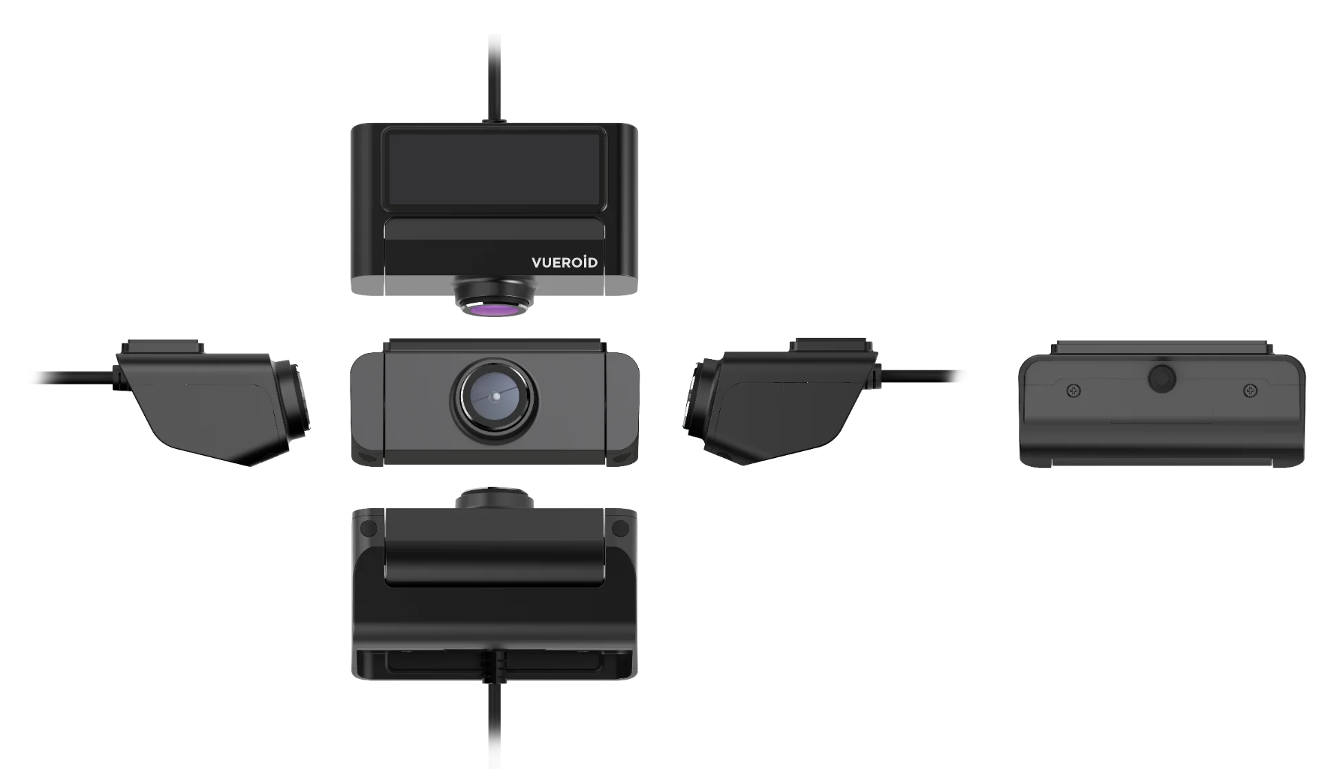

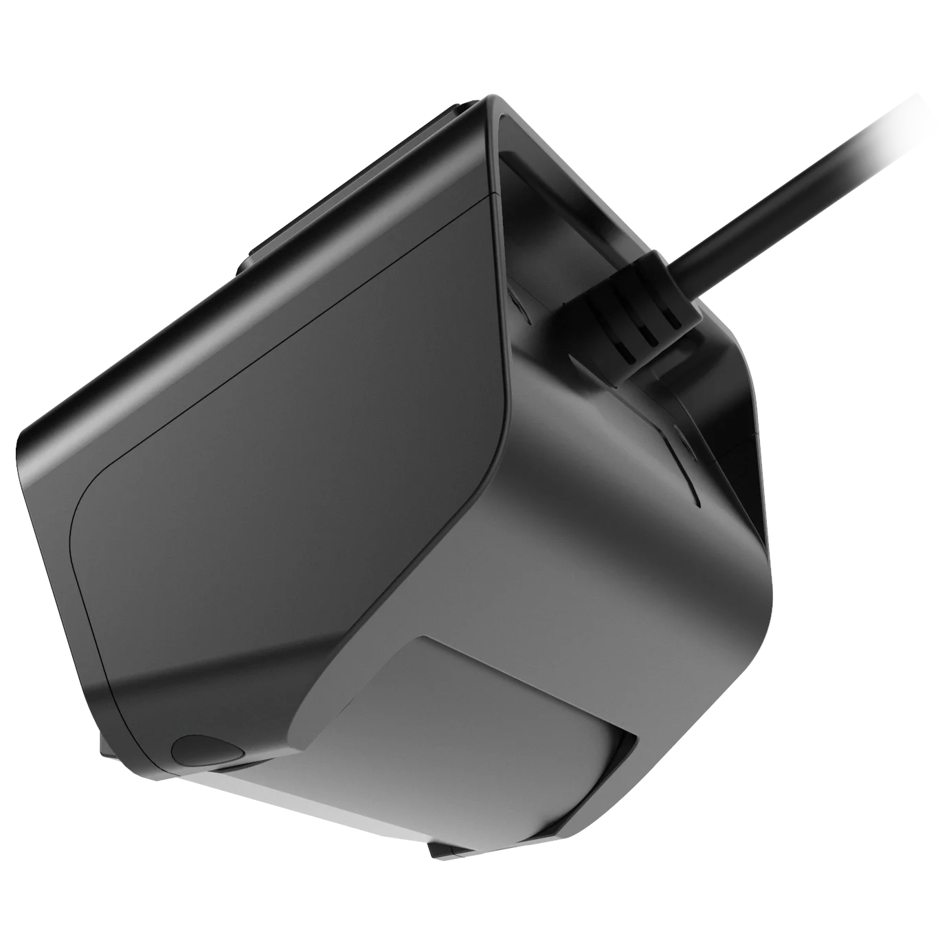

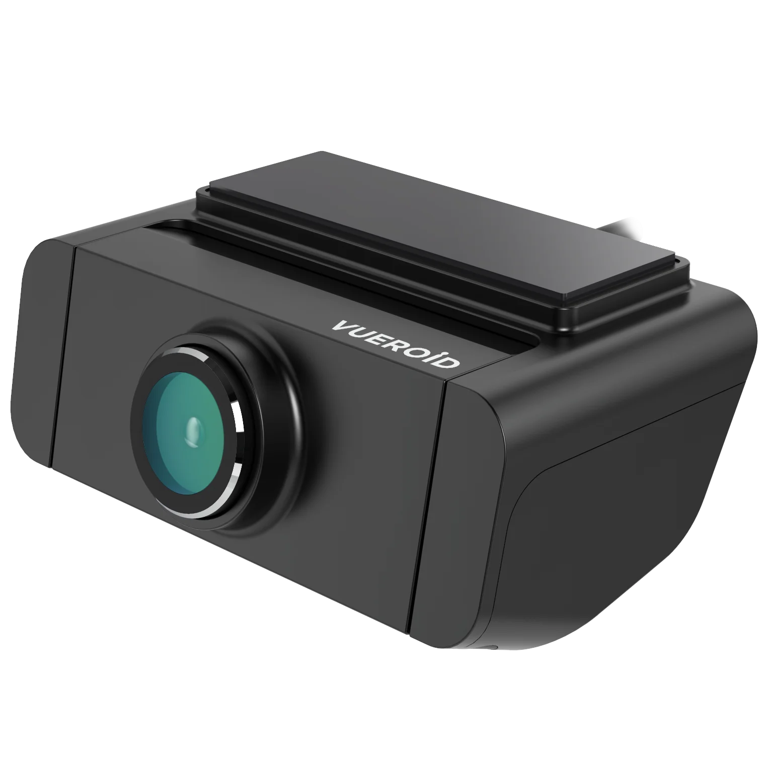

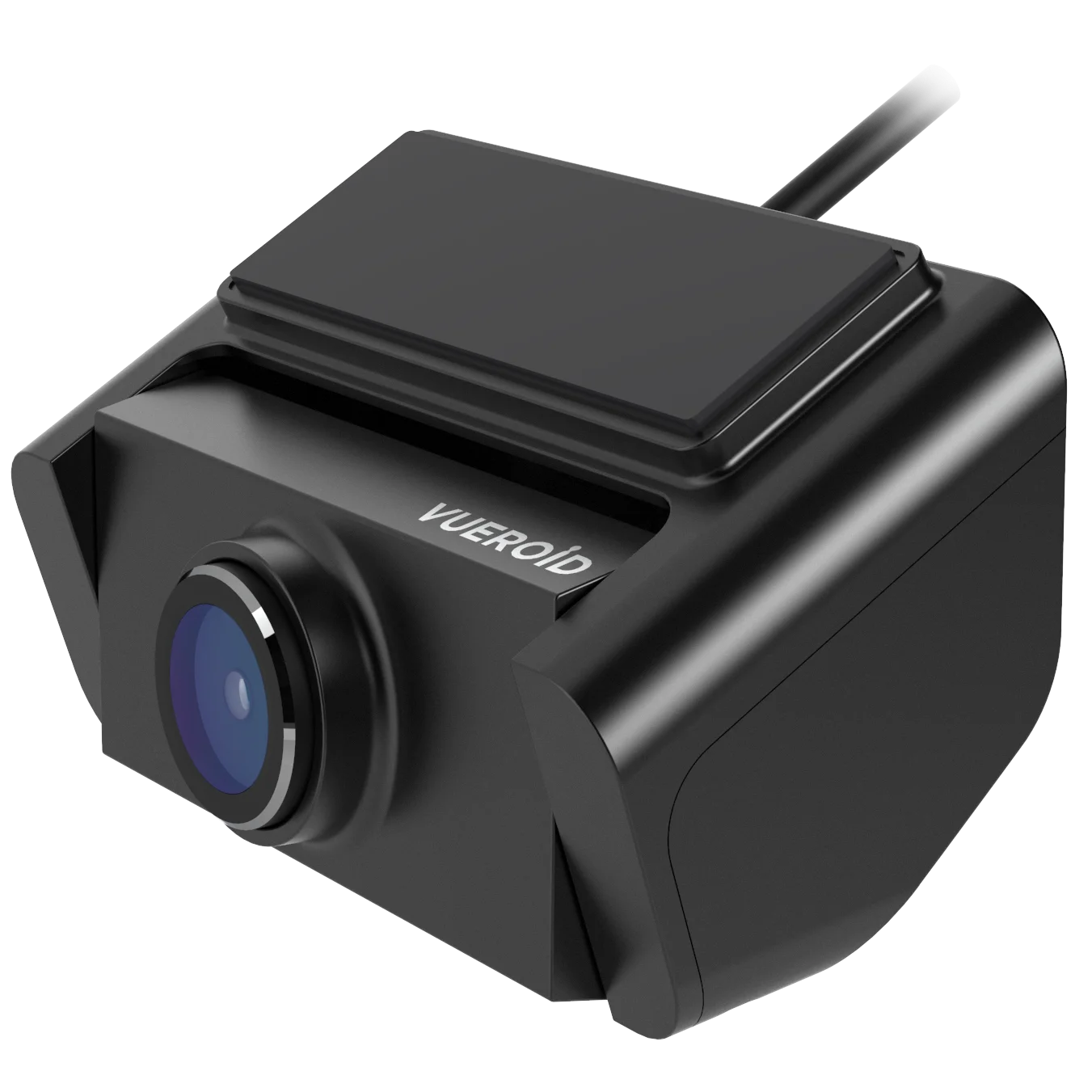

Q: It appears the IR Interior camera cable for the S1 4K Infinite is permanently attached, (not detachable).
Same goes for Rear camera.
Can you make both cables fully detachable from the remote cameras, (not just at the front / main unit)?
Yikes, that's a major design flaw. Look at the flexing in the interior cable. Over time, that would create a short, and you're left buying a whole new interior unit. I've NEVER seen any dashcam maker create an attached cable before. I would caution @Vueroid to redesign the interior unit with a separate cable.

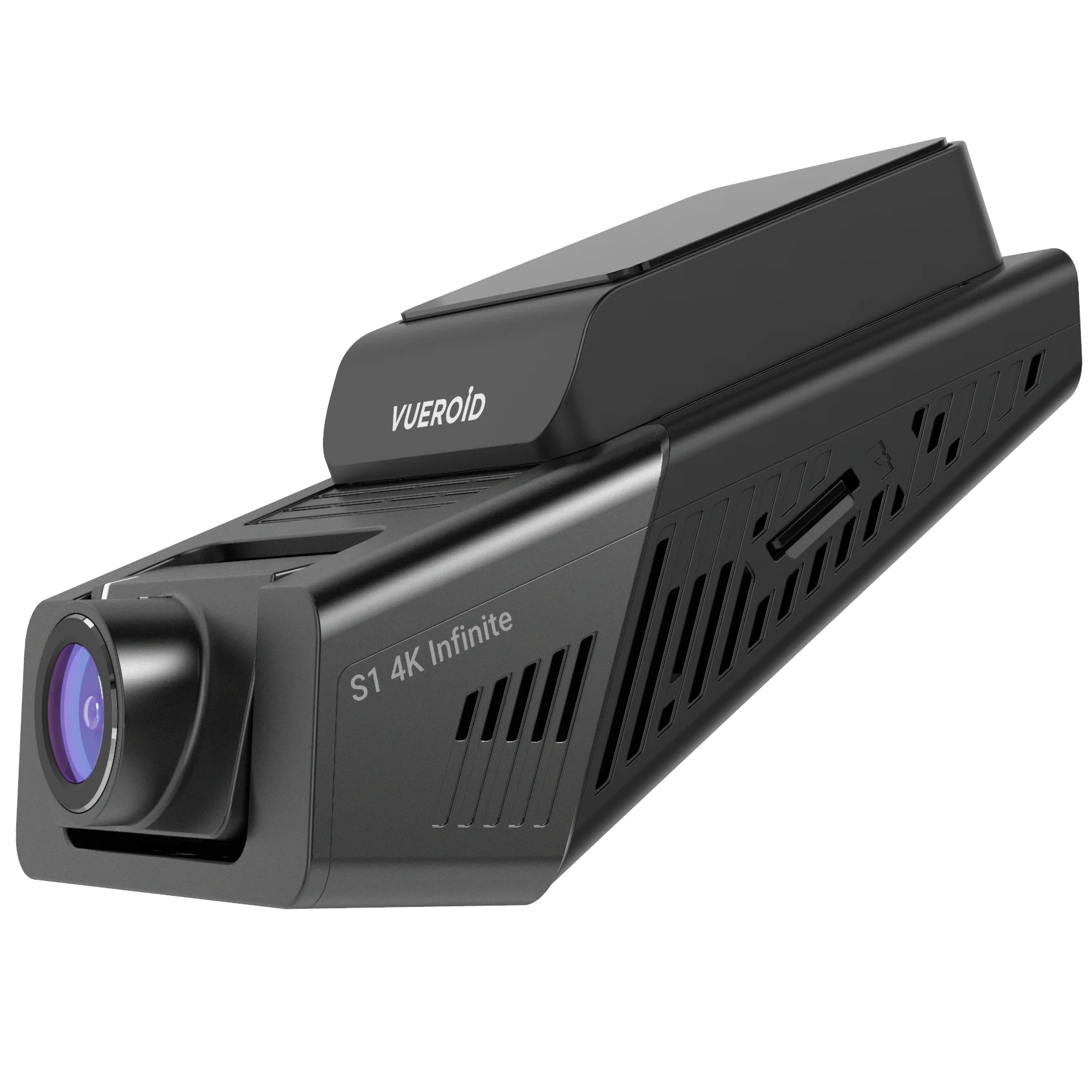

Can you take a better photo of the Main Unit?

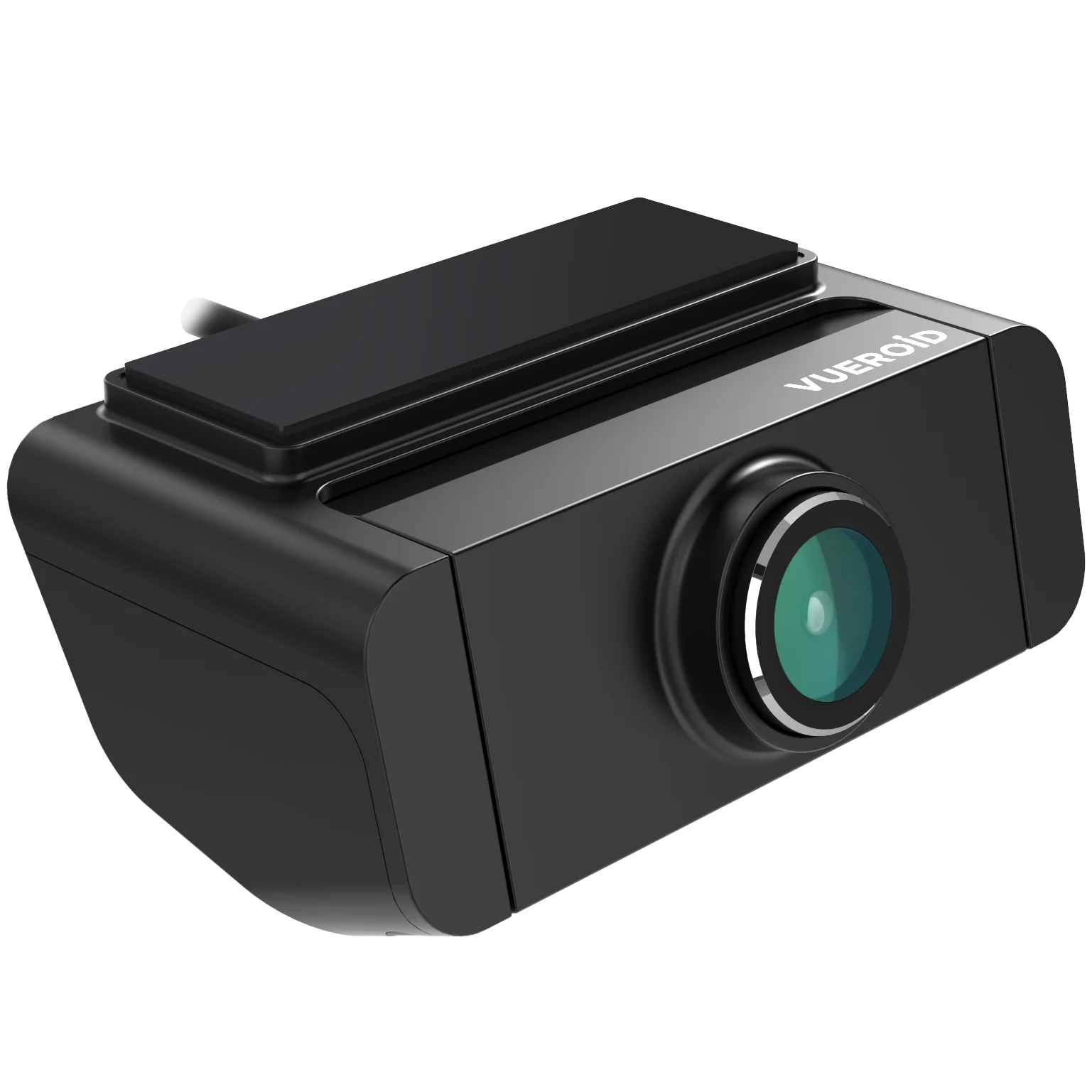

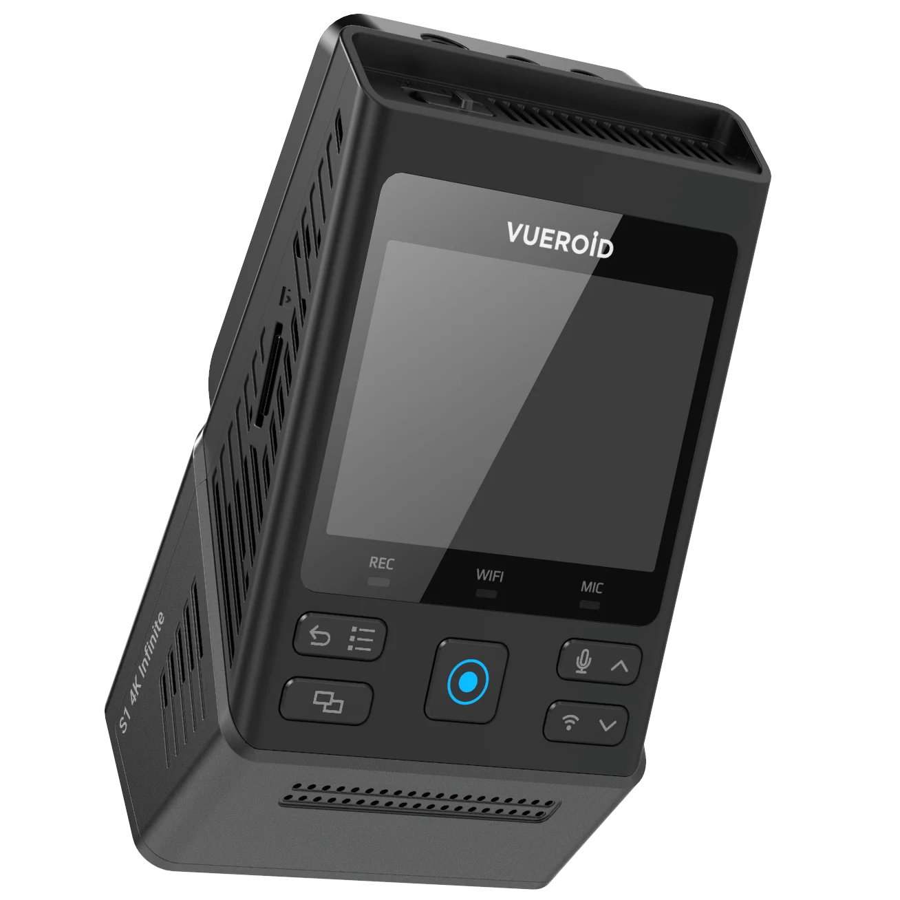

Well; the interior cam is a poor design over all. That blocky, square style will not work for me at all. With a permanently attached cable; the positive side is that attachment does eliminate at least one connector fail point. I will use the S1 as a single camera, if using the interior I will likely use a longer adapter cable and move the camera to the rear of the car, facing forward.
As for the On-Off slide switch, it might have a slightly higher fail rate than a pressure membrane type switch, but frankly, the camera will be hardwired so using the slide switch is something that most users will seldom use.
a permanently attached cable...
We call it a pigtail-type cable. It gives cons and pros. The pigtail cable will be 8~10cm long only. The extensive cable will be provided freely. Once you install it into the vehicle, I think there will be different opinions. 😉 I hope.

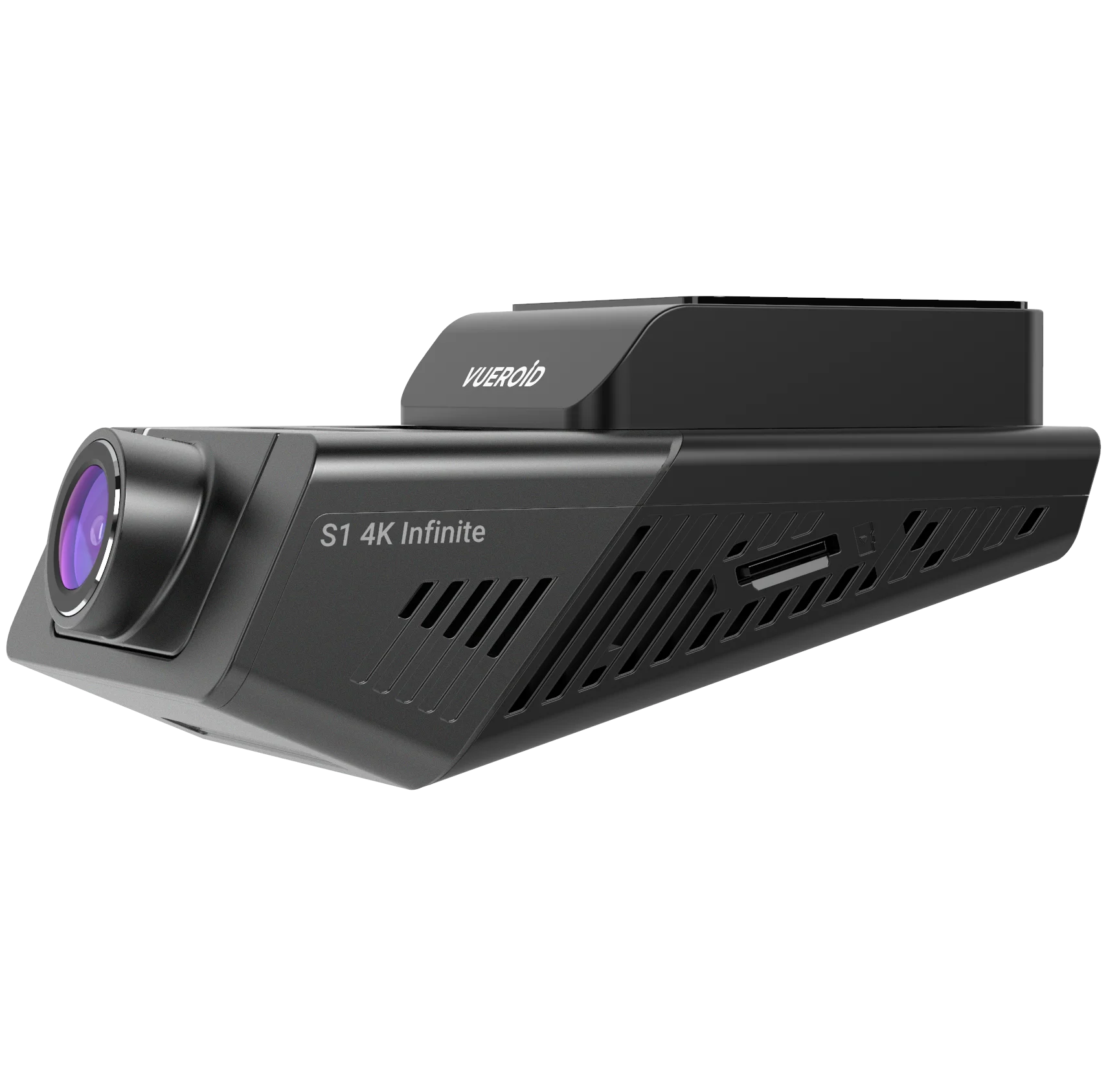

Q: It appears the S1 4K Infinite uses a “sliding switch” to power down the camera.
Can you replace the “sliding switch” with a button that requires a “long press” to power down the camera?
As we have discussed in person, I will be able to explain this after launch how it is useful...
Please give me some time till.
another solution is to replace the switch with a spring loaded slide switch the same size etc.
Similar to panzer idea and maintains original case design and easier to implement.
Should have a similar effect to prevent accidental switching.
Cost to re engine would be minimal.

Any plans to fix the cable design concern on the rear camera? Permanently attached cable is not ideal. If cable develops a short, the whole rear unit needs replaced versus just a cable?

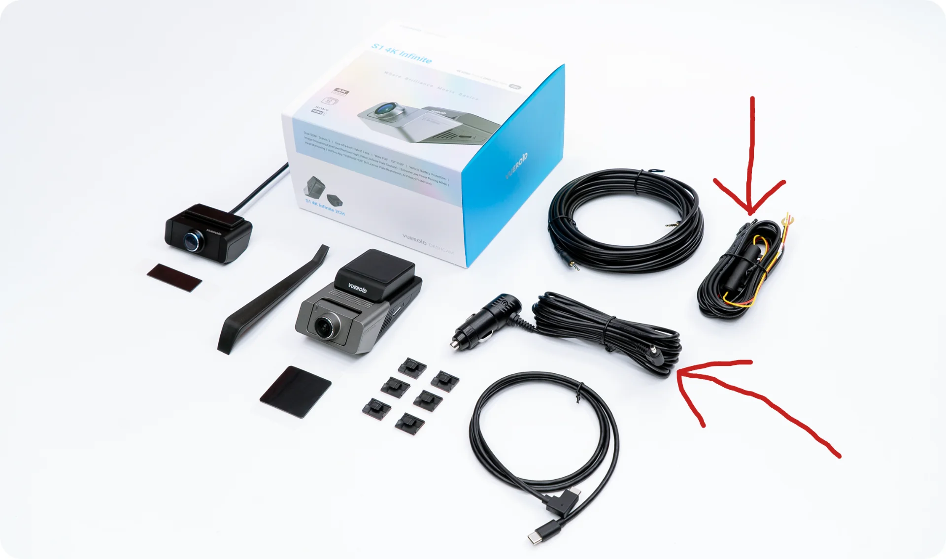

Now In regards to the dashcam i noticed in a video the other 2x camera ports are similar to a headphone Jack.
So does this mean the other cameras are analog units?
Also

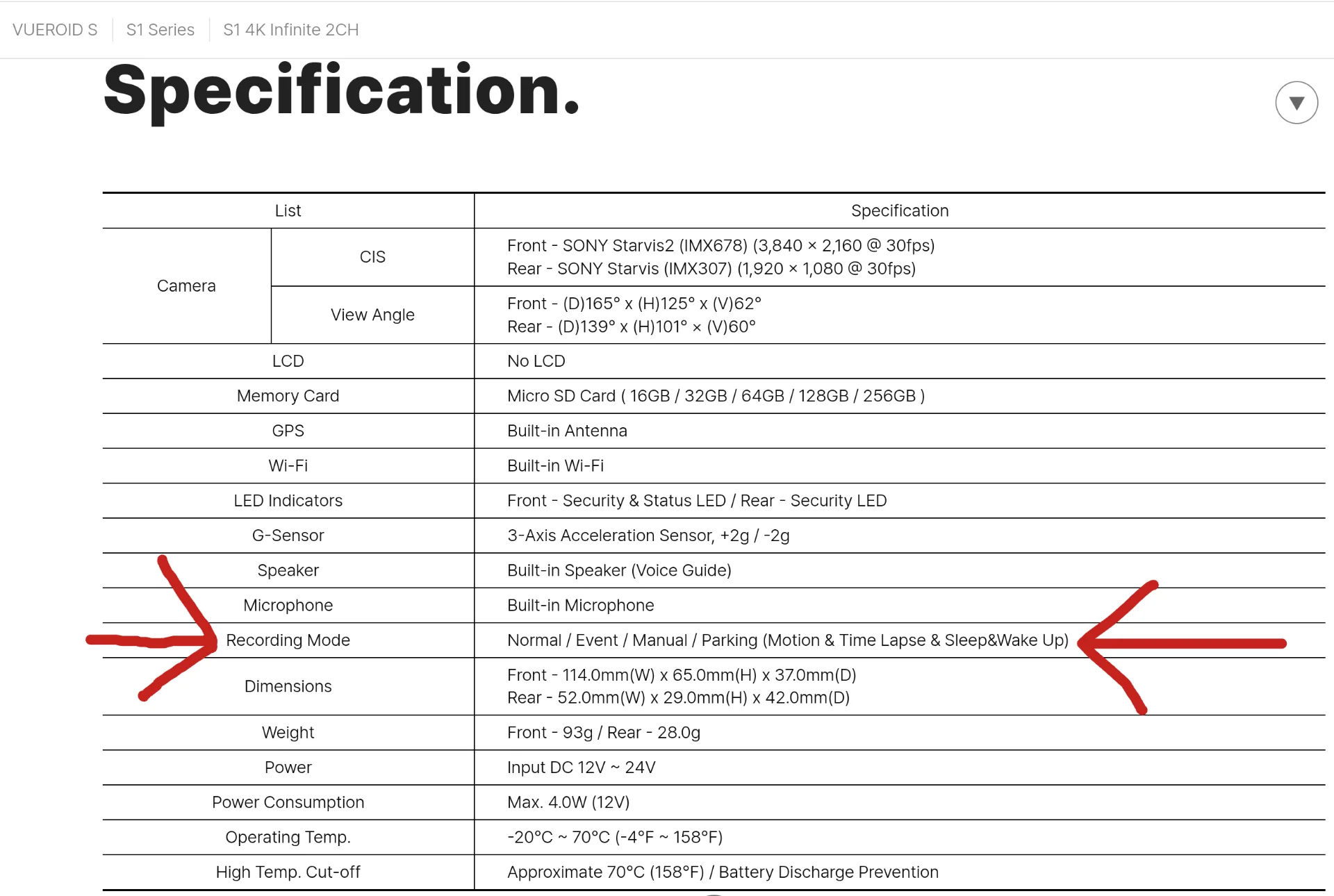

Also the power port is a 5.5mm port so moving away from usb-C ? I know many electric devices and even laptops use the same power connector eg Dell and most of my mains powered stuff.
Does that mean the dash cam doesn't have parking mode? Usually the usb port have a sensing wire. I hires they could use some kind of proprietary plug like Apple likes to do!

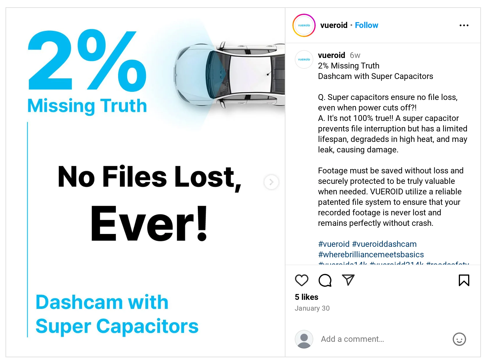

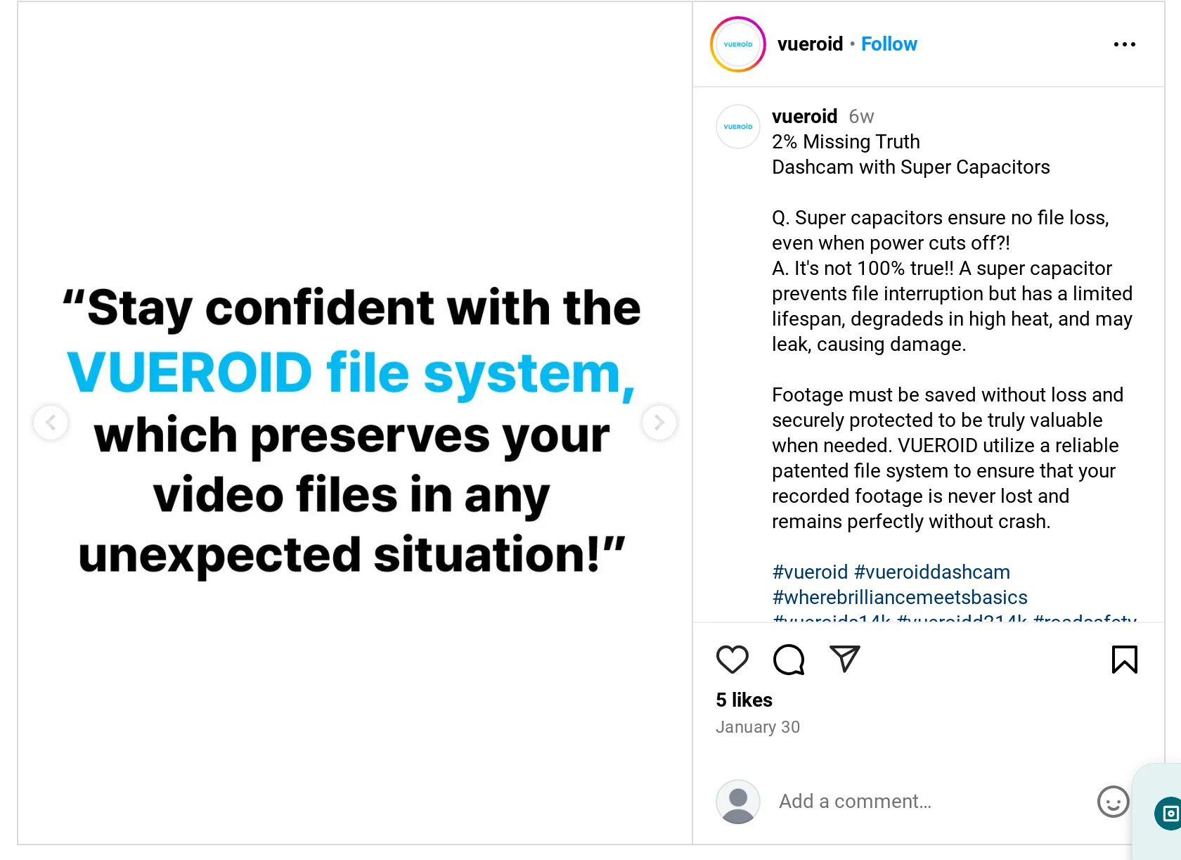

And lastly in the video @rcg530 posted of the sema trip he mentioned (Paraphrased and me being slack) that the unit doesn't have a capacitor and due to "the special file system and hidden files" doesn't corrupt the last file if the power is pulled.
That sounds like @Vueroid are using magic unless they're using the .ts or similar file system.

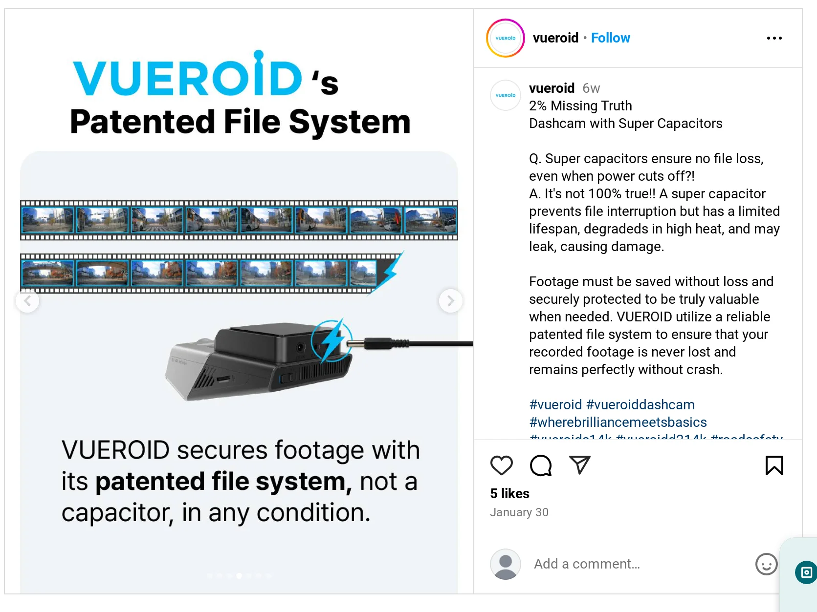

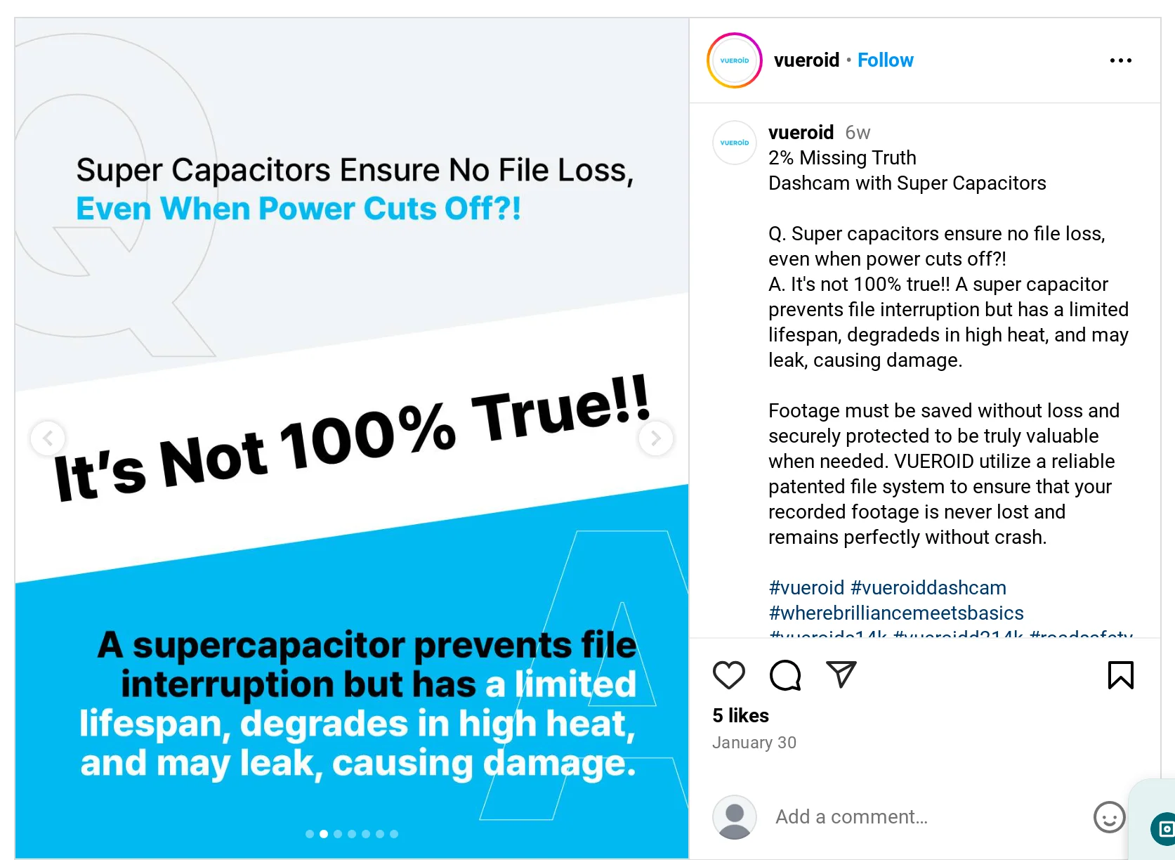

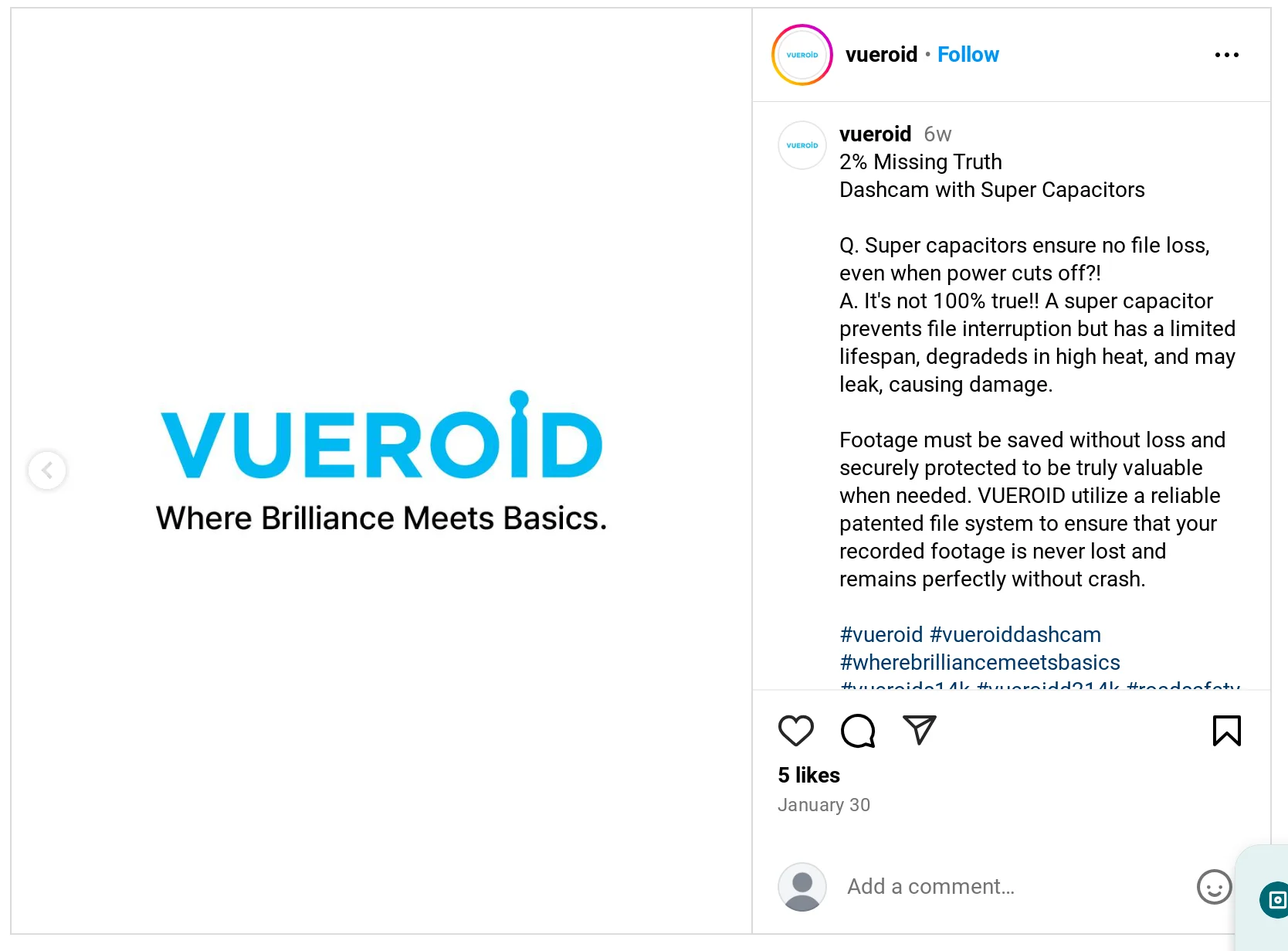

You'll have to check Instagram and what Vueroid have posted here in the forums as to the file system. I can't recall exactly what they said but they seem pretty confident.
Vueroid is rather tight lipped about the file system, other than a brief description of its presence. Likely a journaling file system of some type with possible file writes to NV memory and then files moved to the SDXC card would be my guess. On power up there would be a checksum test to validate file system and last file write and then file reconciliation if needed. A bit expensive process wise with multiple channels, but if designed properly from the start then it is doable. But that is all a guess, driven by my curiosity. 🙂
I think it is a lot simpler than that!
As I understand it, the actual file system is FAT32, or I assume they can use exFAT for larger cards.
The difference to normal dashcams is that they create all the files once, when formatting the disk or after changing the setup, and then never delete or create any more, just overwrite the existing files on looping, thus the FAT tables never get changed, and thus can't get corrupted.
The video files will get corrupted at their ends, but that can be easily fixed when the dashcam restarts, or when the files are played, as happens in Viofo dashcams (they also use Novatek processors).
Using .ts format would mean the files can be played without being fixed. Don't know if they do that or not, although the files are not .ts files, so probably not.
Compared to a super capacitor dashcam, they are going to lose around a second of video, the second just before impact. If they lose too much then they may loose the critical bit! Somebody needs to test how much is lost when they are available for review, I assume it is not too much, but we will find out...
