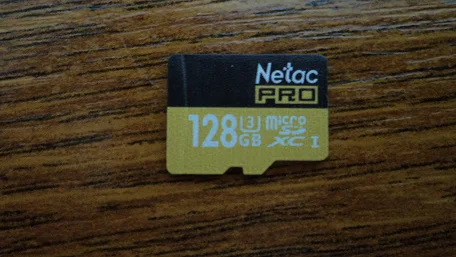

I've had good luck with Netac.
Me too and it works well with high bitrate. I use this:
