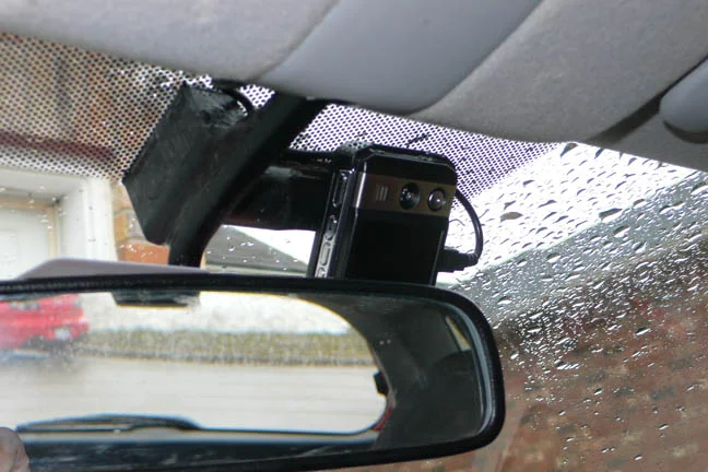

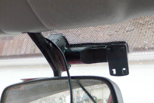

I made a homebrew mount to fit the F500LHD in front of the mirror. It consists of a rectangular block of plastic fixed between the mirror mount and the glass with silicone. A 1″ plastic rod has the attachment point from the stock mount and fits in a hole in the rectangle; after I got the angle right I bolted it in place in the rectangle and attached the rod to the windshield as well.
View from the driver's seat:

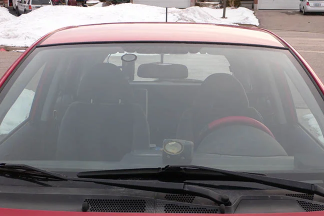

View from outside (will try to remember to replace this with a photo in better weather using a polarizer):

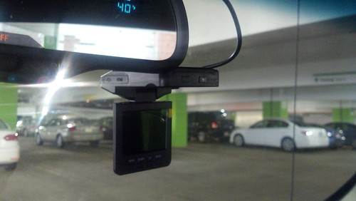

Ball mount for comparison:
