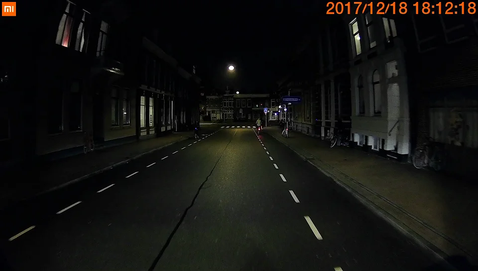

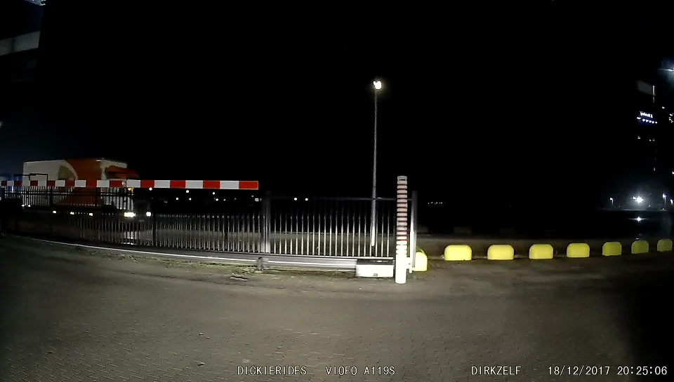

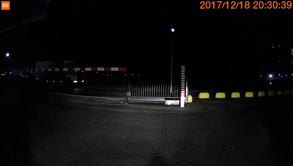

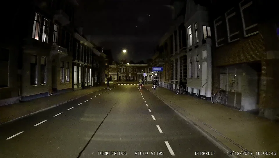

Nevertheless I also have the Viofo A119S (flash sale also.... I like discounts :D), and here are some comparisons to have a look at:
I can post many others, but you get the general idea, the Mijia shows darker images than the A119S, but I'm not so sure that's a bad thing. The Viofo shows more grain, and is twice the price. Nevertheless I like them both a lot, the A119S for it's low light peformance and 1080/60, the Mijia for the great price performance factor. I intended to use it for in-cabin recording so I'd have a proof of what I was doing during an incident, but it seems to use AVERAGE IMAGE light metering so there is no CENTER / SPOT light metering mode, so now the dark inside of the cabin causes the camera to blow up the whole image and the things that you can see through the windshield is way over exposed, and that is really a bummer.

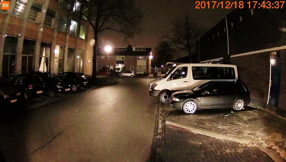

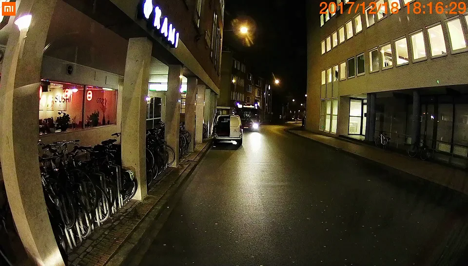

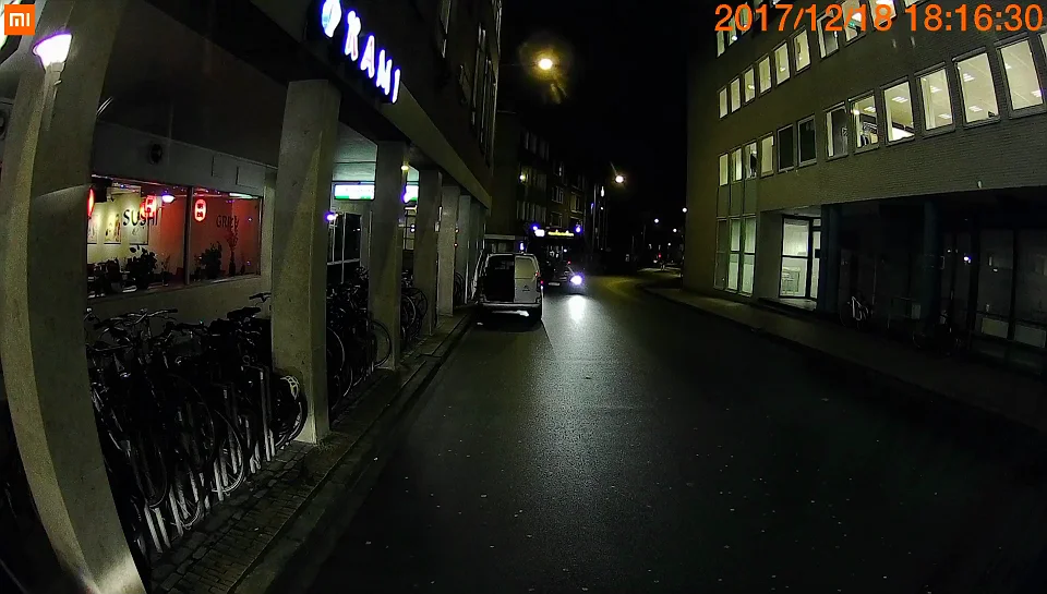

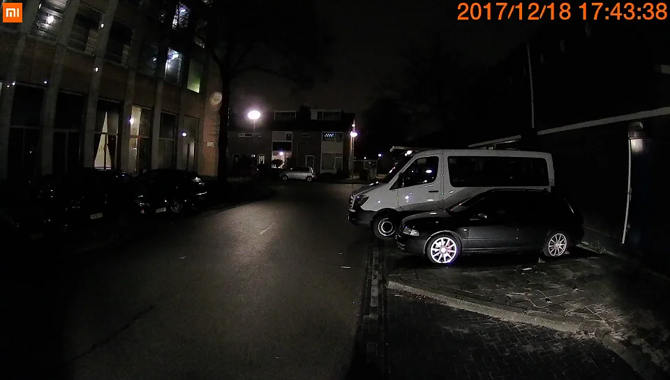

Another thing is, that I noticed in the live WiFi view the image is MUCH brighter than the actual recorded video, so I took a look into that, and guess what I found? The first second or so the image is very bright, bright like A119S, and after one or 1,5 second the image is being darkened by the firmware, maybe the developers can do something about the general brightness to it, or provide an exposure value setting that we can change ourselves.
Here's what I mean:
Start recording:
after one second:
2 more
Start recording:
After one second:
Now that just creaps my corn! Why not keep the nice and bright image recording??
