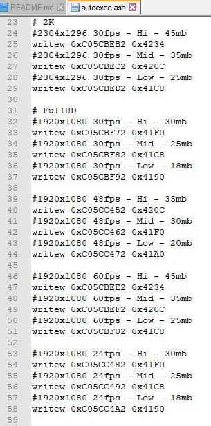

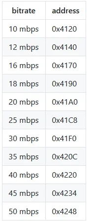

yes you can bump it up to 50mbps by using autoexec.ash script, just put the file on your sdcard. thanks to aristofun on github for the resolution addresses.
and you can get more quality recording by using the combination of YIMAX TUNE Script and 45mbps bitrate script. Thanks to nutsey for making an awesome script.

I tried this on my Z23L and it cuts the files into multiple little files 30-80 MB, first file has 40k bitrate and the other ones about 25-27k..
I copied the goprawn.conf and autoexec.ash on my sd root, it beeps 2 times with purple light, then once long with red light, then it turns on with blinking normal blue light..
Does the long beep with red LED mean something bad?
So I also tried just using the ash file modded for my needs.. 1080p60 from 40 to 50 mbit has this problem.. 35mbit record for 5-10 minutes in 35mbit and then drops to 25 mbit..
