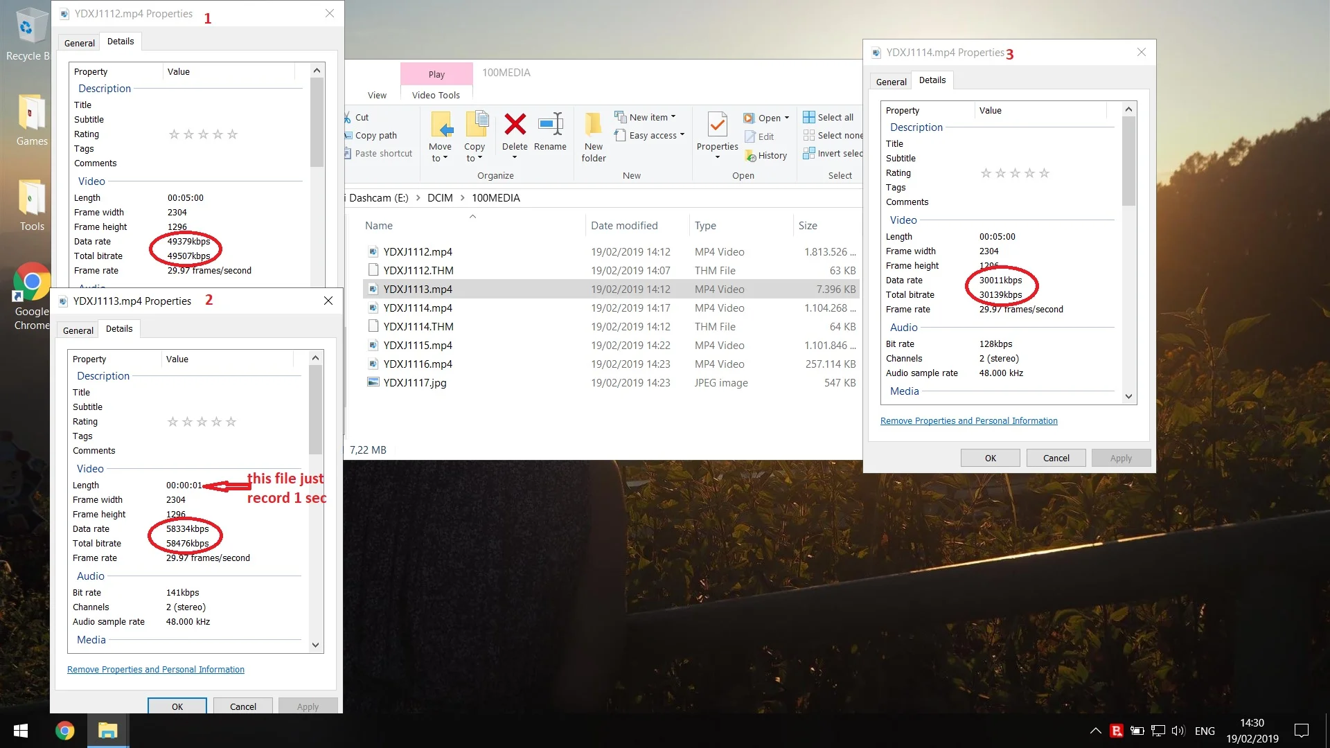

Hi, sorry for the late reply. No,nothing strange happen when installing, but something happen when recording....
I find that after 3-4 minute the file split, from 50M bitrate it seems to reset itself to 30M-35M until the last file. I don't know if is the autorec file or the firmware itself, not try it yet to confirm which one is the cause.
Update
tried with and without autorec file the same result.... you can see in the picture what I mean
Update
tried with and without autorec file the same result.... you can see in the picture what I meanView attachment 44789
