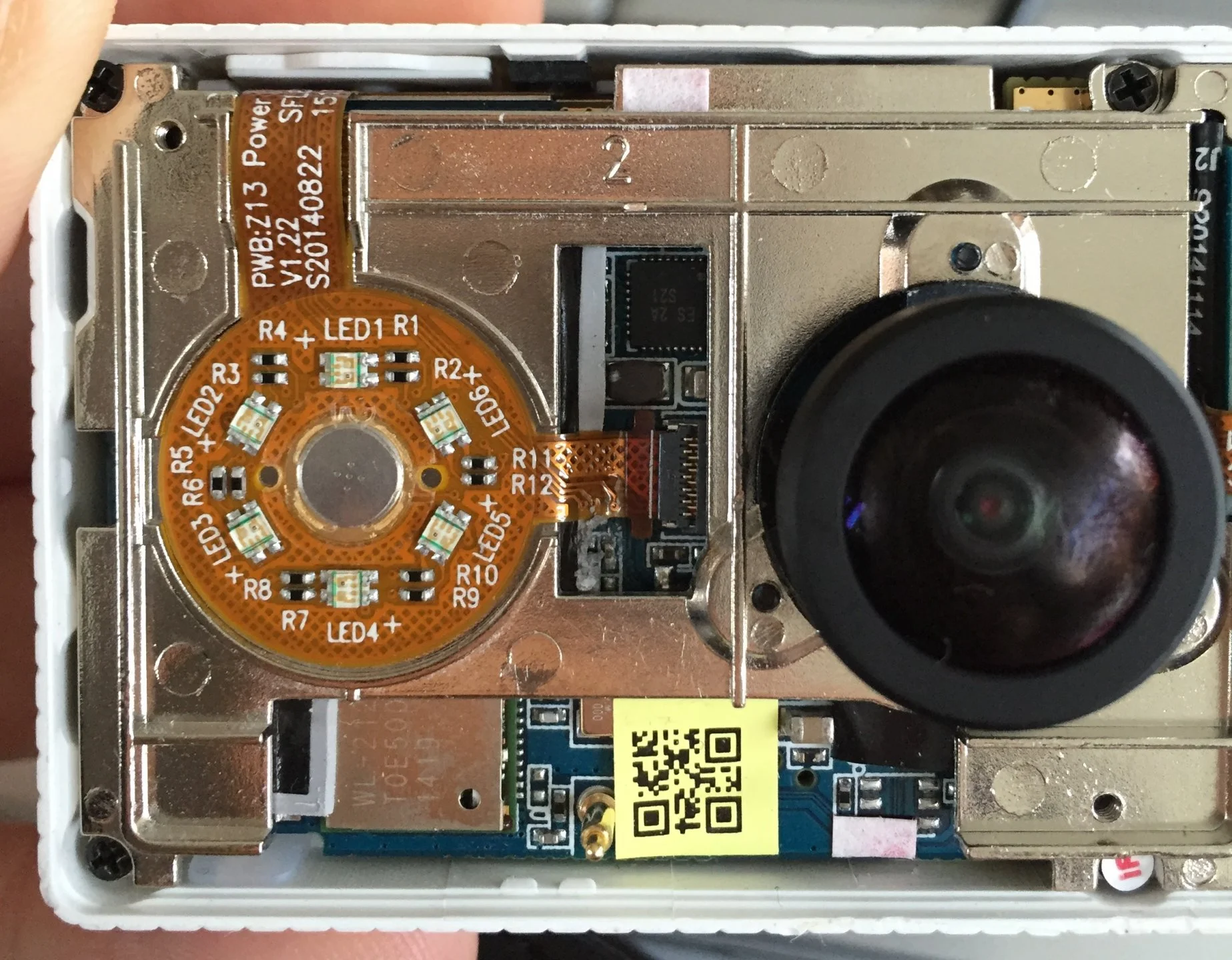

Who helps me short circuiting the Yi? I am trying for over 2 hours now, but nothing works. I tried with paperclip, with pincet and with wire in several positions, but no result! No Windows sound, no recognition of USB.
Maybe someone can post a detailed video? I am really frustrated by now 😑
I think I am damaging the print by now. Please indicate where I need to put the paperclip exactly and what to do exactly in what order... The pictures in this thread and in the PPT are not helping me.
And is it necessary to have the battery in the Yi? And do I have to push the power button for a long time or just short?

Update:
Still no result after almost 4 hours of trying. It seems not to be possible to short circuit the so my laptop will recognize the Yi as USB-device
- All three red LED's are burning when I push the power button
- The red circle is also burning when I have inserted the battery and connected the Yi with my laptop
- When I try to short circuit, I put the points of the paperclip at both points as shown in de PPT. After that, I push the powerbutton while holding the paperclip at its points. Nothing happens, only the 3 red LED's will flash on.
So, first of all, should I do this with battery inside the camera? (I already tried both - with battery in and out)
