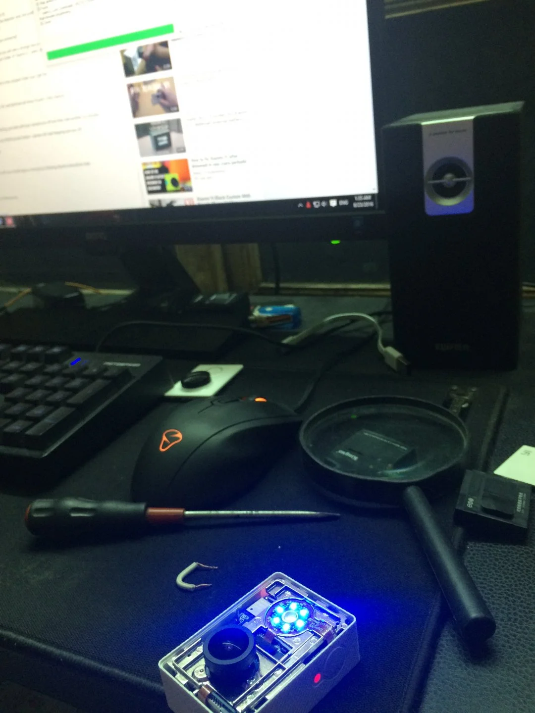

I cant unbrick my cam 3 month , i think you cant to because you S/N 23L6 not 23L5 maybe we need another elf...WELDONE MY FRIEND. THX FOR RESPONDING.
whats ever you must flash unbrick first with the (elf file) than you update the (bin file) mathing your SN put in SDCARD.I cant unbrick my cam 3 month , i think you cant to because you S/N 23L6 not 23L5 maybe we need another elf...
when i try update after flashing elf file i have only three red lights .... update doesen't start .... trying 3 sd cardwhats ever you must flash unbrick first with the (elf file) than you update the (bin file) mathing your SN put in SDCARD.
do you make the test point short circuit?when i try update after flashing elf file i have only three red lights .... update doesen't start .... trying 3 sd card
ofcource , then i download elf file - wait 3 minute after "Done" -cam turn off - then i press power button but upgrade doesent start only 3 red lightdo you make the test point short circuit?
maybe something wrong with your camera boardofcource , then i download elf file - wait 3 minute after "Done" -cam turn off - then i press power button but upgrade doesent start only 3 red light
once i dont now how cam star update , then turn off , when i see progrees in sd card he was only 44 %? then i cant start oricces update again. when you upgrade you copy 2 files on sd yifirmware.bin and autoexec.ash ? or only firmware.bin?maybe something wrong with your camera board
for the original firmware from xiaomi website is rename to firmware.bin - for developer is rename to yifirmware.bin and put autoexec.ash to SDcard 16-32 gb fat32 formatedonce i dont now how cam star update , then turn off , when i see progrees in sd card he was only 44 %? then i cant start oricces update again. when you upgrade you copy 2 files on sd yifirmware.bin and autoexec.ash ? or only firmware.bin?
before download elf you instrt sd and battery - You use elf - then after download - elf you wait 3 minute - then press power button firmware start update and finish ? camera start work normally?for the original firmware from xiaomi website is rename to firmware.bin - for developer is rename to yifirmware.bin and put autoexec.ash to SDcard 16-32 gb fat32 formated
but my cam beep before "done" message its nomall? then i have "done" message and and then cam turn off all lights and nothing happen ..... when cam turn off i need to connect charger? and power on after 15 minute?yes, wait for power ring blue light glos 3times and 3 beeping auto off. than wait for 15 min and power on the cam with usb charger not by pc or laptop.
yes, you do it for 5-10 times and make relexs for coffee- or the camera motherboard is totaly dead, i am sorry for this!!! your cam cannot be recovery you must change the board.but my cam beep before "done" message its nomall? then i have "done" message and and then cam turn off all lights and nothing happen ..... when cam turn off i need to connect charger? and power on after 15 minute?
the new yi action sport camera came with some usb port protection and cannot be to recovery and bring it to void warranties to your shop buy before.yes, you do it for 5-10 times and make relexs for coffee- or the camera motherboard is totaly dead, i am sorry for this!!! your cam cannot be recovery you must change the board.
I win this cam and no have warranty ) I use cam only month and they dead ? then i try recover it ....the new yi action sport camera came with some usb port protection and cannot be to recovery and bring it to void warranties to your shop buy before.
Ok!!! please try with this 2 file - YDXJv22_1.2.13_build-20150906141456_b1049_i841_s1120.elf and YDXJv22L_1.2.13_build-20150906142851_b1049_i841_s1120.elf -> download from google drive. Than you flash them at same process before. The SDcard is 16-32GB class 10 FAT32 formated. Erase the SDcard with USB Image Tool.exe and format agains with windows quick format to FAT32 than put the firmware.bin only to SDcard.I win this cam and no have warranty ) I use cam only month and they dead ? then i try recover it ....
Ok I'm trying morning, in Minsk 1:50 a.m now)Ok!!! please try with this 2 file - YDXJv22_1.2.13_build-20150906142851_b1049_i841_s1120.elf and YDXJv22L_1.2.13_build-20150906142851_b1049_i841_s1120.elf -> download from google drive. Than you flash them at same process before. The SDcard is 16-32GB class 10 FAT32 formated. Erase the SDcard with USB Image Tool.exe and format agains with windows quick format to FAT32 than put the firmware.bin only to SDcard.
Welcome. have a nice day. contact me after you done.Ok I'm trying morning, in Minsk 1:50 a.m now)
Hey can help me?Welcome. have a nice day. contact me after you done.
