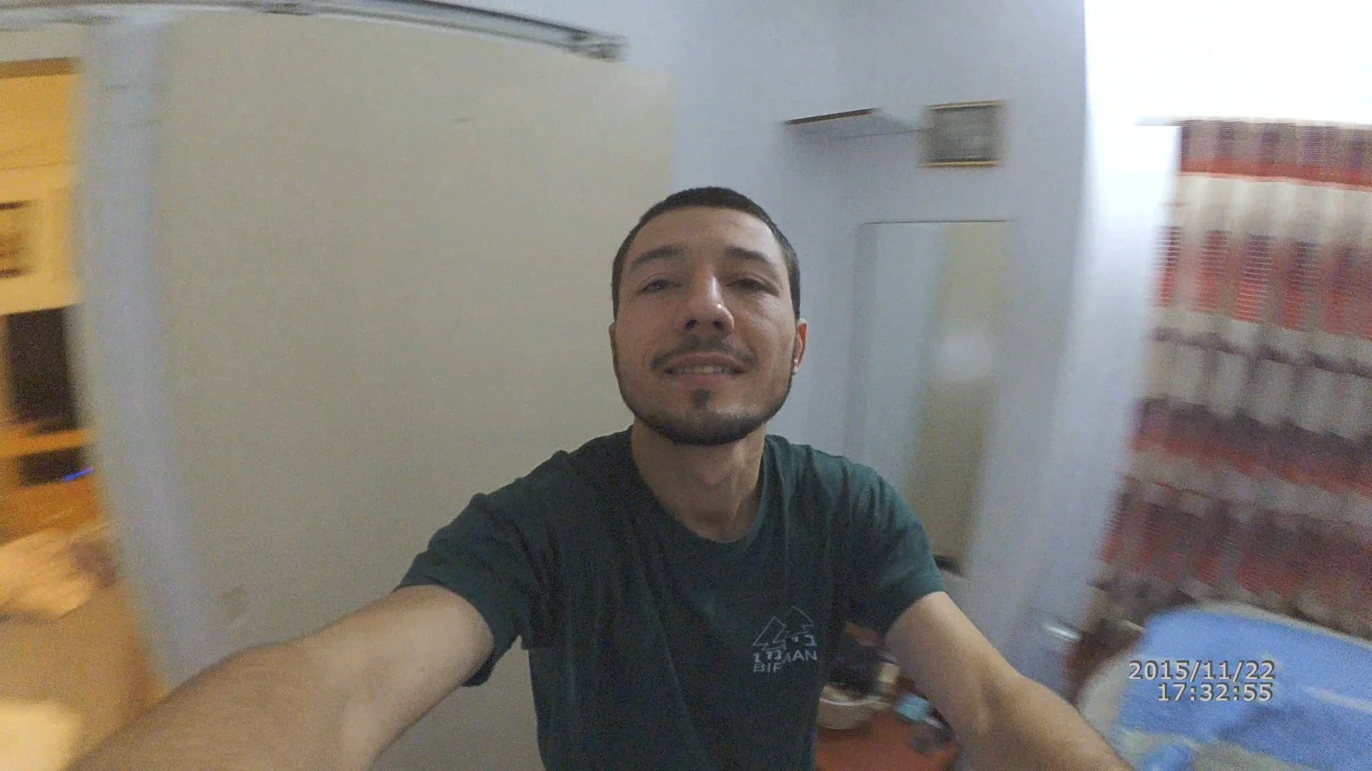

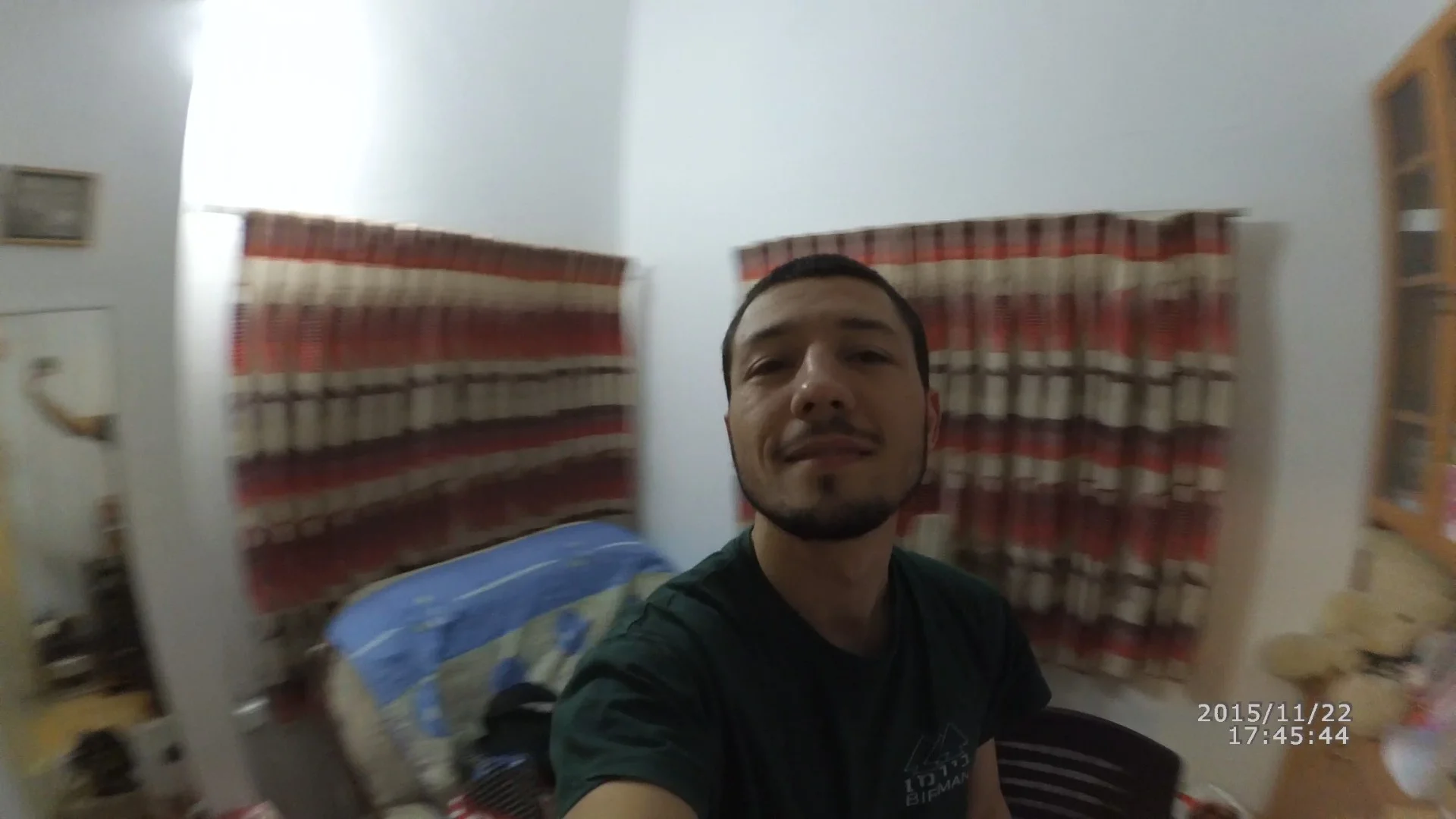

the script do give 35 bitrte, but the image quality is bad. First picture is without script and the other is with.
They are both screen capture from the video.
