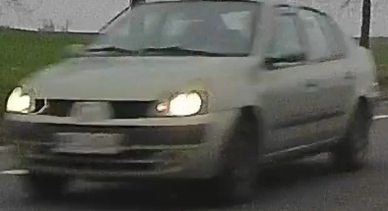

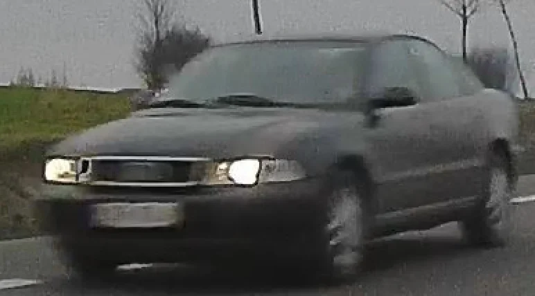

Ok, some people are complaining about picture quality. Static pictures are OK (both cars are fast moving in one direction): foo.png
but when you miss something with higher speed, then quality is very poor: x.png
Original movie: http://catshare.net/CpEzO9MHCDIY0KoS
There is no way to read license plate from opposite lane cars.
