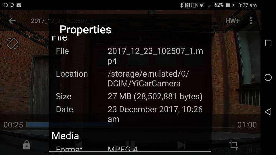

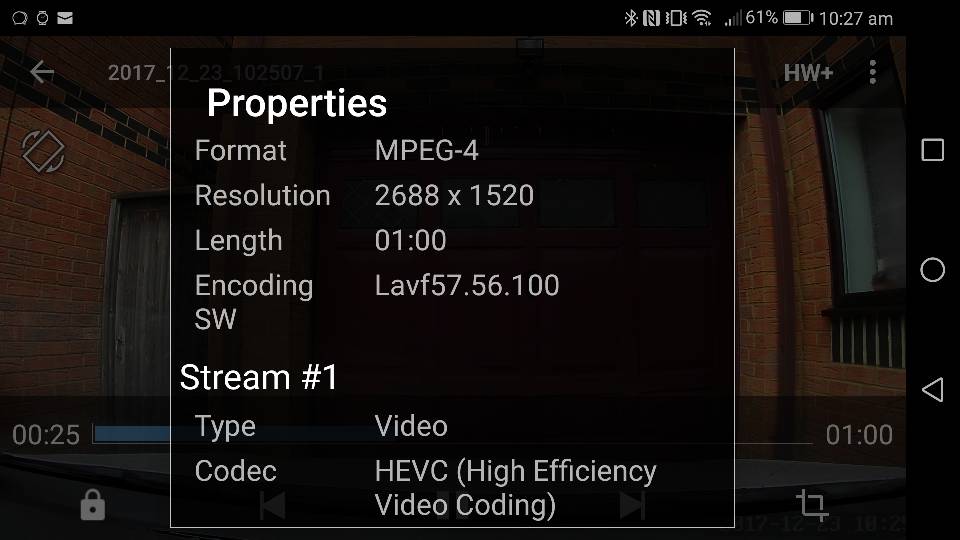

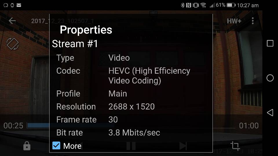

As you can see from the screen shots of the video it is only recording at 3.8mb/s..... Giving a file size of just 27mb for one minute...
Maybe because I'm not moving... I'll download a video clip from my drive to work later.... See what that shows and how it looks..

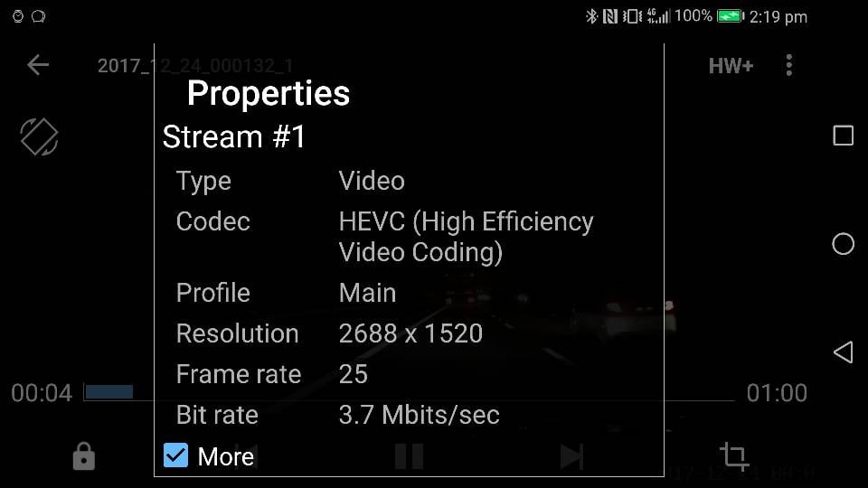

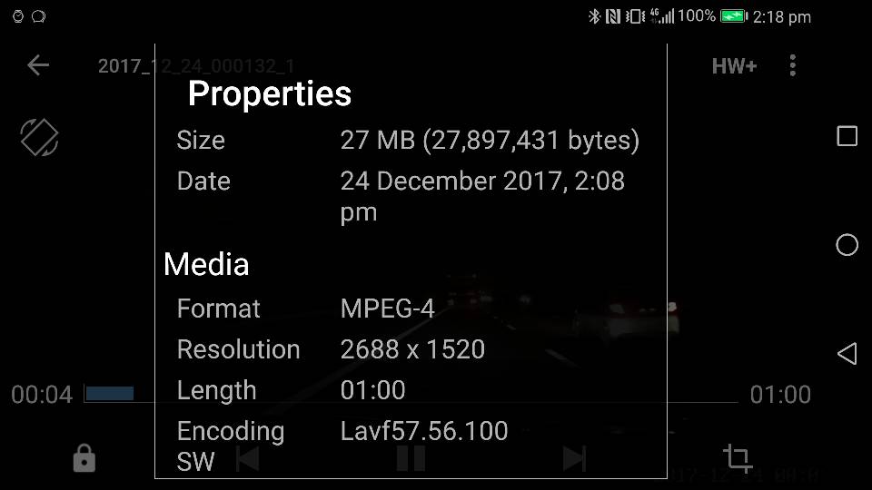

One thing I be noticed is that when h.265 codec is being used the camera records using VBR. I have 2 night time clips that are 27 and 5.9mb in size..... Both using different bit rates..
Two night time clip properties below.
Just proving that in different lighting conditions the Camera chooses different bit rates..
This doesn't happen when using h.264 codec.... It's always using 21-22mb/s producing 160-180mb file sizes....

I notice the frame rate is different in the above videos. One is 30fps and the other is 25. Didn't even know that was an option. Also was the 800kb/s one stationary? The filesize is tiny. Glad to see such a reduction in filesize. Will save writes to the SD card and hold so much more video.

No there's no option for frame rate.
I think it's all down to the quality of the camera hardware and software. I mean I only paid £61 for it. There's cameras out there that cost 4 times that.
Maybe the software isn't up to controlling a constant framerate or bit rate properly. I don't know.
