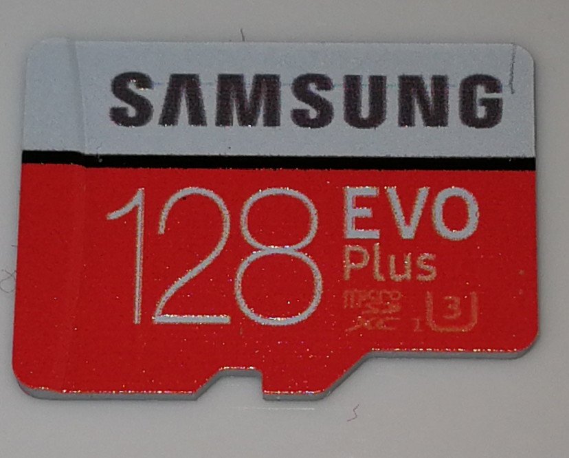

Update: After playing around with different micro Sd Cards, I have found that using a better card than the one supplied helps tremendously with the quality, smoothness, of the recorded files at 1520p.....
This is what I am using now....
