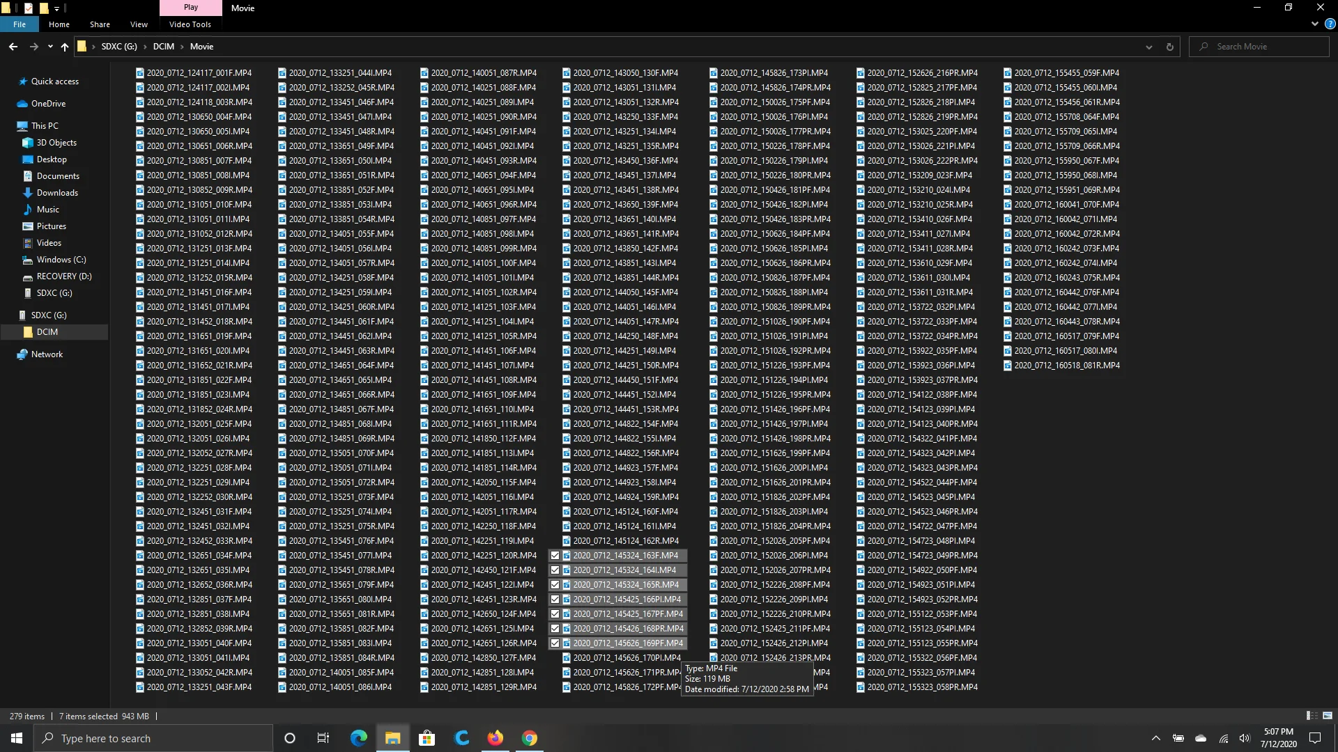

Well... now I'm confused with my test.
I'm checking the footage to see wow much of the rear and interior footage got cut of and all is there! Not a missing bit!!!
I guess what happened is that I used the far right key to awake the screen and that changed the feed view. I thought nothing would change if you only pressed once while the screen was off and the change would take effect if you pressed again once the screen was on. 🤔
I don't wan to think there is a success yet. I need to double check all my footage to confirm that all is there, even though I already did.
There are only two hiccups. In the recording sequence I found Only a front camera recording missing and then an interior recording missing. That doesn't seem heat related to me

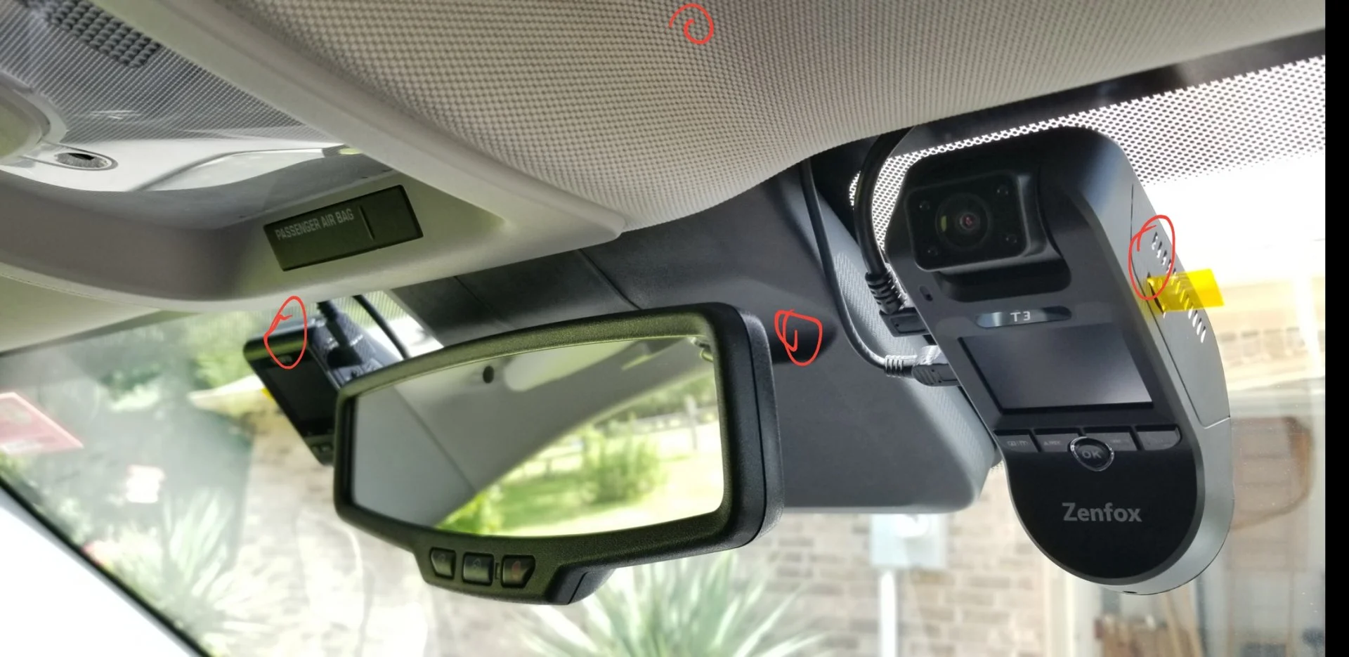

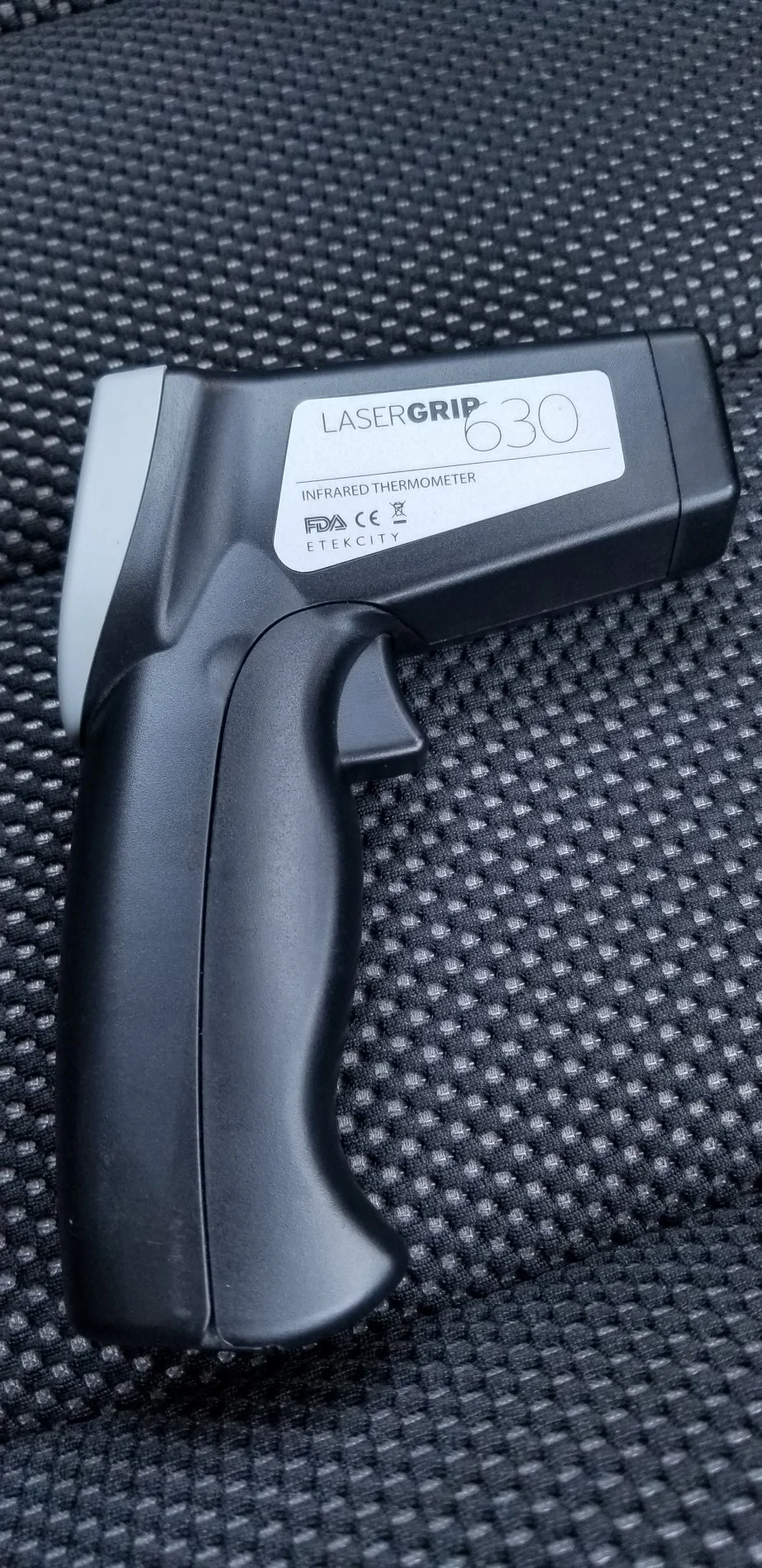

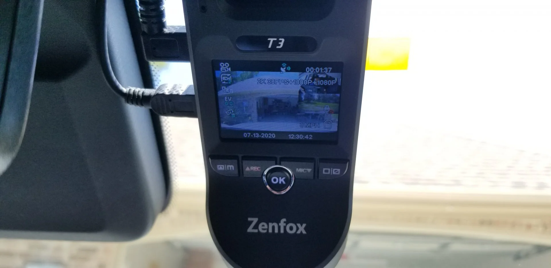

It's been a hour since the test initiated, I went to check on the cameras and take some temperature measurements. Ambient temperature 93f, Zenfox body @156F and all chanels still recording, roof liner 112f and mirror panel 140f.

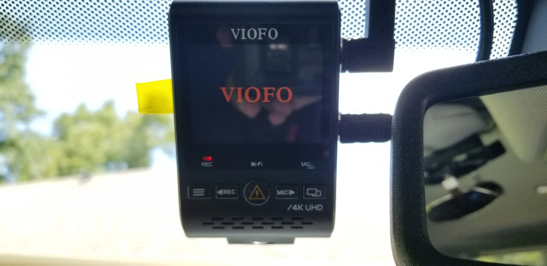

Viofo already failed the test as it is displaying viofo logo in the screen and stuck in that mode with a rapid red light blinking. Viofo temperature measured 187f. Both set in low bitrate parking mode.
This are the points I'm using to measure temperatures. In both of the cameras there is the hottest areas I could find in their shell.

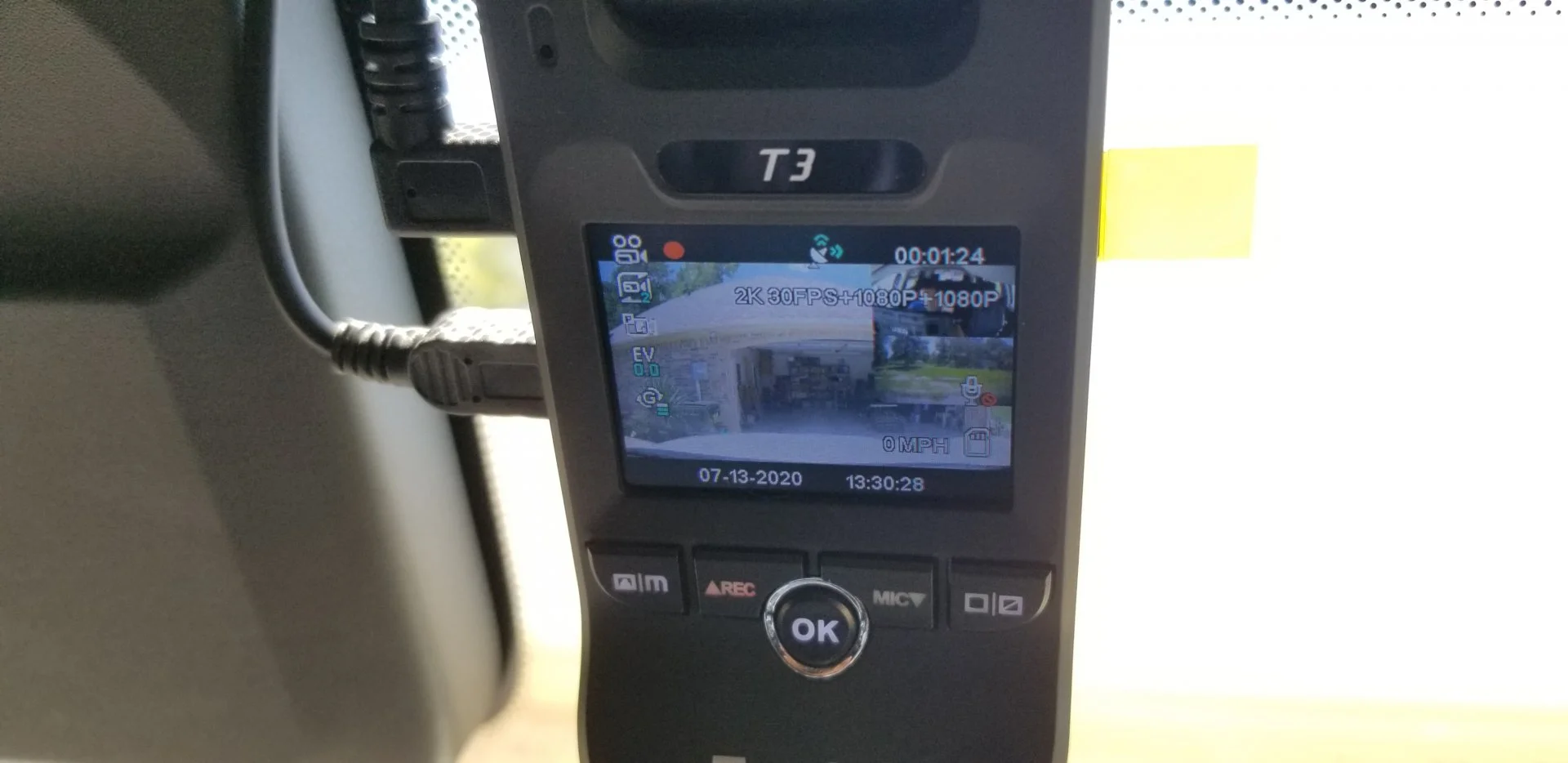

Two hours later (1:30pm), ambient temp is 95f and all channels continue recording, roof liner 122f, mirror panel 140f.
Viofo is still stuck on Viofo logo and it's temperature is 165f
Viofo is still stuck on Viofo logo and it's temperature is 165fView attachment 52625
Why not reboot the A129? If it reached it's max operating temp, it would/should shutdown. Since it's clearly frozen, maybe you have just experienced the parking mode bug.
