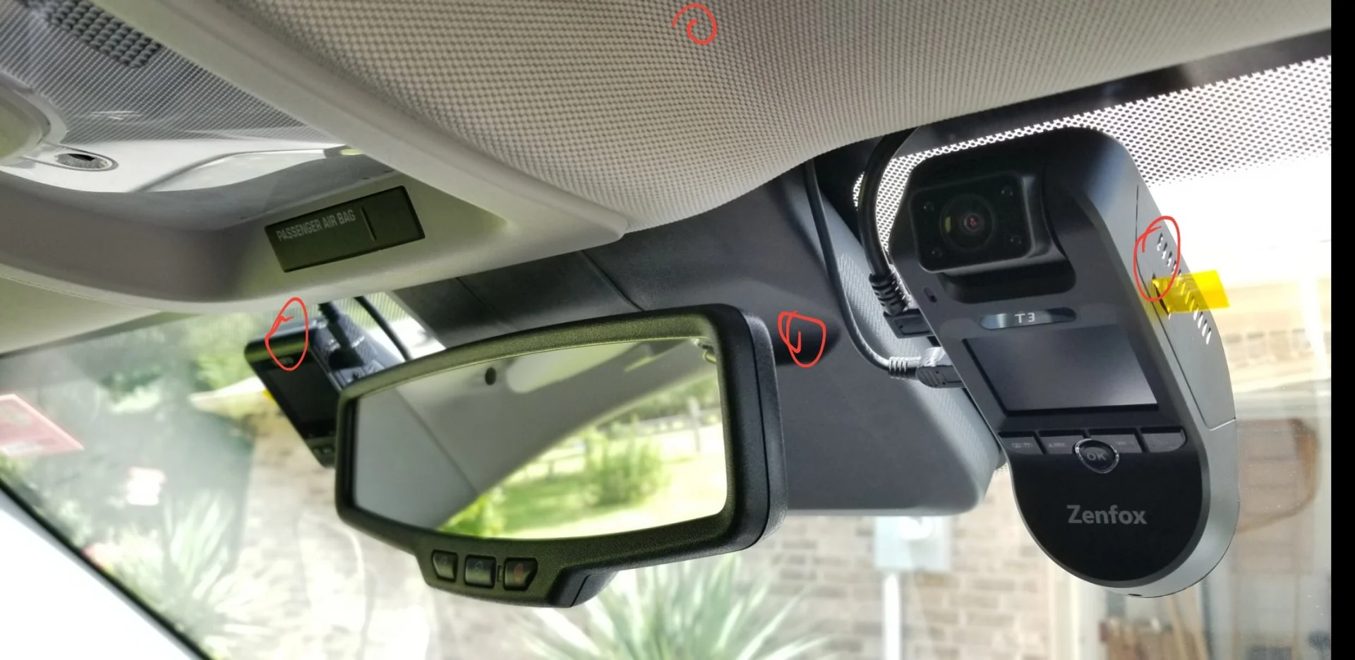

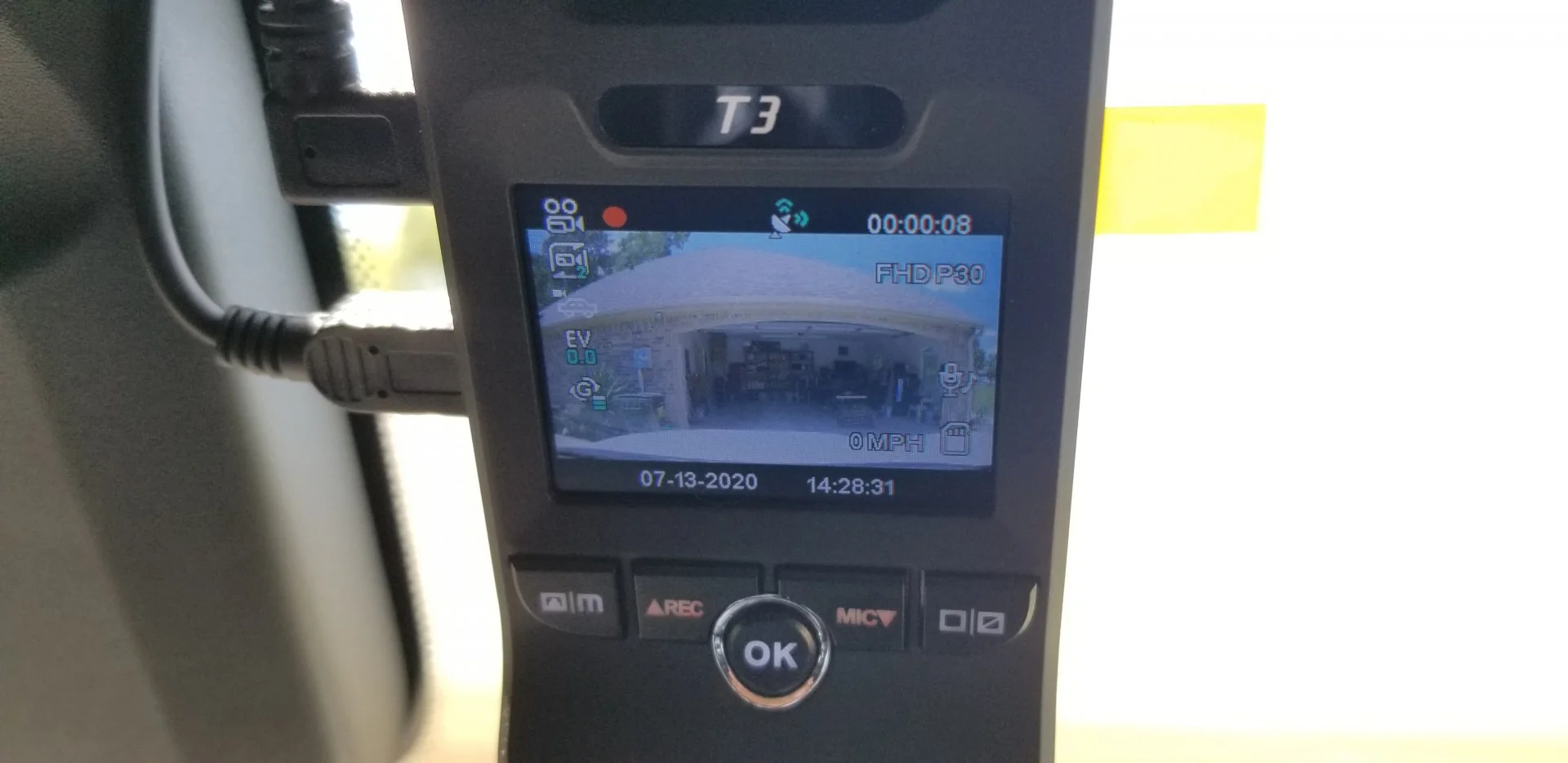

3 hours later. Ambient temp 97f and zenfox finally gave up rear and interior channel but front still recording. shell temperature is 170f, mirror panel 160f and roof liner 133f.
Viofo in the other hand, I restarted but failed again, this time with a black screen, red light flashing rapidly and not responsive to any button. Viofos temperature is 185f20200713_142832.jpg

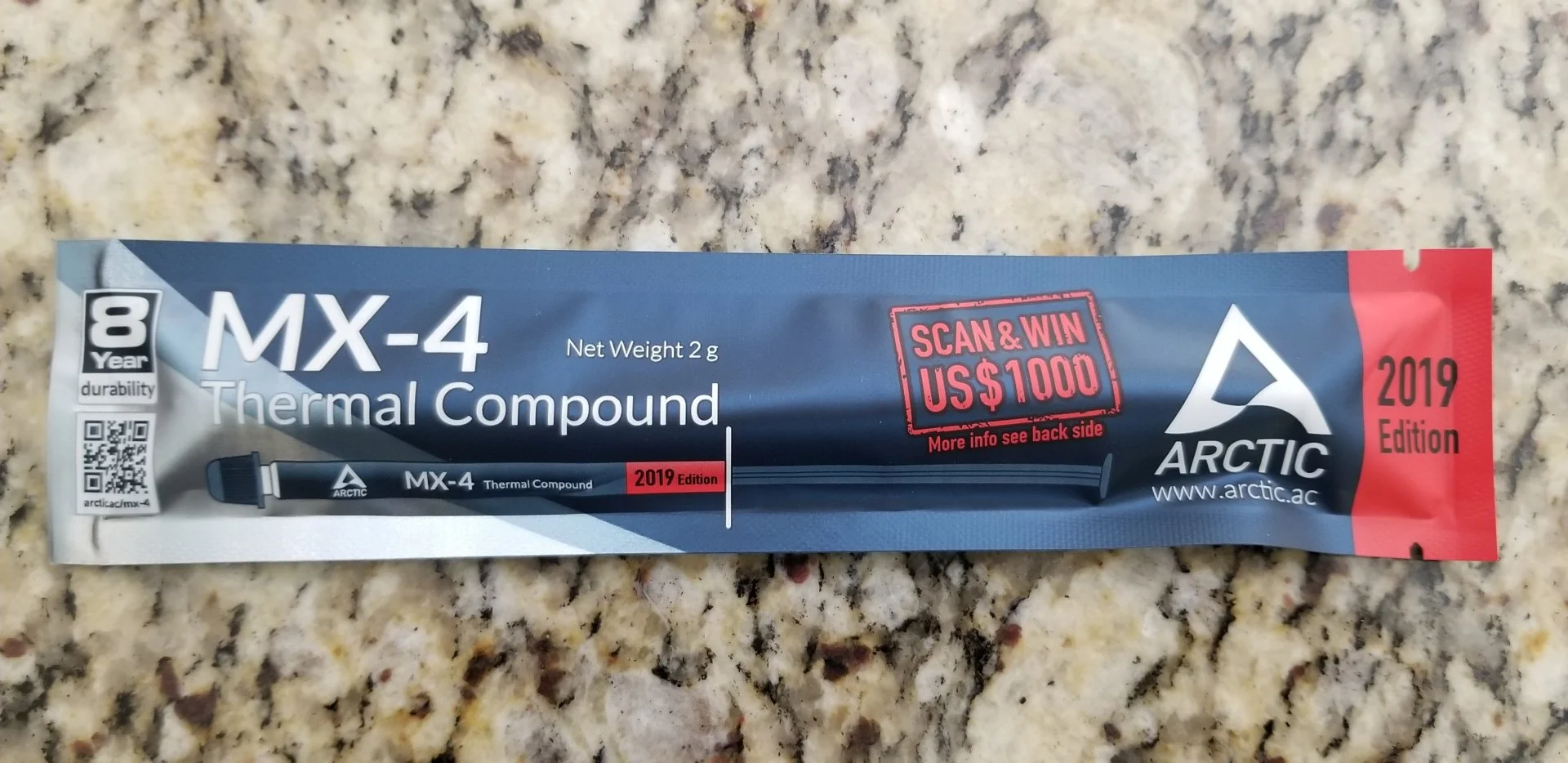

FYI: My MX-4 paste showed up yesterday. Copper Shims come tomorrow. So I can try and see what solution I can devise, too.
this time both in low bitrate parking mode. Yesterdays test was done in driving mode at max bitrate on both units, and guess what, I was amazed about the results. Clearly Zenfox is outperforming Viofo at handling temperatures now after the mod.

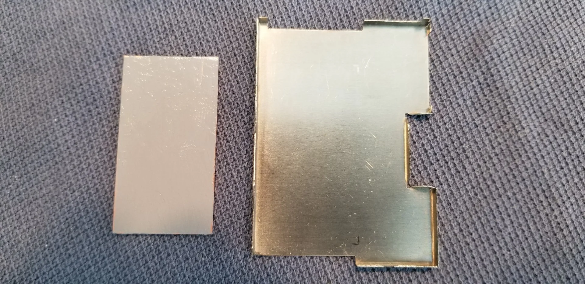

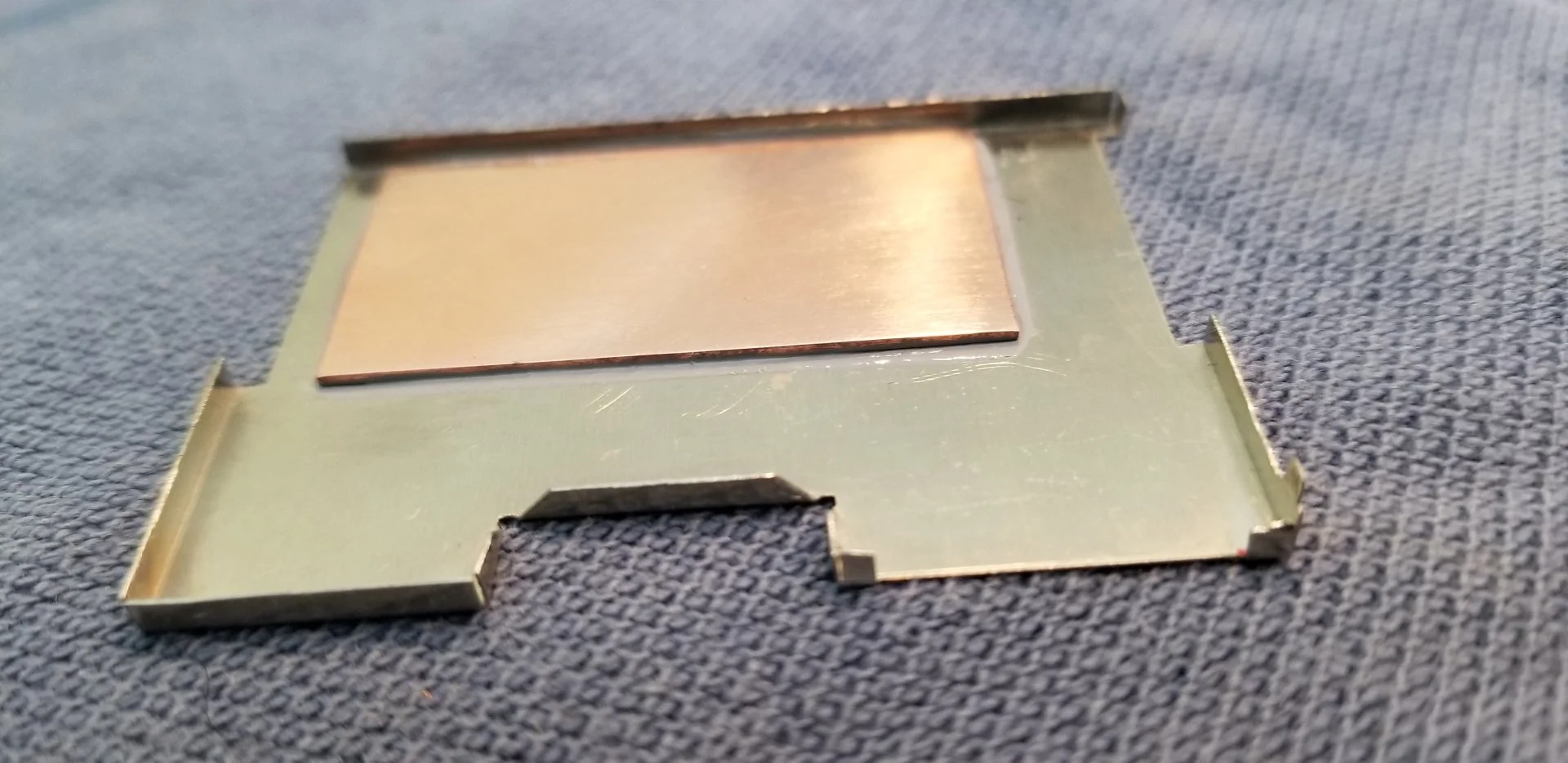

1. How did you adhere the Copper Plate to the EMI shield? Epoxy? Or didn't bother to adhere and just used the thermal paste?
2. How did you adhere the Heatsink to the EMI shield? Epoxy?
If Epoxy on #1 or #2 what kind? Gorilla Glue?

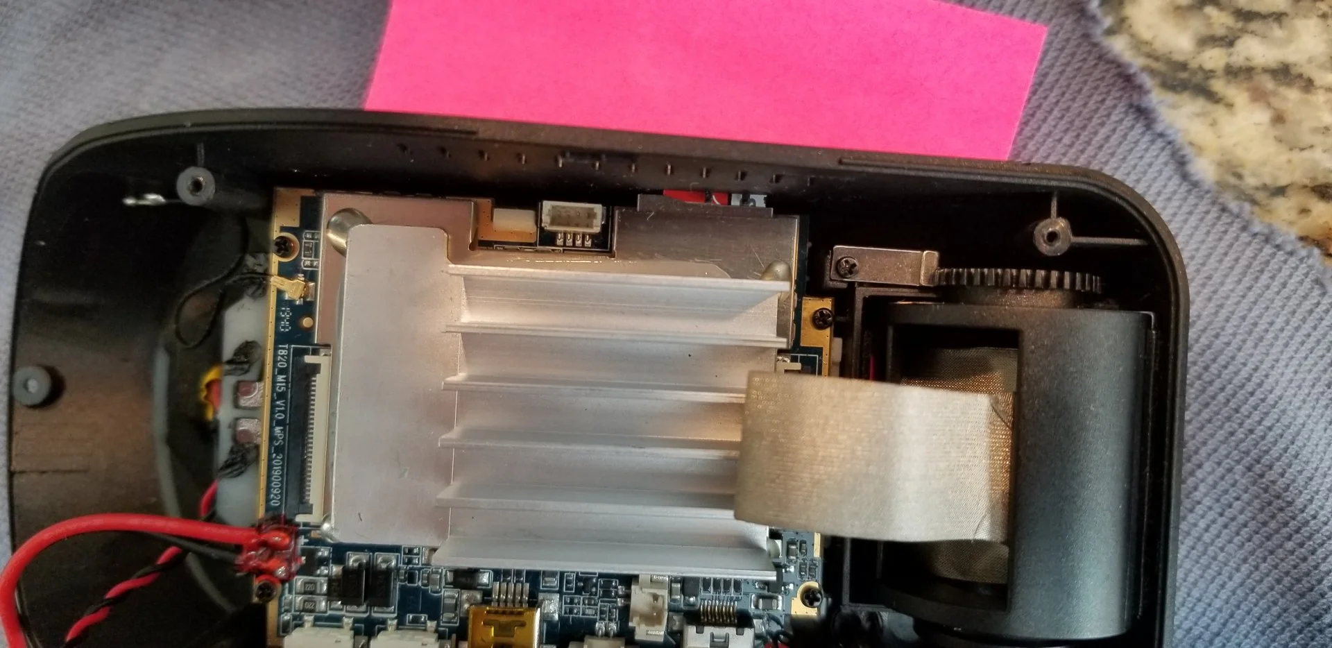

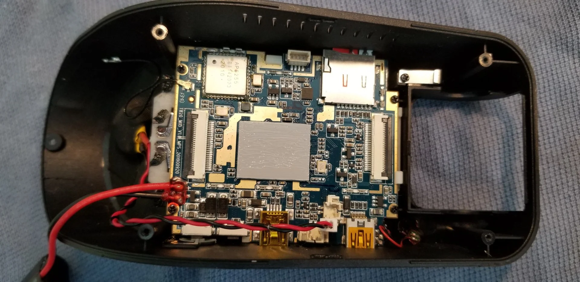

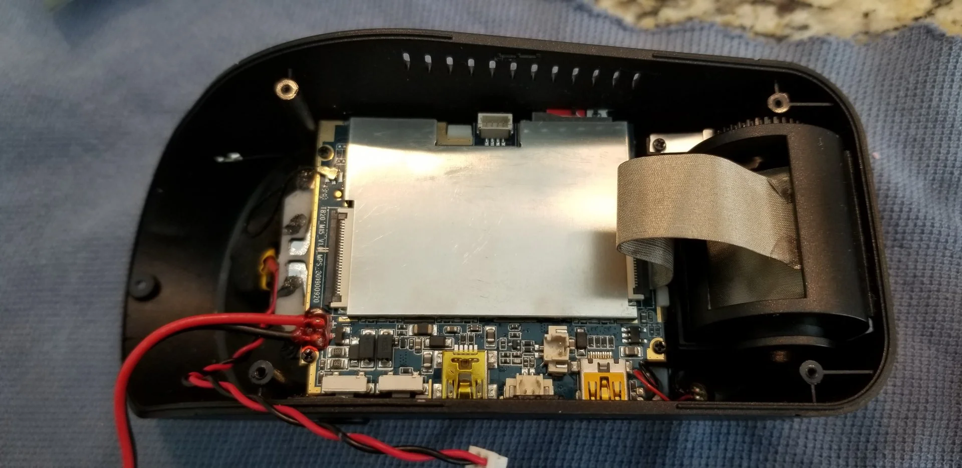

Here are the pics of the procedure 20200711_151939.jpg20200711_155805.jpg20200711_161551.jpg20200711_160721.jpg20200711_164612.jpg20200711_165923.jpg
So you just used the the thermal paste for Heatsink to EMI and EMI to Copper Plate? You didn't epoxy the Heatsink to the EMI Shield or Copper Plate to EMI correct?
Please let me know about whether you used epoxy or just the thermal paste. As I want to know how to best approach this situation. Thanks
I did not epoxy the copper to the emi shield as I found that wasn't necessary, but I did epoxy the corners of the heat sink to the emi shield as you can see in the picture. I used the clear epoxy for general use. Didn't want to use the stronger made to bond metals in case I needed to remove it later, it would make it a bit easier.
What brand or type of epoxy did you use on the Heatsink to EMI if you can please share. Thanks.

Apply the paste to only one side of the copper plate and attach it to the emi shield, the apply paste to the top of the soc surface. remember to align the copper correctly before you close the lid. I marked my lid to ensure proper alignment.

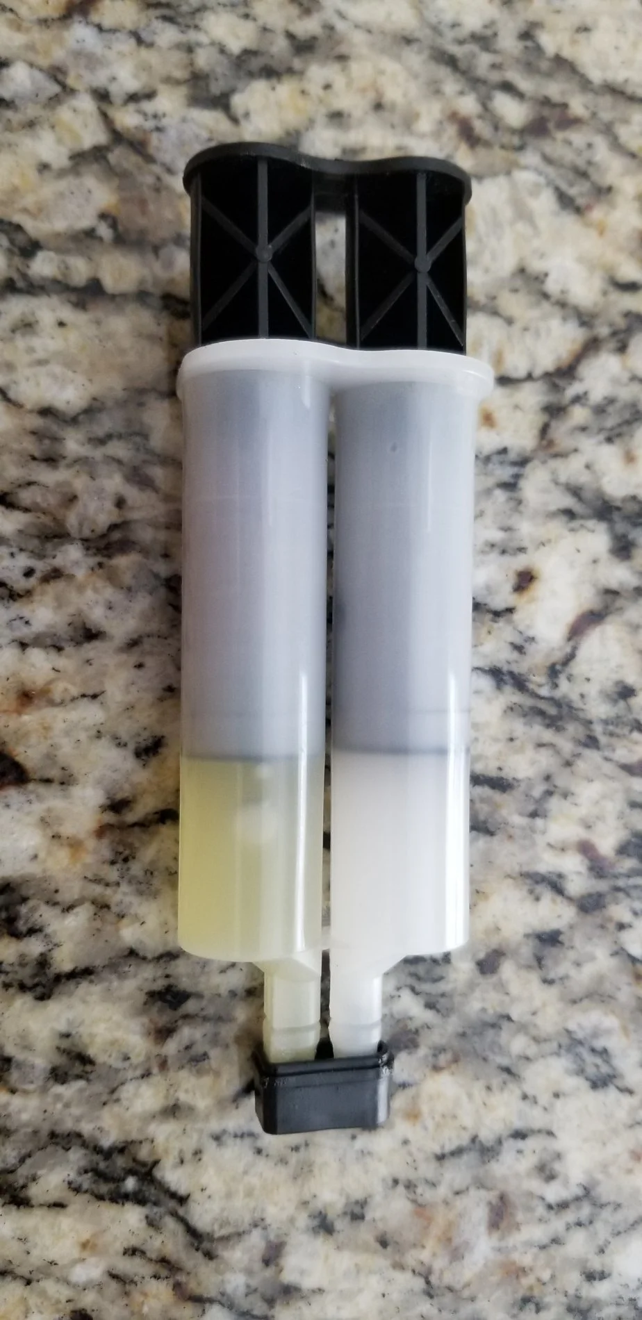

What brand of epoxy did you use to glue the Heatsink to the EMI Shield? Image of brand / type would be very helpful to know so I can purchase some.
It is an old glue I had and it doest't have the plastic with the name on it anymore but I think it was the loctite epoxy clear.20200713_154448.jpg
I don't think the type of epoxy makes much difference, the metal ones are different because they contain metal particles which makes them abrasion resistant and much stiffer (less flexible), there is no need for either of those properties here.
Just make sure the surfaces your are sticking it to are grease free, and thermal paste free, otherwise it will not stick.
and use a very tiny drop as it tends to spread as it sets.
