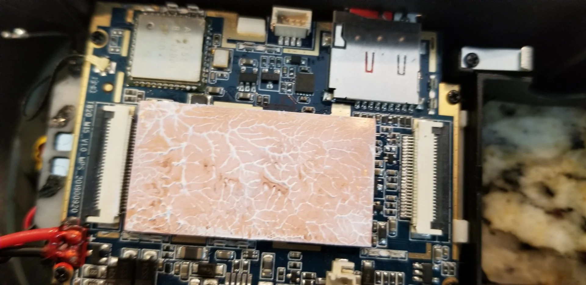

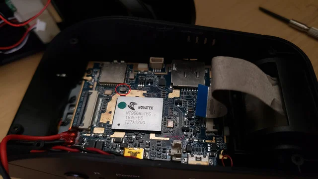

Yes. Please see my photos I have posted to @Nigel. Photos are of a Micro SD card adapter. With a width of 20mm. Notice the circled area and how it contacts that diode. From the best that I can tell, it would rest upon it if overlapping the SOC. As the SOC is only 15mm wide.
Is resting upon that diode a problem? You guys seem to indicate YES?
Based upon my own test and attached photos.....See Circled Diode - It's same height as the SOC. Copper needs cut down ONLY to fit on top of the SOC. The Media Card Adapter is 20/21CM wide. Same size as the copper plate I ordered (20x20x8mm) - 20 long, 20 wide, 8mm thick.
From the photo, it looks like an inductor, put some thermal paste on top of it to help keep it cool :)
(Unless it is the temperature sensor?)
If you soldered Copper Shim to the EMI plate, I think it'd regain it's integrity. I ordered these:
Presumably they are not tall enough to reach through a hole in the EMI shield, so I guess the decision is made!
No idea what that part is, which is why I asked in the first place. You guys recommended against TOUCHING anything else on the board. So I posted a photo showing a potential issue and would like clarification if that'll be a problem!
Well thermal paste fills in gaps but yes there'd be a small space between the EMI plate and copper plate affixed under it. So I probably won't take this route.
Note that there's a reason I didn't extend that far. You can look at the picture I took yesterday while I was disassembling my unit again to apply the new paste (MX-4).
The plate was still seating perfectly on top of the soc without touching any other components.

Look at my photo and your photo. Your shield appears to be resting on that "inductor" or whatever component that may be.
It may look like it does considering the angle the picture was taken. It is not on top of it nor touching it.
Ok. Well I'll trim my shim down to make sure it doesn't contact that component either once shims are received. Your response is exactly what I needed to know. So thank you.
