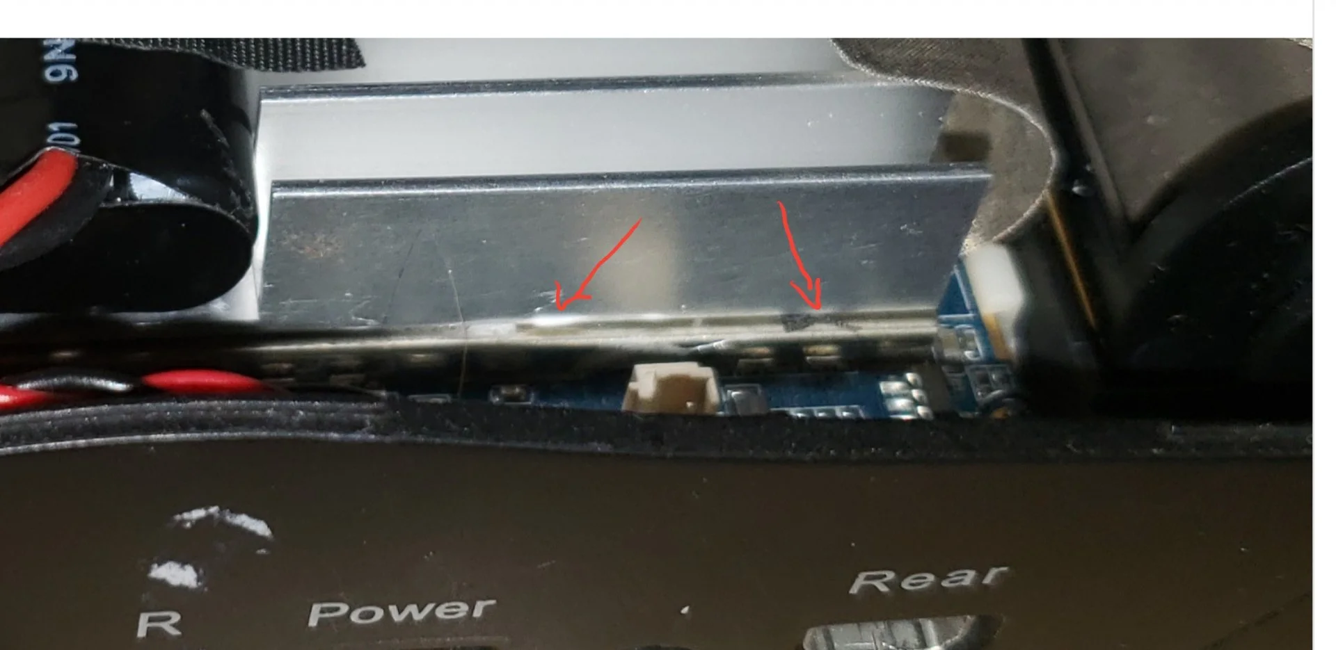

Did you remove all the tape and old glue that was between the emi shield and heatsink?
I still see some portions of it in the edgeScreenshot_20200714-220421_Chrome.jpg

Did you remove all the tape and old glue that was between the emi shield and heatsink? I still see some portions of it in the edgeView attachment 52639
All tape and glue was removed. That tape was probably a piece of fiber that fell from when I cut a sliver to place over the Supercapacitor and took photo.
