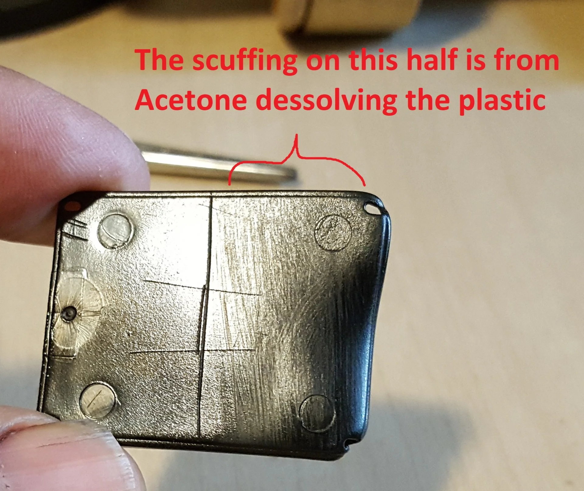

UPDATE ! Acetone will dissolve the plastic that the BlueSkySea mini 0906 is made of, I tested it today on the two degree wedge that came with the mini and that is made from the same material.

I ran a test on the two degree wedge that came with the mini which is made of the same material, first I ran a flame across one side of it with a lighter second I wiped half of both sides with Acetone and the otherside with dish liquid.
I suspect that the heat treated material was just washed away by the acetone. Next I cleaned a small area of my windshield with acetone and then with alcohol mixed with vinegar then another small area with just alcohol/vinegar mix and then lastly I put a spoog of black silicon II on all of those surfaces and waited twenty four hours to see what surface the silicone will adheres to the best. The silicone sticks to the windshield cleaned either with just alcohol or with acetone then with alcohol, I should've tested acetone alone.
The results show that heating the material and cleaning it with dish liquid promote the best bond, please note that the pictures are not in the best order to understand.
