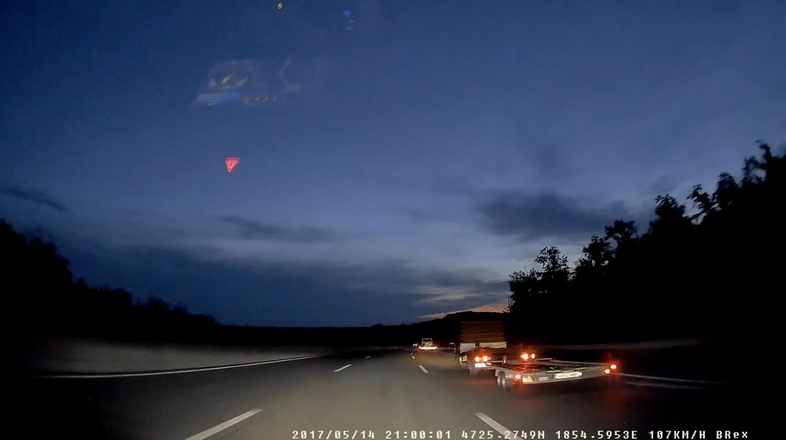

I think mine is out of focus at left down. The rear camera`s recording is not so nice

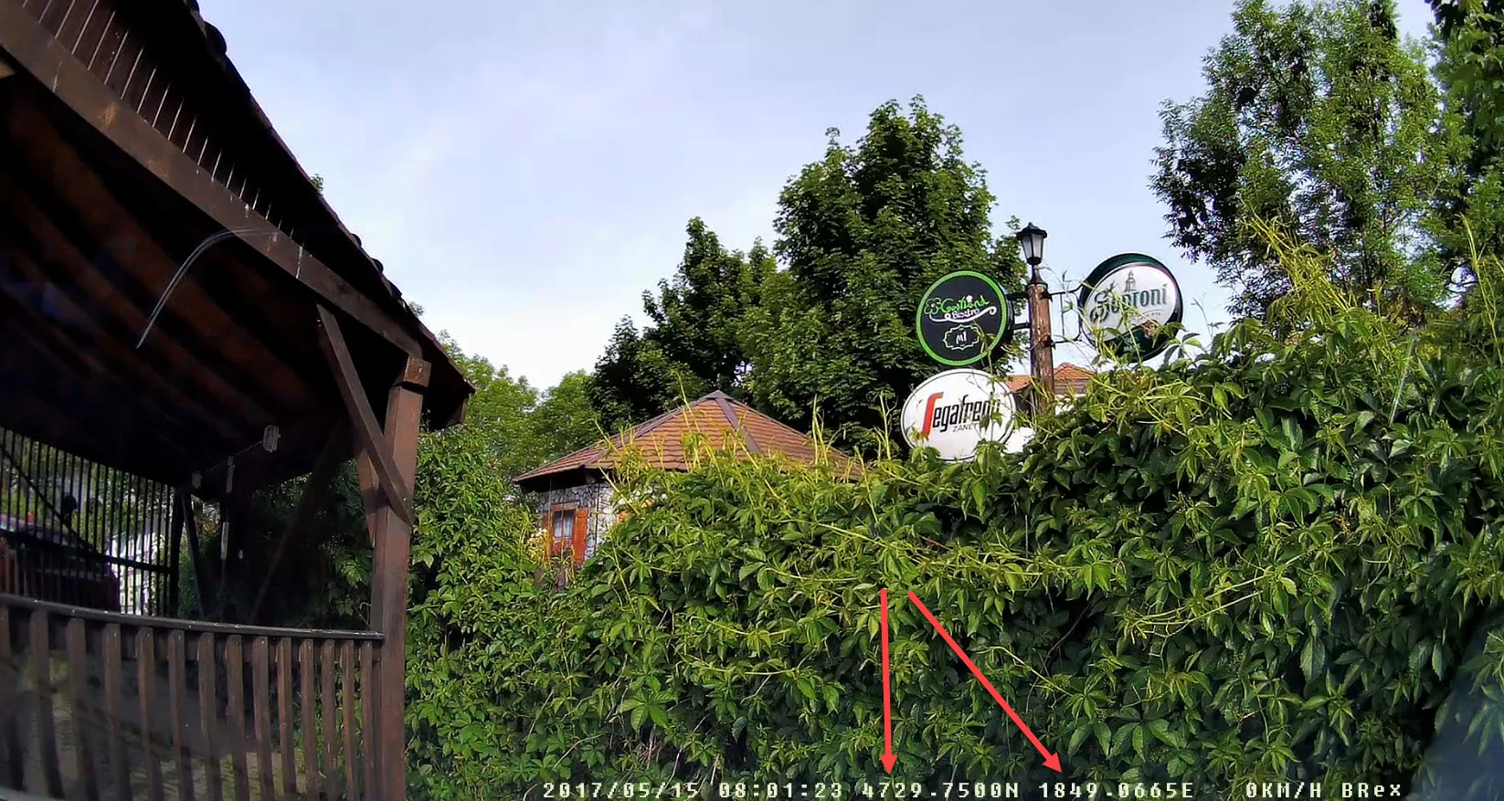

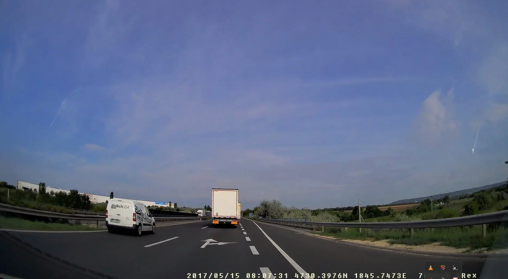

GPS data display and logging is wrong.Instead of 47.297500 it shows and logs 4729.7500

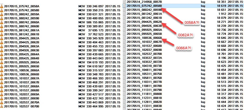

Some log files are missing, what is creating a mess and missing data during the preview with GPS coordinates

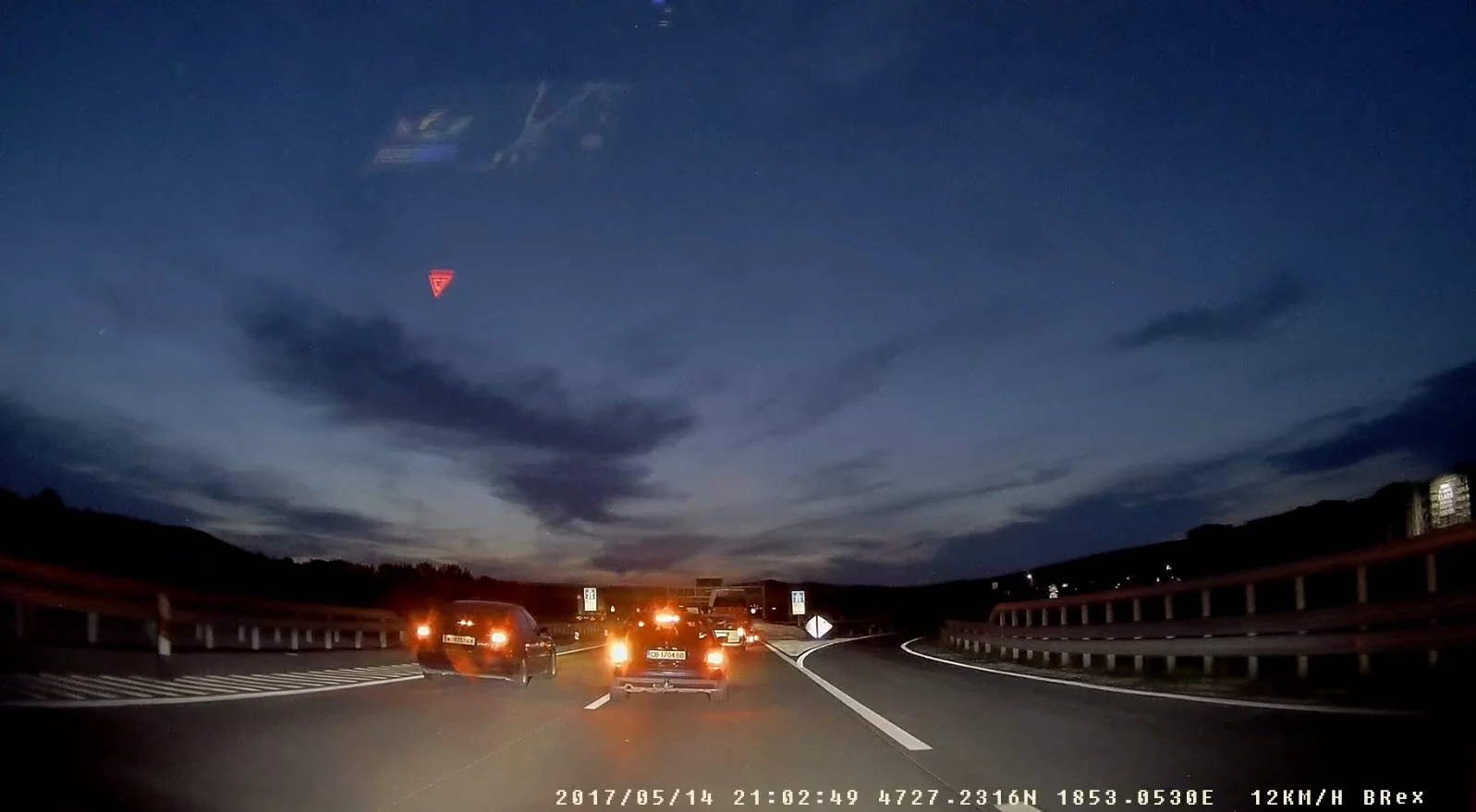

Dark and pouring with rain, but with the bright lights it almost looks sunny!
Hasn't quite got the colour of the traffic lights correct.
I've managed to get vertical halos on the lights, they vary depending on which way the wipers last went.

The default format used by the new chipset is different to what Registrator Viewer works with, I wonder if perhaps some of the file handling problems are due to the changes they've implemented trying to get it working with Registrator Viewer
the default naming logic is not perfect so we changed the naming codes, which bring some problems, especially when added GPS log.
when you developping your camera please take care on this.
we kept with the Novatek default way for this, it causes too many problems to try and rewrite it
have you removed the protect firm of the rear camera?
or the lens is fingerprinted or dirty? and also the rear window
