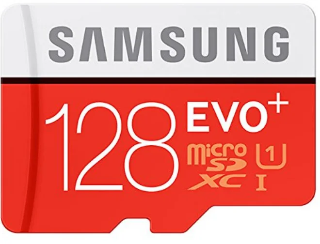

I have been using the Samsung 128 EVO Plus for a week now without issues. So far I've completely filled the card and its overwriting it. I'll keep you posted if It has problems.
https://www.amazon.ca/gp/B0118LR9Z8I also purchased the 64GB MicroSDXC Class 10 UHS-1, I only used it for 1 day to test it, and it seemed to be ok. I'll have to use it longer for more results...
1 thing I do have a problem with it is... it jams while pushing it in and I have to use a small tweezers to get it out... its very stiff going in and coming out... not sure if its a design issue with the card or not... but this card was recommended by Blackboxmycar.
https://www.amazon.ca/gp/B016B6AMFYboth cards worked right out of the box and both format in the camera without issues.

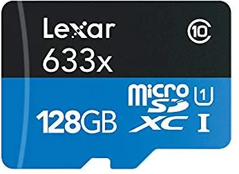

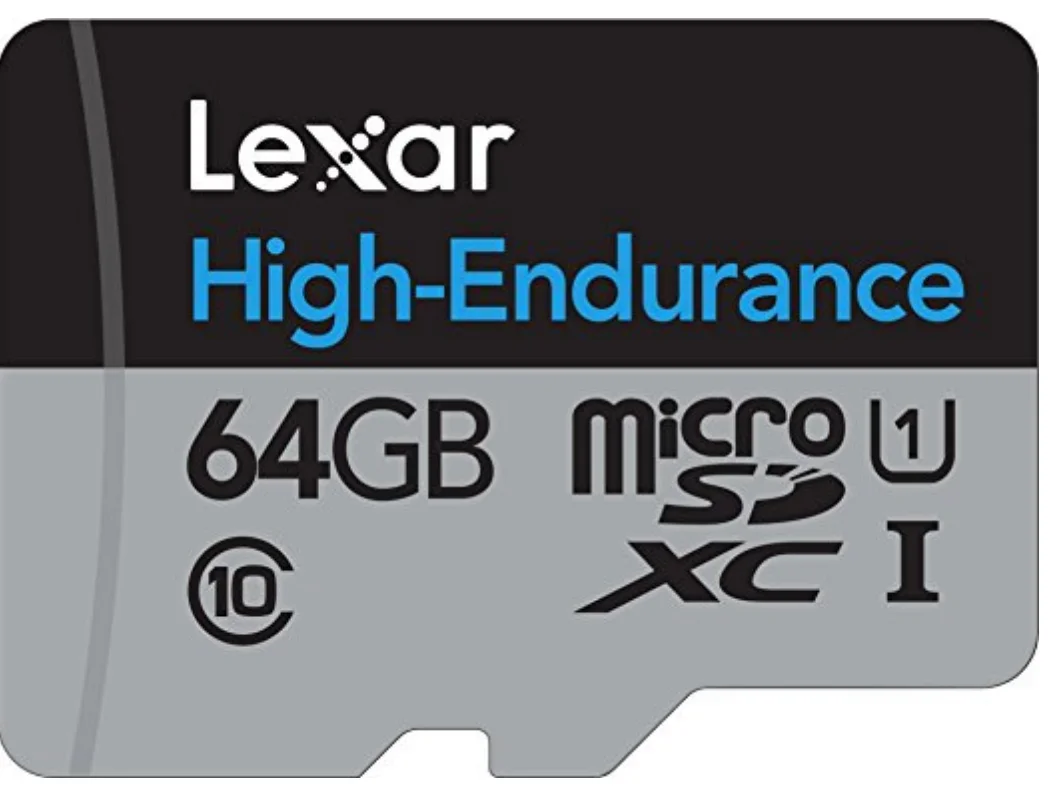

Micro SD card "school" for Thinkware owners:
I have been doing about a full day's research on these. I'm not an engineer and never knew anything about these cards before this, but just bought a Thinkware F800 with rear camera and decided to order it with the 16GB Thinkware card so that I could order a higher capacity card myself, from a different manufacturer (or at least distributor, since we don't really know who makes the Thinkware cards). Initially, I intended to get a 128GB card as I had seen many were successful using these.
It has been a trip down the rabbit hole for sure. I've emailed back and forth with Lexar, Thinkware, Transcend and spoken at length with blackboxmycar.com twice. I've read every post I can find anywhere (here, Amazon, B&M Camera, etc, etc) as well as articles (if you want to understand these well, the article linked below is very good and comprehensive and from July 30, 2017 review of 12 micro SD cards with very thorough explanations of all the different parameters):

I've learned a lot more than I ever wanted to about these cards, but have saved a lot of grief and headache by doing so and thus want to share.
So here are a series of issues and questions which I am trying to put into one place for those who want to know "Which card should I buy". A lot of "common sense" answers turn out to be wrong, in this case, such as "a faster speed card is better" (eg UHS-3 cards are faster, but not compatible with the Thinkware firmware/hardware, while UHS-1 cards are compatible. Samsung Evo+ works, while the higher-rated Samsung Pro+ does not)
1) 64GB or 128GB? Many people have noted that certain 128GB cards work (such as the Samsung 128 Evo+ U-1--but make sure you get the UHS-1 ***since posting this yesterday a member is reporting today that this card caused errors*** see post that follow all of mine). There is, however, no good evidence I've seen yet that this card is recording for a longer duration of time than a 64GB card. Blackboxmycar.com tech Jason has observed that "the 128GB cards get eaten up a lot faster". This seems counter intuitive, but Thinkware claims that even though there is a higher capacity of memory medium in the card, the camera is only writing and rewriting on a smaller sector/section/part of the card and thus, the 128GB card is not going to give you more recording time. Seems from our community posts that some feel they may be getting longer recording times (Please comment and let us know if you truly have a comparison with objective comparison data from a 64GB to a 128GB card!). If they are getting longer recording times with 128GB, this could mean that the higher capacity card is, indeed, being used over more of the memory medium. This would provide two benefits: 1) longer recording times 2)less rewriting, thus improving the life of the card. (for those who are newbies, like I was a day ago, these cards go bad after being rewritten many times...which dash cams do...and companies will even void warranties on many types of cards if you put them in a surveilance or "dash" camera because of the extreme use cycle of these cameras). All these micro SD cards are only going to tolerate a limited amount of rewriting, and thus cards, such as the "Transcend High Endurance" are often a better value in the long-run (except that that particular card may not work...someone commented that theirs wouldn't work with their Thinkware F770)
part 3>
It is important to understand that as cards go higher in memory capacity, they are more likely to use TLC NAND memory matrix (less reliable and with much less longevity) than MLC NAND memory matrix. (Triple Level Cell NAND vs Multi Level Cell NAND) If you really want to go down the rabbit hole, just wiki "NAND" and find out it stands for "Negative-AND"...but I recommend just staying with me here.
So if you get a 128GB card, make sure it is MLC NAND memory and not TLC. The TLC card will absolutely not last as long and will be less reliable even when it is working. (It's cheaper and easier for companies to make higher-capacity with TLC than with MLC)
Answer: Not clear. Very possibly wasting money on more expensive card to have less reliability and no improvement of total recording time. (Need direct comparison input from people using them) The observation by BlackBoxMyCar.com techs that "128GB cards get eaten up faster" may be solely due to those cards being TLC NAND instead of MLC. Either way you choose, make sure you get MLC NAND memory cards only.
