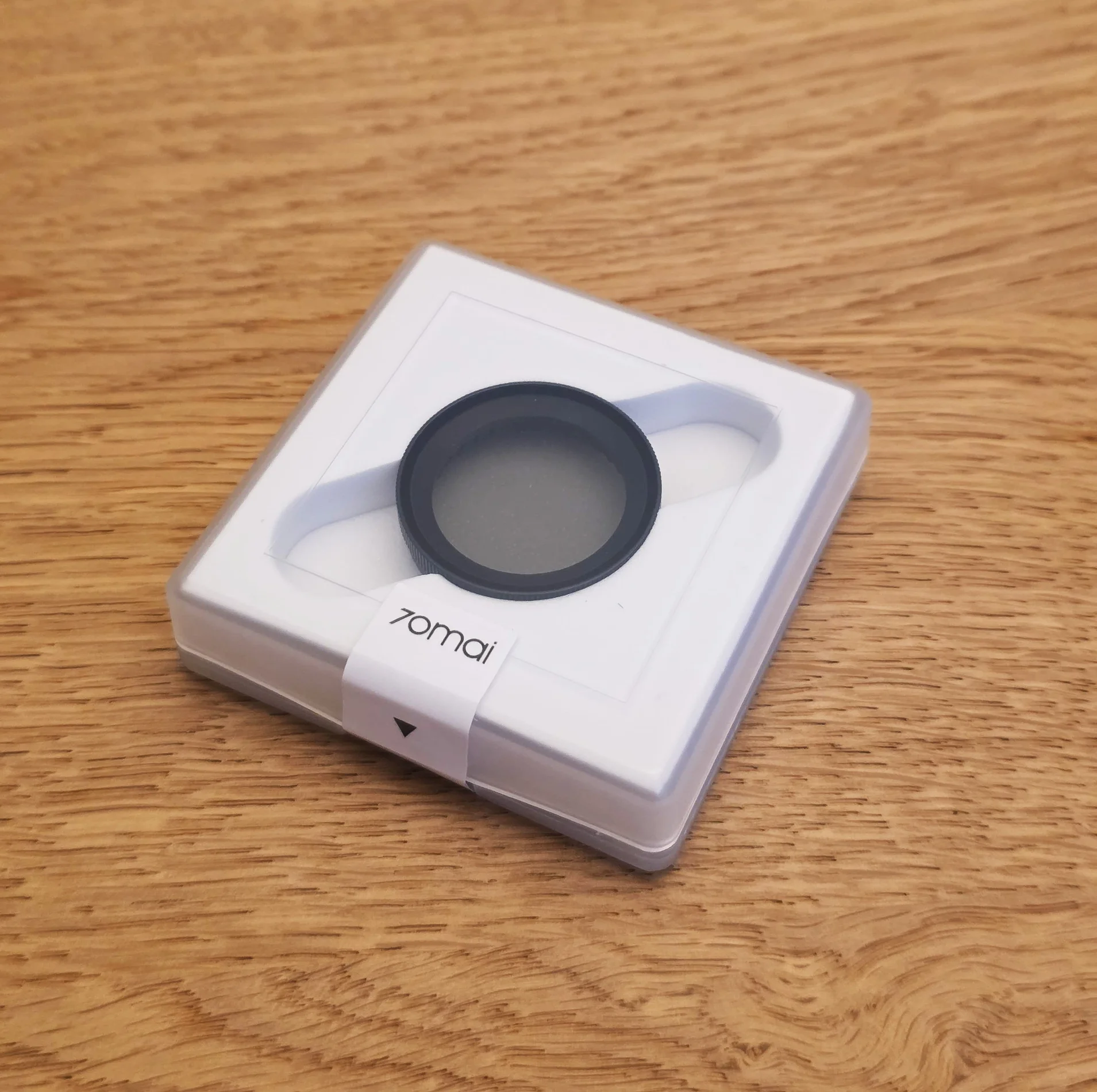

70mai also offers a CPL filter for the T800.
This is how it arrives and looks like.
The rotation can easily be adjusted while it's mounted.
I will check how it will affect the footage in the next days.

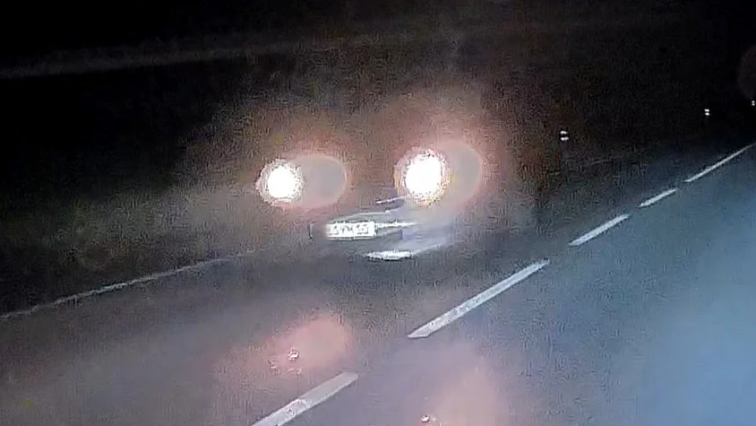

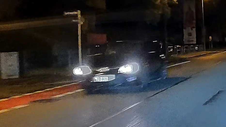

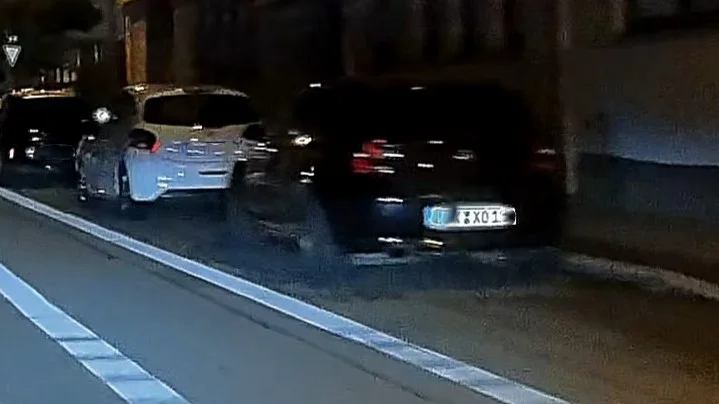

I installed the CPL, and the plate capture at night has decreased. The daytime footage will benefit, but the nighttime plate capture took a hit.
The settings have not been changed.
All plates have been partly blurred to comply with privacy laws.
At lower speeds, the capture is fine. Oncoming traffic at night is now harder to capture.
More in the next post!

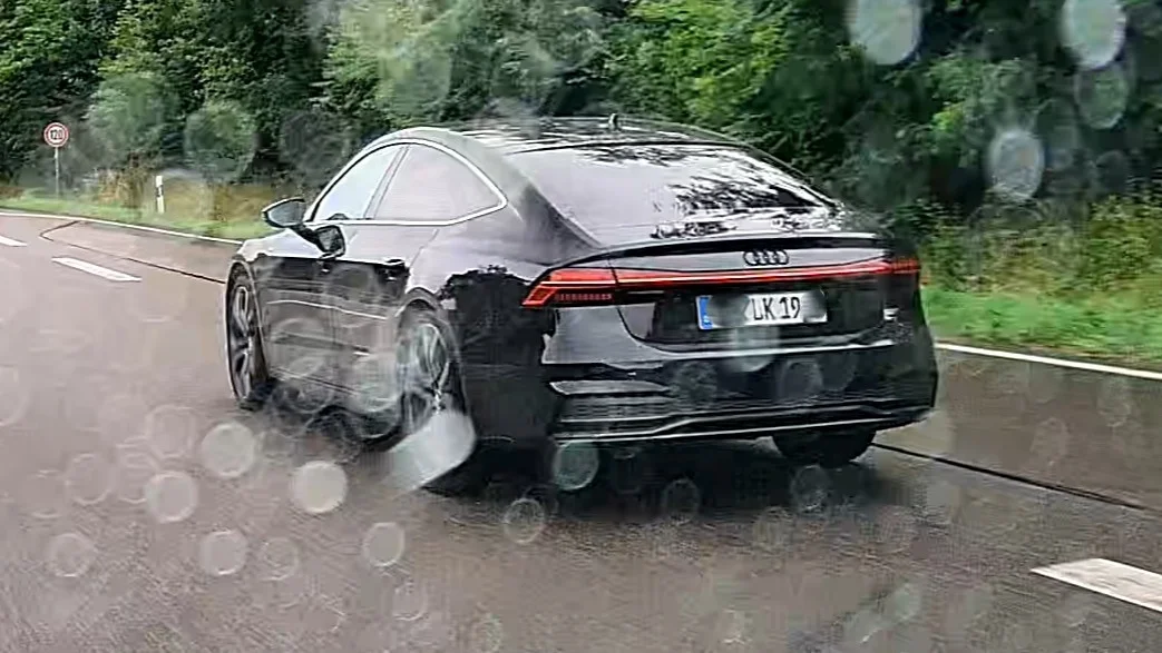

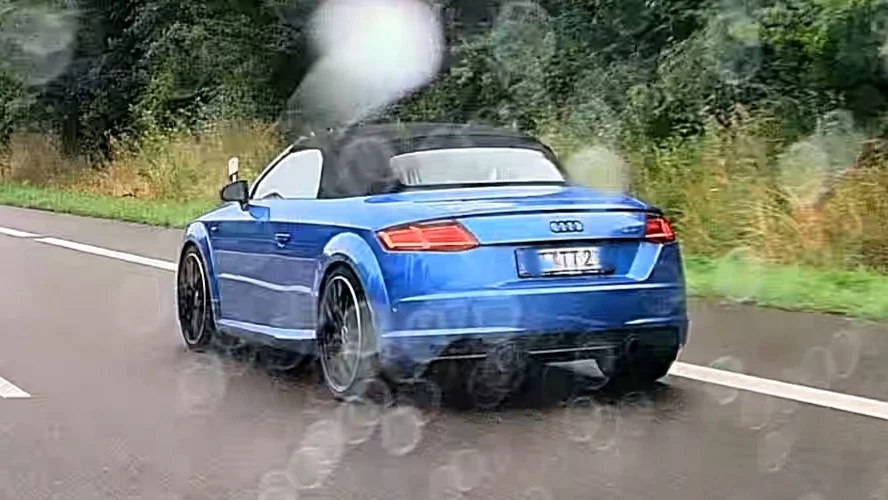

And some more pictures below. It was slightly raining.
The plates can mostly be identified in the original file size.
The forum will reduce the quality.
