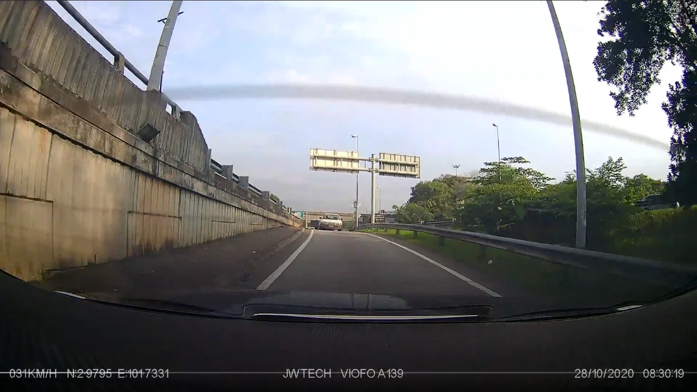

This is the rear cam on my A139. So how can you tell the distance when reverse parking?
