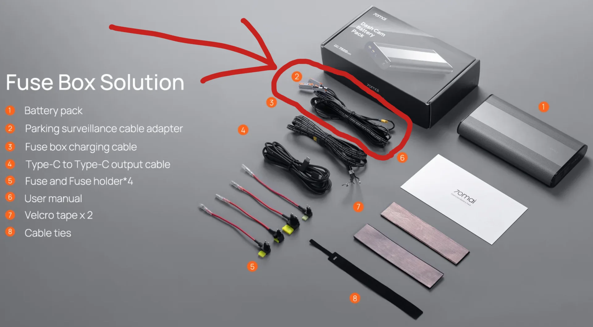

I got tracking for mine now. I will be connecting a blackvue on mine. Any suggestions of which brand/type of connector would be recommended?
Use the hardwire kit that was included with your BlackVue dash cam.
Sorry I should have been more clear. Would I not need a MR30 pigtail? I am doing the CLA for the battery charging. I am assuming the black vue cables would need the MR30 to then go into the battery pack. Any recommendations on this? Unless the battery pack will come with one which I doubt or im just a noob and overlooking something simple.
Everything you need to get you going is included in the box.
See item #2 here;
This is the Output Cable you will connect to your BlackVue Hardwire Cable.
However @rcg530 , and myself would recommend using 16AWG wire for the output cable.
This will require new 16AWG MR30 connectors, 16AWG wire, and soldering equipment & skills.
Make sure you test the battery pack before you install it in your car.

Ah I see the issue. I ordered the CLA kit that does not include that parking surveillence cable adaptor. Looks like I got to buy the MR30 adaptor anyway. Thanks for amazon pics.
The screenshots are from the 70mai website.
It’s not available on Amazon yet.
It’s me who has made the mistake.
I just realized the CLA version does not include all the wires the hardwire version has.
I thought they contained the same wires, and the only difference was the CLA & Hardwire charge cable.
This is a marketing disaster.
There should be only one version that includes everything.
The $10 price difference is so insignificant it’s not going to make a difference to the consumer because the pack is still $130USD cheaper than the competition.

I have to believe the "Cigarette Light Solution" has to come with the "Parking surveillance cable adapter". When the 70mai battery pack is in the "CLA charging mode" configuration and the charging power is turned off, the ACC out power from the battery pack turns off as well. @Panzer Platform have you confirmed with 70mai that the cigarette lighter solution truly does not come with the parking surveillance cable adapter?
I will let you guys know in a day or 2 when mine arrives. I ordered the Ciagrette Lighter solution.
No, I'm going off these screenshots.
But, now I understand the $10 lower price for the CLA version.
Came home last night to my package. Unfortunately the screen shots are correct. No "Parking surveillance cable adapter" included in the CLA kit. I dont see it as an accessory to purchase separately on the site either. For my use case the usb cable wont work since I have a black vue. I also have the black vue official usb cable but No PD on the battery as far as I can tell. Seems to be only 5v while the black vue would need to be hardwired to get 12v. Dissapointing to not have the adaptor included.

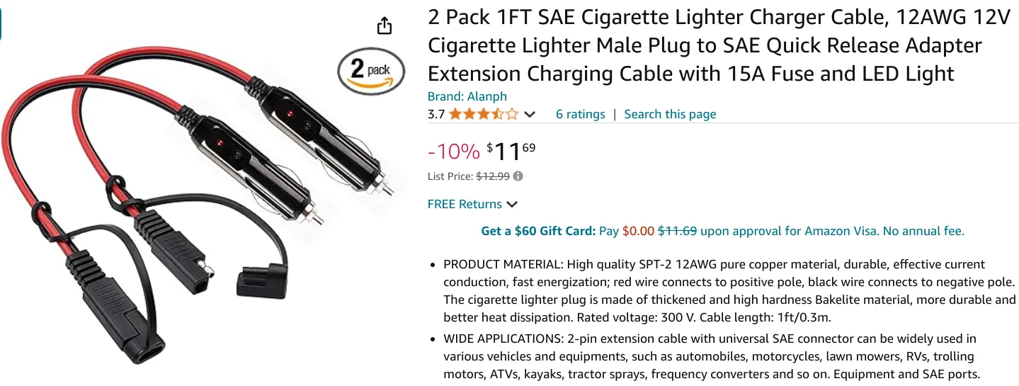

I would return it for a refund, and order the hardwire version for $10 more.
Once you get it, you could easily connect your own CLA to the hardwire charge cable.
