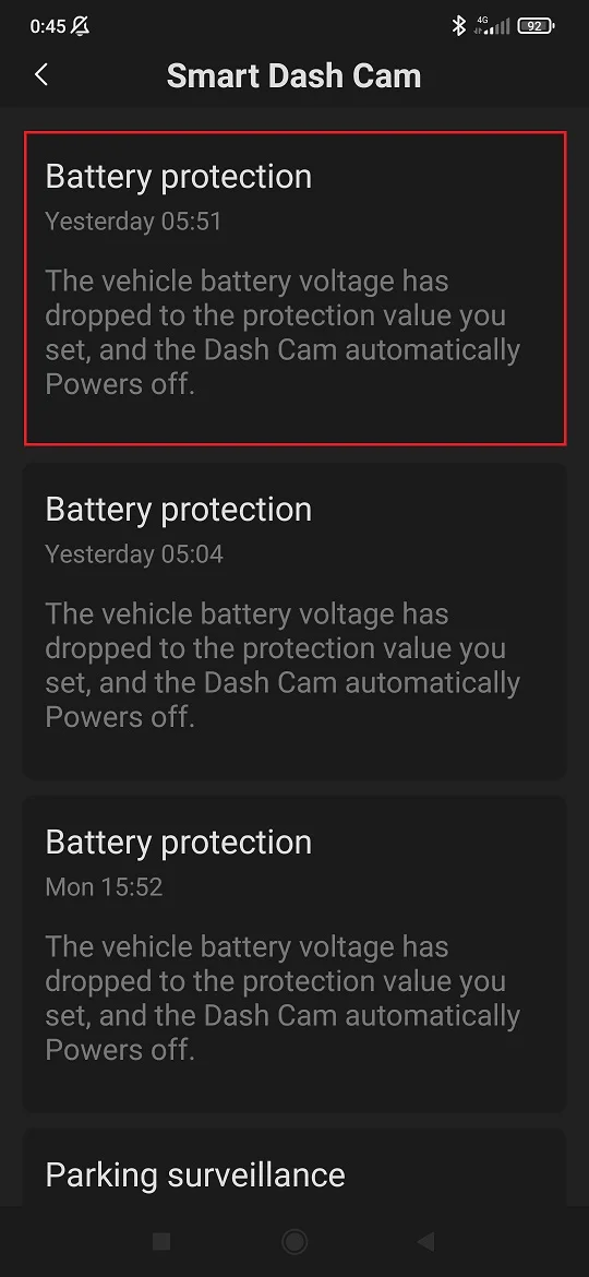

On the phone. ( Testing A810 and A510 with 4G hardwire kit )
It do say vehicle battery, but i am not connected to that i am connected to the power pack. there is no way it seem to just say to hell with low voltage and let the power pack just do its own thing, so i am set to 11.8 volts.

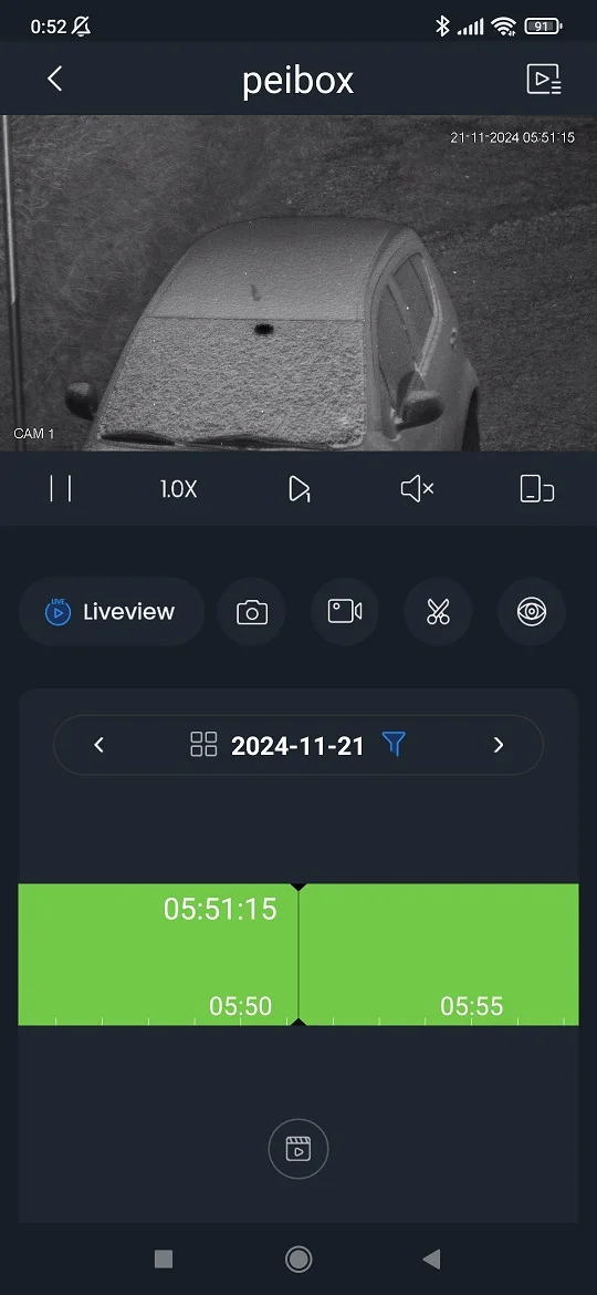

Using G sensor parking guard, and the camera are for sure not off, CUZ it have melted the light sprinkle of snow.
Lemme me grab a picture from my home CCTV,,, BRB
CCTV from the time of the MSG on the phone.
Okay just looked at my power pack and it was indeed flat, what i think happened is my car was so cold on my last longer drive ( home ) and so i was probably half way home before the power pack was warm enough in the glove box that it wanted to charge.
Today in -2 deg C all of the LED just flashed like 3-4-5 minutes after i started the car and scraped ice of it outside, drove across town and after a visit at the car wast the power pack was now charging but just 1 LED flashing.
So pretty sure i will get a low voltage warning before i get out of bed in 10 hours or so ( and tonight minus 10 deg C is forecast for my area.
