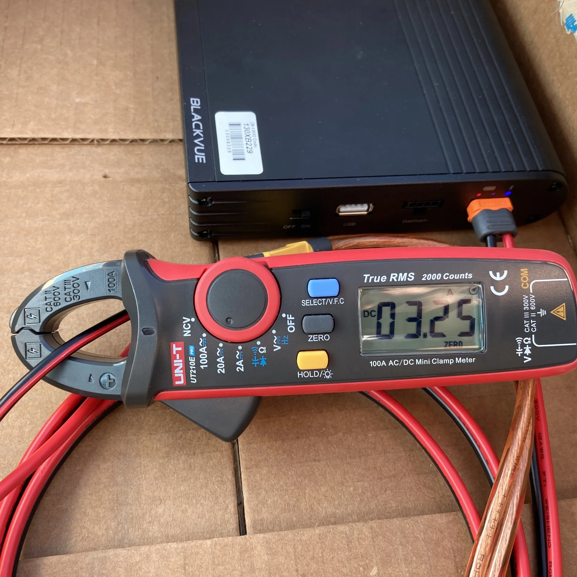

Looking at your solar panel, which will have been sold as a 12 volt panel, open circuit voltage is 21.6V, so you don't want to plug that into a 12V maximum battery, because it will output 21.6V in full sun, if the battery is full and has stopped charging. The "Optimum Operating Voltage" is 18V, so that is the voltage an MPPT charge controller would operate the panel at to extract most power. If you connect it directly to an empty LiFePO4 battery, the voltage will drop to around 12V, and the panel will produce far from optimum power; once the battery is fully charged, the panel will be outputting 21V and cooking the battery.
Your 12 Volt PowerCel 8 will accept more than 12V, but I don't know what the maximum charging voltage is, I don't know if it can cope with the 21.6V, maybe it is OK, I wouldn't be surprised if it can go up to 32V? An MPPT charge controller will take control of the output voltage, and is a good idea anyway to extract more power, a solar panel inside a vehicle will always be operating in far from optimal conditions, the MPPT will allow it to produce more power, and allow use of a smaller panel.
It appears from your multimeter photo that the label on the solar panel should not be completely trusted, some 12V solar panels can reach 24V when no power is being drawn, there are different technologies of solar panel, some may get even higher.

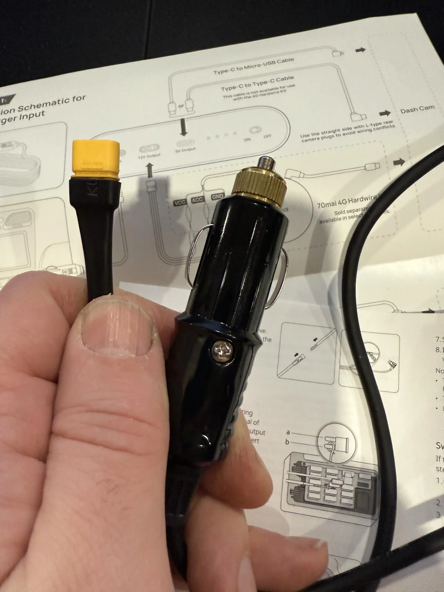

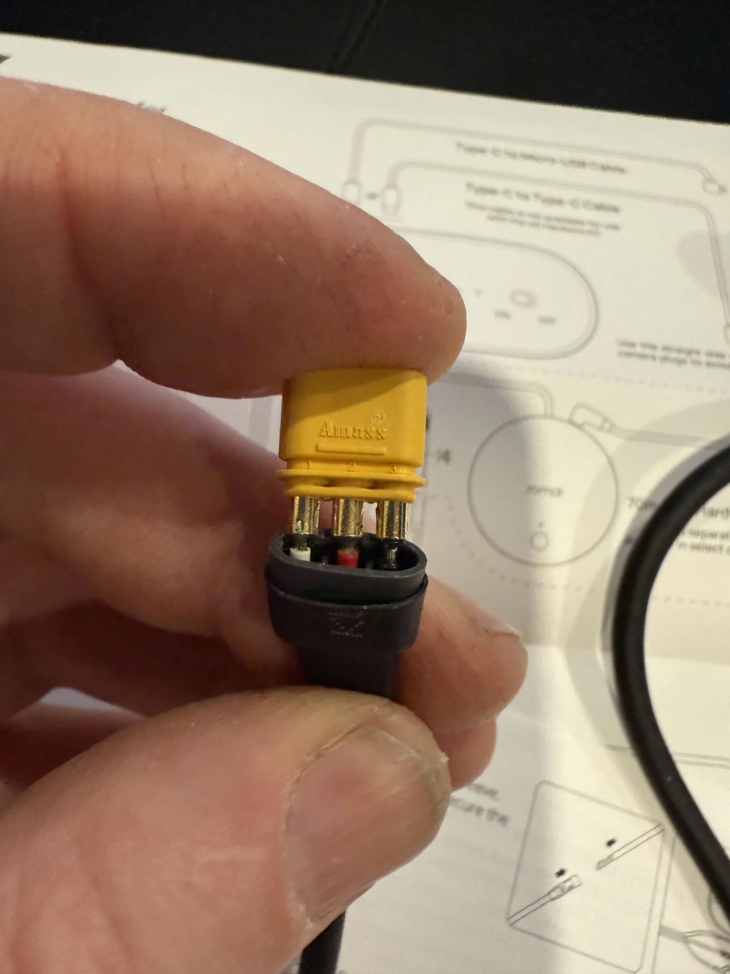

3 wires on cigarette lighter cable would fix this instead of leaving accessory pin empty populate it.
3 wires on hardwire already exists

The IROAD powerpack Pro 12 uses all 3 pins
Then you select low for cigarette lighter and high for hardwire.
