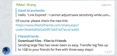

Hi guys!
Firmware for ENGLISH VERSION dash cam (international, with "70MAI" on board, not chenese)
with ENGLISH VOICE control and ENGLISH VOICE commands.
from Telegram:
Version 1.0.5 eu
Firmware: SD_CarDV.bin
Bin File Upgrade Process
Step1:Take out TF card and insert it to your computer (or using a USB converter to connect computer).
Step2: Download the file named SD_CardDV.bin to the root directory of TF card.
Step3: Insert the TF card and keep the power cable is charging.
Step4: The device will automatically upgrade. DO NOT discharge until the voice prompt “Update succeeded” is over.
