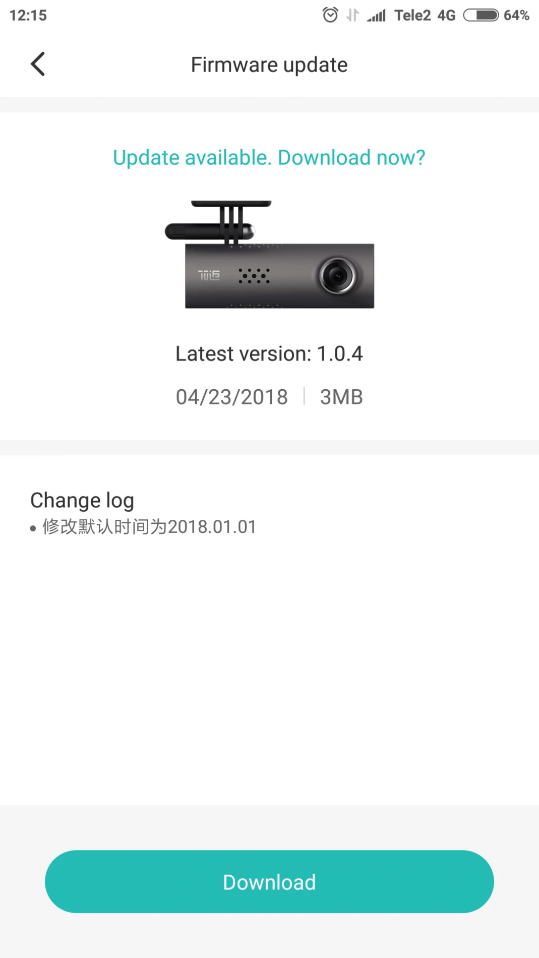

There is a way to get firmware and it is really simple. You need to instal Packet Capture app from Google play, then open it, install certificate. Next inside of the app find 70maidashcam app. Go to 70mai app and click on firmware update. Go back to Packet Capture, click on first captures, on first option, on the bottom there will be link to firmware.
Chinese firmware link: HTTP://rom-cdn.midrive.com.cn/SD_CarDV_70mai_1_0_3.zip
If you will be so kind and share link to English firmware, I will try to install it on Chinese version of cam.
do u have 1.0.4 cinese
