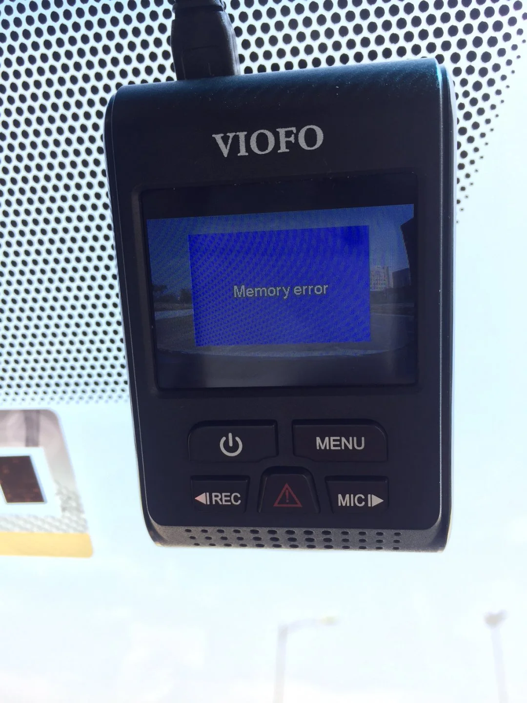

I have a Viofo A119 with GPS which is about a month old. I have a strange issue, the camera suddenly displayed memory error.
After contacting support, i was told to re-flash the firmware 2.0 and reset the settings.
I tried that and it worked for a couple of hours before it again threw the same error. I have done this multiple times and each time camera starts working after firmware flash for a couple of hours.
I tried contacting Viofo support, but strangely no one is reverting for more than 10 days now.
Can someone help?

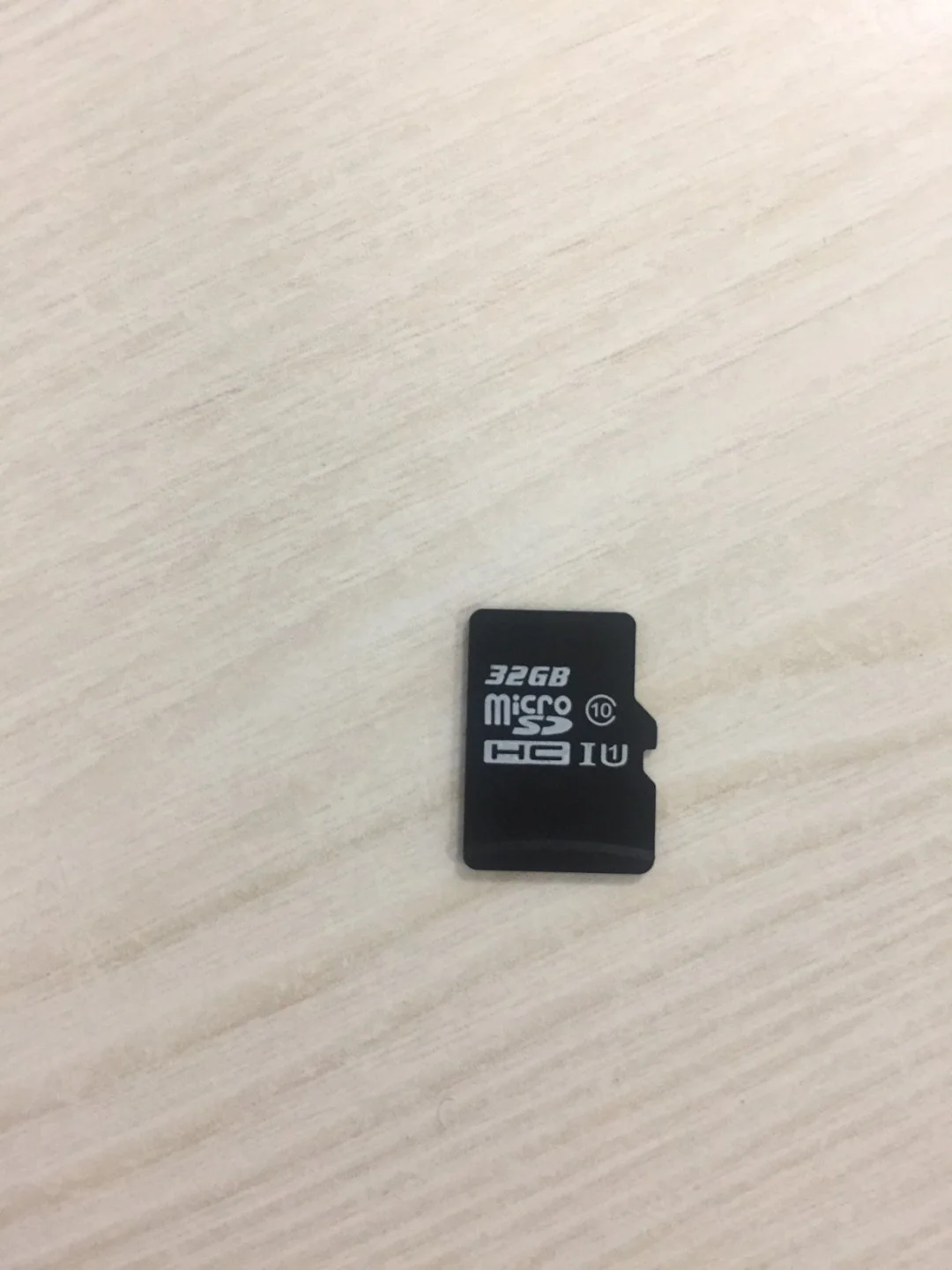

Strangely, there is no company name on the card. I got the card along with the camera, when i bought from aliexpress. Here is the picture of the card.
That card could be anything, including a fake. I would start by purchasing a new micro sd card from a decent seller, such as Amazon. Steer clear of Sandisk cards.
that would be your problem, go and buy a decent quality (genuine) brand name card
Thanks, any recommendation on what brand card should i buy? And is should be a class10 card right?
Transcend High Endurance is probably the best you can get, although it's hard to get hold of and expensive, but Samsung Evo, Lexar 633x or their high endurance card are good.
