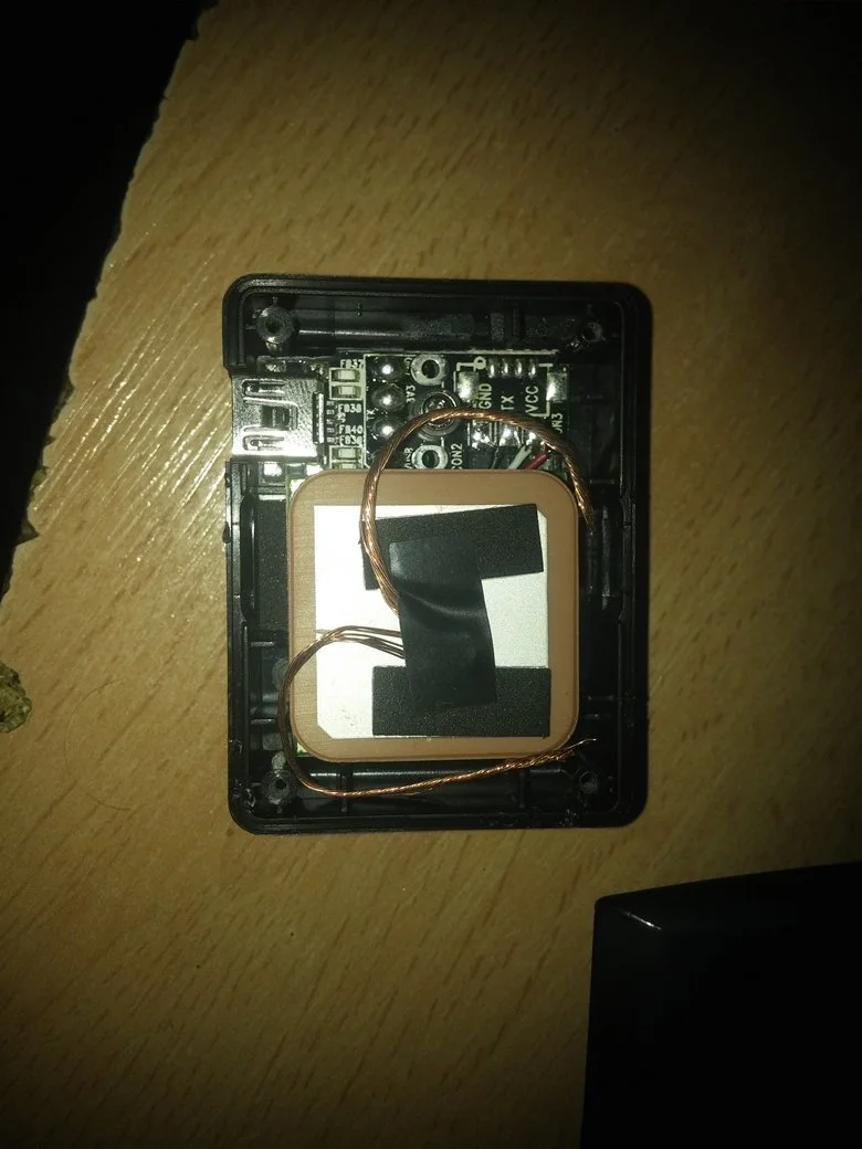

Is somwhere guide how to disassemble GPS? I would like to see what the antenna looks like and possibly modify it.

So I dismantled the gps to modify the antenna a bit (at least I think it is an antenna).
I added 2 wires (without insulation) about 3cm x 0.5mm as in the picture. The result was almost instantly fix the satellite (within 3 seconds) after switching on, and the response to the changes would say minimally twice faster. So it works or is just a placebo effect.

So I did some cold start and average time to fix it was about 10 sec (8-15 sec). It was up to 30 seconds before (for me). And while driving, the response to change is much faster than before (but I have already written it). When I have more time, I will try to make it better.

would you post a real picture of what you actually did, I'm interested in your DIY. :)
Instead of red lines, there are bare wires there (one of this http://i.ebayimg.com/images/g/IW8AAOSwBahVWyns/s-l300.jpg). And in the middle (with tin), I stuck them with electric tape. This would increase the antenna and improve the signal.

The first photo is a fix only by sticking.
On the second photo, I tried to add one more wire (without a visible result) and I connected it directly to the antenna. (Nasty, but at least it keeps on firm)

I am not sure about this. The original (square) is a very well tuned patch antenna. Your mod will probably do more harm than good. Also, cold start under 10 secs. is suspicious - I've never seen times like that.
if you were getting cold start times of 30 seconds then you never had a poor signal issue to begin with
But the cold start was no problem. I had a problem with the delayed reaction for up to 5 seconds. And now it reacts faster by half. So it helped me. I'm not saying it may be worse or you have to do it too. These are very small countries on which I move, other countries (or continents) may be other conditions.
