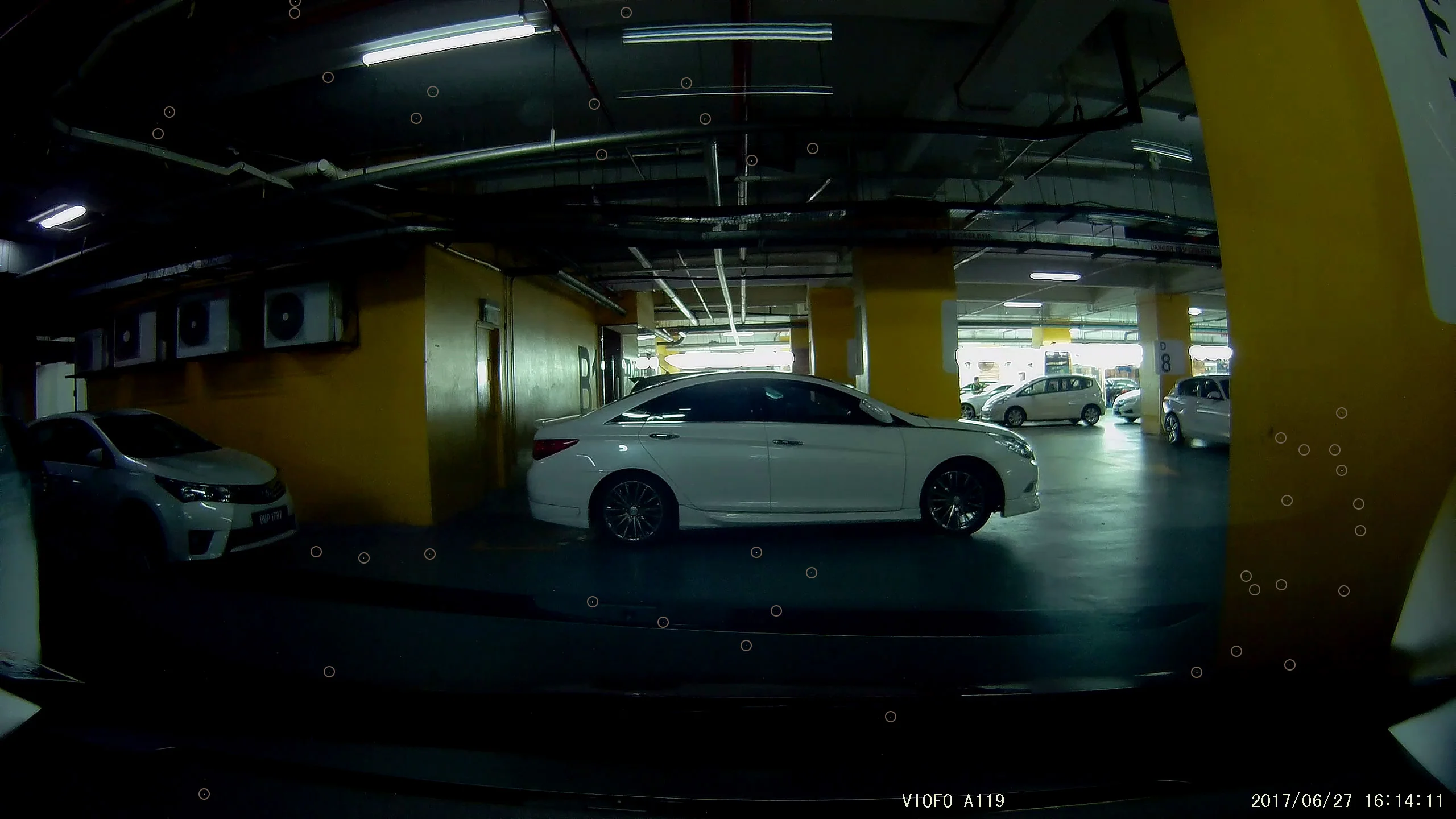

I noticed some artefacts in the video which I didn't notice last time. There are many white dots which looks like dead pixels all over the image in dark scene or low light shots. I circled them in attached image. The white dots disappear in brighter scene shots. I'm not sure if it is caused by the new firmware. I check my videos from v2.02 firmware and didn't notice such artefacts.
I didn't notice artifacts but they don't show up well on my 15 inch Laptop screen.
have a look in a completely dark scene, how does it look then?
I'll have to do more test in different situation and environment.
Yeah, I only manage to test once after updating the beta firmware. I'll need to test more. Good suggestion of recording a completely dark scene. I'll try to cover the dash cam and let it record a few seconds. Maybe I'll compare dark scene recording from v3.1b and v2.06 too if I have time.

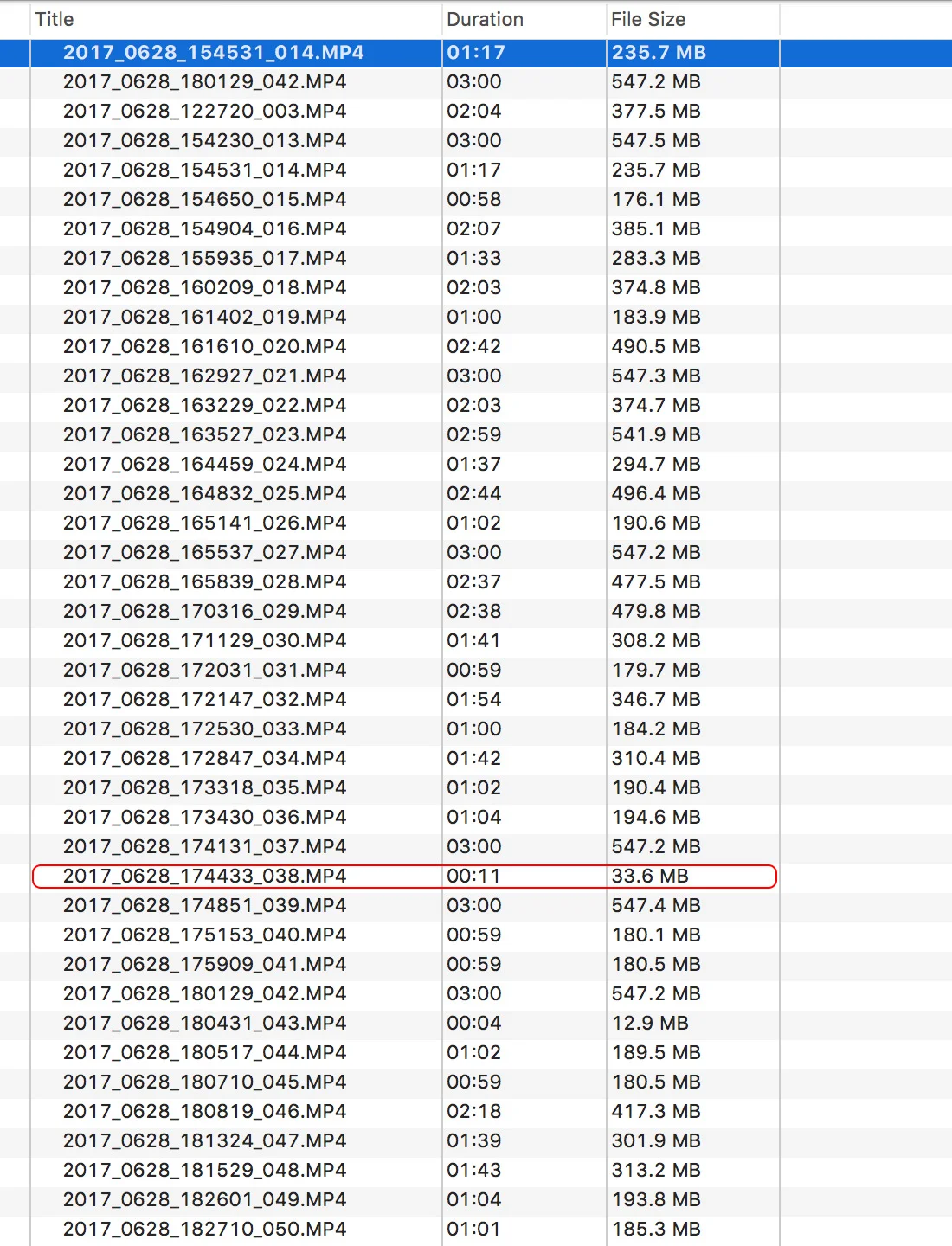

  5. I noticed there is one video clip with just 11s of recording. See the red circle in attached image. I checked the video clip before this and it is a full 3 mins clip and it contains a lot of motion. So my theory is if the motion activity is longer than the duration of loop recording duration (ie.3 mins), it will continue the recording with a new clip but stop recording as soon as motion has stopped. It won't record the extra minute after motion has stopped.

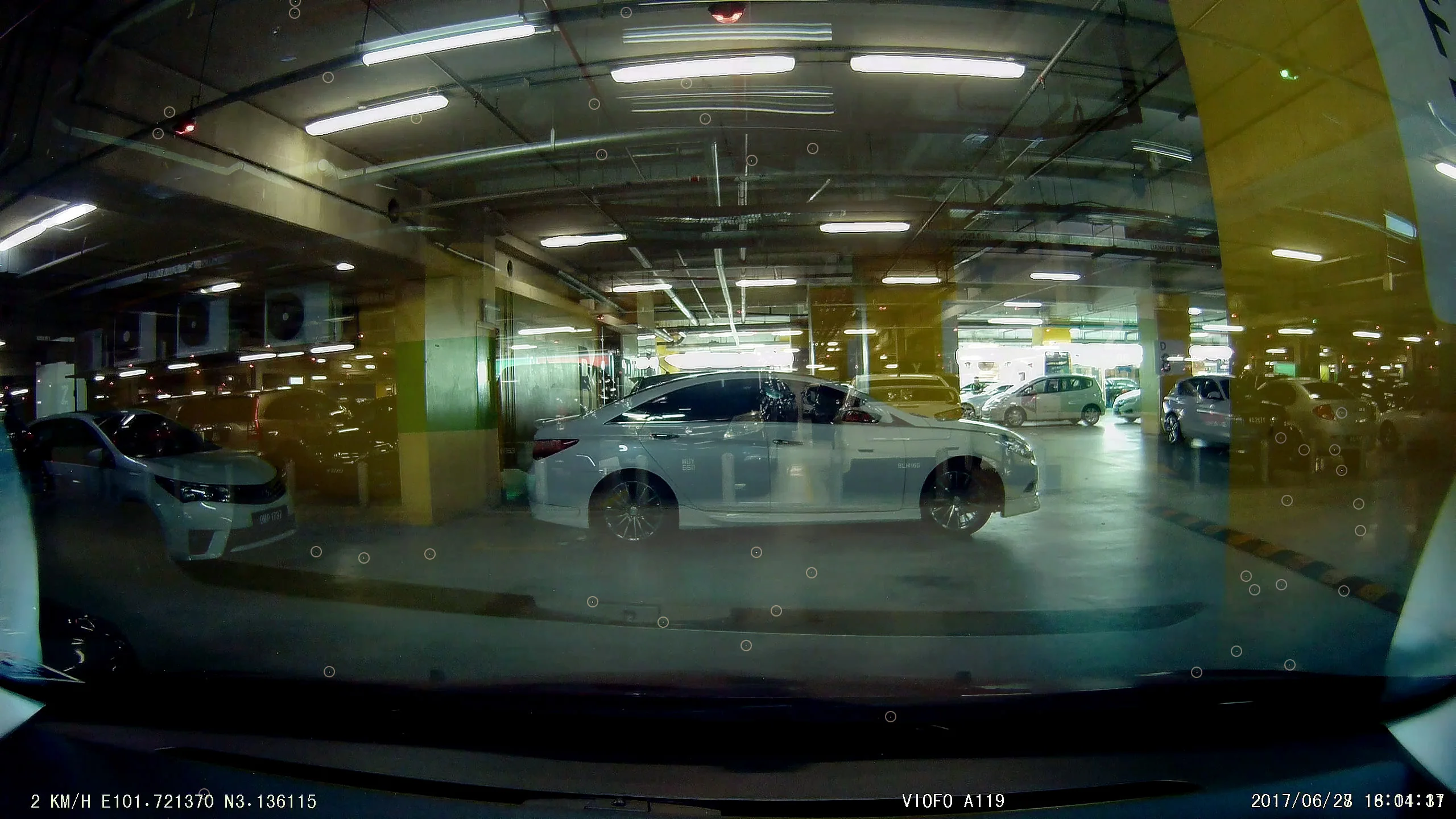

  6. The white pixels I noticed from yesterday's test are still there in low light situations at exactly the same spots with some plus/minus new spots. These white pixels are not static. They will blink like stars. See attached picture where I overlaid screenshot from yesterday's recording to today's recording. I believe these are not artefacts from recording, but due to the issues with some pixels on the image sensor when the sensitivity is being pushed up for low light situation. I also noticed that this only happens when I have run the dashcam for a period of time, maybe due to heat. I didn't noticed any blinking pixels when I first start up my car. I followed jokiin's suggestion to record a dark scene to observe the white pixels issue. I cover up the lens with a black cloth and I did not notice any blinking pixels.
Composite screenshots from yesterday and today.
Motion detect recording. Observe the time gap between recordings and duration of each recording. They are not continuous full 3 mins/clip recording as in yesterday's test. The video clip circled in red is just 11s long. I believe this is the 'overflow' recording from a very busy period of time.

the previous scene had enough lighting for the auto calibration function not to work, it is currently set to only work in darker environments so it's working as expected
correct
  • I noticed there is one video clip with just 11s of recording. See the red circle in attached image. I checked the video clip before this and it is a full 3 mins clip and it contains a lot of motion. So my theory is if the motion activity is longer than the duration of loop recording duration (ie.3 mins), it will continue the recording with a new clip but stop recording as soon as motion has stopped. It won't record the extra minute after motion has stopped.
This makes sense and a re-look at the files from my previous tests confirmed it. I checked short files of less than or equal to 57 seconds (4 cases) and found them all to be preceded by a 3 minute file (Loop Record setting). If I looked back at the previous file at a time about one minute prior to the end of the short file, I found a trigger source (car passing), whereas there was no apparent trigger source at the start of the short file. So the bottom line is that when the current file ends because the Loop Record function times out, any time remaining in the last 1 minute Motion Detection (MD) record cycle will carry over to the next file. If no more triggers occur while the A119 records the carry over time period, recording stops resulting in a file of less than one minute duration. That answers questions {now edited out} in my previous post about files occurring in MD mode that were less than 1 minute.
