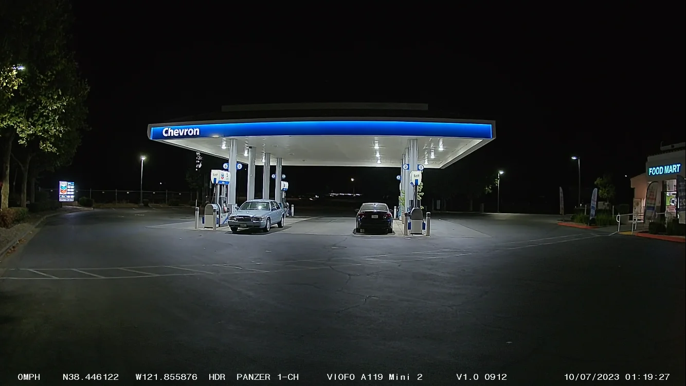

I performed a side by side FOV comparison with my “1st batch” A119 Mini 2 that was delivered 5/12/23, and my A129 Plus delivered September 2020.
Both dash cams have a manufacturer specification of 140° FOV.
It is my belief the A119 Mini 2 has a “true” 140° FOV.
Based on comparing this test footage the A129 Plus has an FOV closer to 165°.

Here is the test footage I took the screenshots from;
