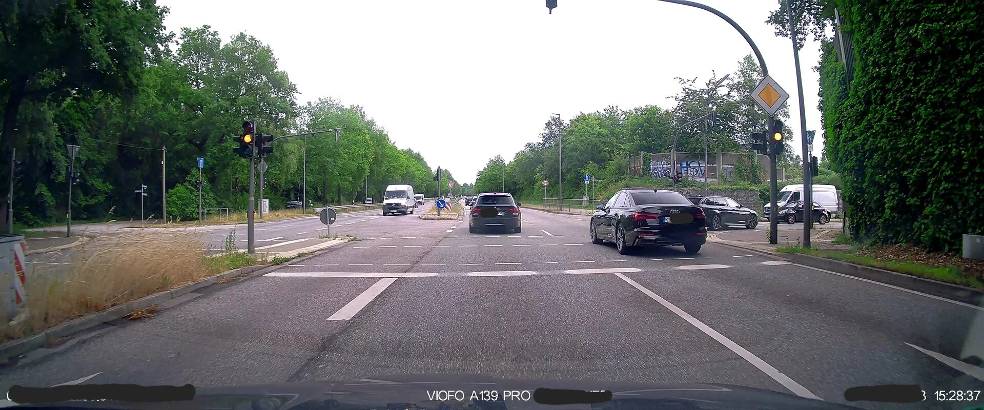

It's 3840x2160 @ 24 fps + 1080p @ 30 fps or 3840x1600 @ 30 fps + 1080p @ 30 fps (which I'll be using as soon as I installed the rear cam. Front is using x1600 and it's good enough for me. I see 90% of my hood and most traffic lights above me):

I'll have a look at my cam tomorrow but might it be, that the A139 Pro can do 4k @ 30 fps but 3840x1600 @ 60 fps when used alone or 3840x1600 @ 30 fps + 2x 1080p @ 30 fps in 3CH instead of just 24 fps?
One review definitely mentioned something like this...
That would explain why I got it so wrong...

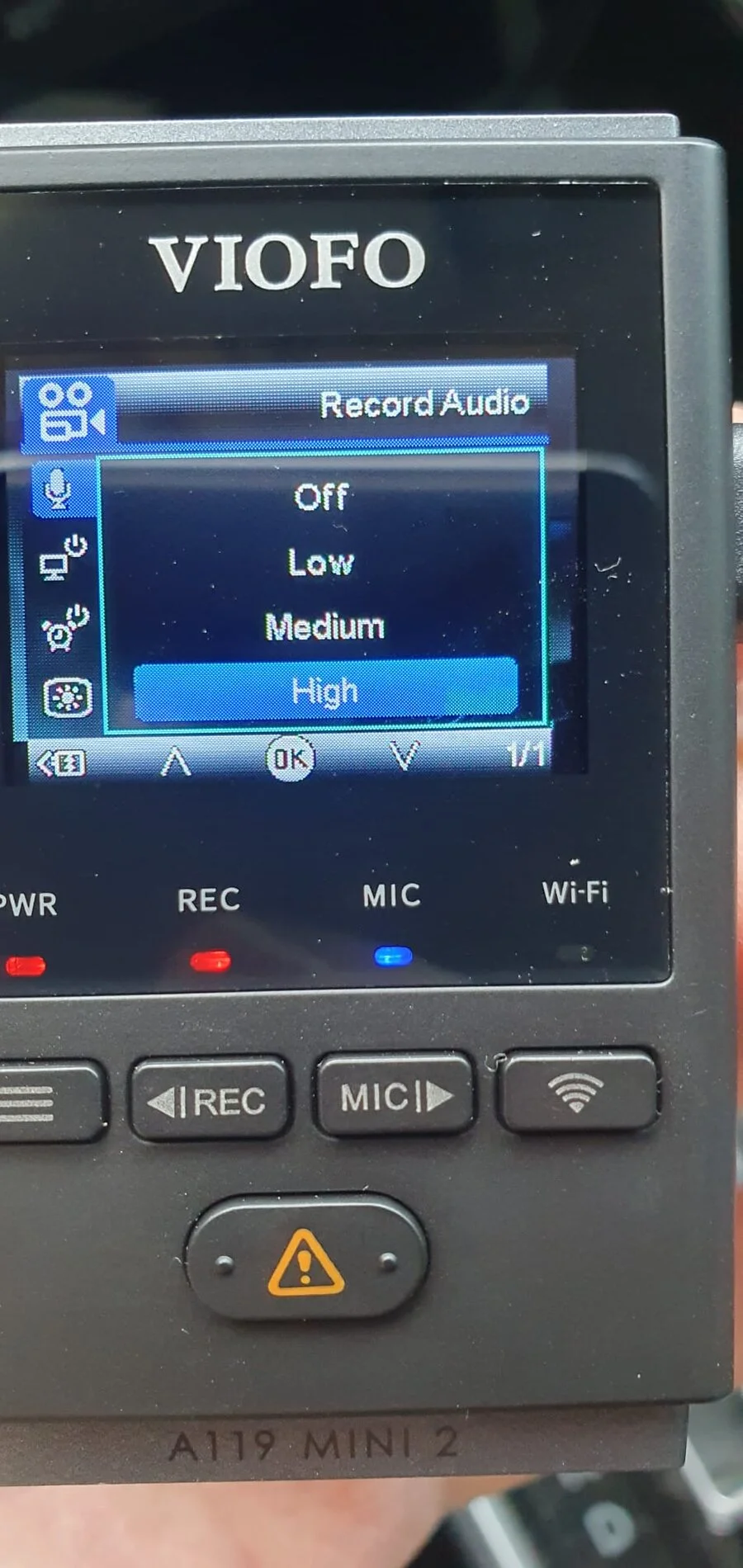

This is the reason I would like to see a low, medium and high volume control in the menu, so the user would have some control over the gain.
The sound on my Mobius 1S is excellent but I've noticed that when I drive at speed with the window(s) open I can get serious clipping from the wind noise. The solution was to re-set the volume from high to medium.
(Edit: I didn't become aware of this problem until the weather warmed up and I started driving with my windows open.)
In the latest test firmware, there is a volume control for the speaker and microphone.
Can you upload a YouTube audio test demonstrating the Low/Med/High volume levels of the Microphone like this?
Wouldn't this test work?
