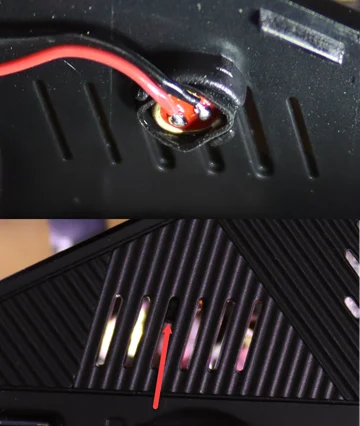

How is it held there? Glue?
It looks like there are tabs on the side of the A119 Mini case that the microphone resides in. The appears to be some sort of "rubber" ring around the microphone that fits in between the microphone and the tabs on the side of the case. I don't see any glue being used (pressure fit?).
I wonder if the rubber blocks the mic at all. Hard to tell by the pics.
If I recall correctly, the early units had the mic taped to the capacitors. They eventually moved it to the side, taped in front of the vents. Seems that's were it is on the Mini now, so I'm surprised it's that low.

When I opened up my V3 there was a small black 'thing' in the centre that was held by its lead, by tape, to a capacitor.
It was held showing about half an inch of lead so I'm surprised it doesn't rattle, especially if the lead gets hot and more pliable.
Is that the mic ?

Sounds like the mic. I'll see if I can find a picture of it.
The A119V2 and the A119 Pro had the mic soldered directly to the board, no lead wires (that recall).

The white arrows point to what I think is the speaker and that was held with weak double sided tape that came away and pushed back easily, to the side pointing outwards.
The mic was more like the red arrows.
Odd thing is that both of my V3's have good sound even though one is old and the other is new. I thought the newer ones needed the firmware fix ?
Yes, white arrow points to the speaker. Red arrow to the mic.

Here is an A119V3 I just opened up. It's not from any recent batch, so not sure when it was manufactured. As you can see the mic is taped to the capacitor. At some point, I believe they moved it to the side of the casing, up in front of some vent holes. Seems it's moved around quite a bit though.
