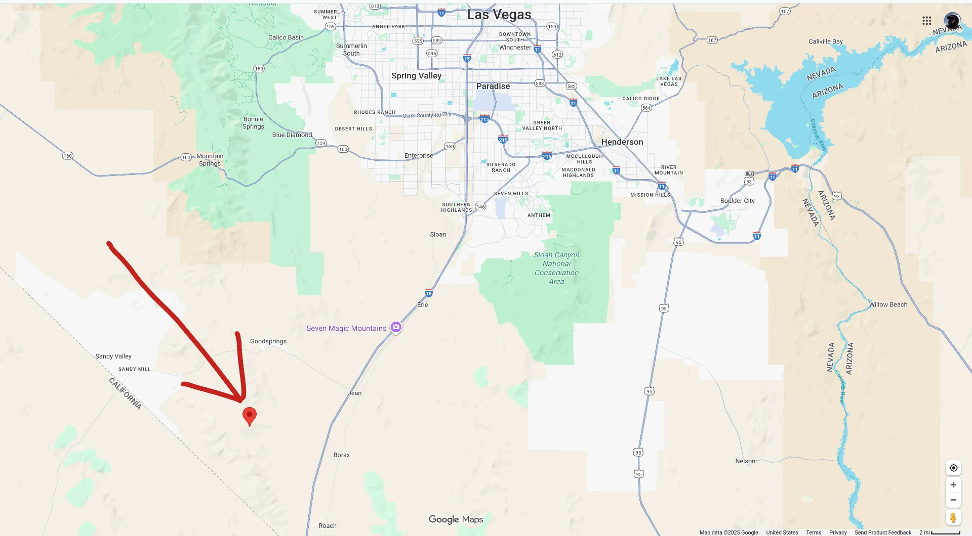

DEPARTING FLIGHT:

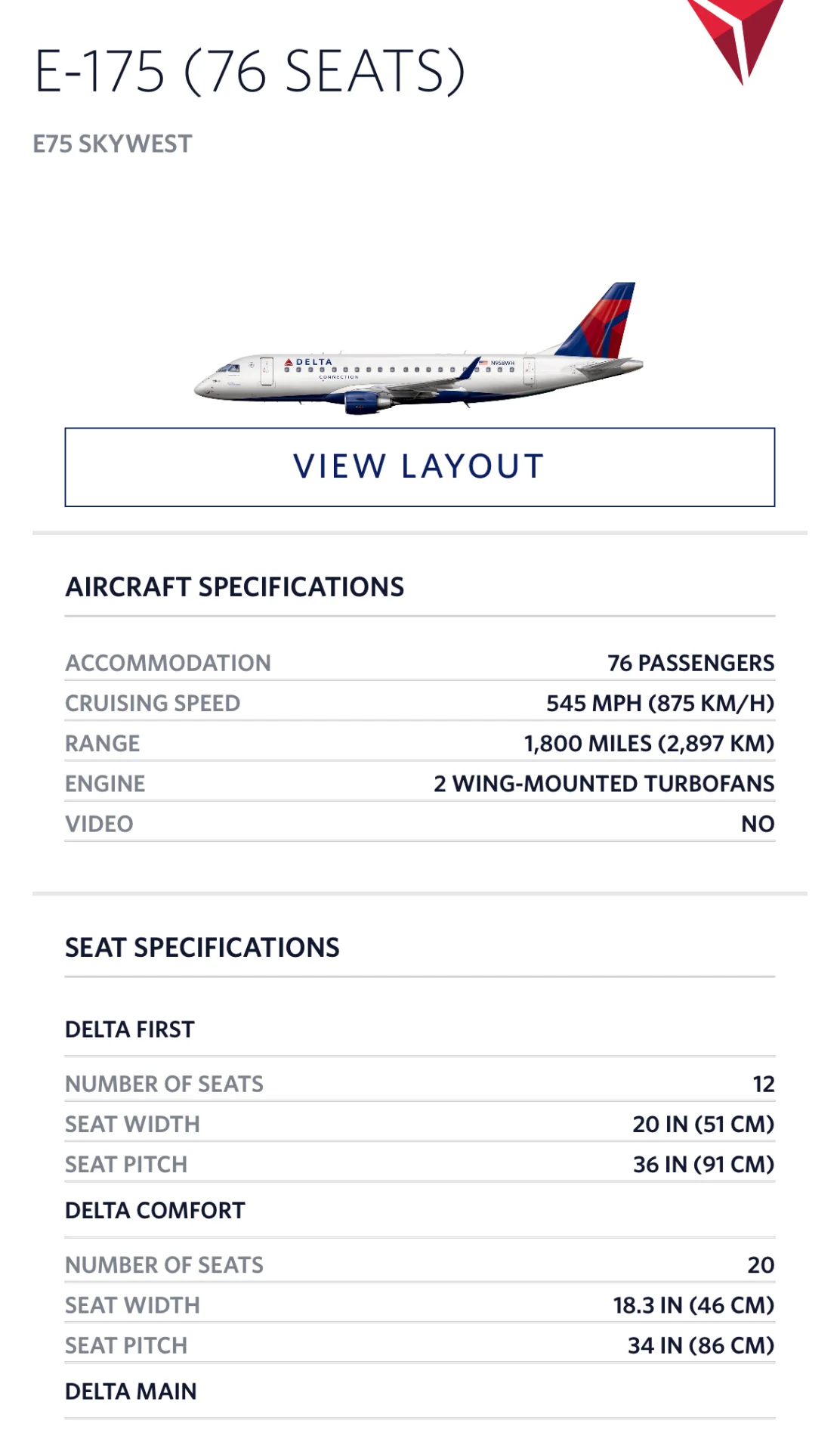

SMF to LAS Delta 4105 Embraer 175 3:00PM - 4:00PM (sunset 4:41PM)
Filming Location Seat: 1A (left side)
Final Approach: Borax, Nevada N35.744845 W115.458171

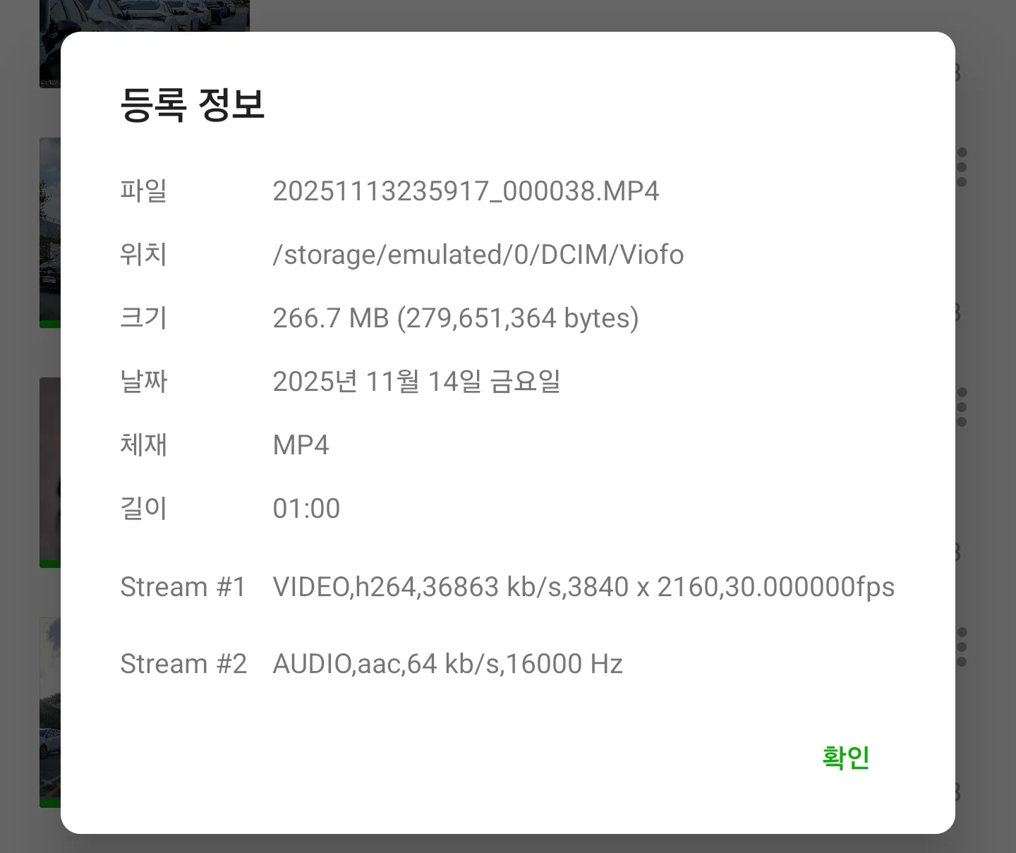

고맙습니다. 나의 A119M pro의 bitrate는 low, mid, high 입니다.
A119M Pro, high bitrate

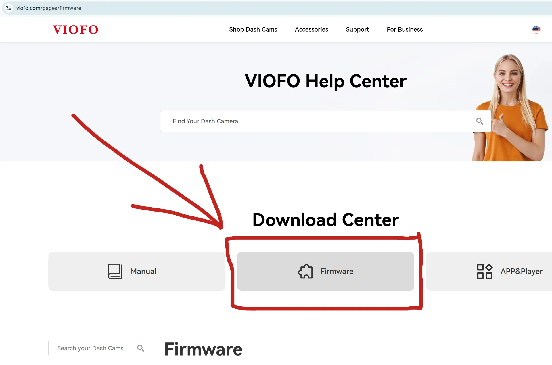

The “first official public firmware” will be published on the official Viofo website.

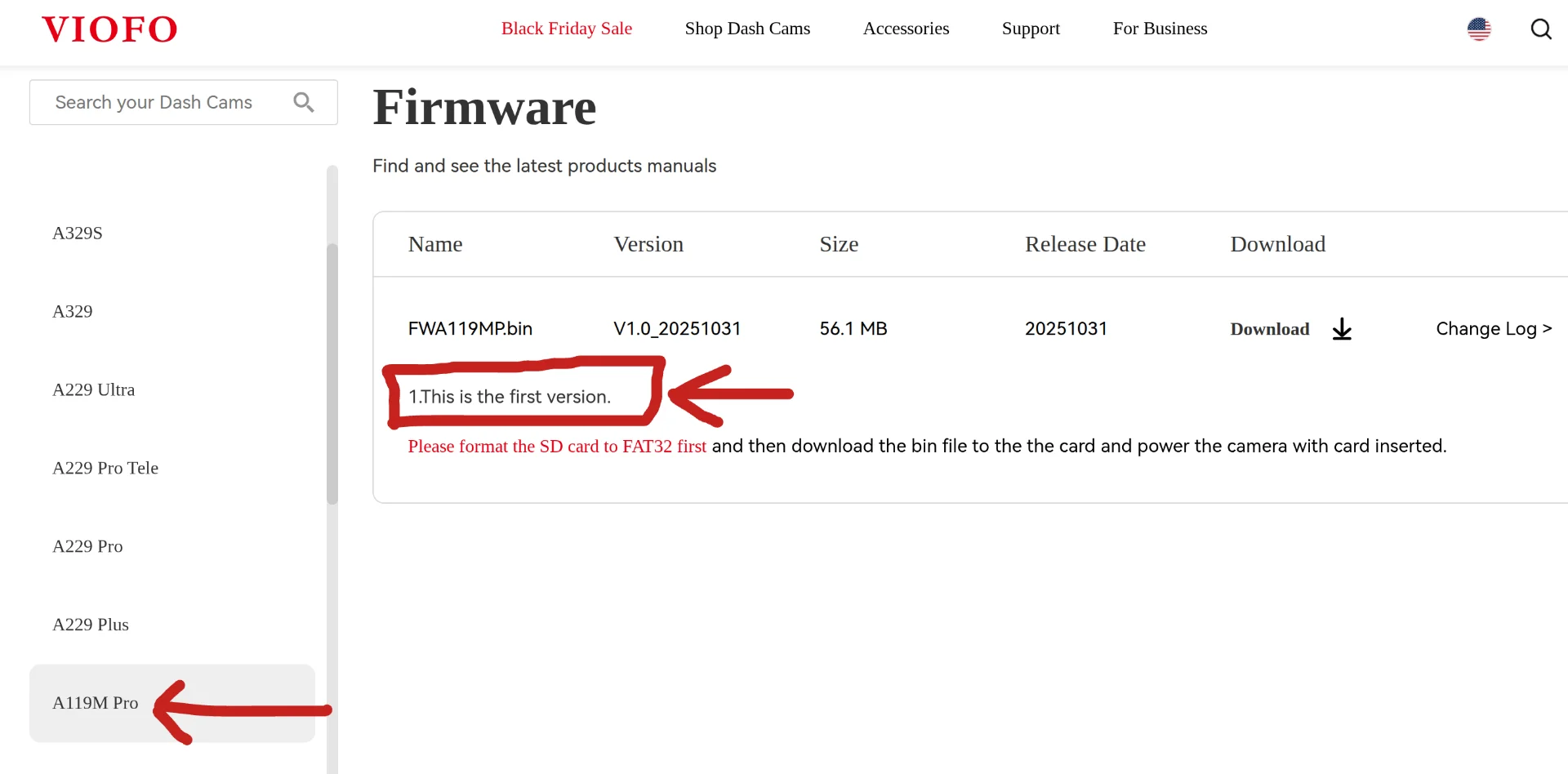

First Official Public Firmware: V1.0_251031
Change Log: “This is the first version.”
