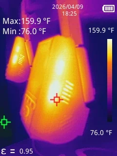

I measured power consumption, and operating temperature of both cameras with Wi-Fi OFF, and LCD Screen Off.
They both have similar power consumption around 3.7 Watts.
However the E1 Pro runs much hotter.
180℉ (82℃) E1 Pro
160℉ (71℃) A119M Pro
I re-tested this several times over 24 hours, and I was blown away they have the same power consumption, but the E1 Pro runs hotter.
The good news is I have not experienced any overheating malfunctions from either camera.

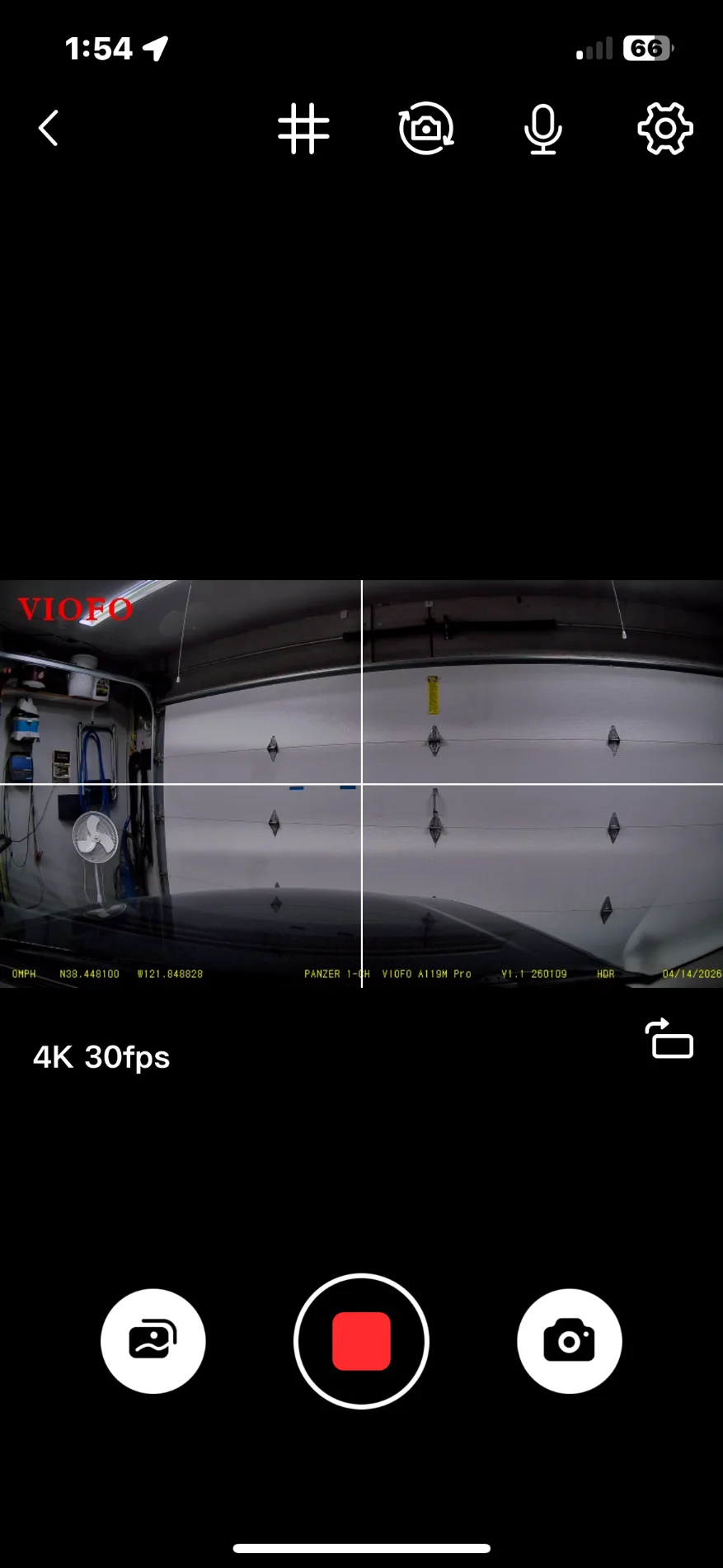

This is the first time I’ve had two “competing” dash cams that both have Live View Horizon Line Adjustment, (see attached screenshots)..
This makes lining up both cameras with identical Horizon Lines a breeze, so we have a fair comparison.
Those two pieces of blue painter's tape on my garage door represent “true horizon”.
We’ll see how close I am once the sun comes up, and I can gather DAYTIME test footage.

The Horizon Lines are not identical, and they’re around 51% Sky 49% Road.

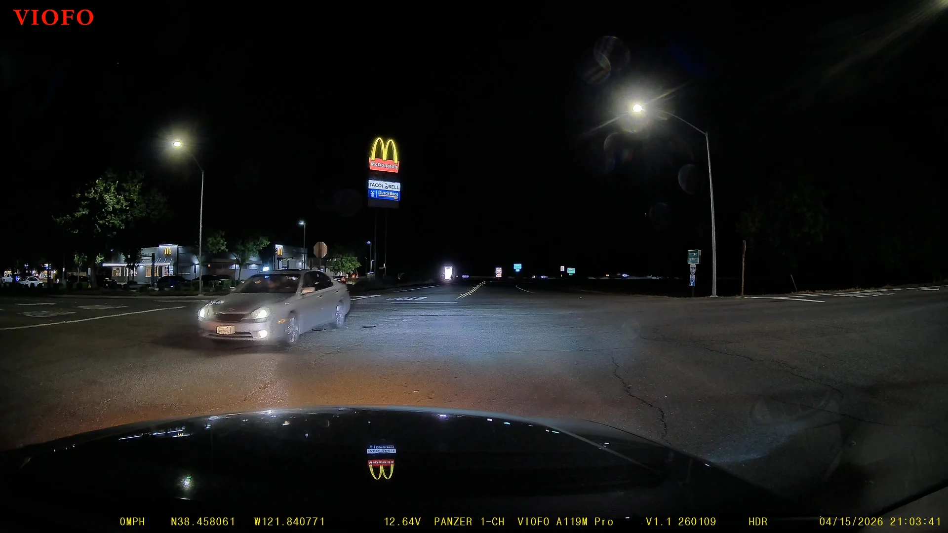

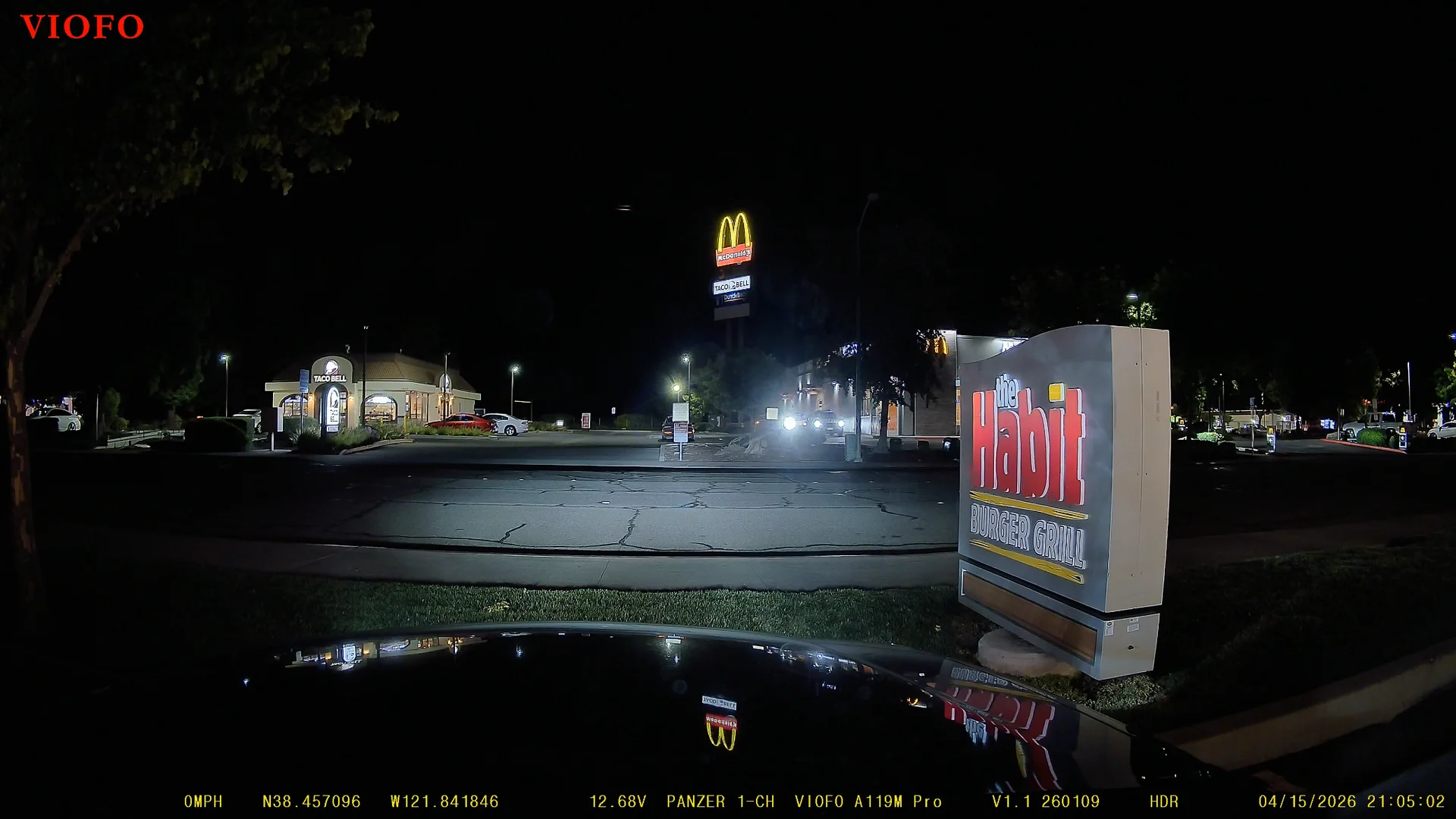

Round 1: FIGHT!
I was sure E1 Pro was going to win this round with PlatePix, but I may have found a limitation.
Not only does A119M Pro get the plate but, the entire frame of footage is much brighter.
California Plate# 5PXD596 2005 Lexus ES330
You can see the Lexus around 9:30:40PM in the videos.

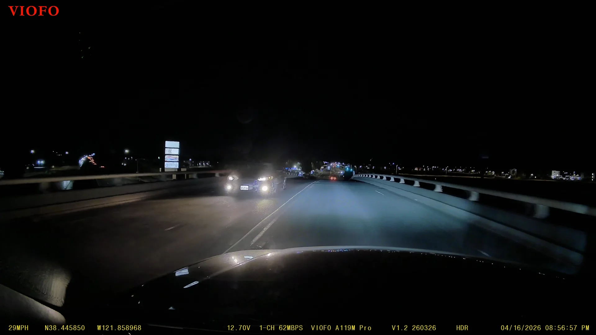

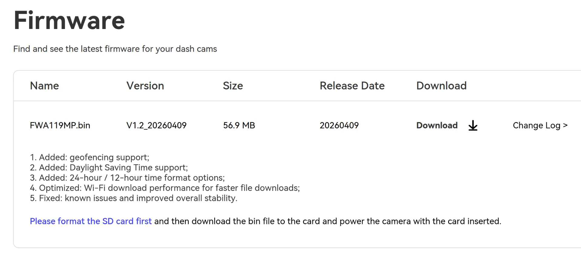

My prayers have been answered 🙏
I’ve been hoping for this since August 12, 2025, (9 Months).

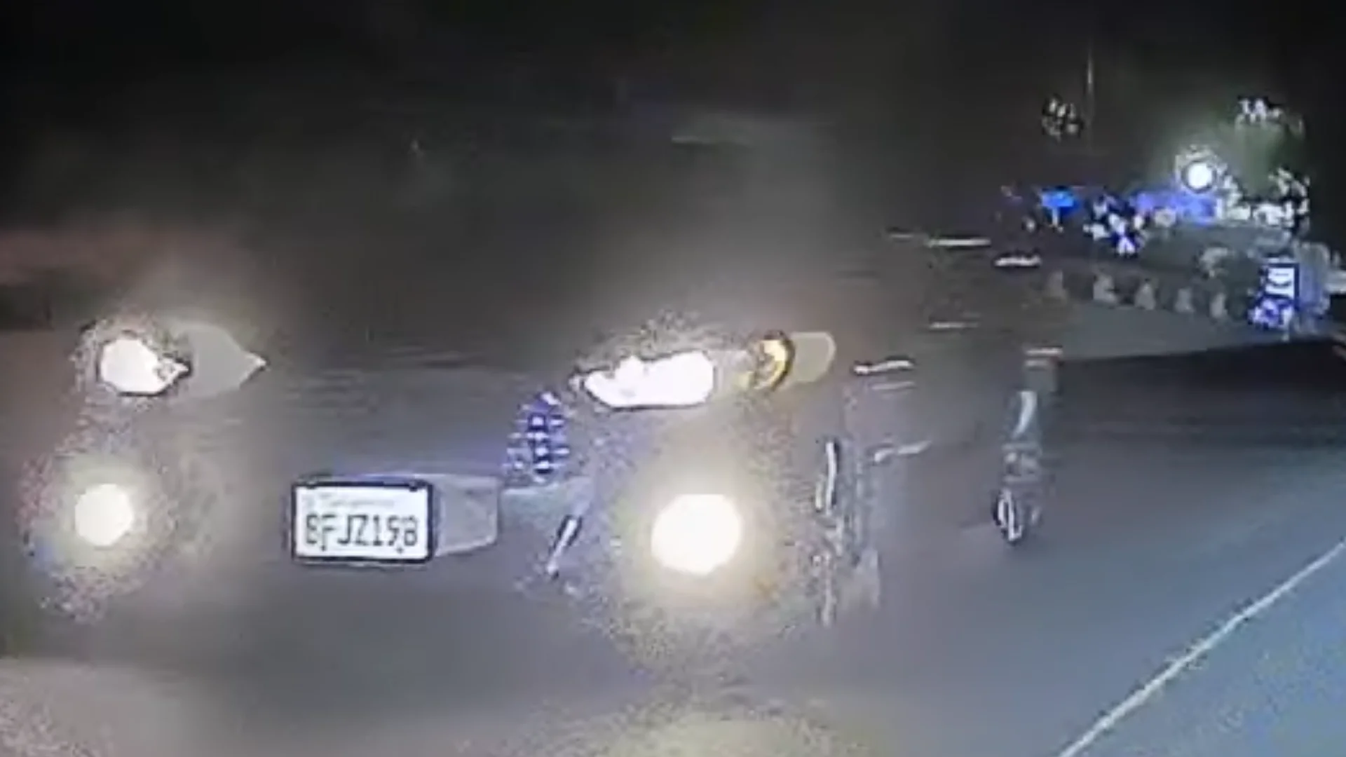

We finally got proper Bitrate with OFFICIAL FIRMWARE V1.2_20260409.
It’s now approximately 62Mbps, (previously 37Mbps).
This is HUGE!!!
Thank you very much @viofo @VIOFO-Support
Now we just need LPID.
What’s the difference between 62Mbps & 37Mbps Bitrate?
See for yourself.
CA Plate# 8FJZ198 2015 Ford Fusion
Here’s the videos the screenshots were taken from.
