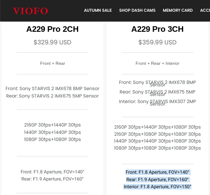

1.) The Front camera is “wider” than the Rear camera despite their specifications.
In the specifications, the manufacturer always indicates the diagonal angle.
So, with resolutions of 2560x1440 and 2560x1080, the horizontal angle will be the same, but the diagonal angle will be different.

In this post I would like to compare the Horizontal FOV of the Front, Rear, and Interior camera.
The A229 Pro 3-CH has a specification of 140° + 160° + 150° + “Wide Viewing Angle”.

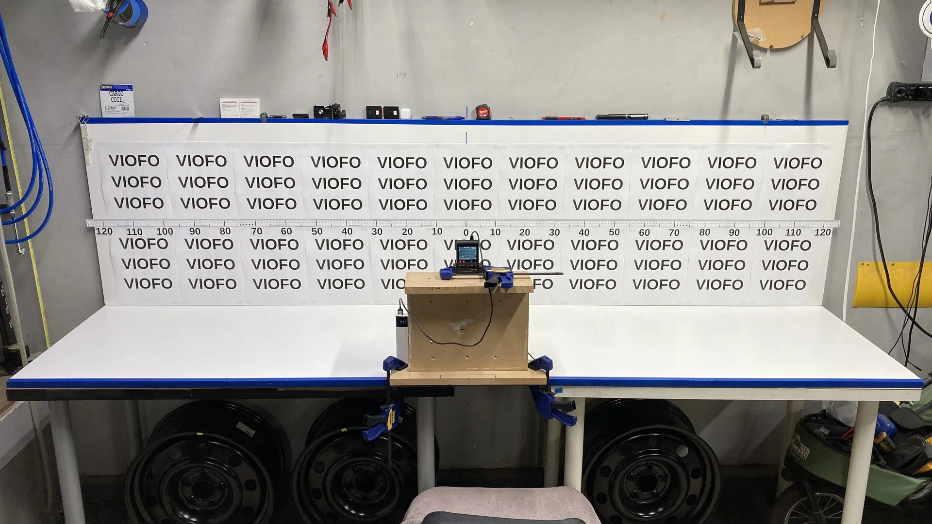

I updated my work bench with more wallpaper, and a ruler.
I’m hoping the additional wallpaper will help identify focus issues.
I’m hoping the ruler will make it easier taking measurements.

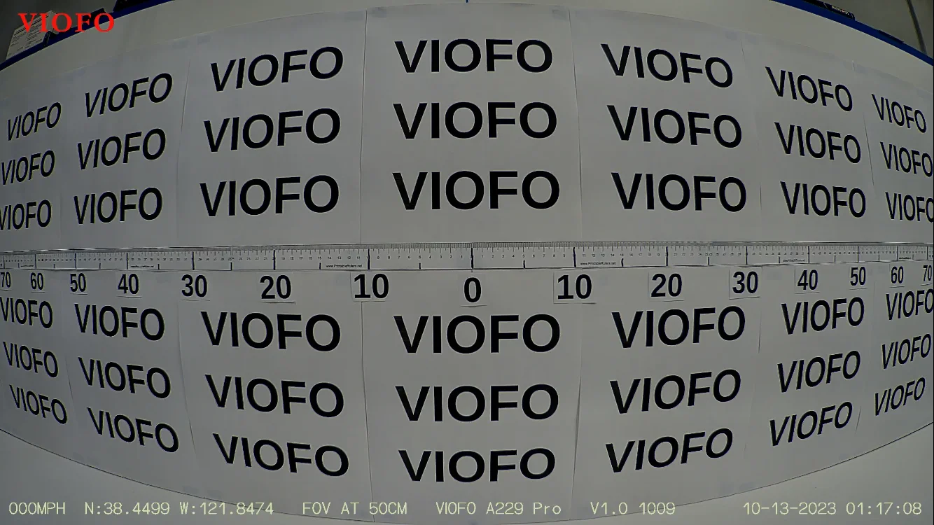

I adjusted the distance of my platform jig so the camera lens is 50 centimeters from the wall.
Shoutout to @Karagandinez and @gse for helping me with that.
I made a new platform jig because @Nigel complained the camera lens was not the same height as the ruler.
The jig is now 11 inches tall, the same height as the bottom of the ruler.
The center of the lens is the same hight as the center of the ruler.
I made sure the jig was “square” with a level, if the image looks "tilted" it’s possible the lens in not “aligned”.

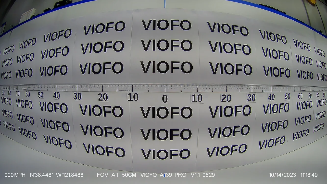

Here are the Horizontal measurements in the center of the recorded footage;
Front: 148.5cm
Rear: 143.5cm
Interior: 180cm
Interior LED’s On: 80cm
Shoutout to @DT MI for telling me about Right Triangle Calculator, and @rcg530 for helping me understand it.
Now that we know the Horizontal measurement, and the distance from the lens to the wall we can calculate each camera’s Horizontal AOV.
Here are the “true” Horizontal AOV’s;
Front: 112°
Rear: 110°
Interior: 122°
Interior LED’s On: 77°
Looking at the screenshots three things stand out to me;
2.) It looks like the Front camera might be out of focus on the far right side.
3.) When I turn off my garage lights, and the Interior IR LED emitters illuminate the AOV is reduced, and a lot of information is lost on the sides of the image.

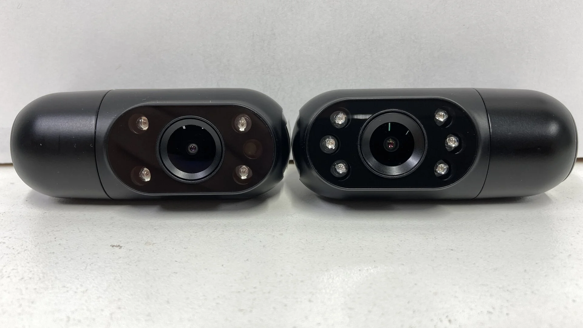

IR INTERIOR CAMERA COMPARISON - PROS & CONS
In this post I would like to compare the IR Interior cameras of the A229 Pro & A139 Pro, with their Pros & Cons.
A229 Pro Image Sensor: STARVIS 1 (IMX307) 1080P
A139 Pro Image Sensor: STARVIS 1 (IMX291) 1080P
A229 Pro FOV: 122°
A139 Pro FOV: 124° (2° wider)
A229 Pro IR LED Emitters: 4
A139 Pro IR LED Emitters: 6
During good lighting conditions when both cameras are in full color mode the A229 Pro appears blurry / fuzzy across the entire image.
The A139 Pro appears tack sharp, and just overall “better”.

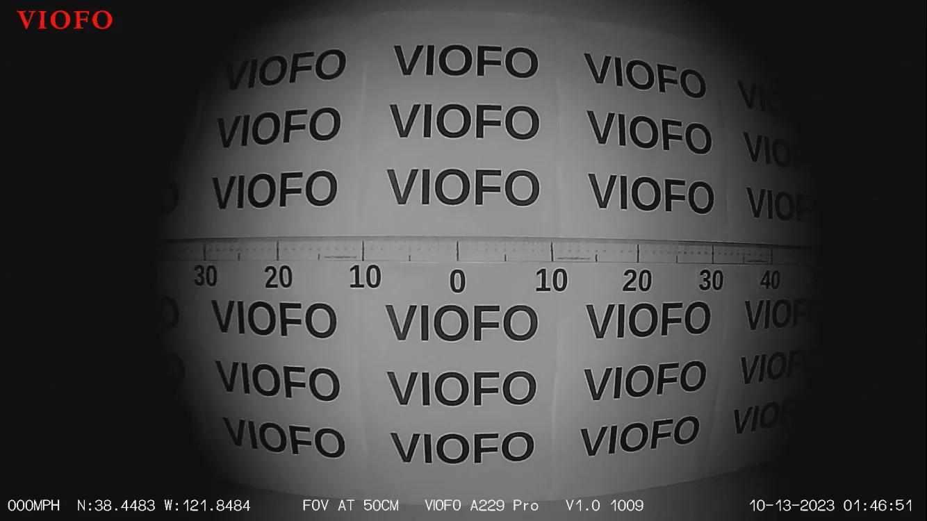

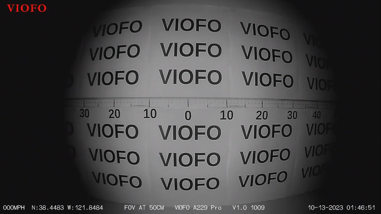

During poor lighting conditions when the IR LED Emitters are illuminated, and the cameras switch to Black & White mode the A139 Pro becomes blurry across the entire image.
The A229 Pro becomes tack sharp.
It’s almost as if the A229 Pro is “tuned” for poor lighting conditions, and Black & White mode operation, and has sacrificed a small portion of it’s “daytime” full color mode image quality.
Also take note of the A229 Pro’s reduced FOV in Black & White mode operation due to only having 4 IR LED Emitters, compared to the A139 Pro’s 6.
A229 Pro B&W FOV: 84°
A139 Pro B&W FOV: 98° (14° wider)

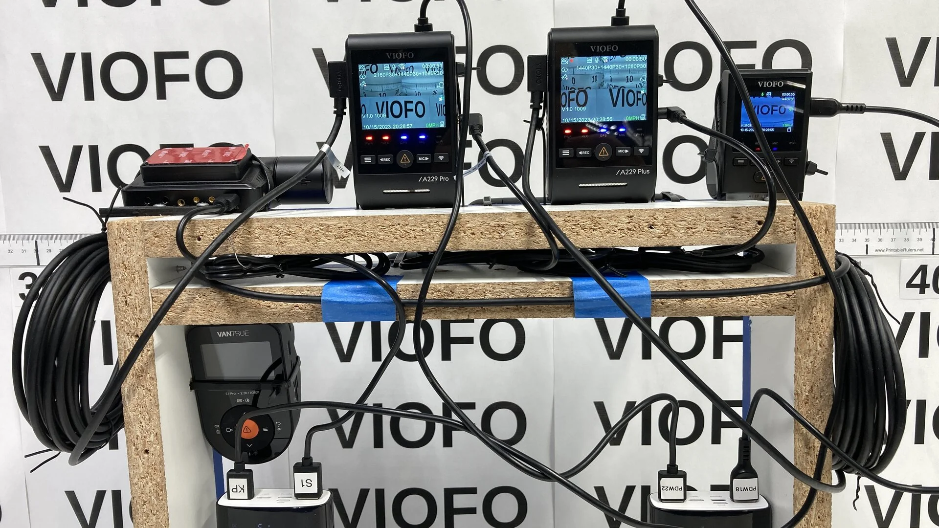

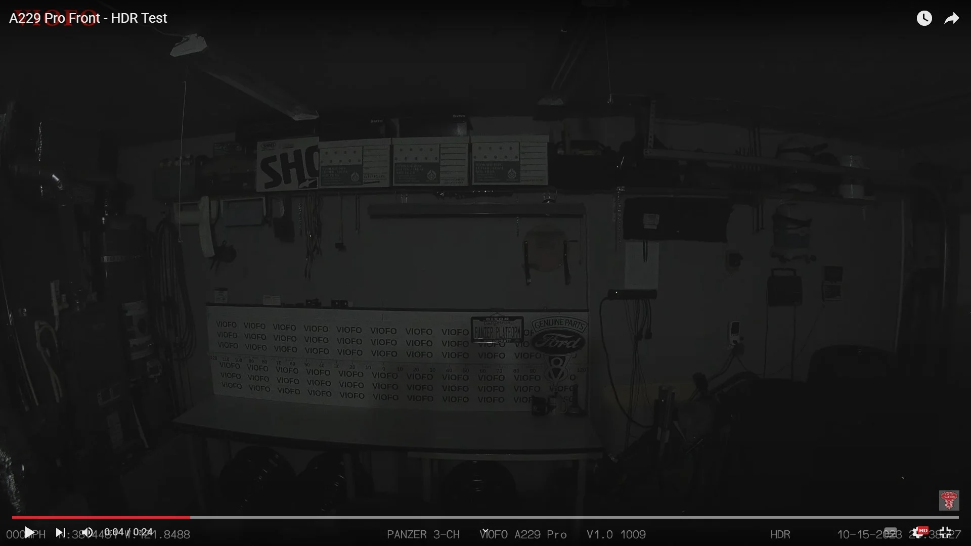

HDR Comparison with Firmware Update V1.0_231009 + V1.0_230928
@rcg530 @safedrivesolutions @Vortex Radar @viofo @VIOFO-Support
Keep in mind this comparison is not enough to judge final HDR performance, it’s just a reference.
The final test will be with cameras installed in a moving car trying to resolve other moving objects.

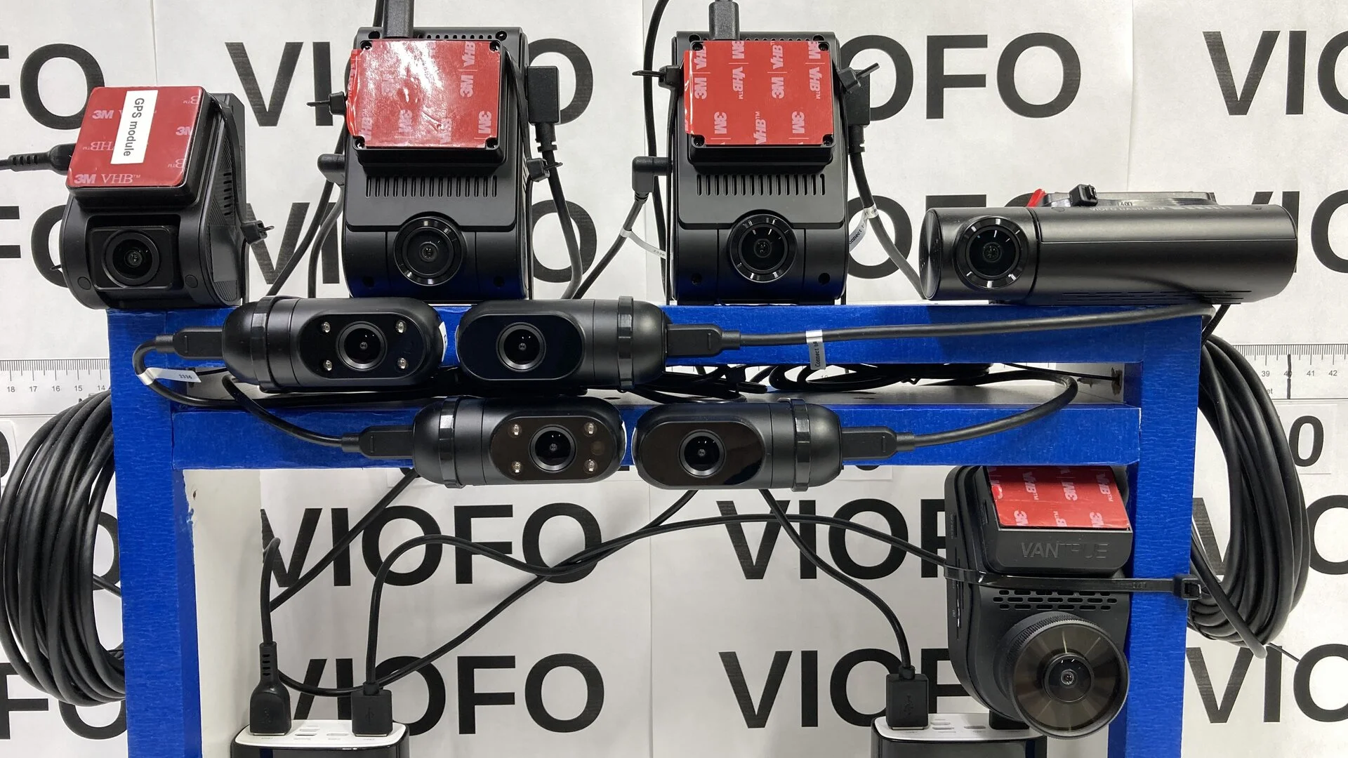

Cameras on the rig;
A229 Pro 3-CH (IMX678) + (IMX675) + (IMX307)
A229 Plus 3-CH (IMX675) + (IMX675) + (IMX307) V1.0_231009 + V1.0_230928
A139 Pro 1-CH (IMX678) V1.1_0629
A119 Mini 2 (IMX675) V1.0_20230912
Pay no attention to that man behind the Vantrue S1 Pro.

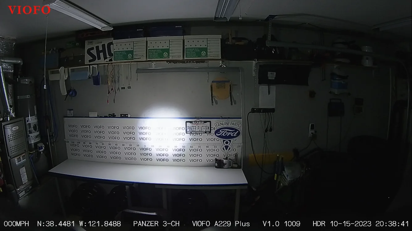

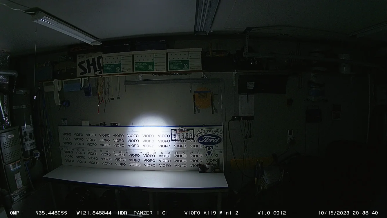

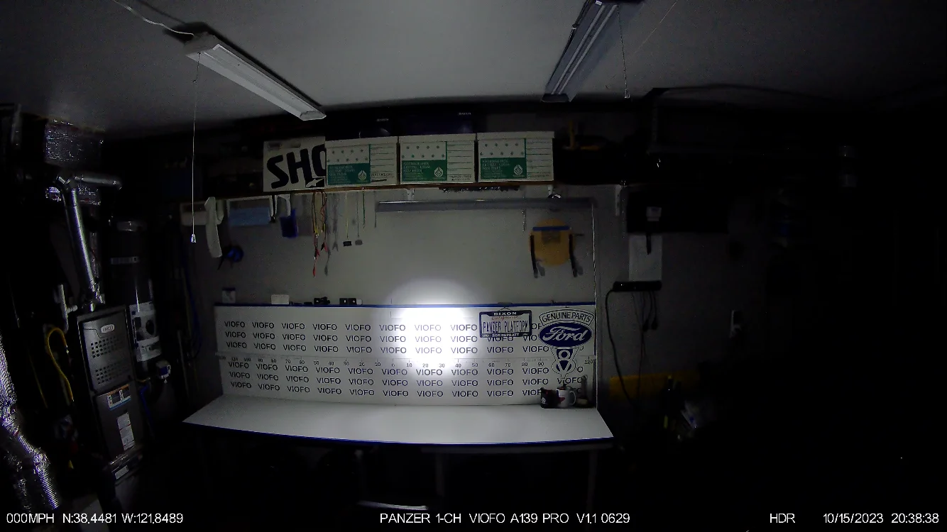

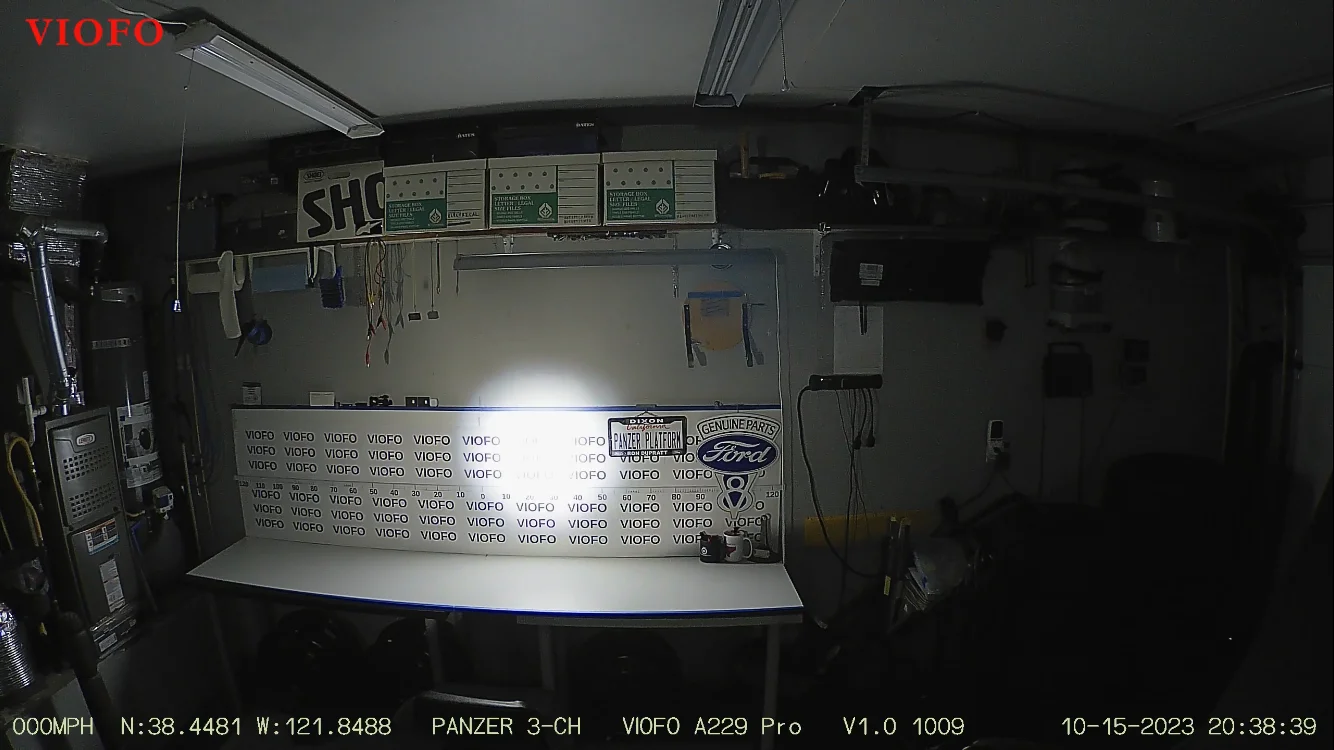

Here are the comparisons being performed;
Remarks:
A229 Pro Front: .....Unacceptable - Corrective Action Required
A139 Pro 1-CH: .....Acceptable - .....2nd best HDR performance I’ve ever tested.
A229 Plus Front: ....Unacceptable - Corrective Action Required
A119 Mini 2: ...........Acceptable - .....Best HDR Performance I’ve ever tested.
A229 Pro Rear: ......Unacceptable - Corrective Action Required
A229 Plus Rear: .....Unacceptable - Corrective Action Required
A229 Pro Interior: ...Acceptable
A229 Plus Interior: ..Acceptable
Conclusion:
Dear Viofo, whatever secret sauce you put on the A119 Mini 2’s HDR please put it on the;
1.) A229 Pro Front
2.) A229 Pro Rear
3.) A229 Plus Front
4.) A229 Plus Rear
I know you can do it because the HDR on the INTERIOR camera works.
Until we get an acceptable public firmware to fix basic HDR performance gathering “driving” test footage is almost a waste of gas.
I don’t think my request is unreasonable.
Please make the HDR performance as good, or better than the A119 Mini 2.
-Chuck

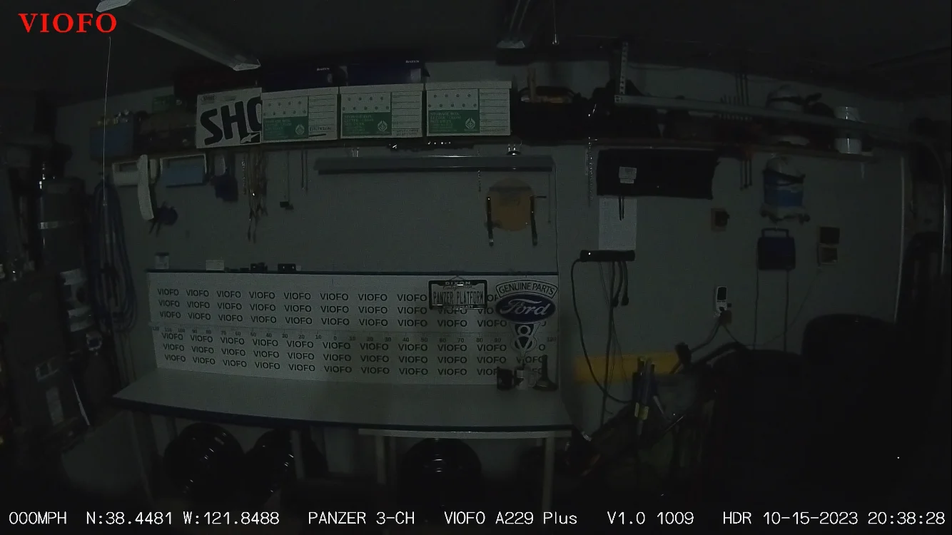

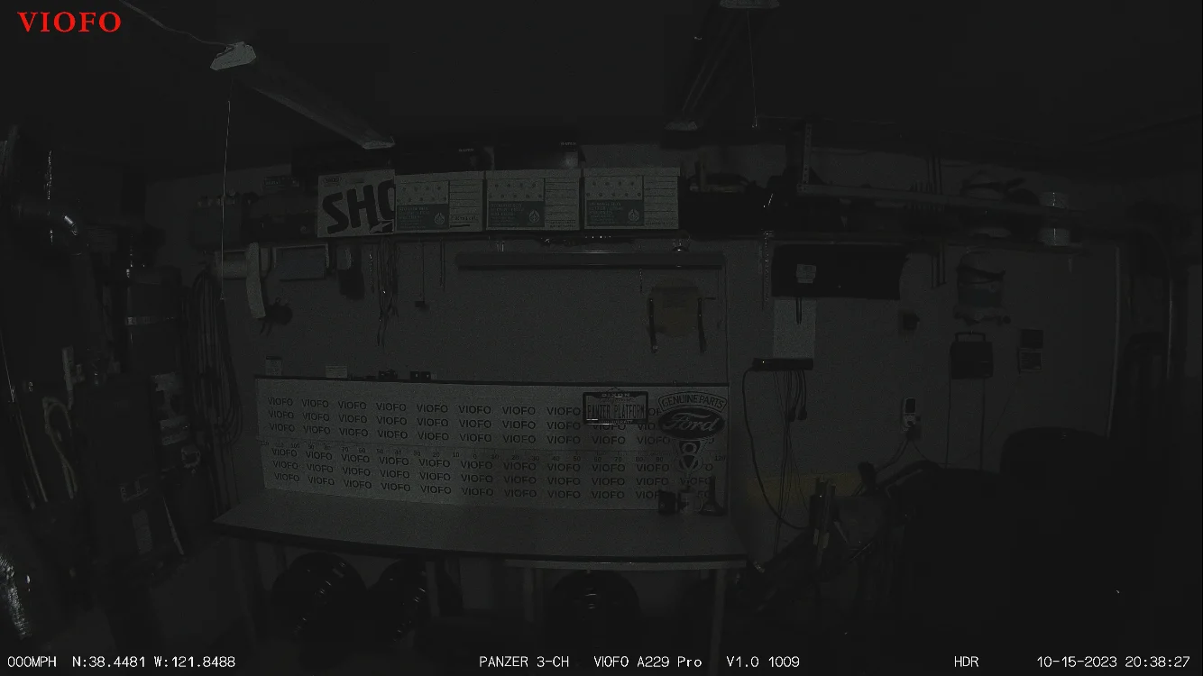

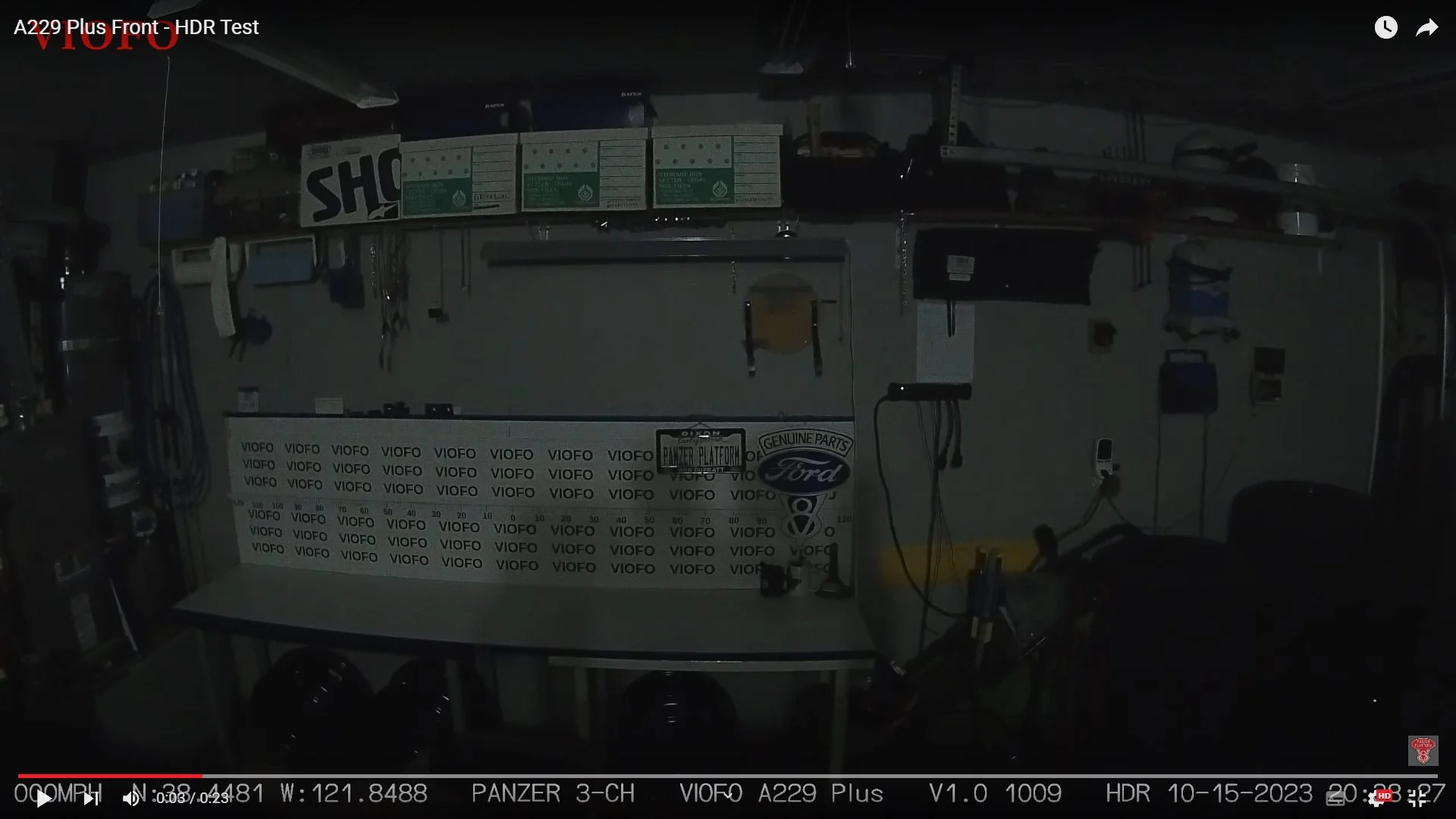

Q: Which camera has better “Low Light Sensitivity” A229 Pro 4K (IMX678), or A229 Plus 2K (IMX675)?
A: You make the call.
Btw, Horizontal FOV is;
A229 Pro: 112°
A229 Plus: 102°
Q: Why does the A229 Plus have better Low Light Sensitivity?
A: I’m confident @Nigel will along any minute to tell you why.

A229 Pro has only just come out so I'm sure they can eke some more performance out of the sensor. It has Imx675 at the back so that's not bad either when there's the imx678 up front. Would have been nice to have the better night sensor up front too, but with a lot of things in life you can't have it all..
I think it is just the exposure settings that Viofo have set in the firmware, the sensors are very similar, with the 4K Pro sensor probably able to manage slightly better sensitivity if Viofo turn it up a bit.
The darker image on the Pro may mean that it is using a faster shutter speed, which would mean that it is the better camera for motion blur - can you add some motion blur into your test so that we can see?
Those light levels are not important for most people, except those that use overnight parking mode, motion blur tends to be a very big issue because there is lots of it.
There does seem to be more noise in the Pro image, but that may be due to it using a higher gain level, which again may result in less motion blur, can't tell without a motion blur comparison in those conditions. So can't say which I prefer.
that's a fair difference
someone said that 4K cams seem to be worse with Night/ Low Light sensitivity than the 2K versions.
It was explained to me by Viofo (Bill) when I performed this test 2 weeks ago that comparing the low light sensitivity of a 4K dash cam to a 2K dash cam is not a “fair fight”.
The 2K dash cam will always have better low light sensitivity.
A 1080P dash cam will have better low light sensitivity than a 2K dash cam.
Based on my testing I find this to be true, (Nigel you let me down). lol

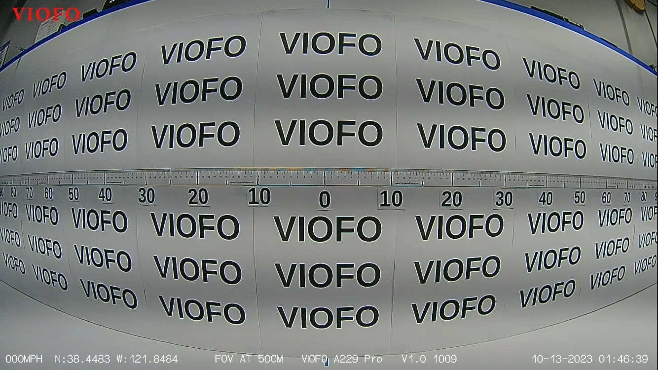

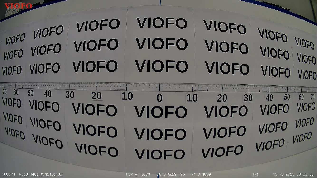

I just got done measuring 14 different Viofo dash cam FOV’s.
Not a single one is accurate to their listed specification.
What if they’re fudging the numbers on Aperture specs too?
How do I confirm & verify the Aperture specification?
From now on, all specifications must be confirmed & verified, and until they are I have zero faith in trusting any listed specification.

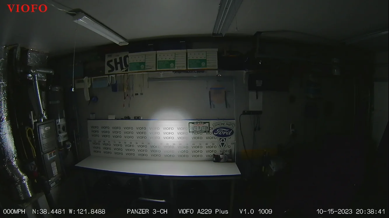

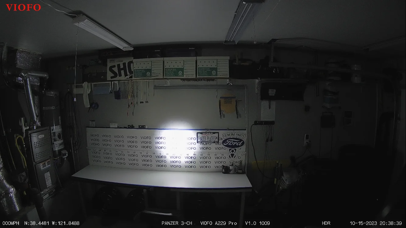

As Nigel said, the difference is not just between the two sensors. The DSPs are not the same, and the FW may be tuned for different results - a trade-off between motion blur and noise.

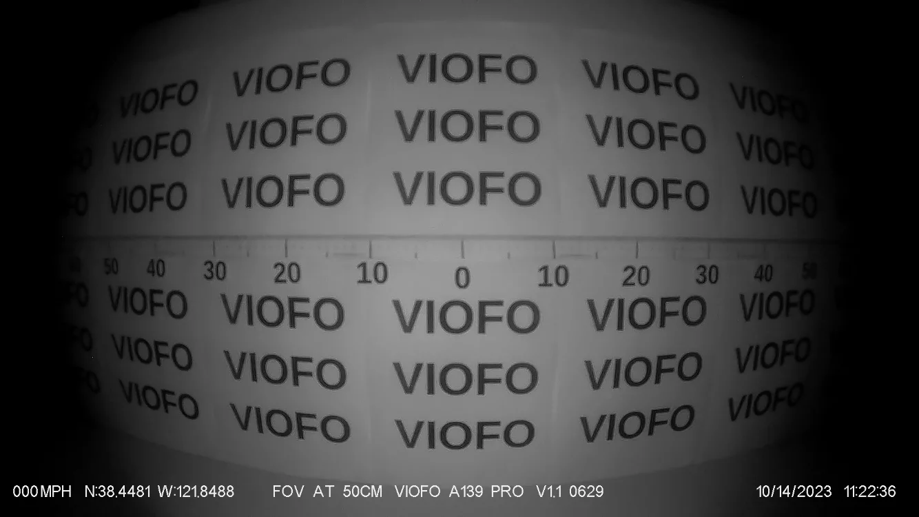

Despite using the same sensor, there are differences between the A229 Pro (IMX678) and the A139 Pro (IMX678).
The A229 Plus (IMX675) is darker than the A139 Pro (IMX678), but the A139 Pro is more fuzzy.
