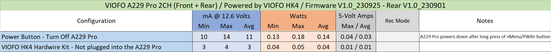

When it comes time to perform my power consumption tests I wonder how many milliamps the GPS Mount draws when the camera is connected with a hardwire kit, and powered down by long pressing the power button on the camera.
I wonder if @rcg530 already measured this.

Yes, it's part of my power consumption chart. Here's that section from the chart.

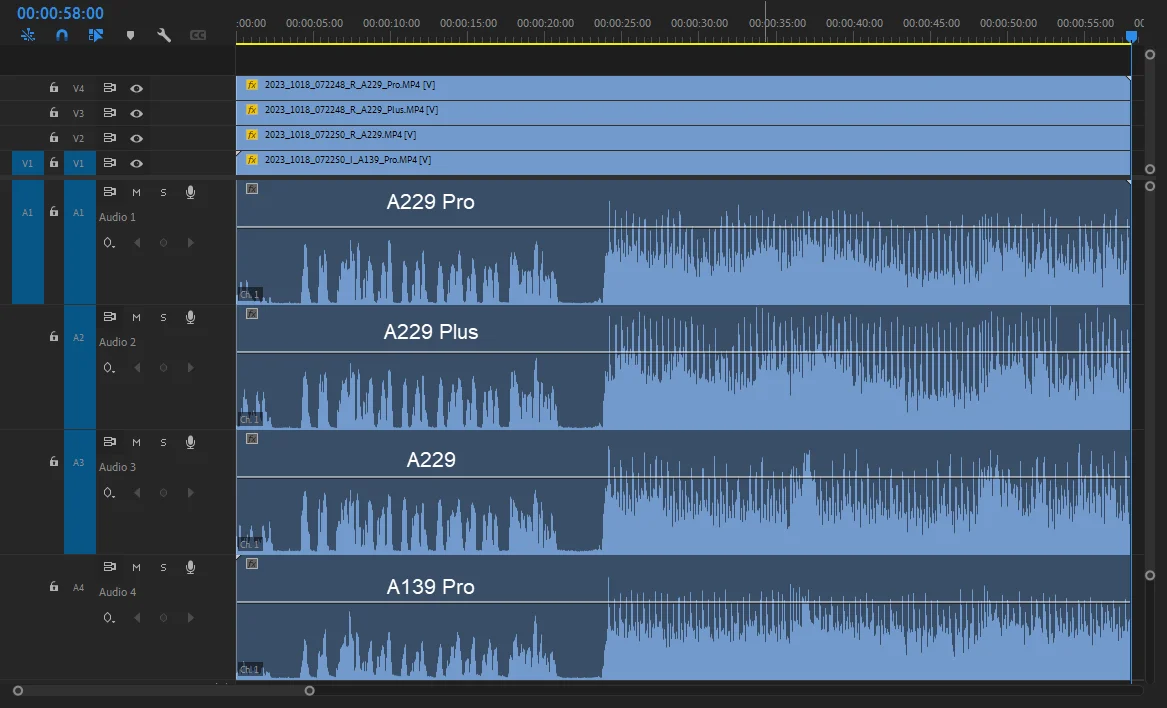

Here’s my in car audio comparison.
The Original A229 Duo has the loudest, and clearest audio volume level.
The A229 Pro & A229 Plus are slightly quieter.
The A139 Pro is quieter than all.
I wonder how much the External Microphone will improve the Original A229 Duo & A139 Pro.
Here is an analysis of the audio by @rcg530
Shoutout to Robert for helping me with this comparison.

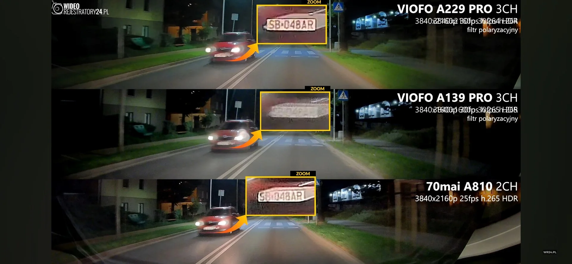

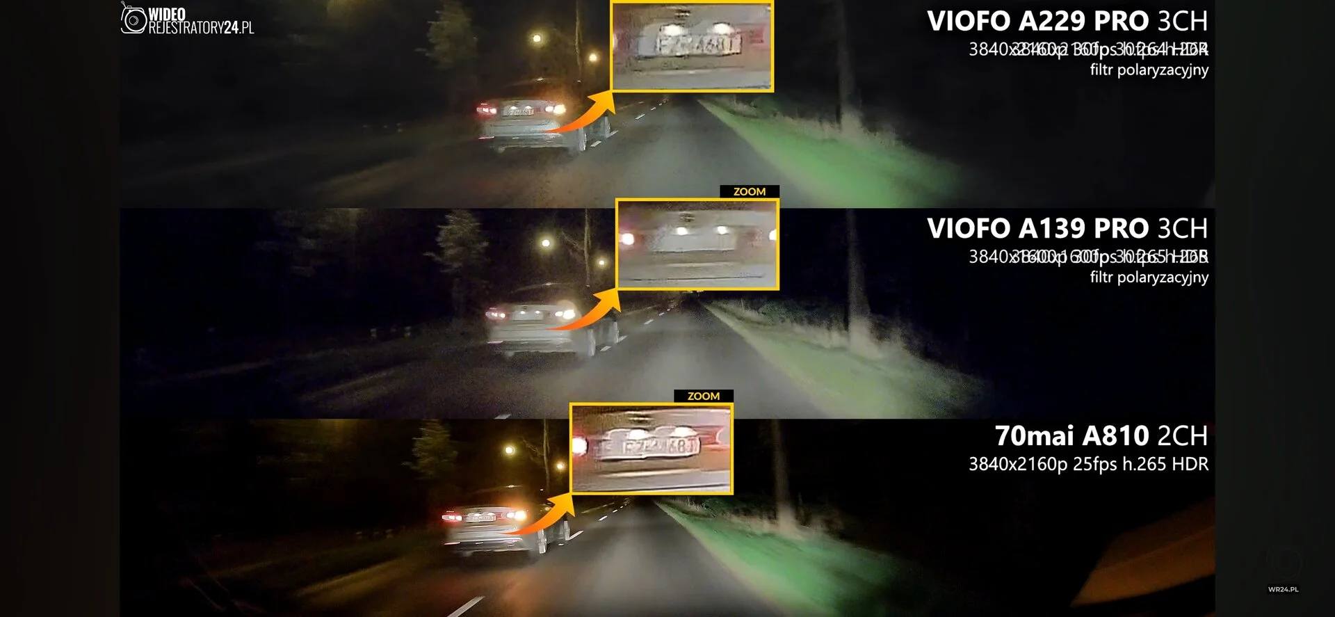

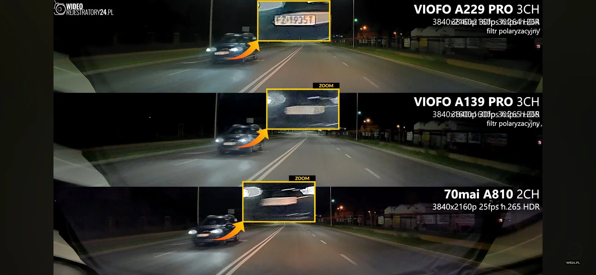

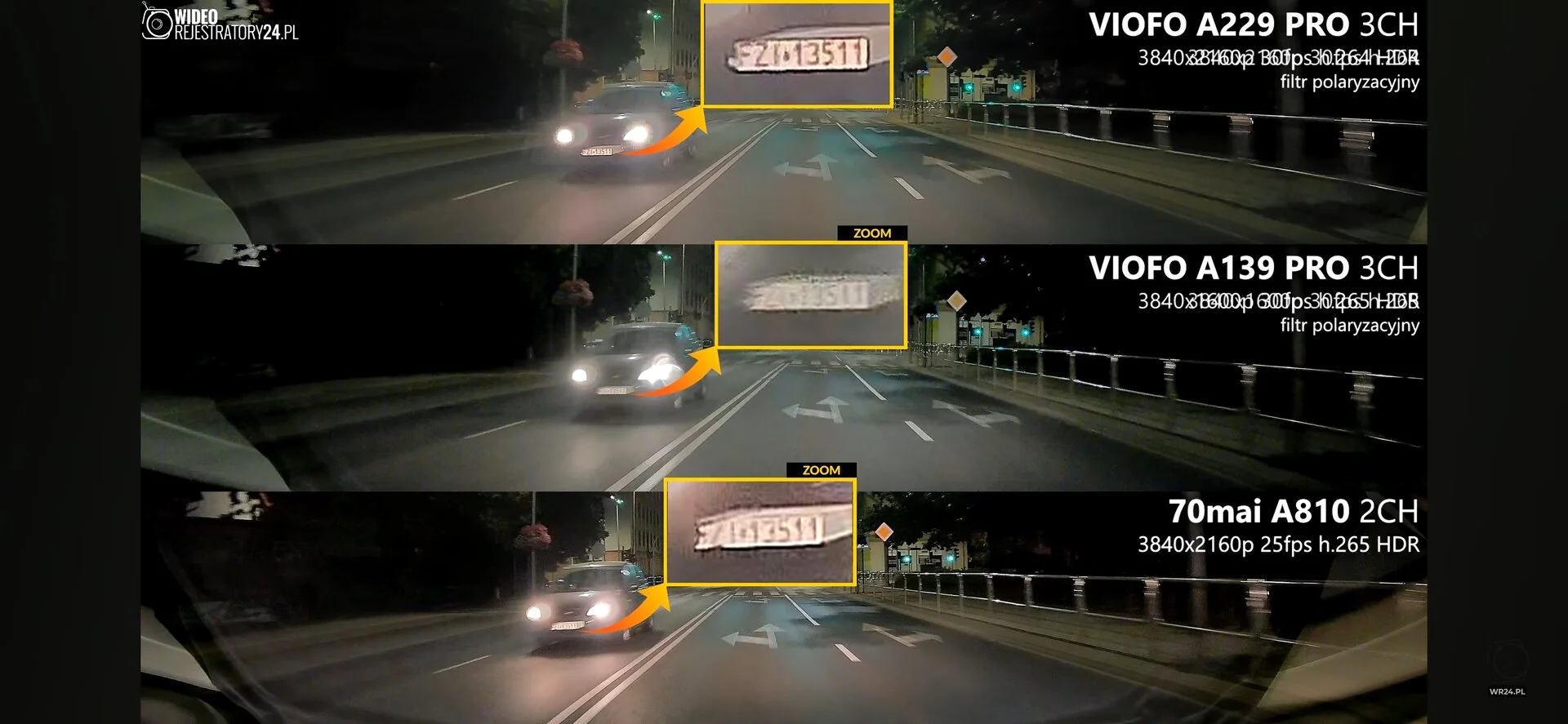

Night vision is simply not cutting it. I have night time video as well. Lots of it. Lots of different versions of the video as well. Everytime the 229 Pro has not kept up to A139 Pro.
Well, according to this pictures, this not quite true.
No idea where your A139 Pro is mounted but I can light up the A229 Pro so bad with night time footage. I have moved the A229 Pro 3 different locations on windshield plus who know how many firmwares I have updated to now.
I am going to say this on record “The Vantrue N4 Pro has better night vision than A229 Pro” i got lots of footage to prove it.
I am a Viofo reseller so it’s a bold statement.
It is taking 5 seconds to adapt when entering a tunnel. The main problem is HDR. When you even look @Panzer Platform videos in his garage you can tell it is not working well.
But who knows. Like I said to Bill @viofo maybe this first run they sent us is not performing well.
I am waiting to hear back as I have sent them more raw video files.
That is not my video. I know for sure that the man behind that YouTube channel it also a member here, but I don't know the nickname to quote him.
I would like to hope it was a bad run early on a few of us testers got.
But we do not know. And if i put out a review. My A139 Pro performs better at night then N4 pro and a229 pro.
So who knows….

Apart from A139 Pro they're all performing quite well, and not bouncing off the limiter that much which is the most important thing. No distortion either.
The A139 Pro with EXTERNAL microphone will outperform all three A229's BUILT-IN microphone.
But I didn't use the External mic on the A139 Pro in this comparison because it wouldn't be fair.
But I didn't use the External mic on the A139 Pro is this comparison because it wouldn't be fair.
Obviously it would but honestly it's not a hard ask to get a stereo mic put in a dashcam, surely. The focus isn't audio so of course has been overlooked for all these years. We can put them in phones yet not dash cams.

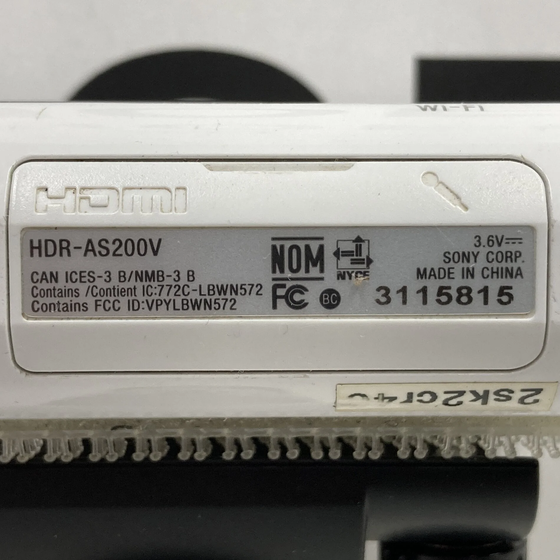

Eat your heart out, Mister. Lol
I’ve been using this action cam since 2015.
All my YouTube videos are filmed with it.
It just won’t die.
