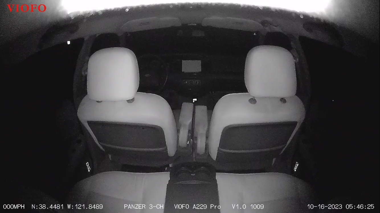

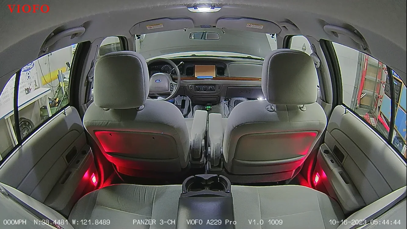

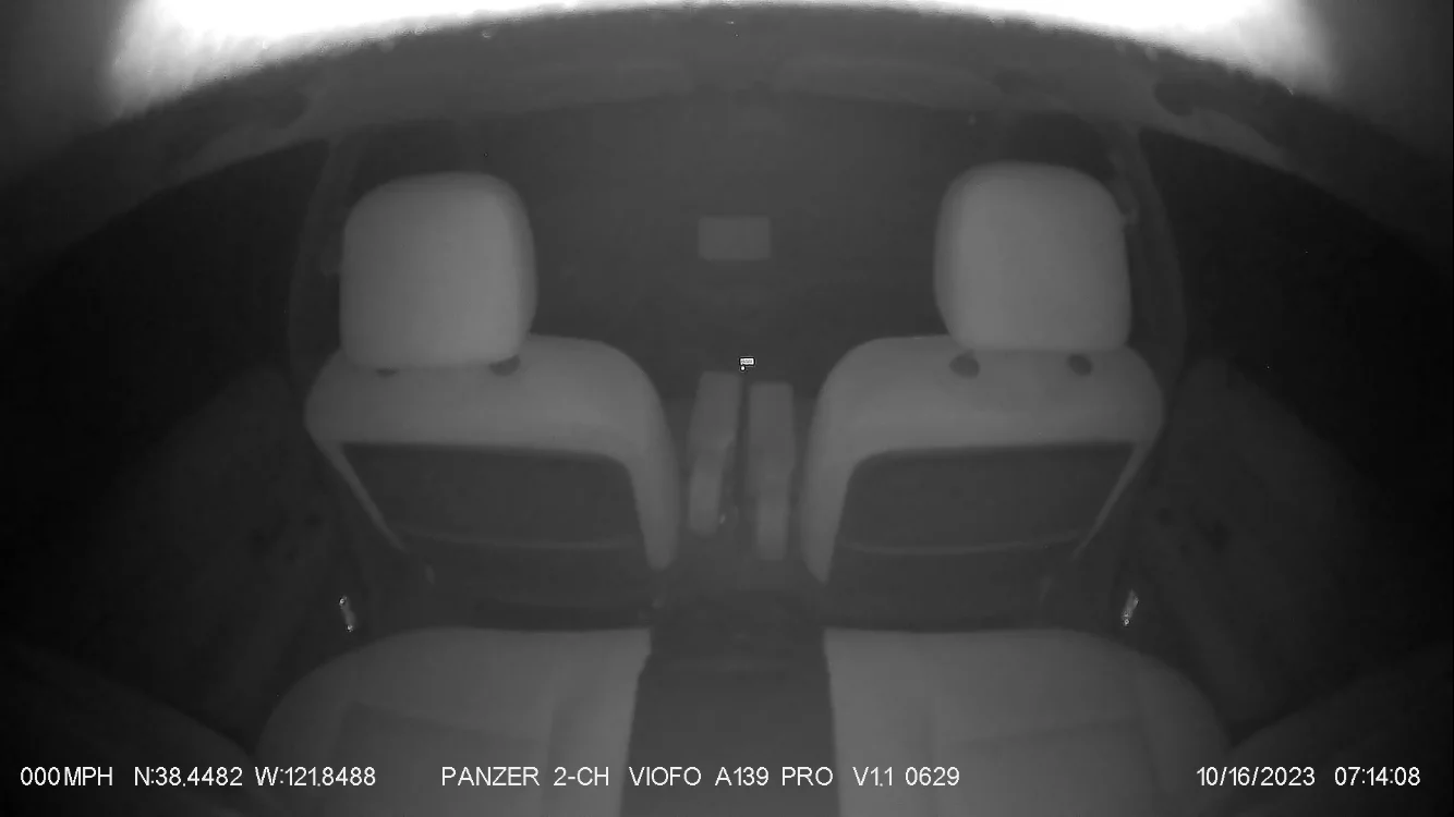

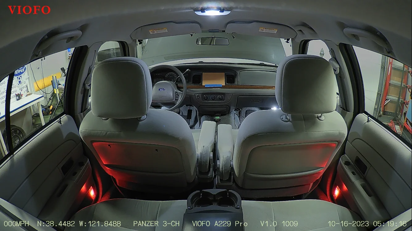

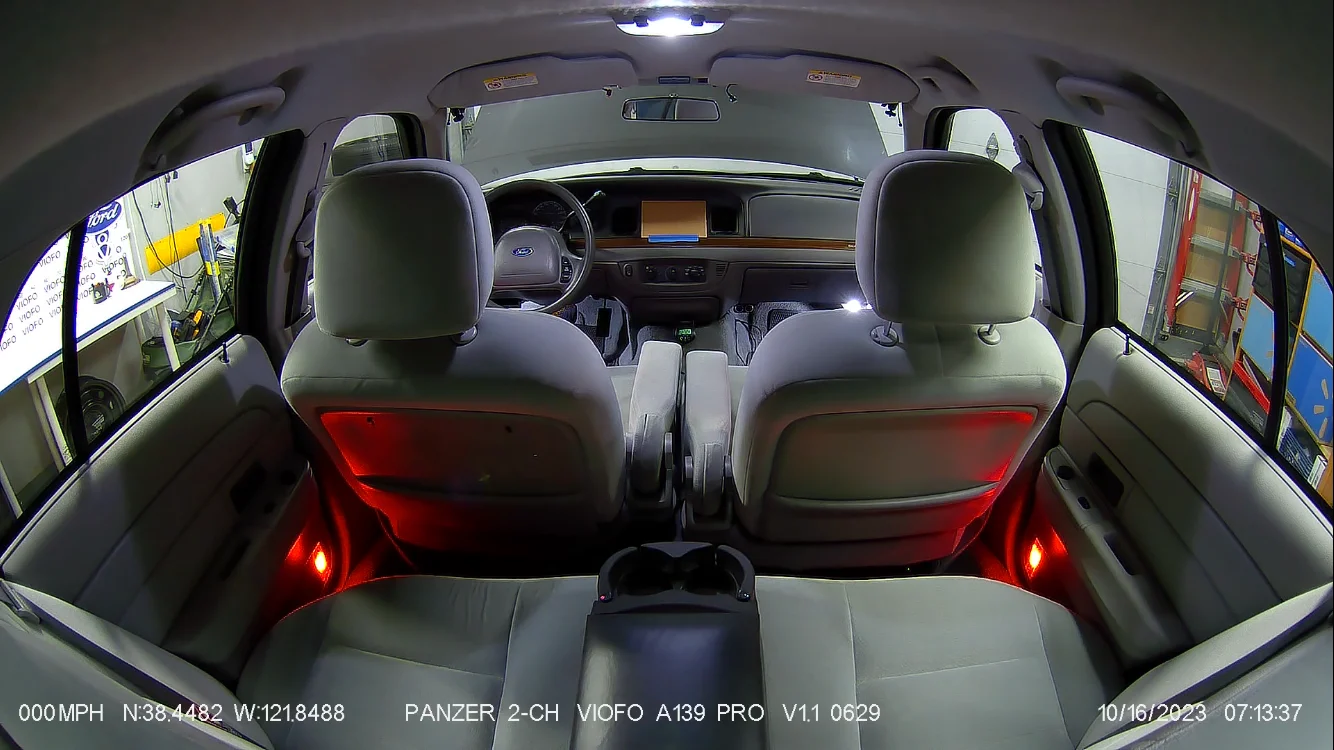

Passenger Compartment FOV Comparison
Q: What does the Horizontal FOV difference look like when installed in the rear passenger compartment between these cameras?
A229 Pro Rear ……………….110°
A229 Pro Interior …………….122°
A139 Pro Interior …………….124°
A229 Pro Interior IR LED’s …84°
A139 Pro Interior IR LED’s …98°
A: I thought you’d never ask.
Each camera was installed in the same location by using the original mount from the A229 Duo that was already installed on my rear window by removing / reinstalling the 3 screws that hold the camera in the mount.
The original A229 Duo, A139 Pro, A229 Pro, A229 Plus all use the same Rear & Interior camera case / mount.
But faffing between 3 different cable connections quickly turned into a logistical nightmare, (2 different size Coax & USB Type-C).
