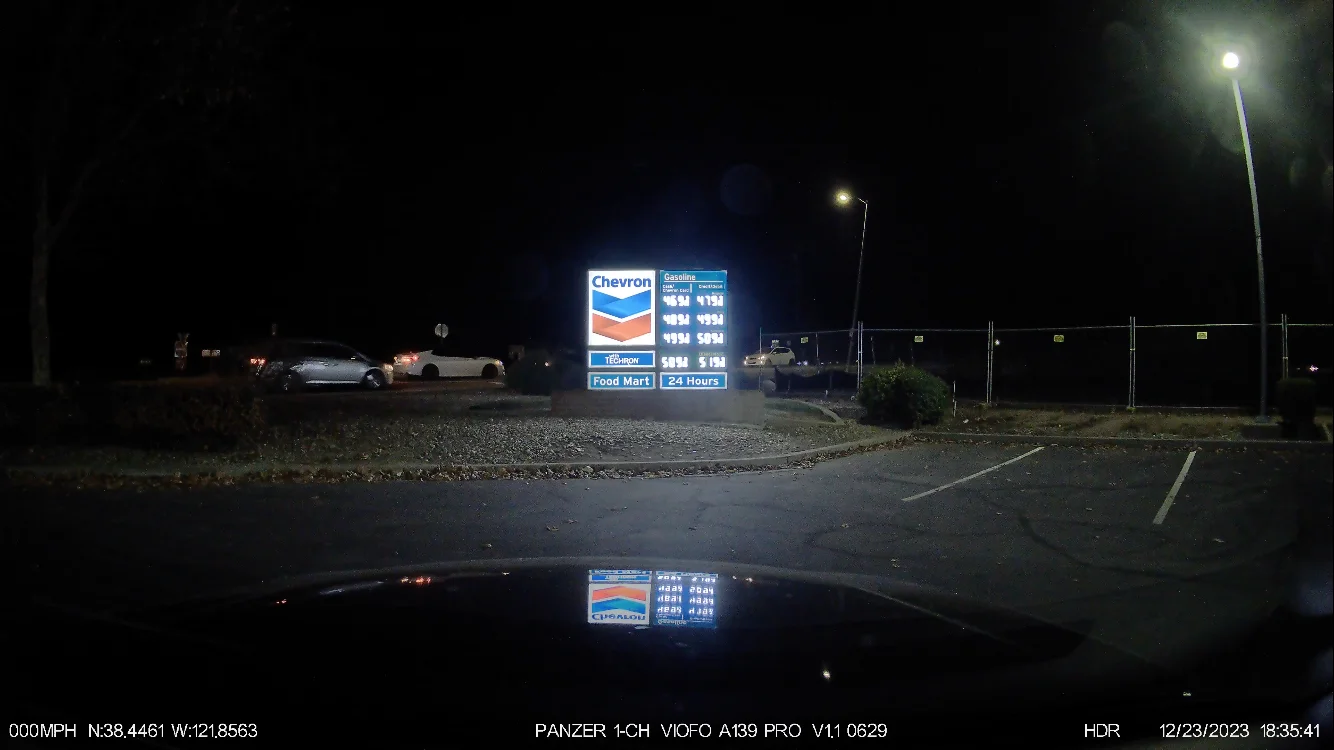

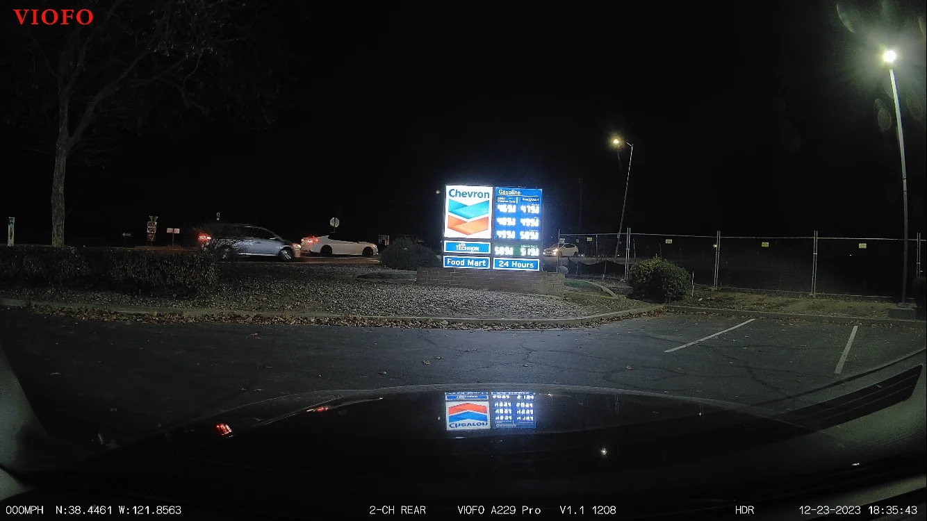

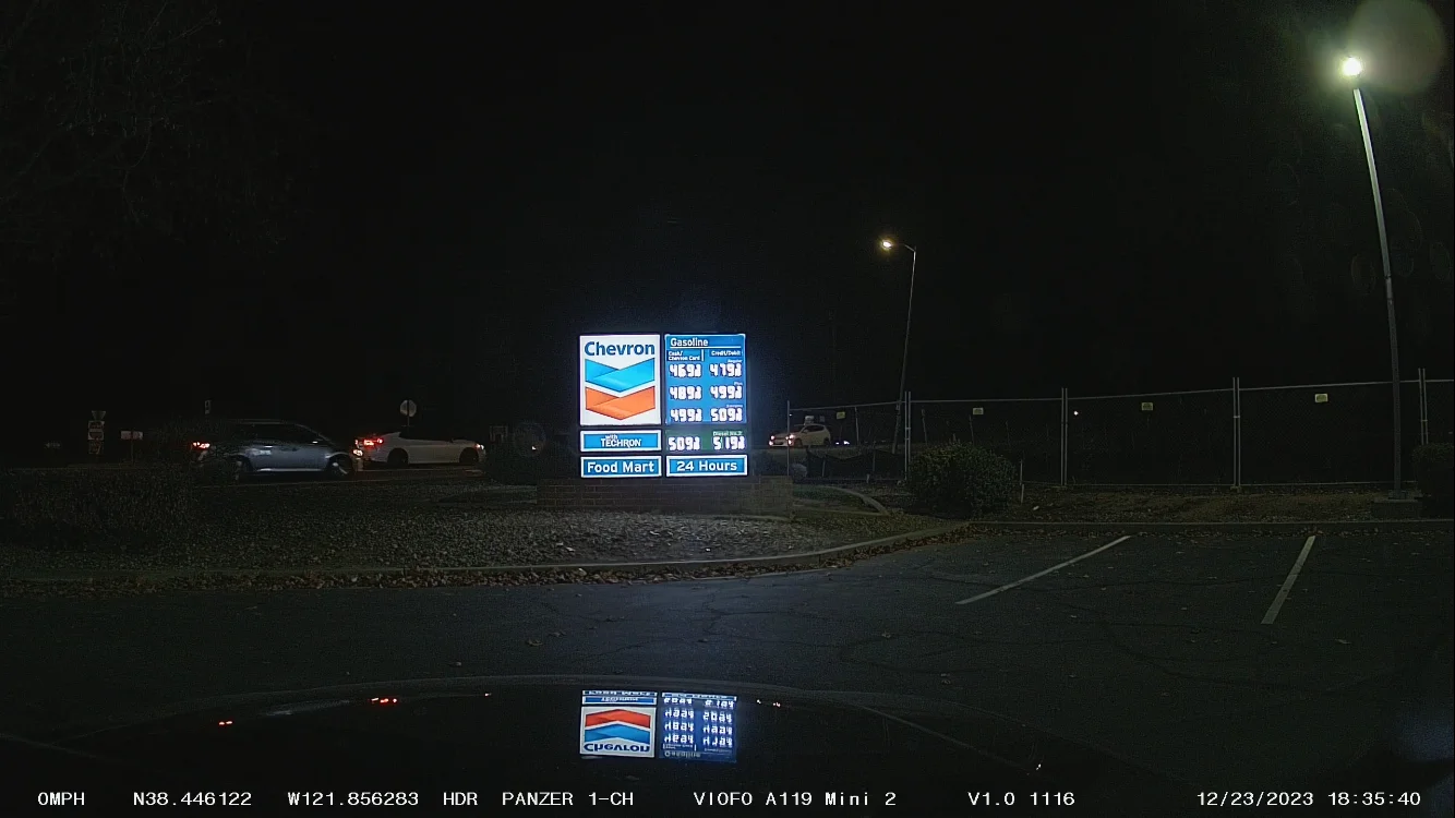

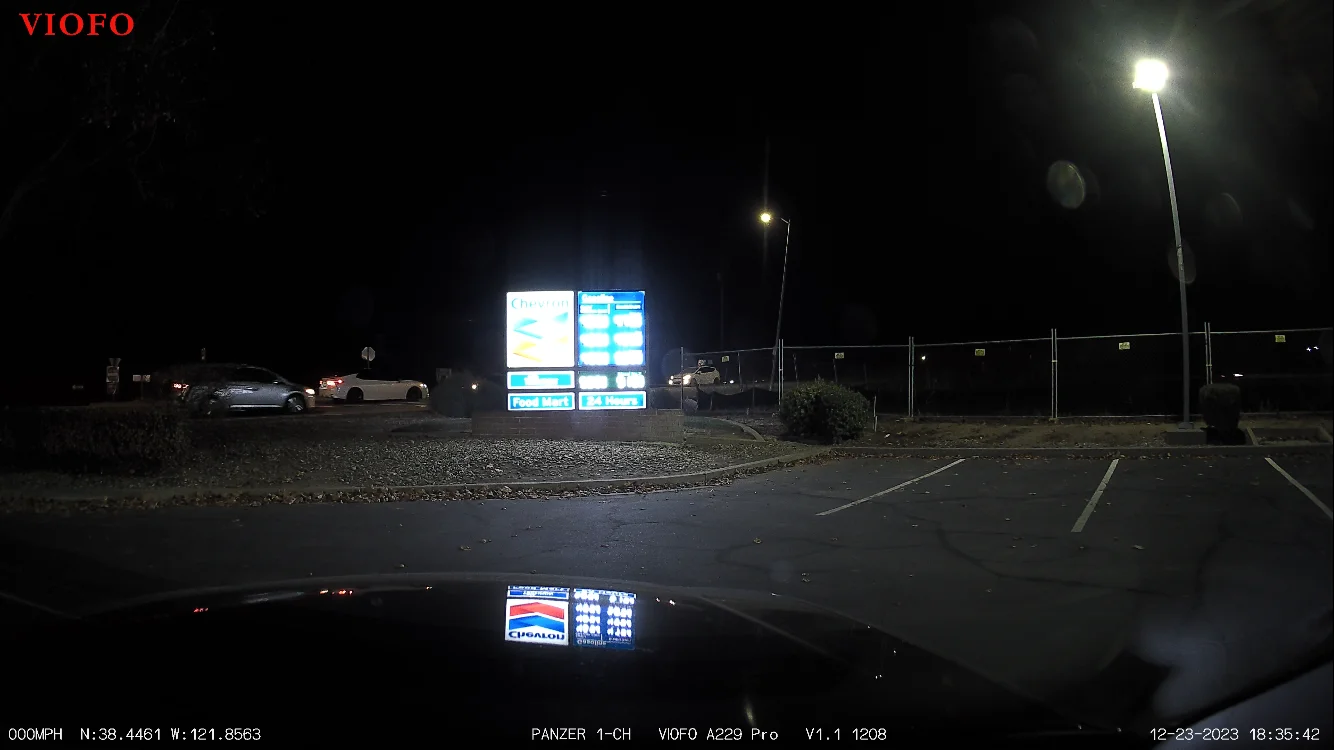

Here’s one of the reasons I say night time HDR performance needs more fine tuning.
