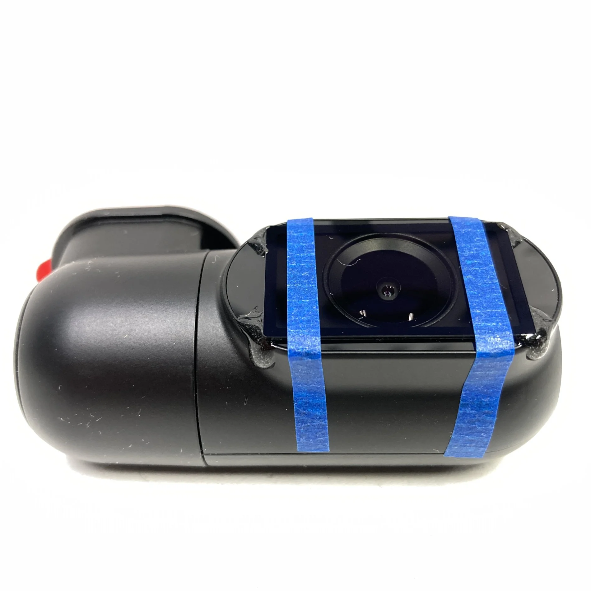

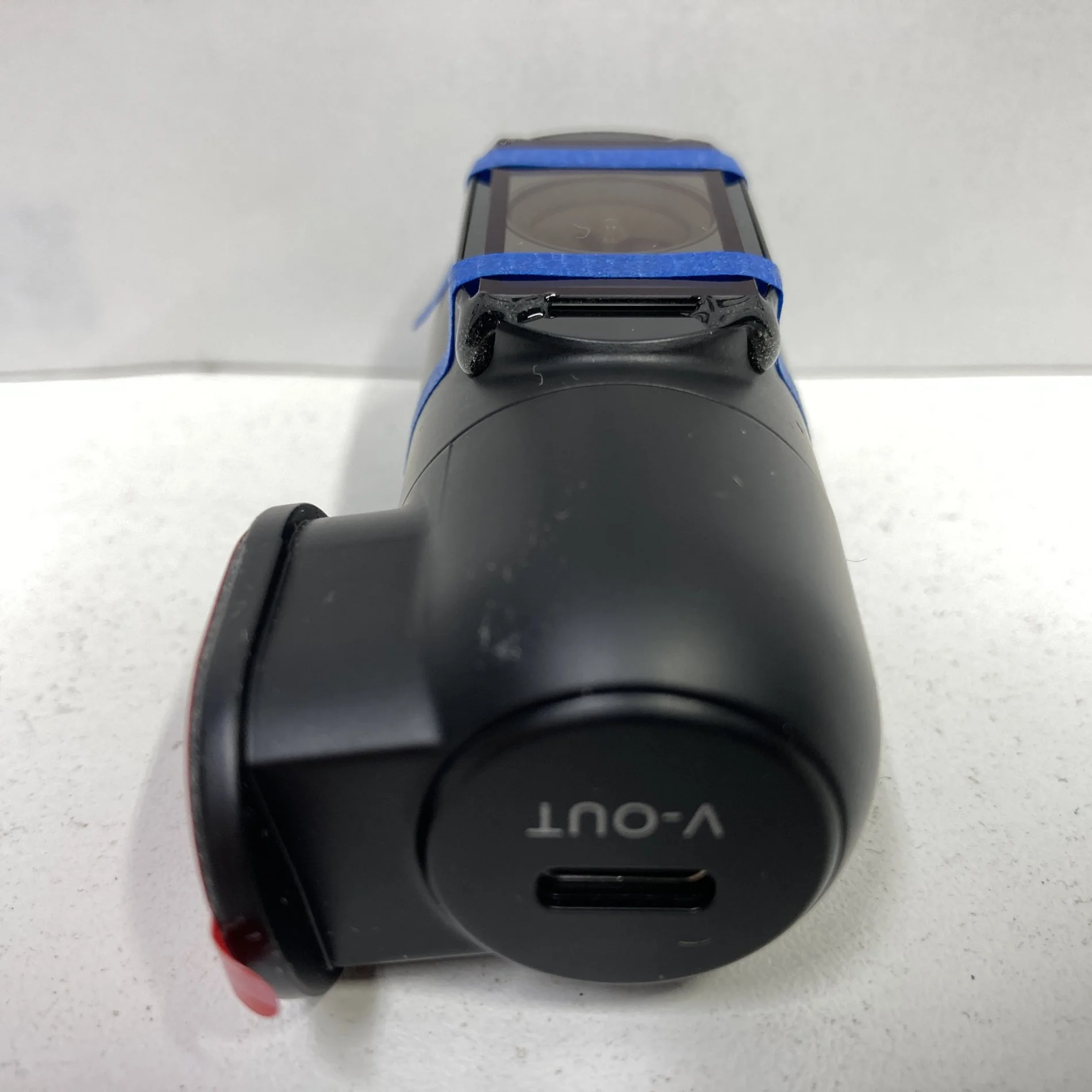

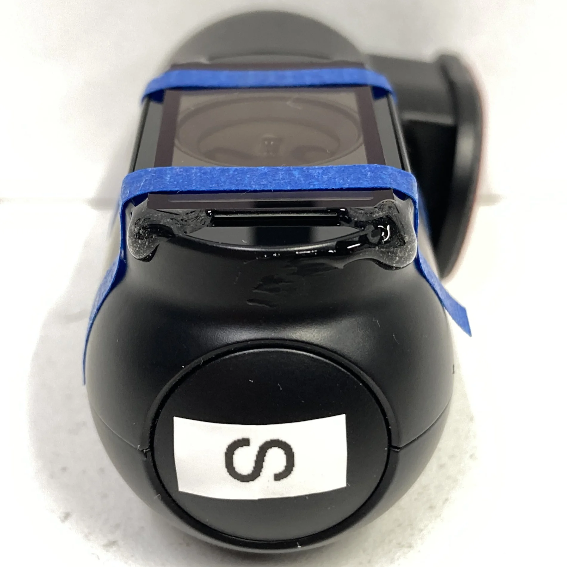

Shoutout to @VIOFO-Support for sending over some CPL Filters for the REAR cameras of the A229 Pro & A229 Plus for testing.
Ever since I reviewed the original A229 Duo August 2022, one of my “CONS” was no available CPL Filter for the REAR camera.
Due to the angle of my rear window glare is very noticeable.
Installation was semi-permanent by dabbing a glob of 5-minute epoxy on the four corners of the CPL Filter.
I can already see improvement in glare reduction just from the garage lighting.
I’m excited to see daytime driving results, and how much the filter impacts night time driving.

@Panzer Platform - Nice DIY; I would probably mess up and get adhesive everywhere on the lens.
@VIOFO-Support - Is there any chance the rear camera CPL filter accessory/attachment will be made for purchase?
Thanks for your suggestion 👍 . We are working on this and trying to make it easiest for our customers to install it.

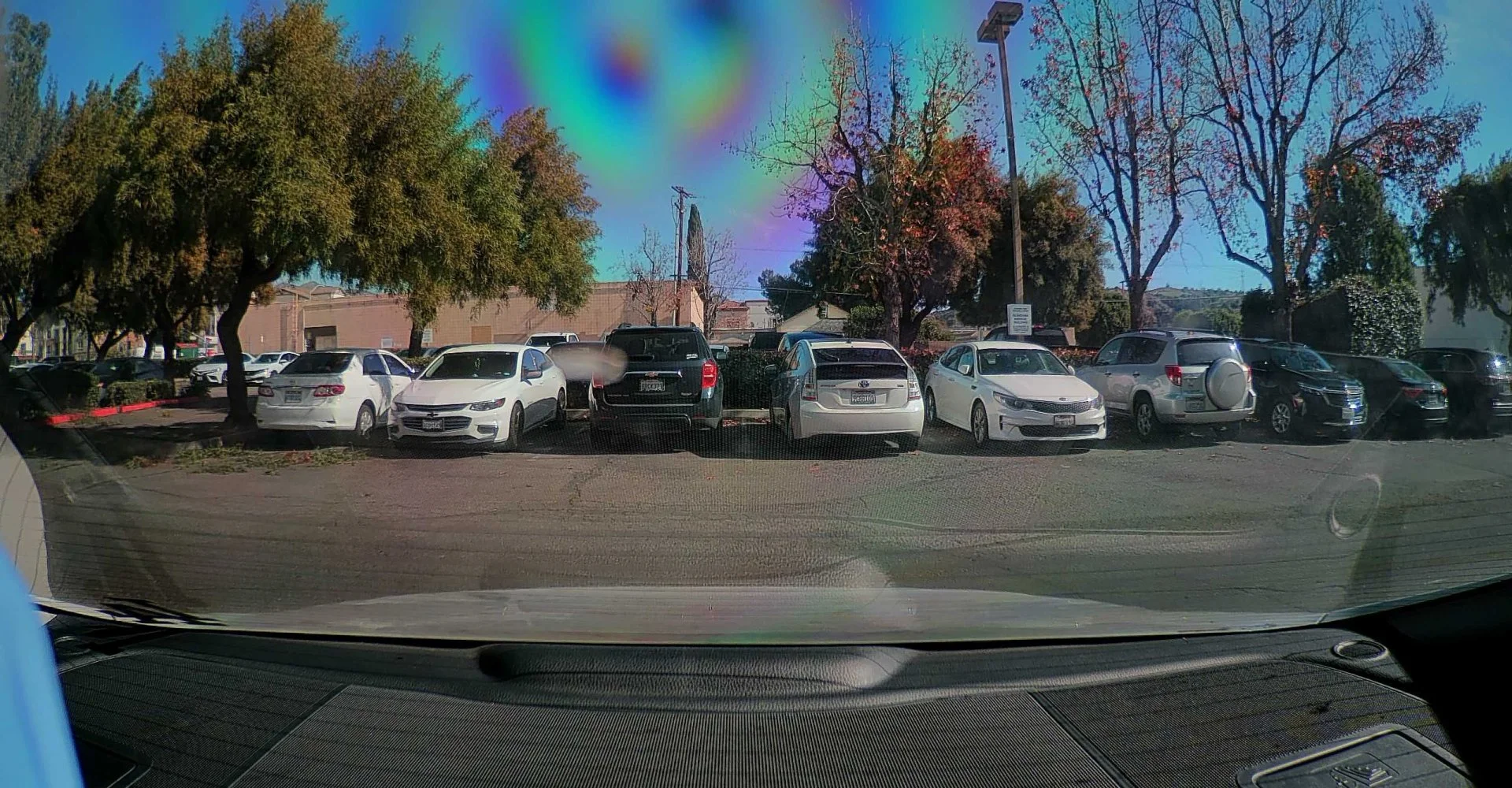

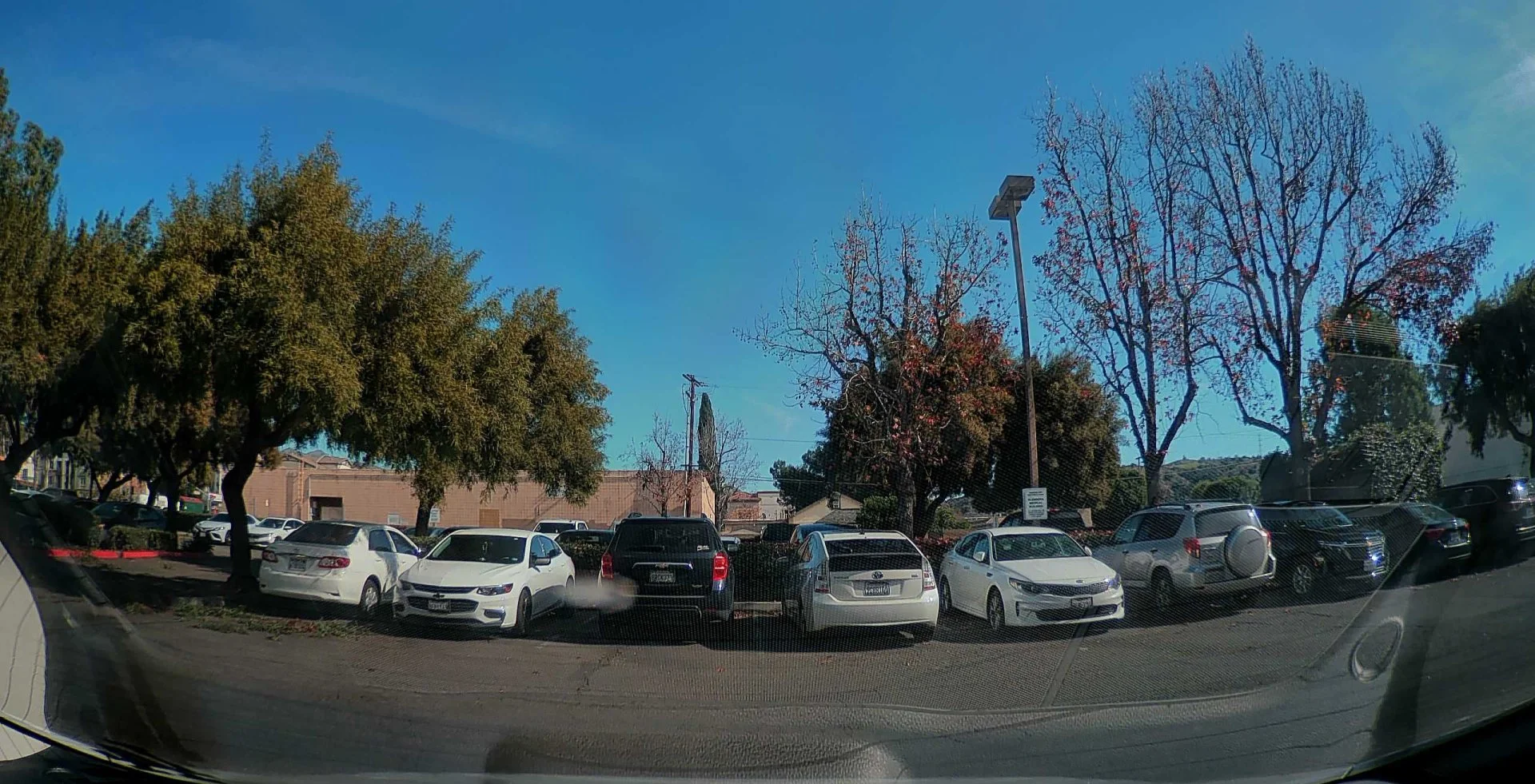

So I tried that CPL filter for the back camera and I got this weird rainbow effect. Have you had this happen before? First picture is without, second is with.
That could indicate your rear window have some form of polarizer / filter on it
My grey good not remembering what it is called, but @Dashmellow will know
Does having ceramic tint with a CPL filter cause problems like rainbows?
Getting the rainbow effect when adding a CPL Filter is usually due to aftermarket window tint, or even some factory window tint.
I guess this is one of the reasons CPL Filters do not come standard on all dash cams.
You can also try getting a black dashmat, or similar for your parcel shelf to cut down on window glare.
Oh yeah the CPL Filter is "directional", (see attached photo").
-Chuck
