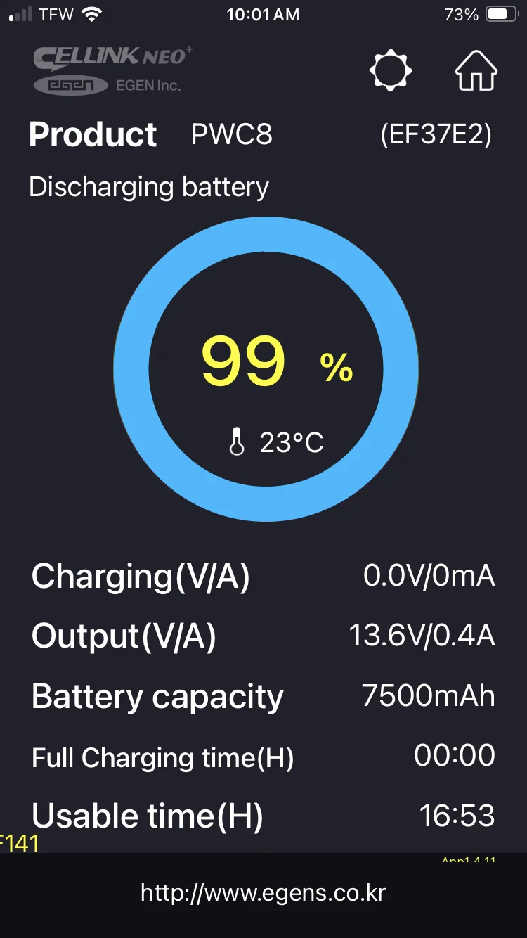

Q: How long will the A229 Pro 2-CH REAR operate in Low Bitrate Parking Mode with @BlackboxMyCar PowerCell 8 Battery Pack, (actual, not theoretical)?
A:
Test #1 16 Hours 15 Minutes
Test #2 17 Hours 56 Minutes (1Hr 41Min more, what is going on here?)
Test #3 18 Hours 2 Minutes (1Hr 47Min more, what is going on here?)
Test #4 18 Hours 19 Minutes (PT)
Test #5 18 Hours 57 Miniutes (PT) Retail / Production

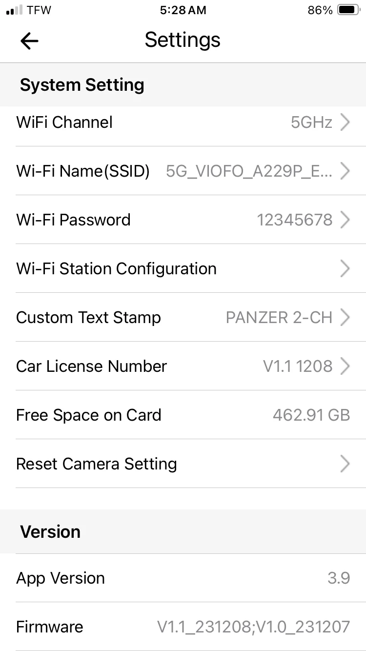

Firmware & Settings;
Front Firmware 1208
Rear Firmware 1207

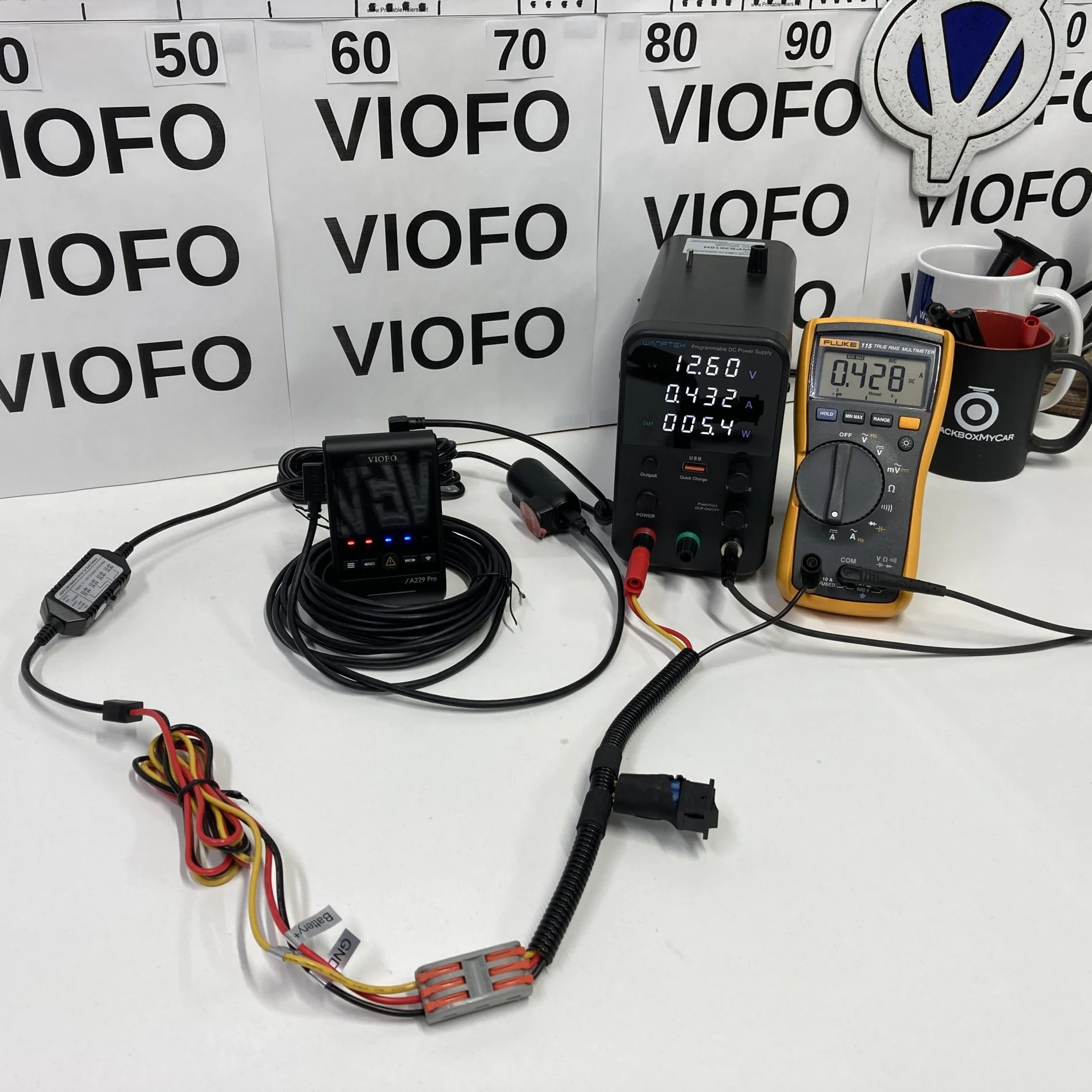

Q: What is A229 Pro 2-CH REAR power consumption in Low Bitrate Parking Mode?
A: 5.41 Watts
Q: What is A229 Pro 2-CH REAR power consumption in Normal Recording Mode Mode?
A: 5.97 Watts

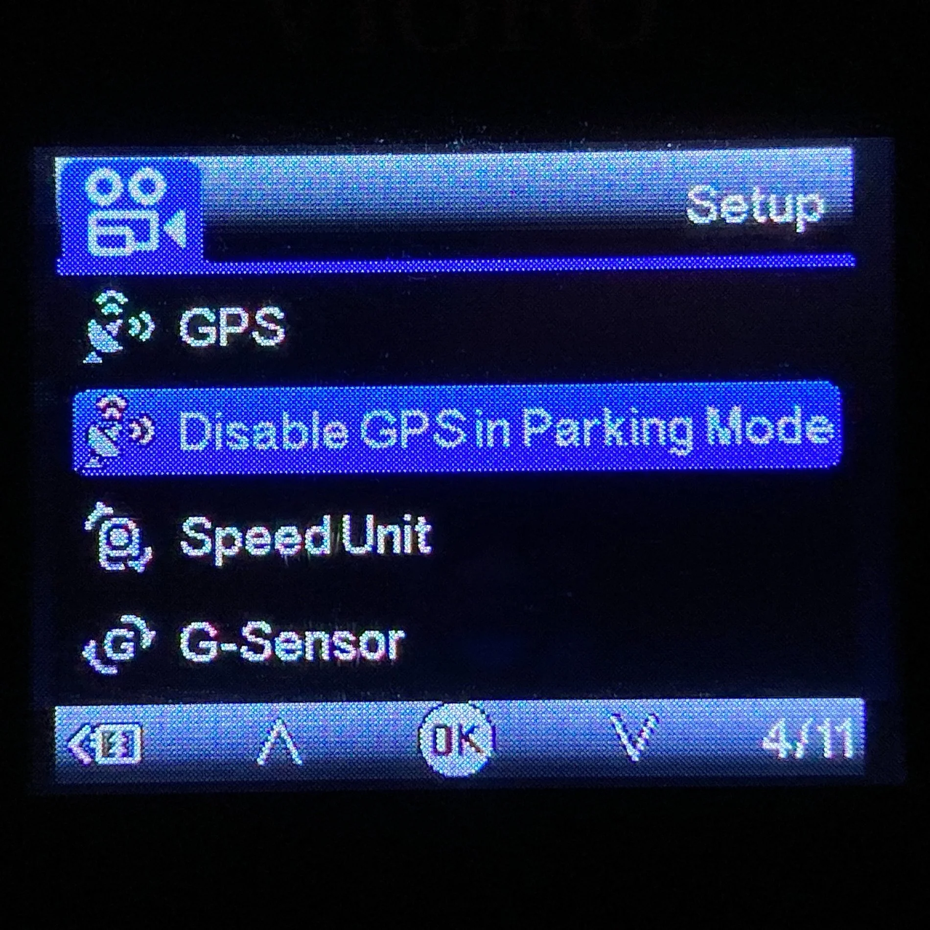

Dear Viofo,
I’ve been hesitant to report all the little “insignificant” firmware bugs I’ve noticed since I began testing the A229 Pro 9/11/23 (89 days ago) because I don’t want to divert any manpower / time / resources away from fine tuning image quality.
The most important “elephant bug” is image quality & NIGHT TIME HDR performance for me.
Without the world famous, industry leading Viofo image quality I see no point, and everything else takes a back seat for me.
Image quality is the basic fundamental ingredient that make your cameras better than all other brands.
I’m only 90% satisfied with current image quality.
But, now I think I found a bug that is complicating my parking mode run time tests.

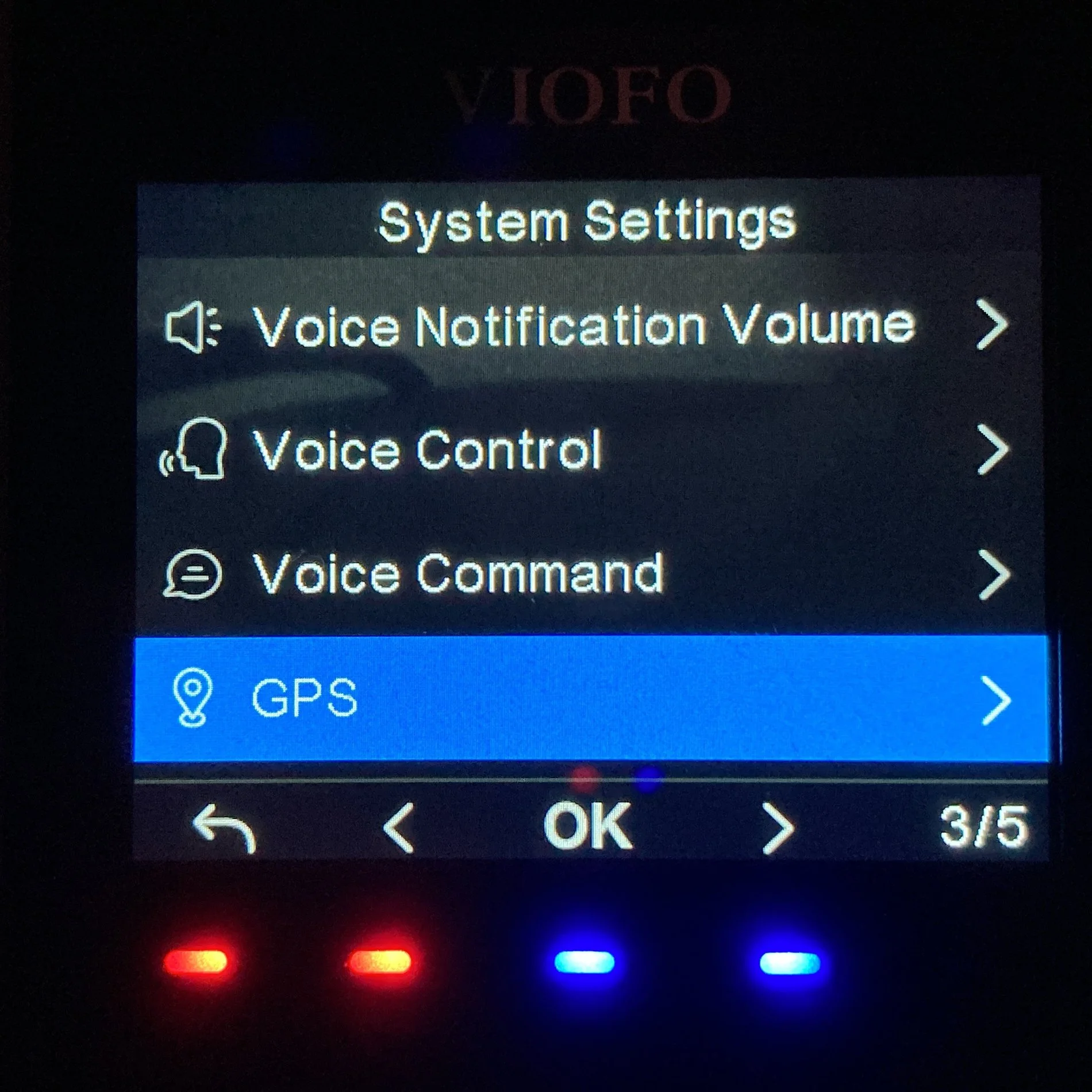

If I recall the whole reason for the new 5-Pin GPS mount on the original A229 Duo, & A119 Mini in 2022 was to enable power saving features like disabling power to the GPS module in parking mode to reduce power consumption, and increase parking mode run times.
It appears “Disable GPS in Parking Mode” setting is missing from both the LCD Screen menu settings, and the Viofo Smartphone APP.
See attached photos.
Viofo:
Yes, Chunk we have already fixed.
It will be released in the next A229 Pro & A229 Plus firmware update, and the all new Viofo Smartphone APP.

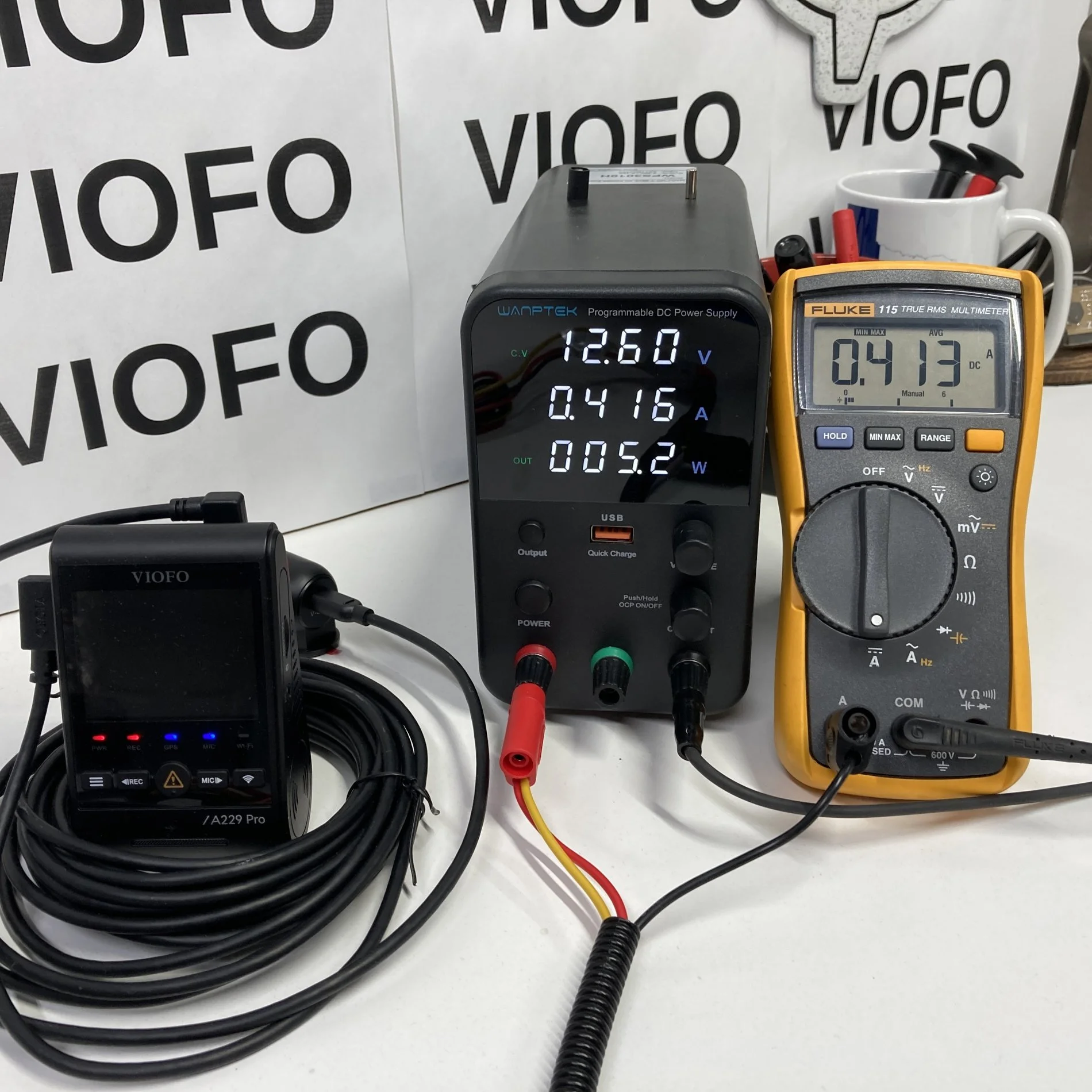

Good news.
I retested with your method, after 15 minutes I'm getting "identical" measurements with my 512GB Viofo SD Card.
I'm so glad we have the "same" power supply, and Fluke.
I also tested a 64GB Viofo SD Card, and umm I got some interesting results that I don't want "open the can of worms" right now. lol

I received my retail / production A229 Pro 3-CH for test & review, so for the past week I’ve been checking it out to see if it behaves / performs like the pre-production unit I received on September 11, 2023 (104 days ago).
So far I’m glad to say they are “identical”, so I don’t have to go back and redo all my previous testing. Thanks again Viofo for sending that out.
I gathered DRIVING test footage with the newly released firmware for the A229 Pro from the official Viofo website.
Front: V1.1_231208
Rear: V1.0_231207
I also gathered some “useless” indoor / outdoor stationary night time HDR test footage.
I’m glad I have two A229 Pro units because it will enable me to gather side by side simultaneous footage to test things like;
