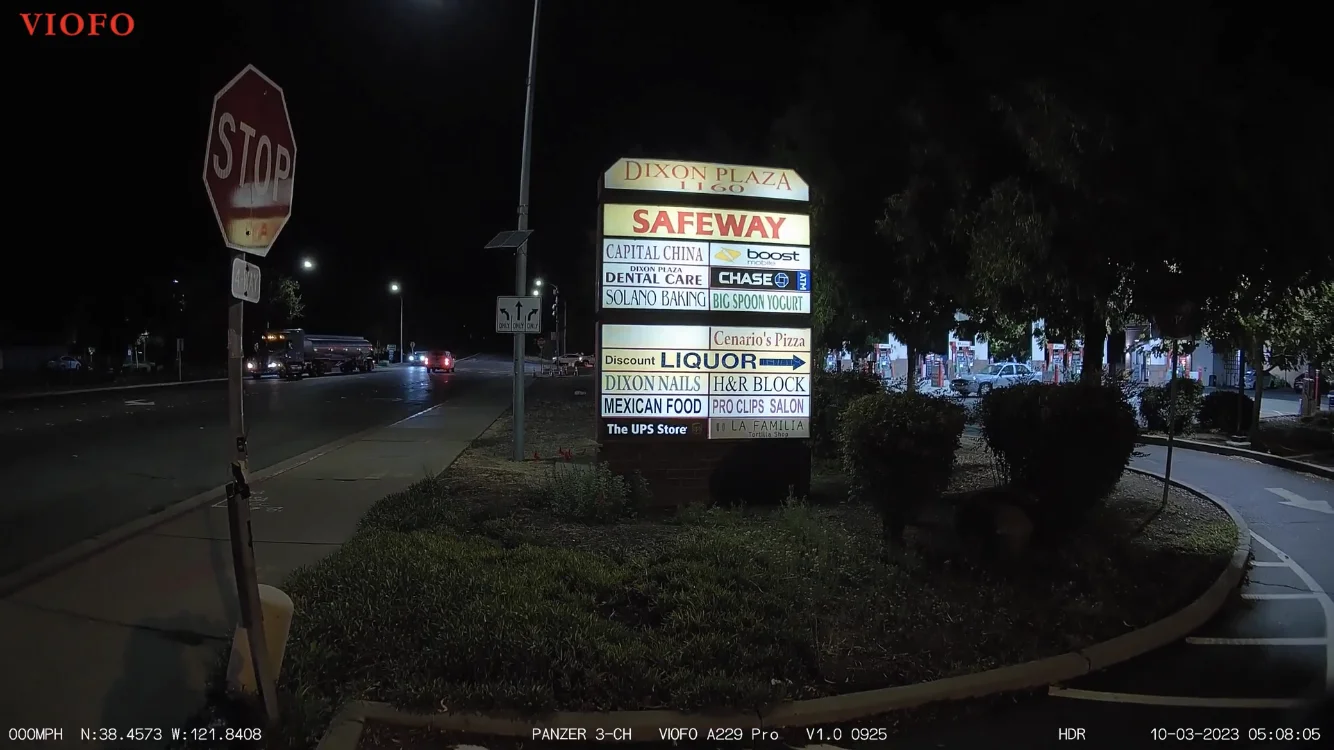

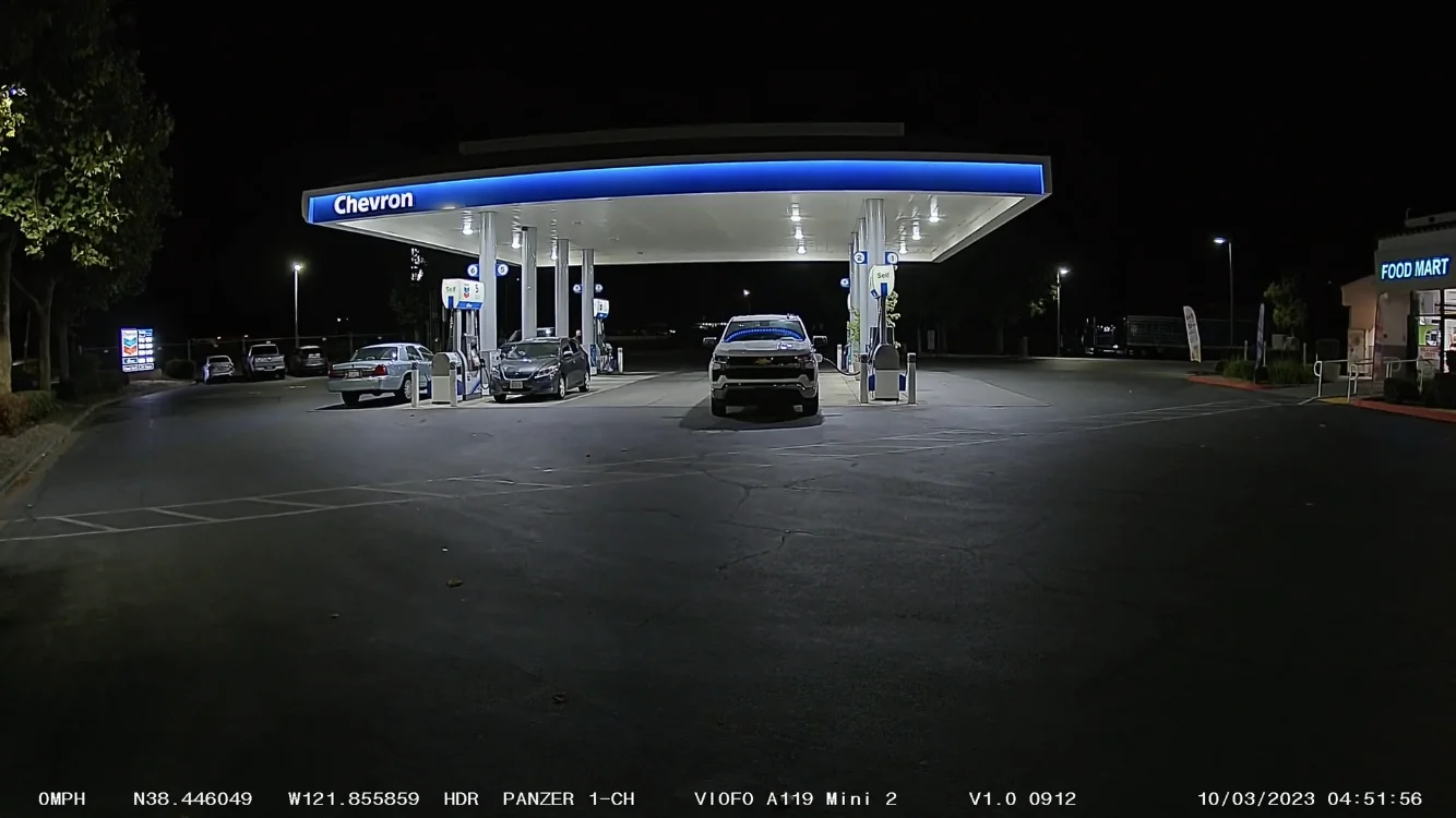

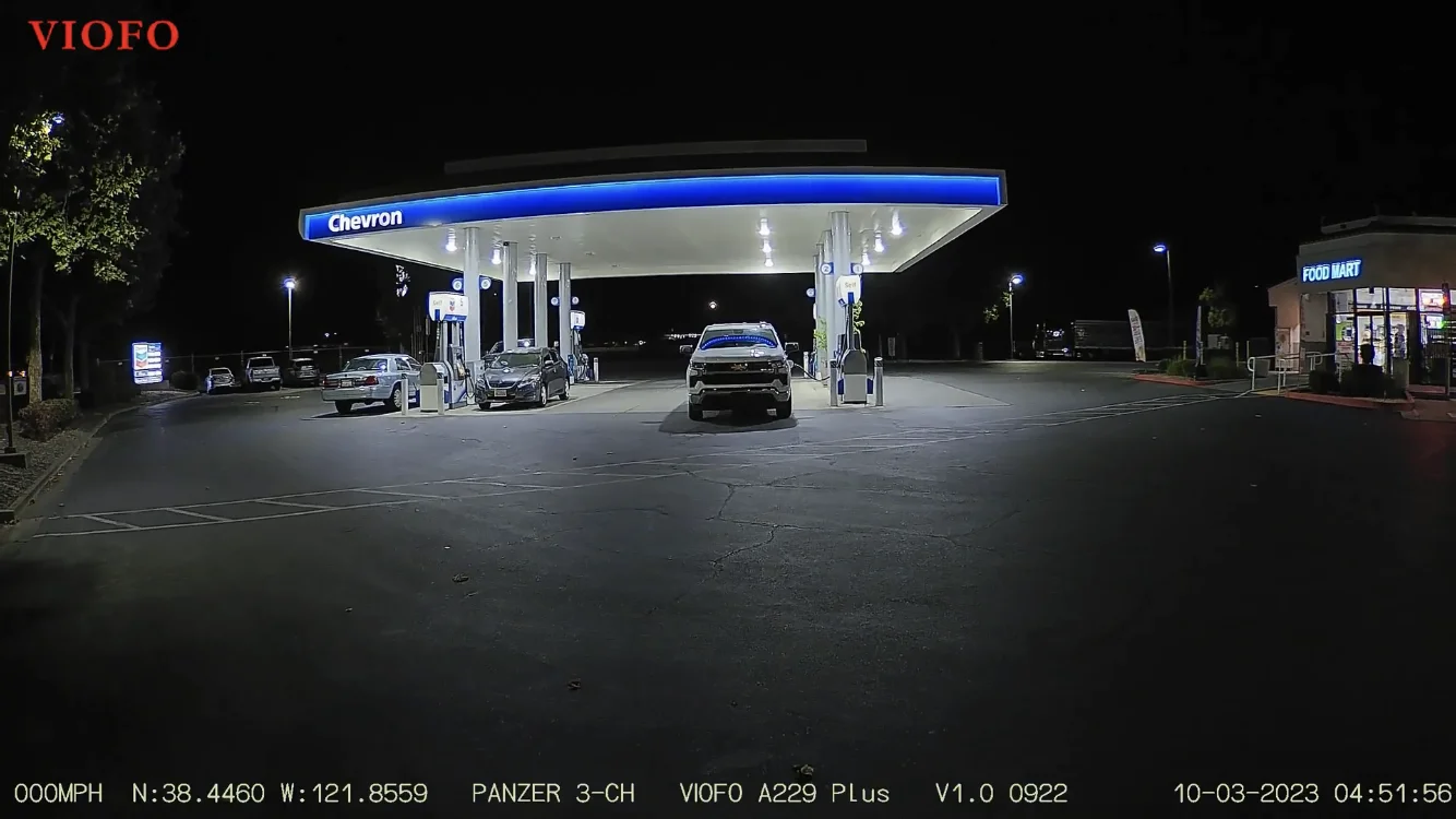

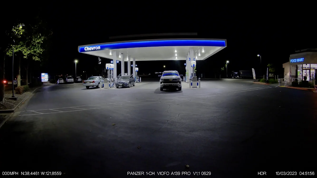

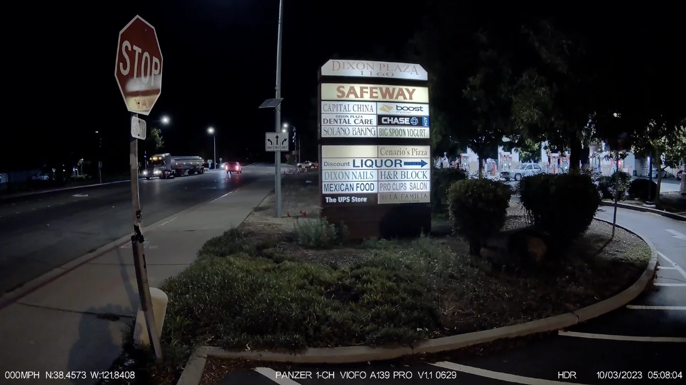

1.) A229 Pro Front vs. A139 Pro 1-CH
1a.) Take note of the wild grass in the foreground, it looks like a completely different species.
1b.) Take note of the headlights, and yellow clearance lights on the fuel tanker in the background, thay are sharp as a tack compared to the A139 Pro.
1.c) Take note of the written text on the illuminated sign.
1d.) Take note of my car parked at the fuel pumps.

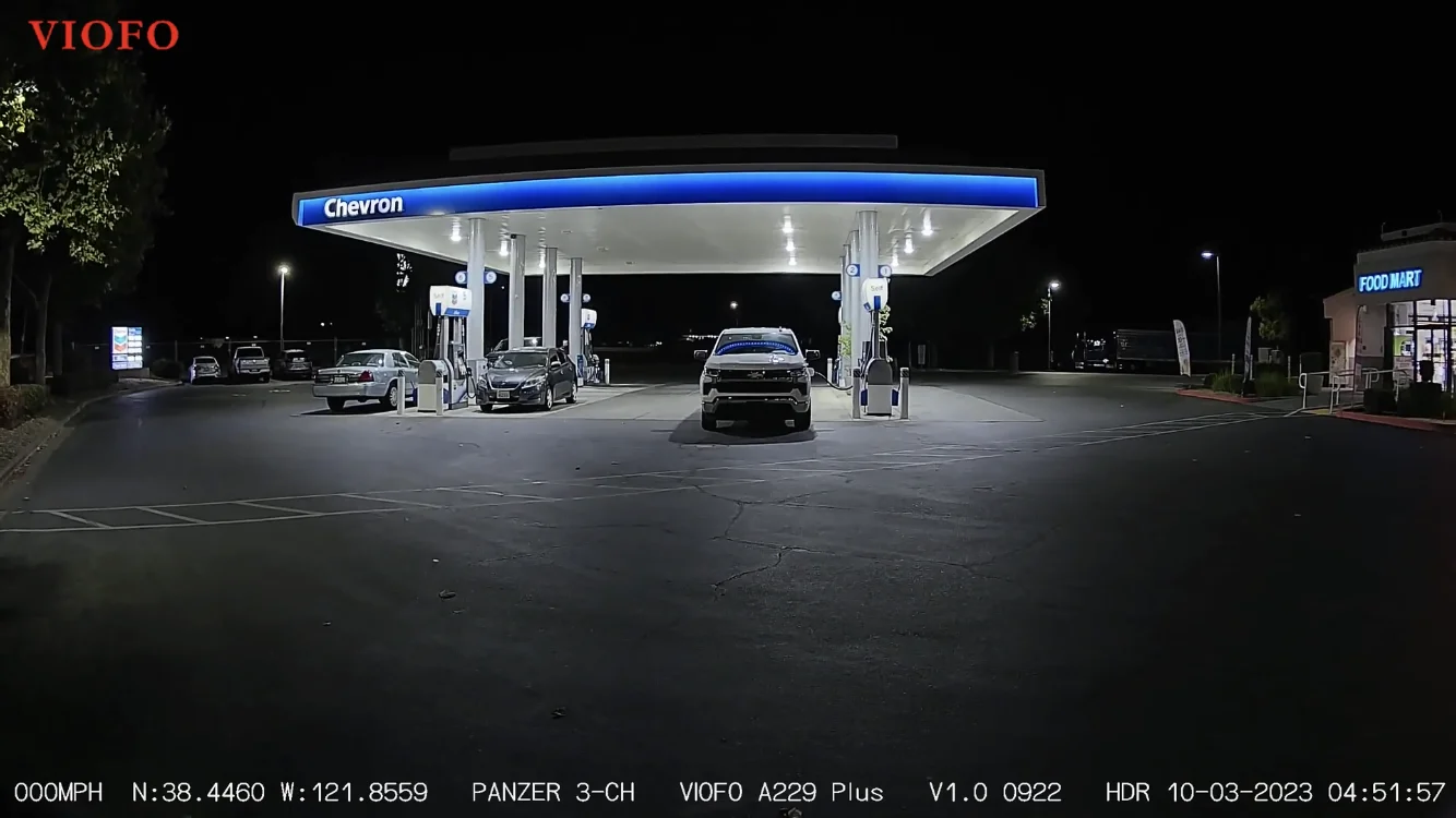

This is a fantastic example of the A229 Pro’s potential.

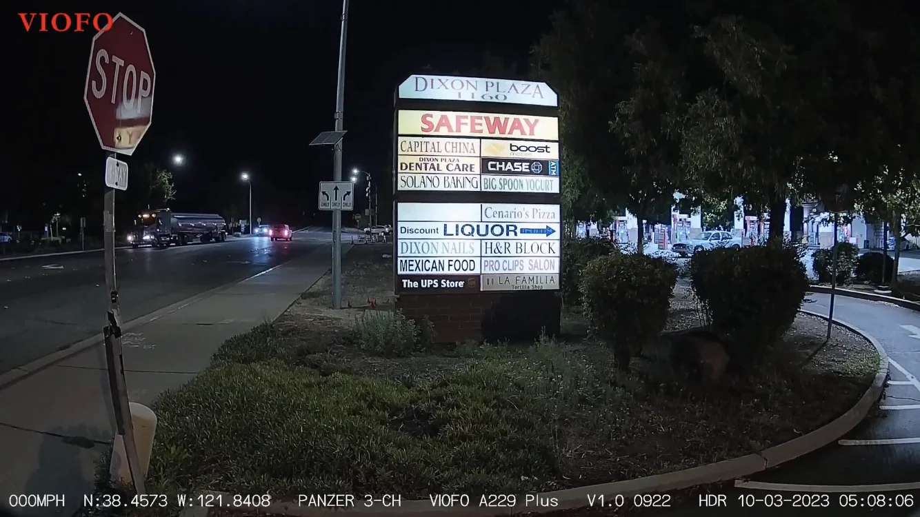

2.) The A229 Plus Front is brighter than the A229 Pro, but it’s also overexposed.
3.) What happened to the Might Mini 2?
Everything is legible, but it’s just too darn dark.

This feels like the lenses they put in front of your eyes when you go to the optometrist to get your eyes tested. A229 Pro seems quite clear for the sign and the grass.

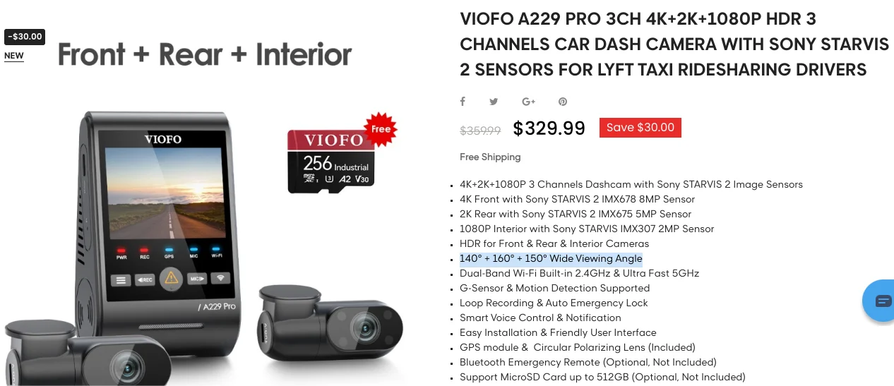

Both the A229 Pro & A229 Plus 3-CH have listed specifications of;
140° Front + 160° Rear + 150° Interior Viewing Angle.

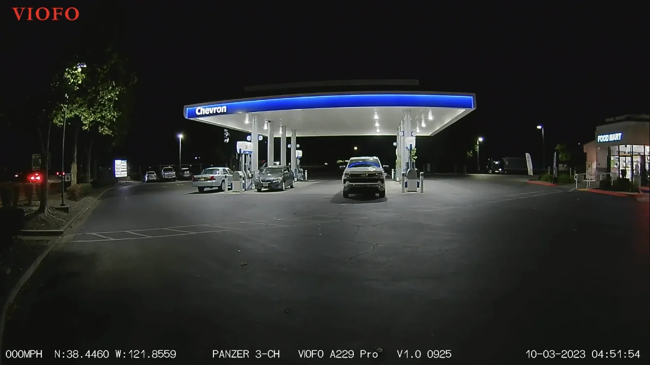

Based on these screenshots the true FOV is closer to;
A229 Pro: 160° Front + 160° Rear + 170° Interior
A229 Plus: 145° Front + 160° Rear + 170° Interior
It’s been explained to me the FOV specifications are provided by the lens manufacturer to Viofo.
If Viofo fails to confirm & verify actual FOV of their dash cams after final assembly this is a deficiency of minimum standards for quality control in my opinion.
The name on the dash cam is Viofo, and they are ultimately responsible for providing true & correct specifications to consumers.

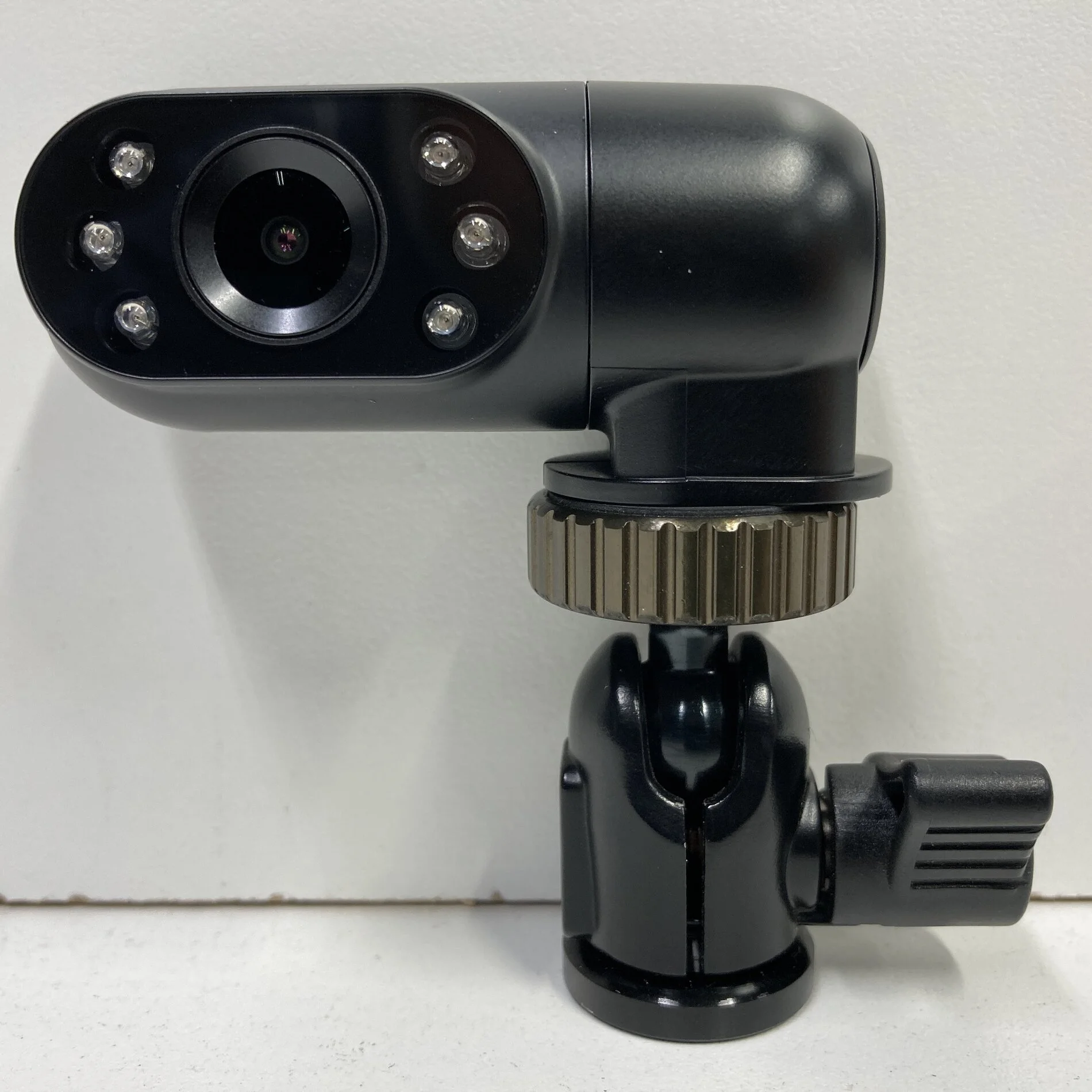

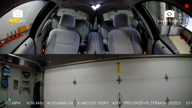

IR INTERIOR CAMERA - DIFFERENCES & IMPROVEMENTS
Keep in mind the IR Interior camera is identical in hardware & image quality for the A229 Plus.
In this post I would like to talk about the differences, and improvements of the IR Interior camera compared to the IR Interior camera of the A139 Pro.
Long story short I like all they’ve done hardware wise, but I can see why @rcg530 said; “He’s not a fan of the interior nighttime image quality”.
I’m hopeful some fine tuning with it’s firmware can fix this.
I’ve found the A229 Pro & A229 Plus IR Interior camera to be much improved over the A139 Pro’s IR Interior camera for three reasons.
1.) Image Sensor upgraded from STARVIS IMX291 to STARVIS IMX307
2.) HDR Support
3.) Built-in Light Sensor with IR Cut Filter
They reduced the number of IR LED emitters from 6 to 4 to make room for the light sensor & IR cut filter.
It appears to be a good trade off because the upgraded sensor has better low light sensitivity so it can maintain full color until lighting conditions drop so low that it illuminates the IR LED Emitters, and switches to black & white.
The HDR works fantastic.
The built-in light sensor is more accurate, and quicker to respond to changes in ambient lighting conditions, (switching back and forth between color & black and white).
And the IR Cut Filter has gotten rid of that annoying purple hue on dark colored objects during daytime recordings.

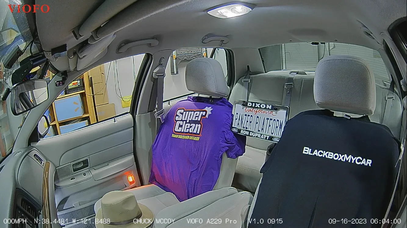

Camera Settings & Firmware;
Bitrate: …..Maximum
HDR: ……..On (A229 Pro)
IR LED: ..…Auto
A229 Pro ...V1.0 0915
A139 Pro: ..V1.1 0629
1.) Take note of the HDR performance of the A229 Pro in the dome light, and door panel courtesy lights.
2.) Take note the IR LED’s are set to AUTO, but only the A139 Pro has them illuminated.
Even under these “bright” conditions with the dome light, and my garage lighting it still thinks its dark enough that it has to illuminate the IR LED emitters.
You can see the the purple glow of the emitters on the sun visor in the image recorded by the A139 Pro, and you can also see the IR LED’s are illuminated in the image recorded by the A229 Pro by looking across the passenger compartment.
At the same time you can see the IR LED’s are not illuminated on the A229 Pro.
3.) I do like the more natural appearance of the A139 Pro, however it’s been explained to me the buzzy appearance of the A229 Pro is designed for better low light performance.
Maybe that needs more fine tuning, not sure.
4.) Unrelated note: my car is a 2004 Ford Crown Victoria with 162K Miles, and I’ve been able to keep the interior in somewhat good condition for this almost 20 year old car. Lol

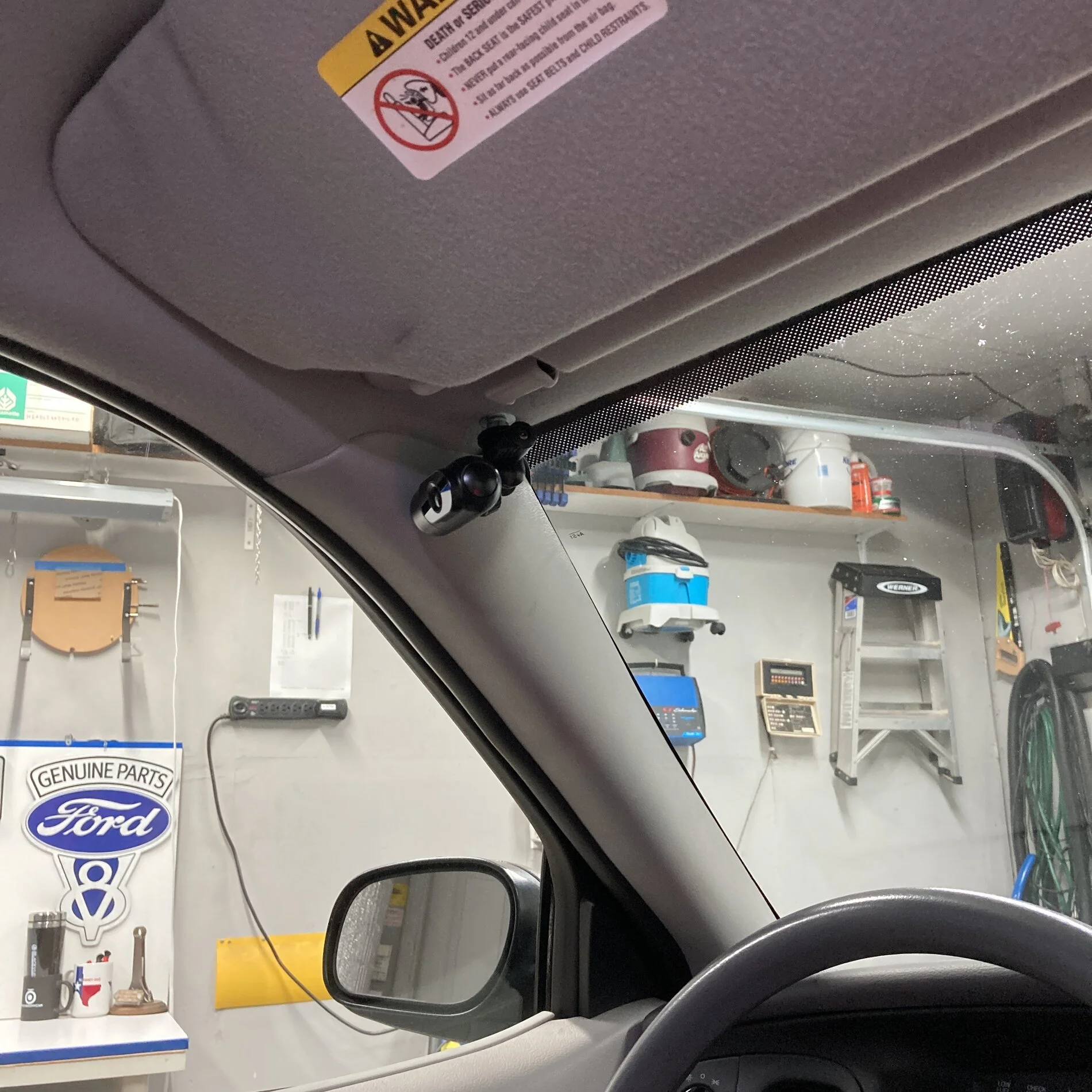

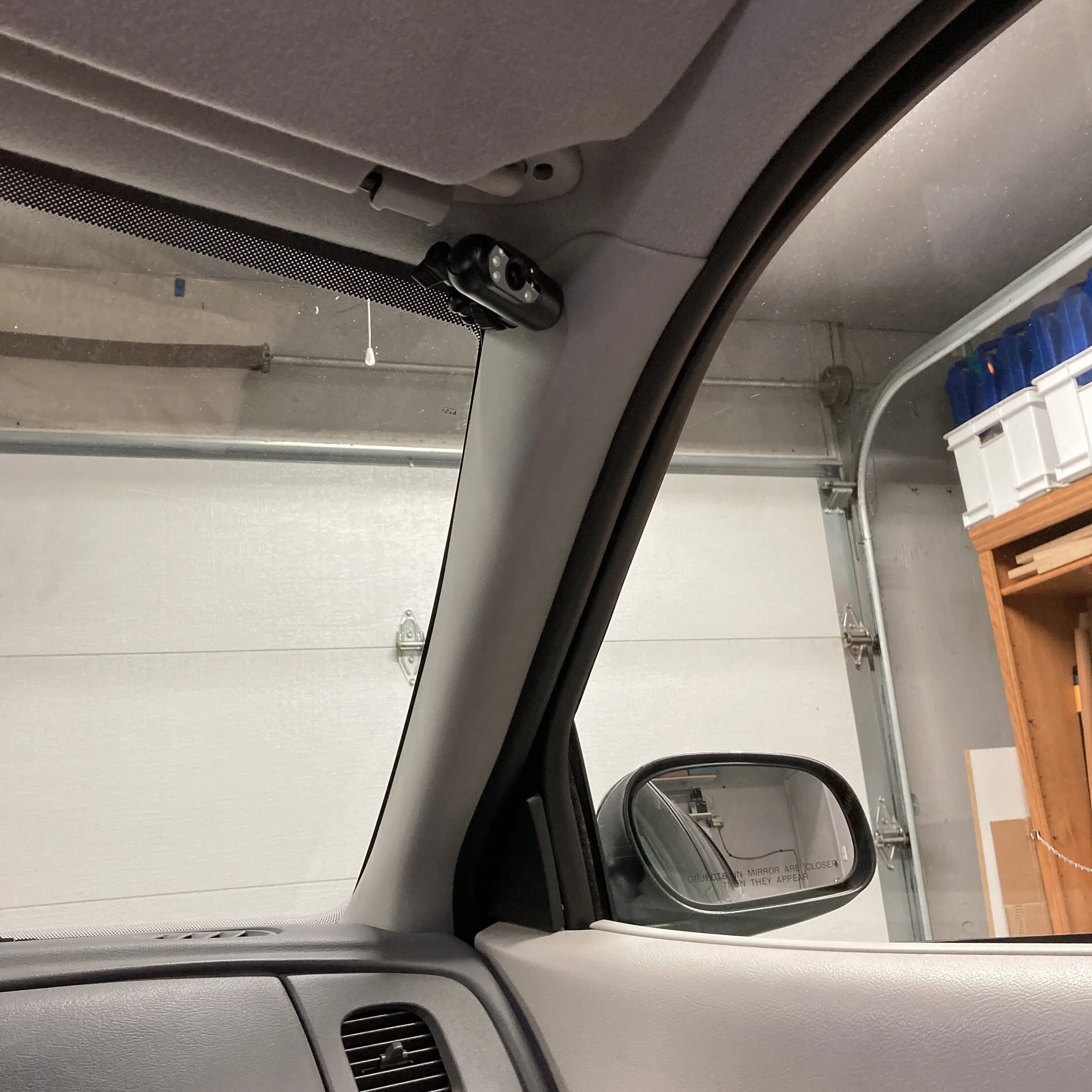

what is the mounting adapter you are using for the IR camera that is mounted on the passenger side.
I thought you would never ask. Lol

IR INTERIOR CAMERA - MOCK TRAFFIC STOP
I wanted to see how the IR Interior camera would perform in the different lighting conditions of a potential traffic stop.
After filming this, and watching the footage I realized I should have filmed these two clips consecutively, not simultaneously because there are times when both cameras have their IR LED emitters illuminated providing “double” the IR illumination.
I’ll refilm this separately for my final review, however it’s still nice to see how the cameras react / adjust to the change in lighting conditions.
Bitrate: …..Maximum
IR LED: ..…Auto
1.) Take note the A139 Pro is never able to achieve full color mode, and the IR LEDs are always illuminated.
Conversely the A229 Pro’s camera switches between full color, and black & white when the dome light is illuminated on/off.
2.) Take note of the difference in audio volume level from the A139 Pro vs, A229 Pro.
Both cameras are using the built-in microphones.
I’m pleased to report it sounds like the audio quality, and volume level of the original A229 Duo has carried over to the A229 Pro.
3.) Bonus points if you can name the movie quote.
It choses not to use full colour mode rather than not being able to do it. Not sure why we need to use monochrome at night when full colour mode would work perfectly well?
I note that neither camera can read the plate in the dark without additional illumination, disappointing given the size of the text!
When I was running a rear and interior camera together side-by-side on my A139 Pro, both facing the glass, with IR illumination set to OFF, I noticed that the rear camera picked up a purple glow from the interior camera. So I wonder whether the A139 Pro IR LEDs are always-on?
Although the A229 HDR is working nicely for the dome light, it is not working for the A139 IR light at the start of the video... why not?
Looks like glare from the opposing IR LEDs. Should be a different result when PP runs his consecutive rather than simultaneous tests.
The reason neither camera can read the plate when IR LEDs are illuminated is because it’s not a real license plate.
It’s a “novelty” plate that was sent to me by one of my YouTube channel subscribers.
Why would you ask me?
I just observe & report. lol
You're the expert.
I've been running the A139 Pro IR Interior as my regular interior camera for the past 8 months.
I always set the IR LEDs to OFF even at night.
I have periodically checked the footage and they stay off.
Once I get the cameras re-installed in the car I will conform & verify.
