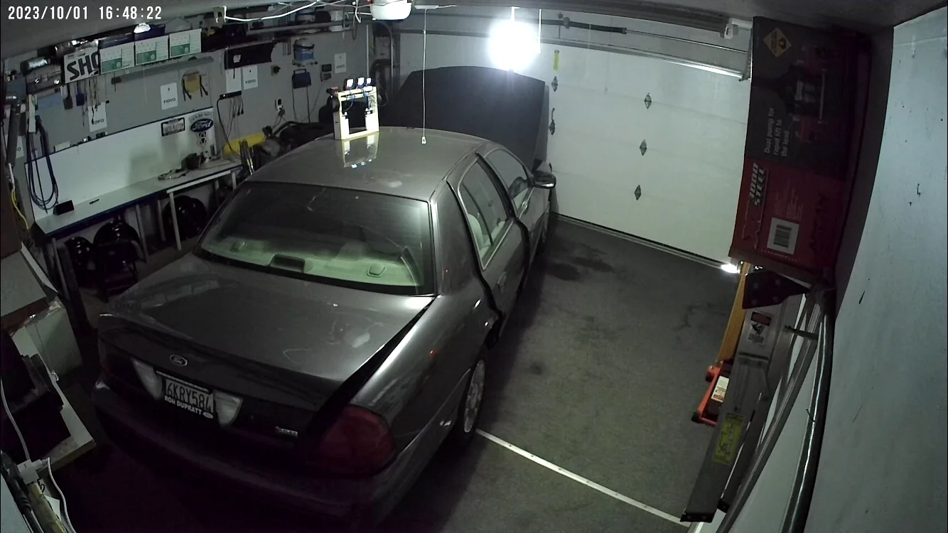

For this HDR comparison I place the camera test rig on top of my car 5ft high in the center of my 20ft x 20ft two car garage.
The test starts with a single light source illuminating the garage.
I have a Streamlight Stinger LED flashlight hanging from the ceiling with a diffuser 5ft behind the test rig in an attempt to evenly distribute the beam pattern.
The flashlight has 3 power modes HIGH/MED/LOW.
I use the LOW setting rated at 100 lumen for this test.
I let the cameras adjust / stabilize to the very dim conditions for approximately 10 seconds.
I turn on a second flashlight with an extremely tight focused beam pattern to maximize the intense difference between the darkest, and brightest part of the image.
The second flashlight is a MAGLITE ML300L.
I use the HIGH setting rated at 625 lumen for this test.

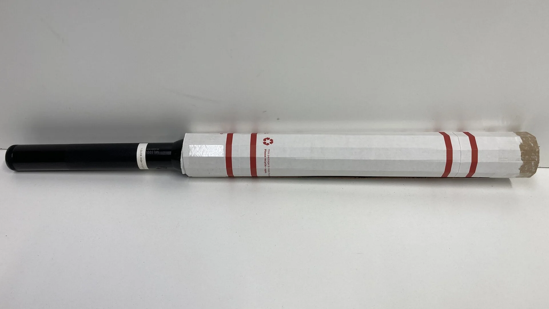

I achieved the tightly focused beam pattern by constructing a telescopic shroud from USPS Assembly Grade Cardboard, (see attached photo).

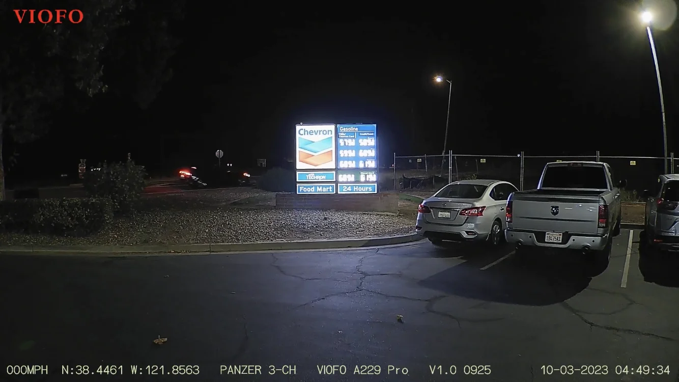

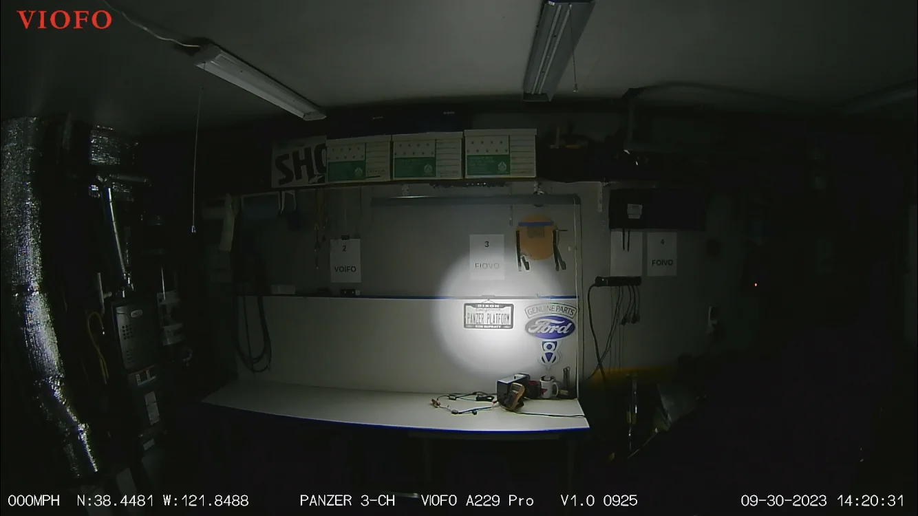

After watching the recorded footage, and comparing screenshots side by side, 5 things stand out at me.

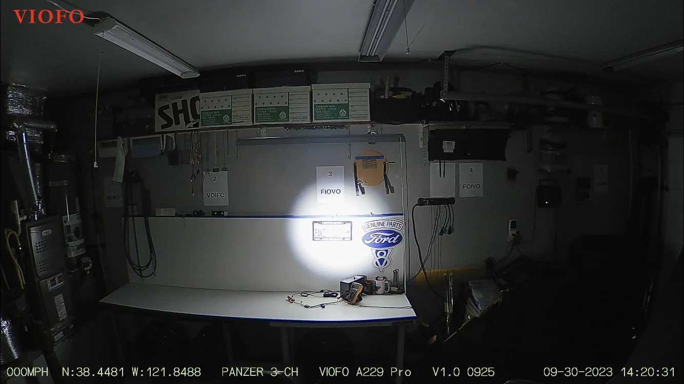

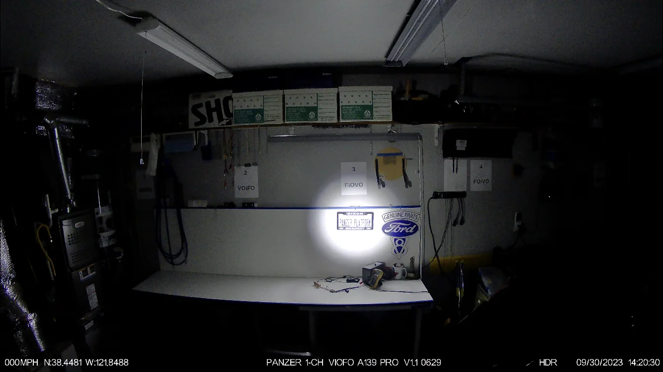

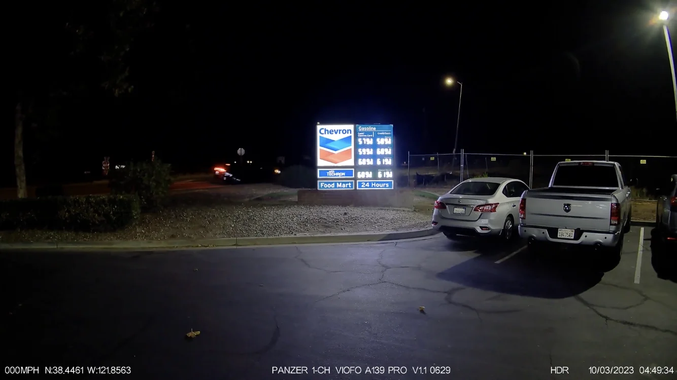

1.) The A229 Pro, and A139 Pro have similar HDR performance resolving the license plate.
Take note of the difference in size / shape / density of the beam pattern.
It’s almost like the cameras achieving the same goal but going about it in different ways.
Is this the difference in processors, (A229 Pro 96529 & A139 Pro 96687)?
Or a difference in firmware programming?
1a.) Everything not under direct illumination appears sharp, and focused on the A229 Pro, where as the A139 Pro looks blurry, an unfocused.
Take note of the 5 misspelled “VIOFO” paper signs.
Can you identify how each one is misspelled?

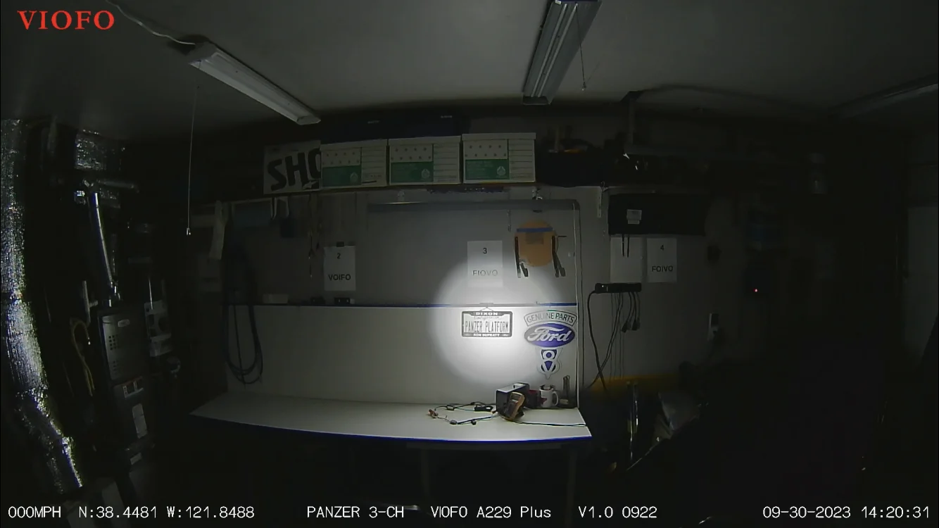

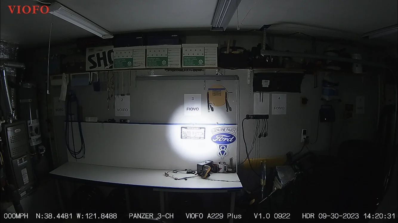

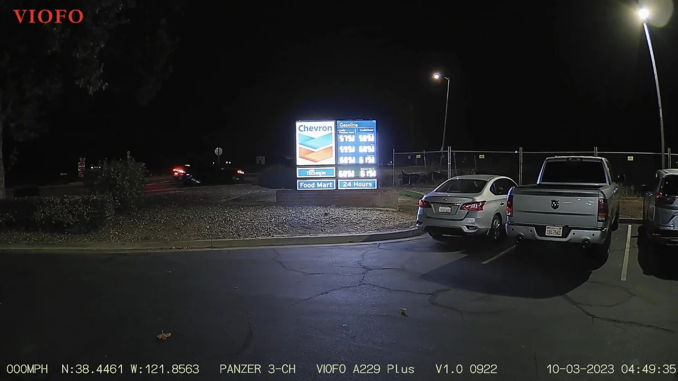

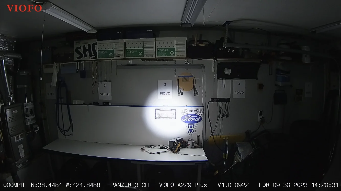

2.) The A229 Plus has a much brighter overall image than the A229 Pro.
However, the HDR performance is ineffective, and unacceptable trying to resolve the license plate.
This is a major malfunction that requires corrective action.

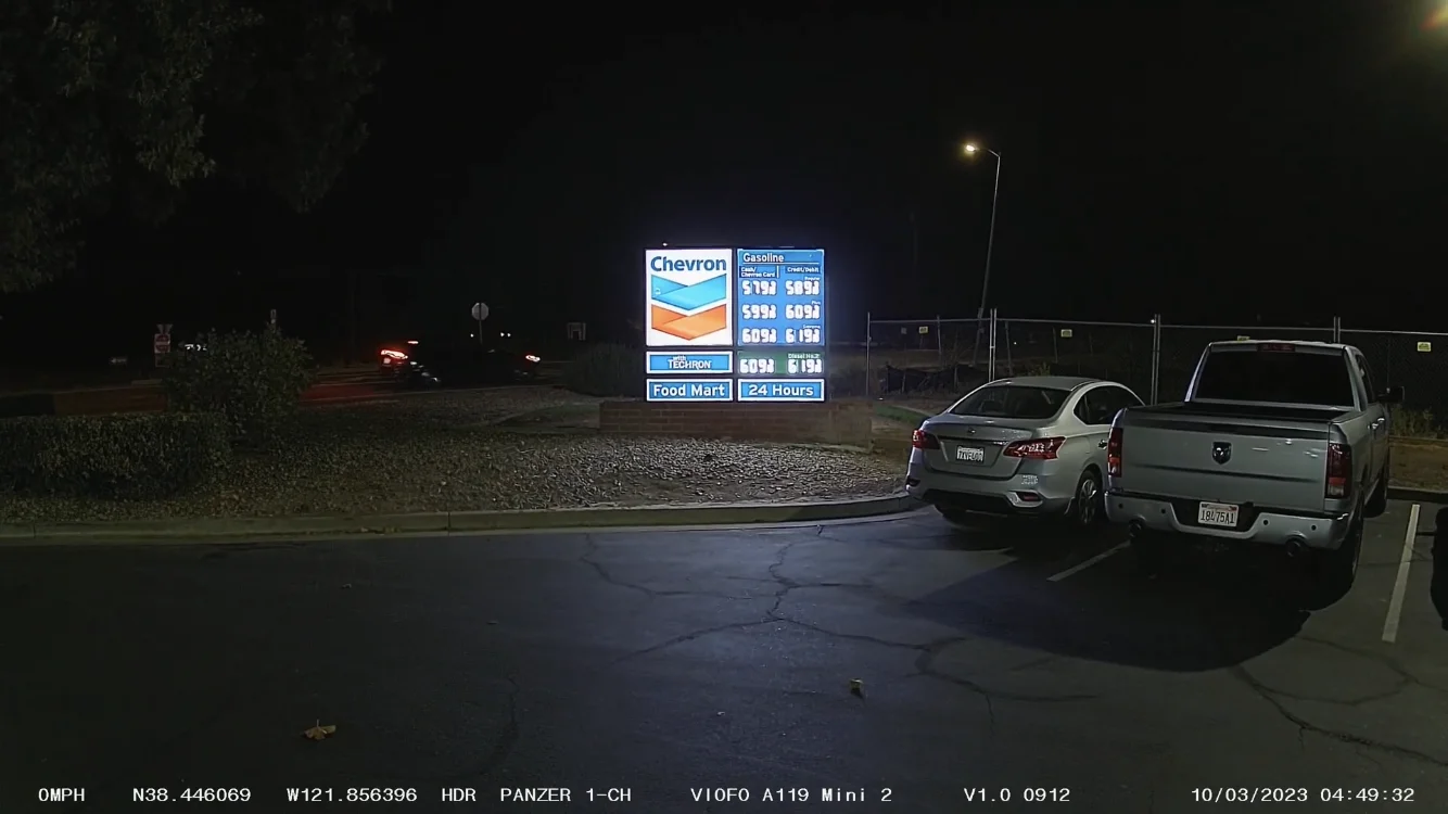

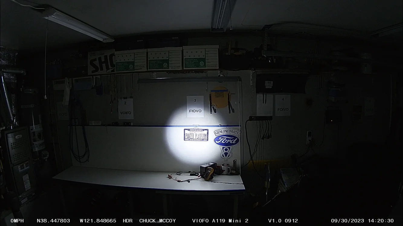

3.) The A229 Pro & A119 Mini 2 have similar brightness, and clarity of the overall image.
However, the A229 Pro is no match for the A119 Mini 2’s HDR performance at resolving the license plate.
Take note “California” in red lettering is missing from the A229 Pro, among the overexposure.

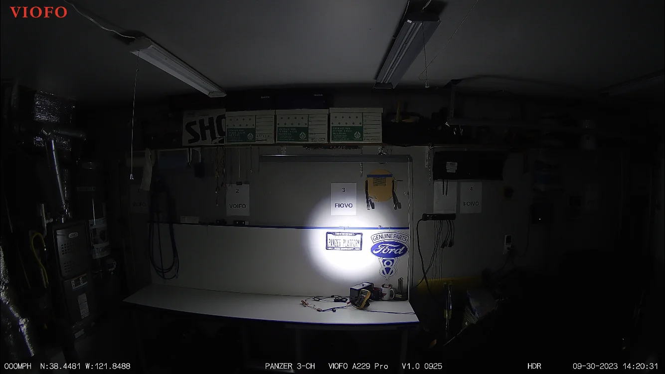

5.) The Interior cameras of the A229 Pro & A229 Plus have a dark overall appearance of the image.
However, the HDR performance resolving the license plate is far superior than the Front & Rear cameras of the A229 Pro & A229 Plus.
How does the “lowly” STARVIS 1 (IMX307) have better HDR performance than the STARVIS 2 (IMX678) & (IMX675) in the A229 Pro & A229 Plus?
Take note in the video footage when I turn on the flashlight.
It takes the Interior camera 3 seconds to adjust / react to the change in lighting conditions, and choose / select the appropriate exposure.
This is unacceptable, because all other Viofo HDR cameras accomplish this task in 1 second.
This requires corrective action.

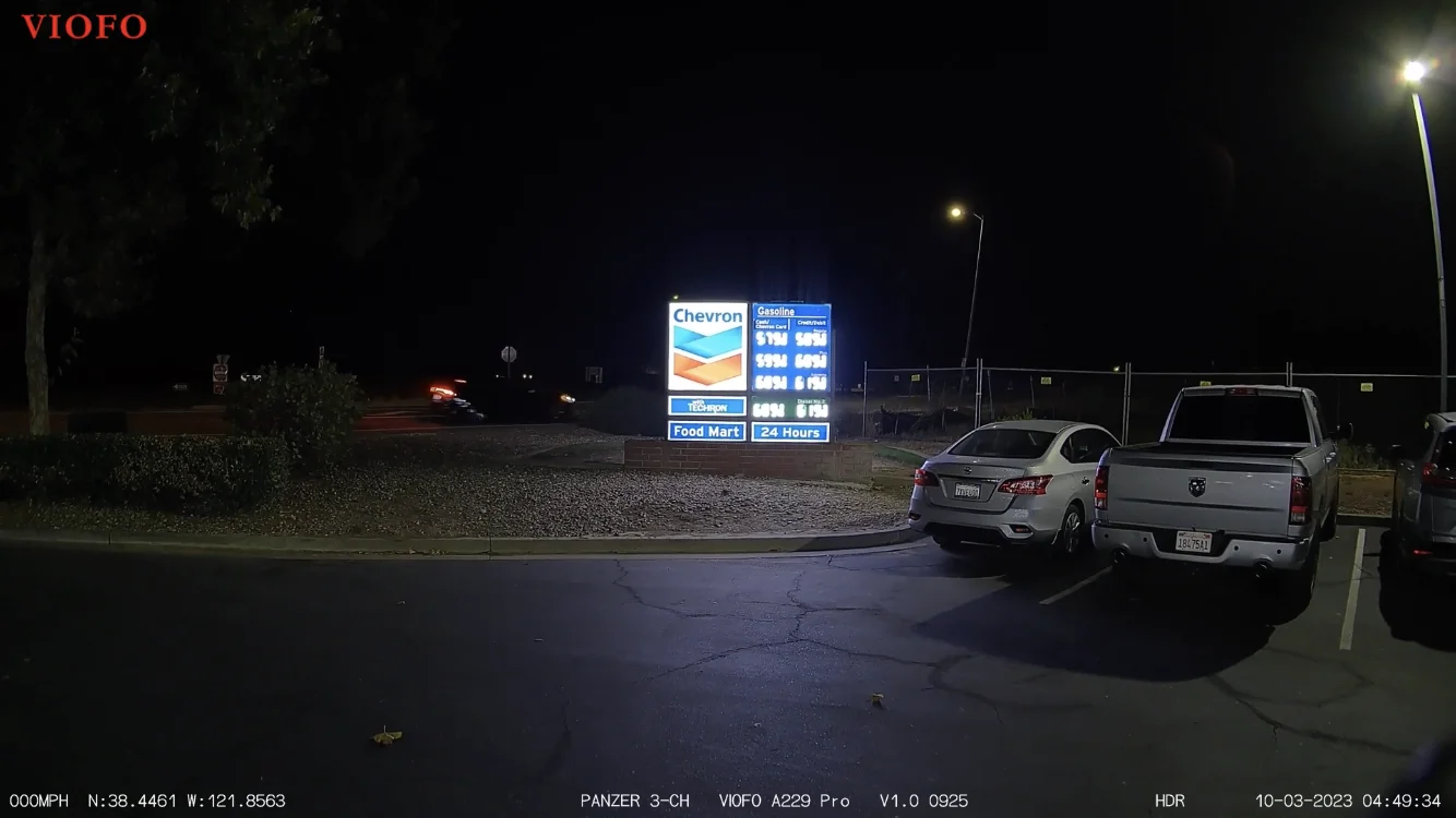

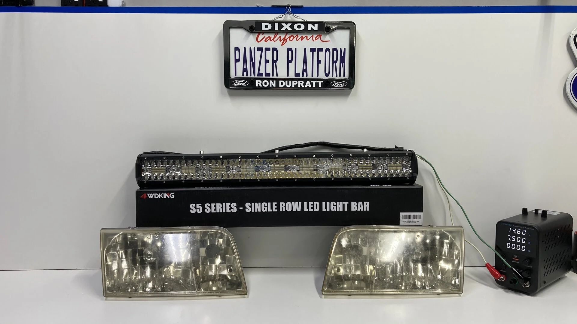

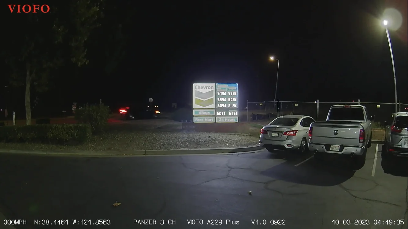

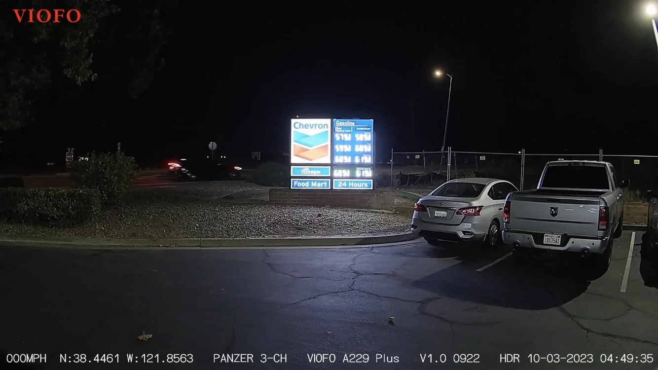

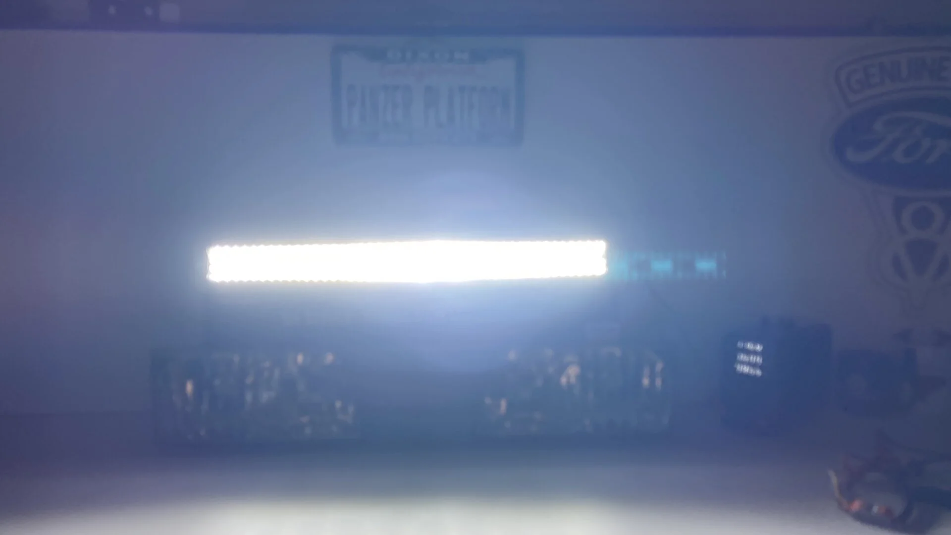

@Panzer Platform
The reason for the high brightness level of rear cameras when reading license plates may be that the rear windows of many vehicles today come darkened from the factory or because dark-colored tinted is pasted on later. Additionally, since there is no backlight, the brightness level is high.
The images are quite good. Since I can't do it myself, I can share an idea with you. maybe you want to try..;
In a similar license plate test, if you have another flashlight or your vehicle's lights are on, you can also test the performance of the cameras when exposed to the light coming from the front by placing your test plate in front of your vehicle.
It should be pretty easy for you to test this with your current setup.
Thanks for what I've seen so far. If you want to try the idea I shared, good luck.
Do you mean something like this?
Of course I will do it at night.

Wow damning results so far :/
Yes it is similar to this. (Another scenario is whether the front cameras can read the license plate through the oncoming light when the lights of two vehicles coming towards each other are on at night. This may also be a test that can be done for your installation.)
The result can give you, me and those who are interested an idea and create a visual feast.
Do you think this would work?
See attached photos.
At the same time, light must come from the camera side. In other words, you can think of two vehicles coming towards each other and the lights of both vehicles are on. (Maybe the situation I mentioned may not occur exactly because your license plate does not have a reflector. As you know, in some countries there are reflectors on the license plates. So it's like traffic signs. Therefore variability may still occur. I may have suggested some tasks that will tire you. Sorry. Only various combinations can bring you pleasure.)
A229 Pro Front cam show more dark and less colors picture than others. Hmm... is this price for 4K resolution?
That's what the EV +- setting and HDR option is for. Focus on the legibility of the car license plates, not the beauty of the footage

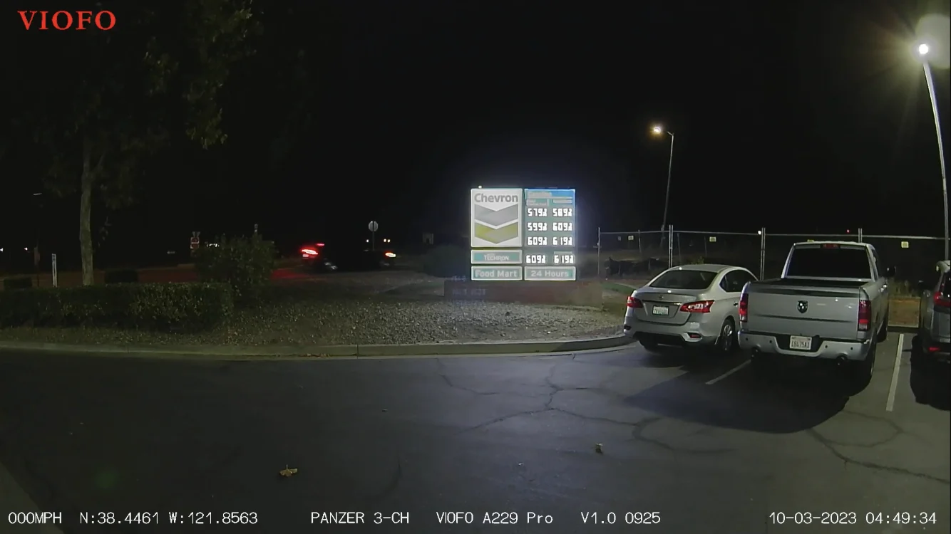

HDR COMPARISON - CHEVRON SIGN
This stationary HDR test is NOT the final judge of image quality.
Installing the dash cams in a moving car trying to resolve moving objects at speed is needed, and still requires independent peer review to confirm & verify.
I won’t be gathering “driving” test footage until we get an “acceptable” public firmware fixing certain issues.
I’ve found this sign to be helpful in gathering baseline HDR performance due to the individual digits are made up of intensely bright LED lights.
Also the background, and surrounding area is very dark.
Cameras on the rig;
A229 Pro 3-CH ..(IMX678) + (IMX675) + (IMX307)
A229 Plus 3-CH (IMX675) + (IMX675) + (IMX307)
A139 Pro 1-CH ..(IMX678)
A119 Mini 2 ……(IMX675)
Camera Settings;
Bitrate: …..Maximum
HDR: ……..On
IR LEDs: …Off
CPL Filter: Off
Camera Firmware;
A229 Pro Front: ..V1.0 0925
A229 Pro Rear: …V1.0 0901
A229 Plus Front: .V1.0 0922
A229 Plus Rear: ..V1.0 0901
A139 Pro: ………..V1.1 0629
A119 Mini 2: ……..V1.0 0912
1.) The A229 Pro Front & A139 Pro 1-CH have similar HDR performance resolving the digits of the price sign.
However, take notice of the bush & tree.
This is the improvement in low light sensitivity of the A229 Pro I’ve been talking about.
Once the A229 Pro’s HDR has been fined tuned, and we get an “acceptable” public firmware it should beat the A139 Pro’s image quality in every aspect.
2.) The A229 Plus HDR performance trying to resolve the individual digits on the price sign is ineffective, and unacceptable.
The A229 Plus has even better low light sensitivity than the A229 Pro.
If we can get the HDR fine tuned, and keep some of this “brightness” the A229 Pro will be t*ts.
Another interesting note: The narrower FOV of the A229 Plus makes the license plates in the image appear larger, and easier to read, (more on this later in the next post).
3.) The A229 Pro Front is no match for the mighty Mini 2.
Not in HDR performance resolving digits on the sign, or in low light sensitivity, and overall brightness of the image especially as shown in the fine detail of the bush & tree, and even the weeds behind the chain link fence.
4.) The A229 Pro & A229 Plus Rear camera’s HDR performance trying to resolve the digits on the sign is ineffective, and unacceptable.
However, the overall brightness / exposure looks good.
5.) The A229 Pro & A229 Plus Interior camera’s have far superior HDR performance resolving the digits of the sign over the Front & Rear cameras.
It’s been explained to me by Alex (Viofo) I should not compare the Interior camera with the Front & Rear because the Interior has been designed / engineered with a focal length of 1 meter appropriate for passenger compartments.
I agree, but at the same time I’m amazed how well the HDR works.
I’ll be comparing the Interior camera with the A139 Pro’s Interior camera in a future post.
Q: Why do we need HDR on the Interior camera anyways?
A: I’ve performed preliminary testing comparing the Interior camera with the Interior camera of the A139 Pro, and the HDR does an excellent job when my dome light is illuminated.
I can see how this will be beneficial for professional ride share applications because they have regular dome light illumination from passenger ingress / egress.
Another interesting note: Take notice of the license plates in the image, the “low” 1080p resolution really shows compared to 4K & 2K.
I really wish Viofo would have used the (IMX335) for the Interior camera or better yet another (IMX675).
