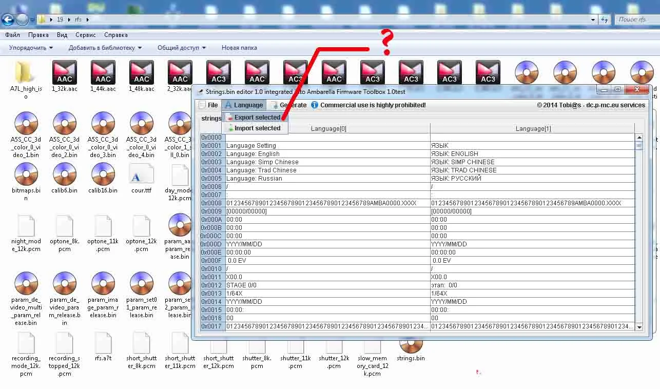

Hello.
And where now strings.dat -?
Hi, the import/export works a little bit different. It Exports/imports the row you have your active cell in.
It will be in the rfs folder and is called language[id].lang

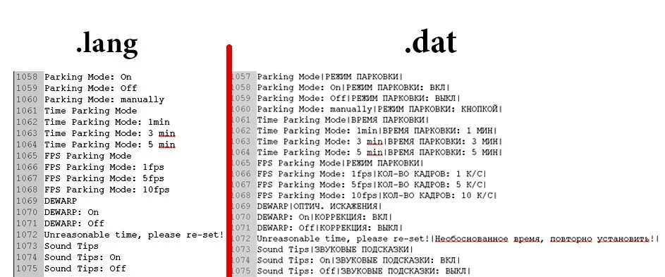

Yes, but there is not all the information.
No second language.
Here strings.dat, but language0.lang
snippet:
The .dat file comes from the old strings.bin editor. It's not used anymore. The application keeps the language data in memory.
The export/import is used to modify a single language (column) with an external editor and import it afterwards. Therefore the exported file only contains strings from one column.
