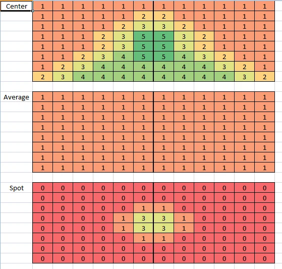

- what is the meaning of the values in AF ? This isn't EV, no ? I changed a firmware and used the extreme values: all zeros/ all fives. I wanted to define some profiles: day/night/cloudy. The result wasn't as expected. The only thing I could see was a change in the temperature of the colours: more yellow/more blue.
> why in the following original profile "1" is on top, and "0" and "7" on bottom ? Just a little problem: on the tested firmware the max value is 7.
