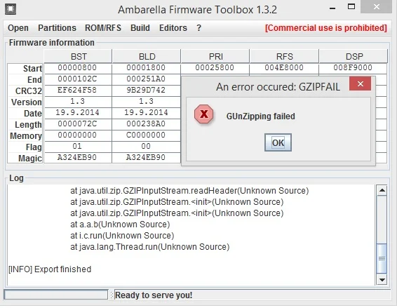

I am trying to change my boot logo, everytime I extract the ROM from partitions I get this error below.
error-jpg.13373
Can someone clear instructions for the latest model it does not seem to be working.
