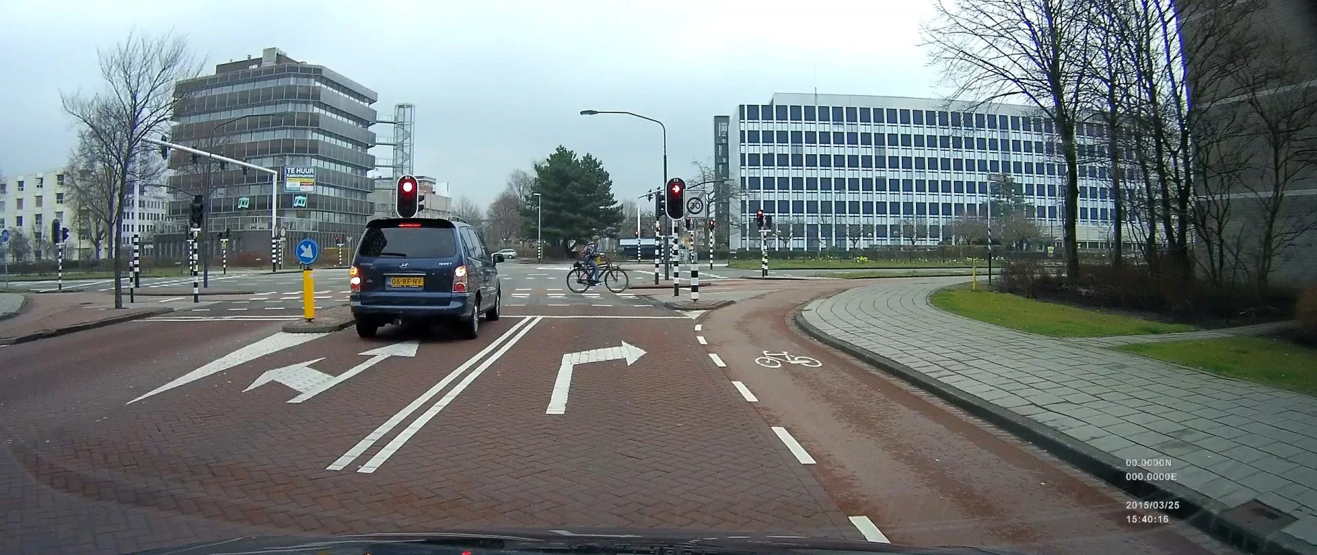

I was wondering if the following could be an improvement.
In my mini0806 I have chosen in the menu: Auto Exposure Metering for CENTER
CENTER correspondents with this picture:
On the bottom of my screen there is a small part of my dashboard (and reflection) and part of the hood visible .
I thought that maybe the picture quality could improve if I edit the AETable and change the bottom-line to be less sensitive, so filling it with 1's or 0's or something like this:
Could this be the case or have I now proven that I have no idea what I'm talking about :D
Here's an example of my picture (original)
But I was wondering if I could reduce / suppress the reflection a bit and let the black part have less influence on the picture
(here's a full size screenshot)
