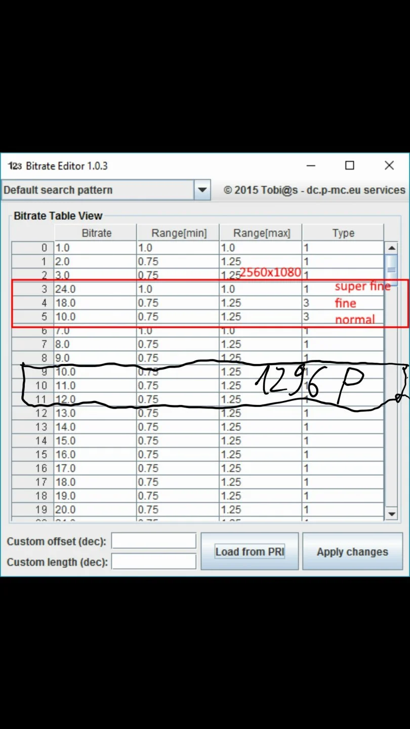

I do not know English, I use google translate sympathy. I edited A7LA50D chips ambarella bitrate success.
3-4-5 (2560x1080)
9-10-11 (2304x1296)
24-25-26 (1920x1080) 1080p 30f
51-52-53 (1080x720) 60F 720p
54-55-56 (1080x720) 30F 720p
now aac 48000hz and 64k, I want 48000hz and 96k or 128k recoder audio??? help
