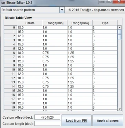

Can anyone help me, I am stilling trying to find a way to edit the bitrate on my Gator HDDVR 400L.
The firmware is a few posts above.
Error Message:
thanks Falsificator, it took ages to finally get it all working.
The first time I updated the firmware it bricked my device, I have finally got it all restored and the new bit rates edited now on the G90 Cam, very happy 🙂
update* The camera just freezes after about 15/20 mins of recording, does that have anything to do with me changing the bitrate to 26mbit? I am running 2560x1080
